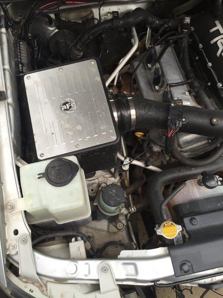

    Well I got an ARB twin compressor for Christmas but it looks like I won't be able to use the Slee off-road bracket because of my AFE intake. @chenbro can you send me a few pictures of your setup when you get a chance?

    Top view of where it's supposed to go. Looks to me like the intake is in the way

    Looks to me like it's time to ditch that POS and install a snorkel instead :D
    I think the Slee mount will work, but you'll need to figure something else out for the remote manifold if you decide to get it. The top part of the mount is a piece of 16g steel about 1.5-2" wide, so if the top of your intake is lower than the top of the washer reservoir then it should clear.
    Or just mount the twin to the CAI cover.

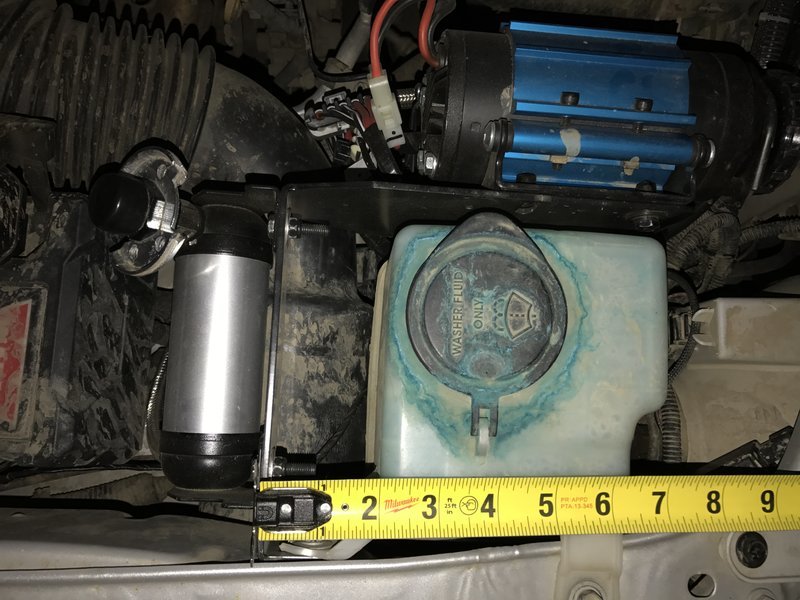

    Would still like some pictures of your setup. Particularly a top view

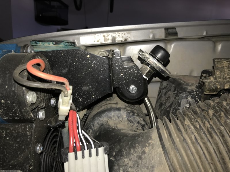

    So the way the Slee mount works is it starts with the mount for the ARB single with the power steering pump relocate on the bottom. Then you bolt one half of the twin to a simple L-plate that bolts to the bottom plate. The other half of the twin is then secured at the top by an L-bracket that wraps around the washer fluid reservoir. It's this top L-bracket that will give you the most issues. Worst case, you could just get the mount for the ARB single since it's the foundation, and then have @3378jakesr5 fab up the rest of the stuff you need.
    Top view
    Side view

    Where does the power steering canister go? Mine is right where the twin is mount in your pics?

    In the image below, the small piece on the right is bolted to the main plate and holds the power steering pump.

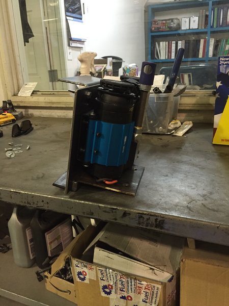

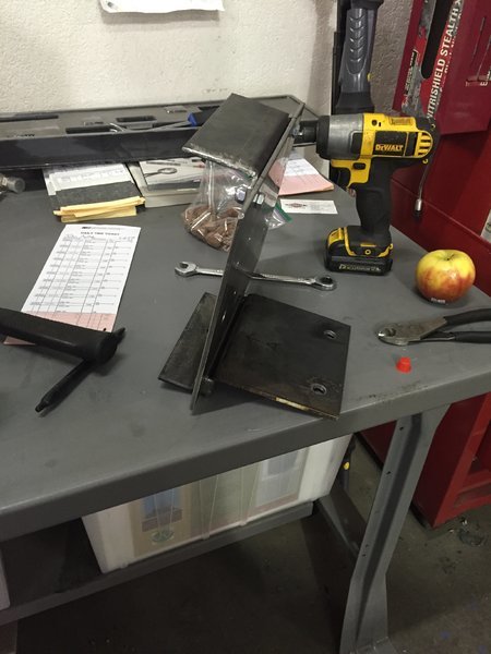

    Fabbing up a bracket for my compressor and also to relocate my fuse box. Hoping to have the compressor mounted and wired by the end of next week
    It will mount in the engine bay on the passenger side right behind my airbox
