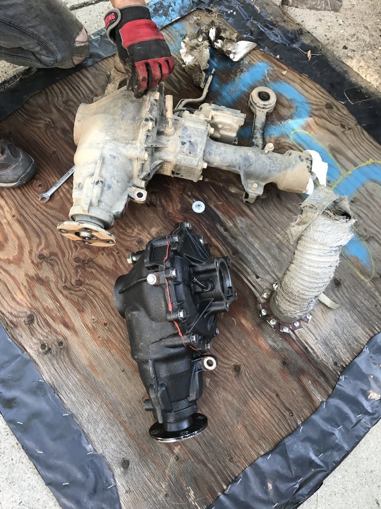

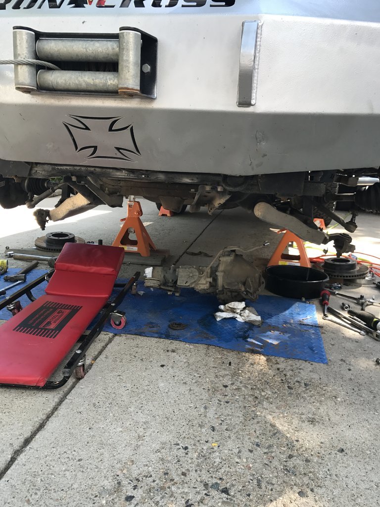

    Huge shoutout to @thefatkid and @Littles for all the help getting my truck back to being a 4wd with my new 4.56 gears! Can't wait to get this break in period over with and get out on the trails before summer is over!!

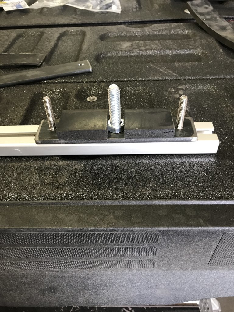

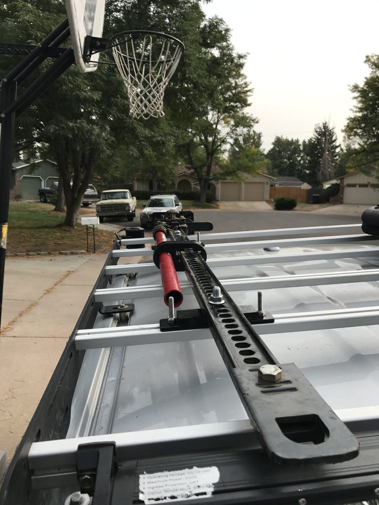

    Fabbing up some custom brackets to mount my hi lift to my prinsu rack

    Welded a 1/2 inch bolt to a steel plate, glued on some rubber bushings and painted them black

    I need to trim the bolts down and add another chunk of rubber, but other than that it should work perfect!
