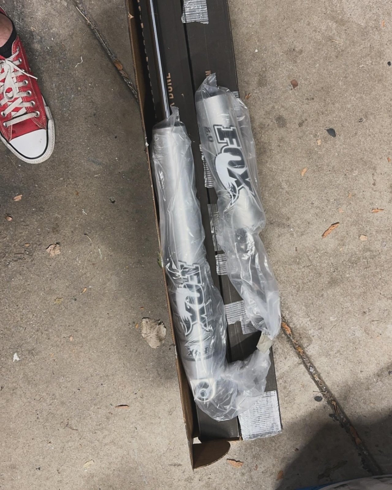

    You might be fine. I'd throw the new shocks and droop the suspension without connecting shocks to the axles, and then connect it and see where you're at full bump. Ideally you don't want your shocks acting like limit straps and you want to hit full bump before the shocks are fully compressed. Both are bad, and my understanding is that tab placement has a lot to do with that once towers are burned in.
    You could take a look at the expanded /collapsed lengths of your Billies versus the foxes to get an idea if you want a heads up or just wait till they arrive.

    The beef has arrived!!! Now I’m just waiting for the bushings and the shackle kit and we are good to go!

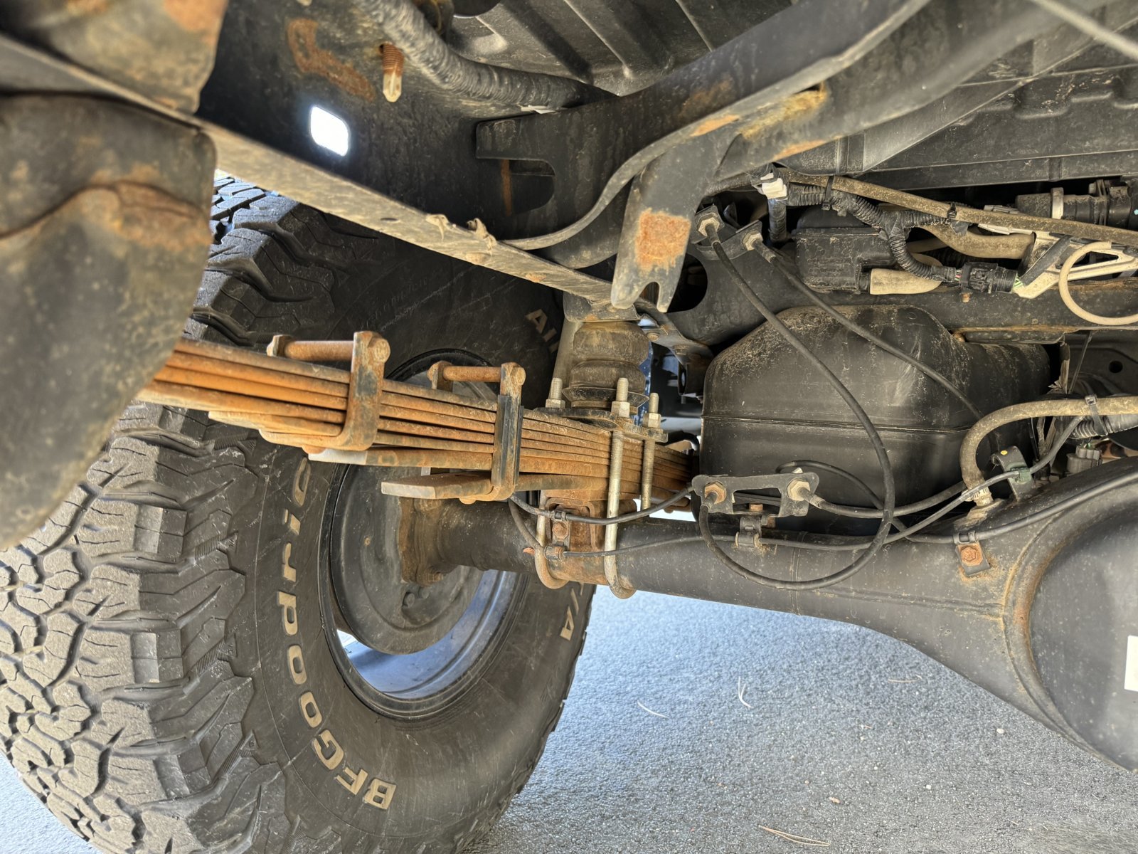

    Gonna be nice to get these flat springs replaced with something more rigid

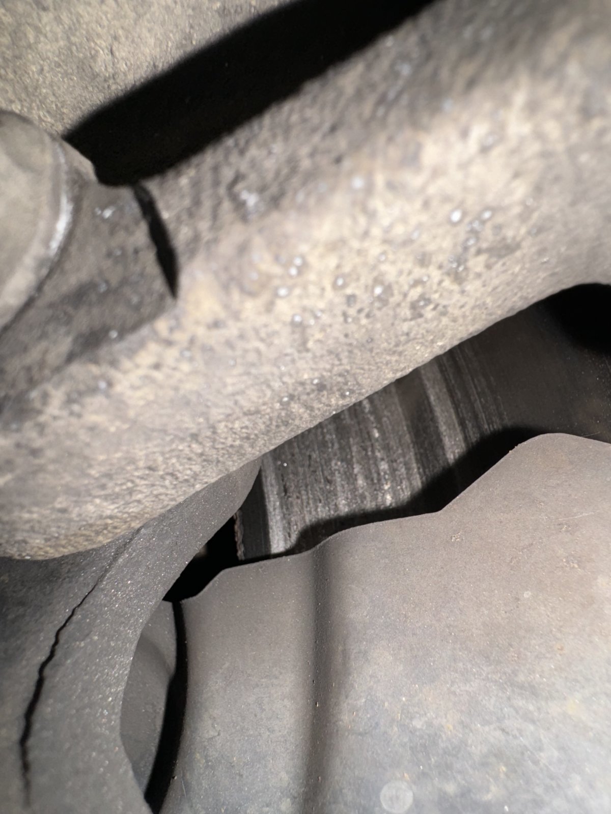

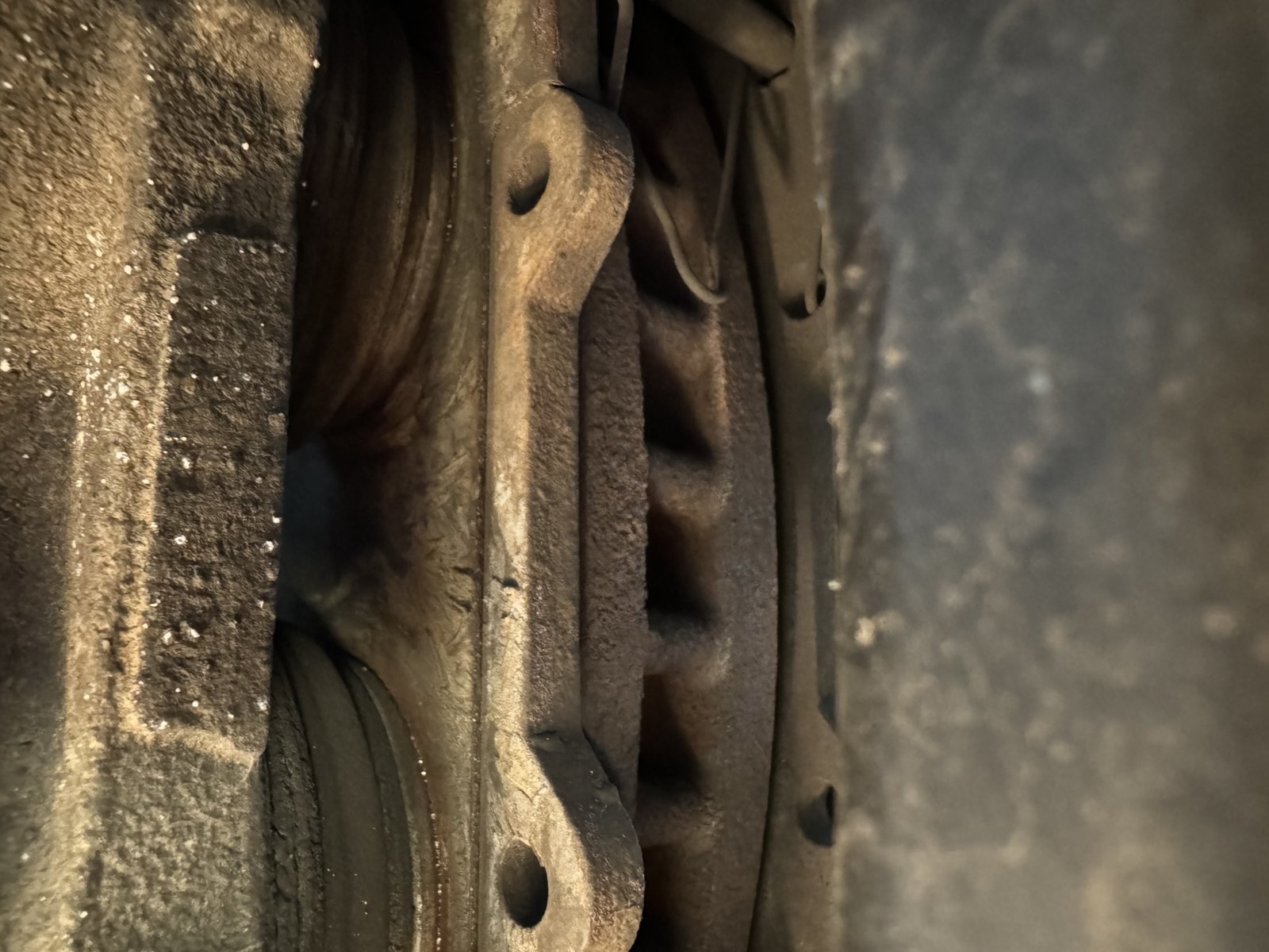

    So it turns out that when your truck is a few thousand pounds heavier than stock your brakes don’t last quite as long as they are supposed to. One of my front inner pads decided to go metal on metal on my drive to work this morning. Add that to the already expensive to-do list I have on this truck

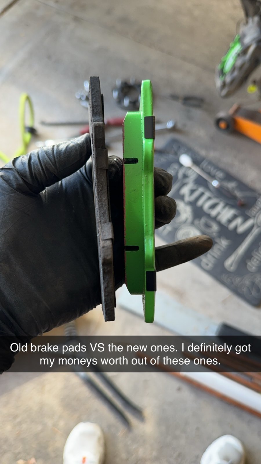

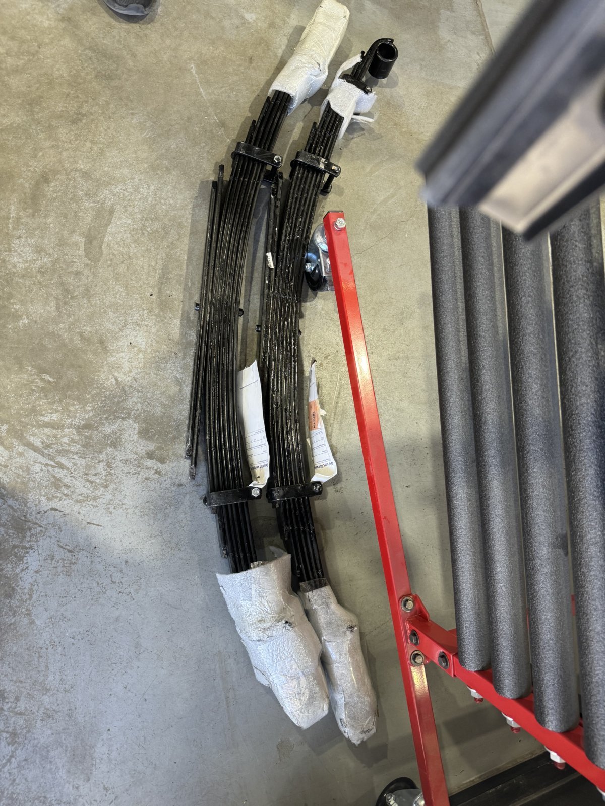

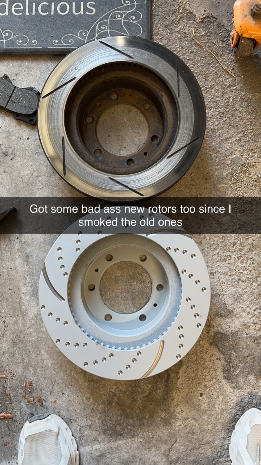

    upcoming stuff in the next 2 weeks:
    Deaver stage 3 leaf springs
    @ARCHIVE hammer hanger kit with shackles and high clearance reinforcement beam
    Fox 2.0 X 12 shocks with resi
    EBC slotted and dimpled front rotors with green stuff pads
    NAPA passenger side CV axle
    AFE pro dry S air filter
    cabin filter
    alignment

    EBC pads are terrible. Look for a true high-quality performance pad, or a "severe duty" pad for towing. I've seen pics of yellow stuff pads crumbled in light track day lapping from multiple sources (should never happen), and heard 1st hand that green stuff pads were not good

    too late now, theyll be here tomorrow lol. plus i dont daily drive the truck anymore so im sure theyll last me atleast a few years

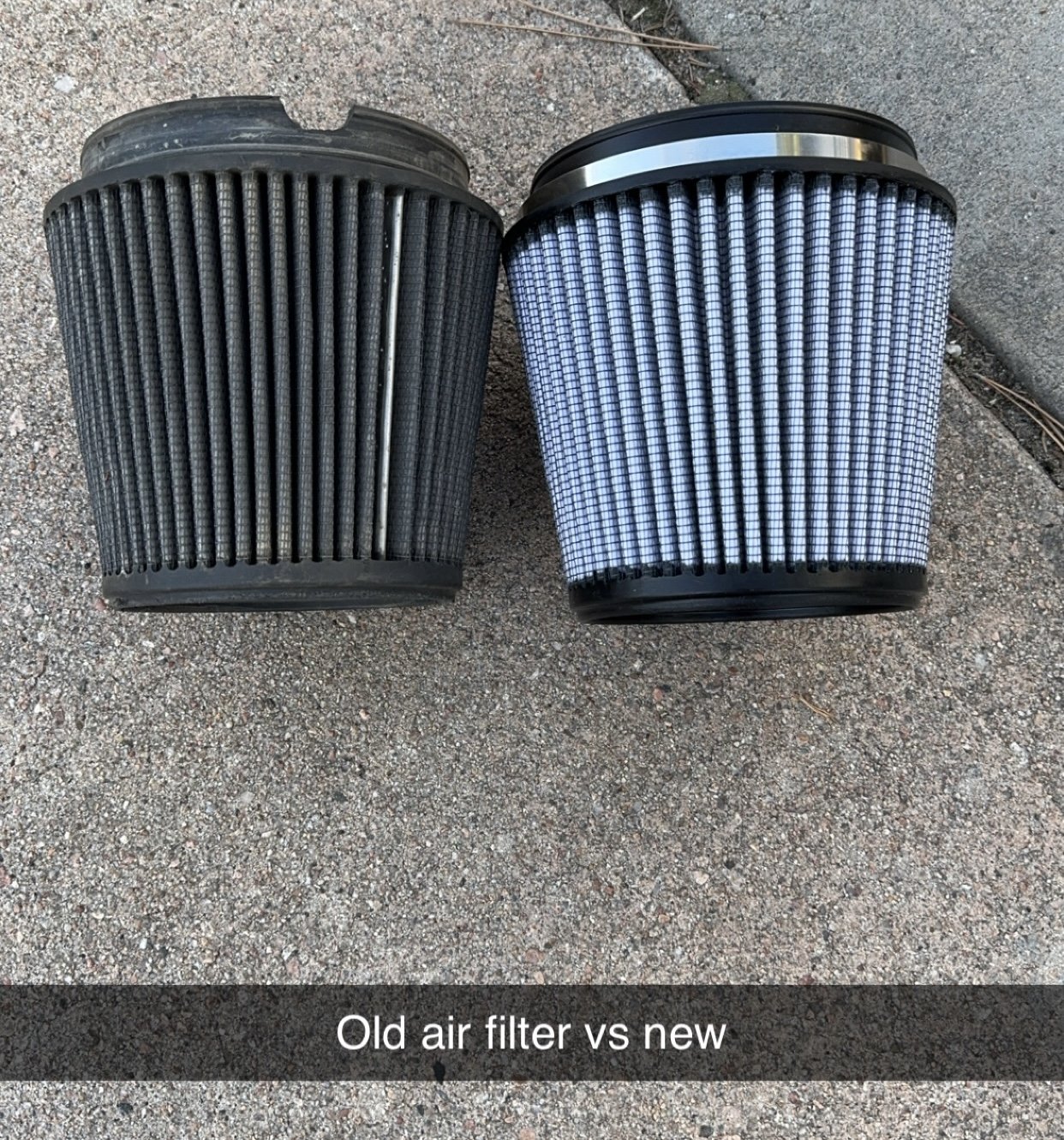

  19. Mar 11, 2024 at 7:07 AM
    #3039
    Tacoma SS
    Tacoma SS [OP] Well-Known Member
    Sep 3, 2015
    #163341
    5,084
    John
    Denver
    Supercharged 09 on 35s
    Boost and flex and 35s
