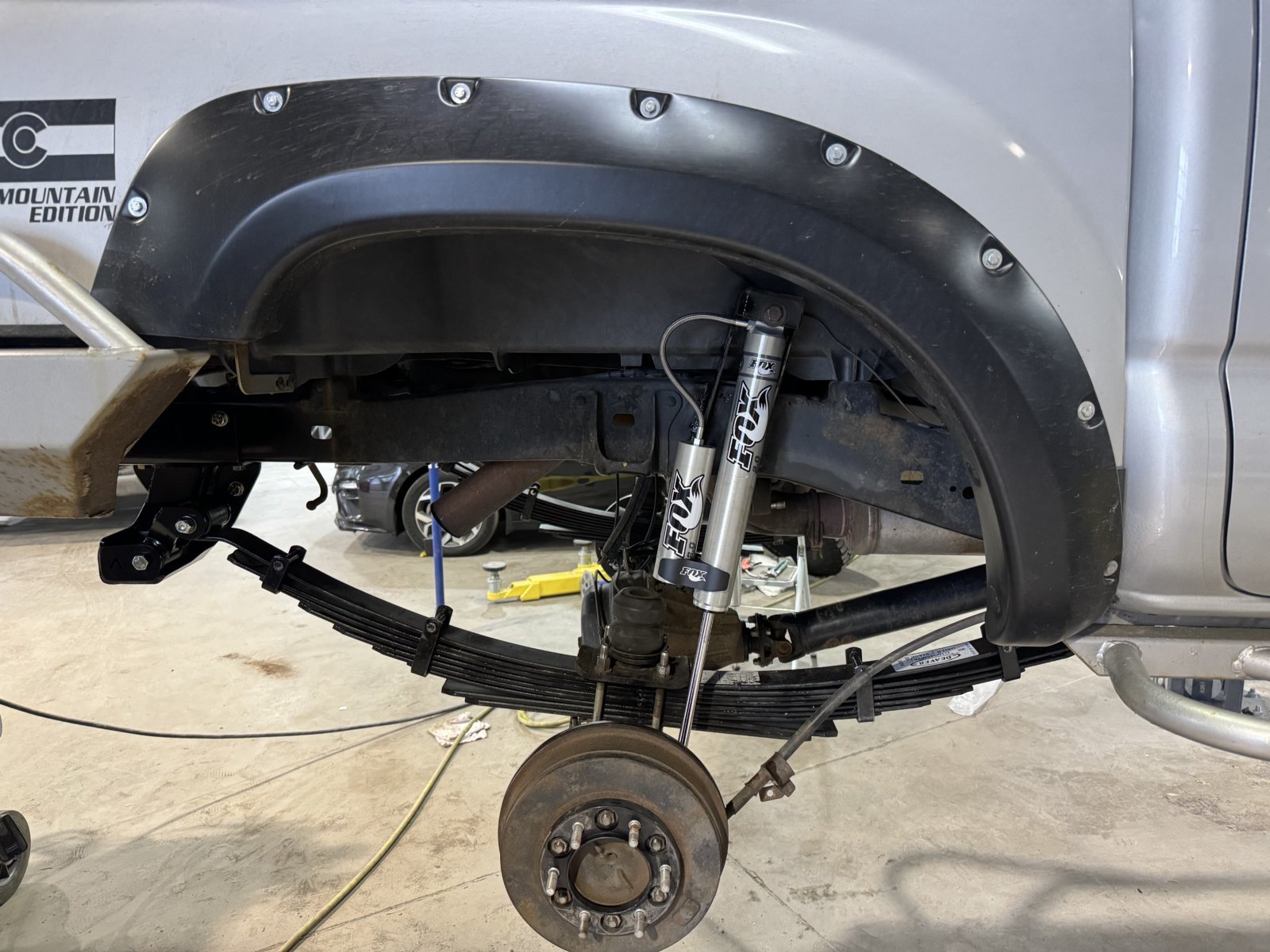

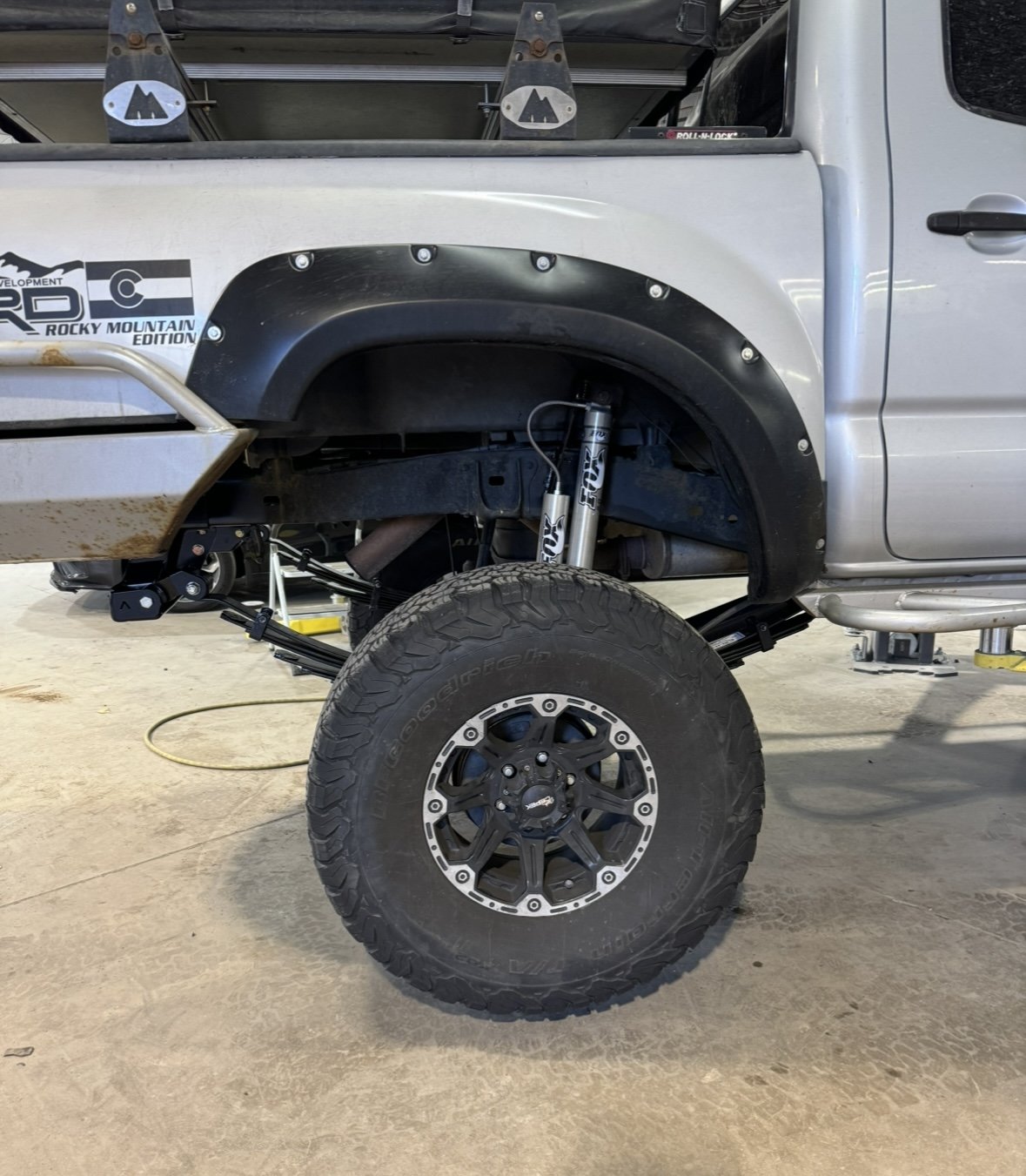

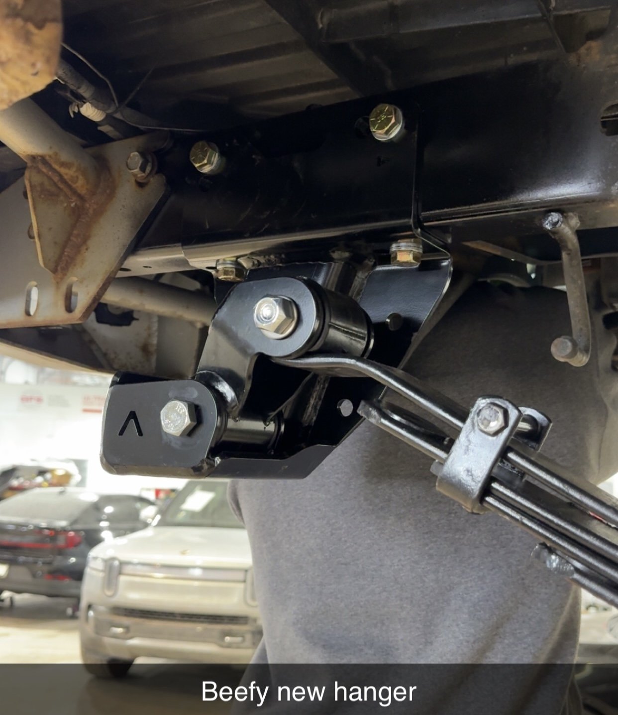

    Super successful day at the shop yesterday. The rear suspension in the big guy is now fully upgraded. Bilstein shocks replaced with Fox, OME 300lb leaf springs replaced with Deaver 1000lb springs and the factory hangers/shackles replaced with Archive garage hammer hangers with shackles and crossbar. Fun stuff

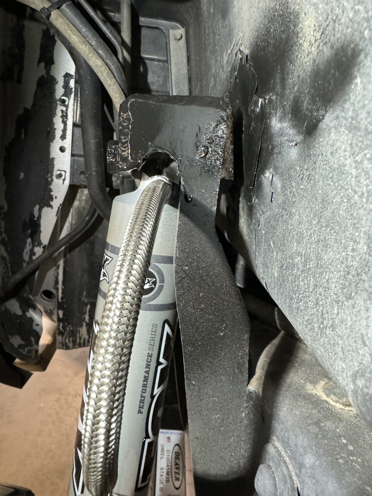

    Had to do a little trimming to the jake special shock towers. Turns out they weren’t built for shocks with resi’s

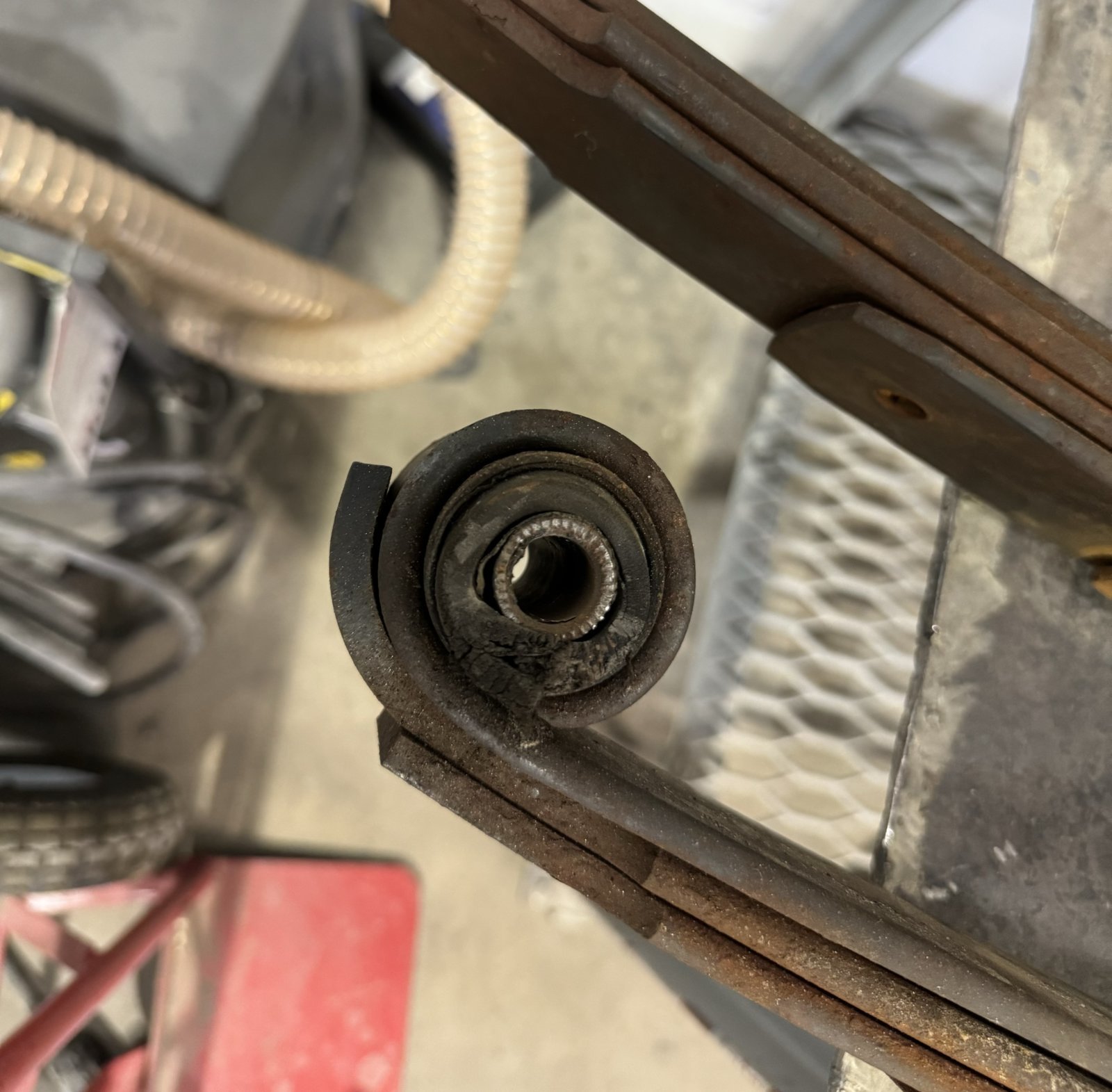

    Bushings in the old leaf springs

    My Dakars looked the same when I replaced them with Deavers.
