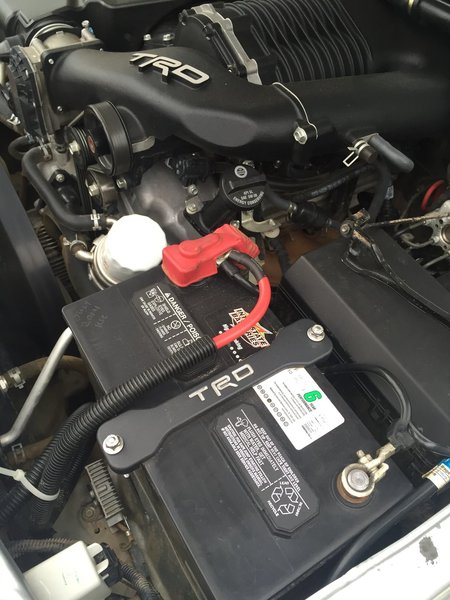

    John, I know you wheel your truck in actual dirt and mud... how the hell do you have such a clean engine compartment?

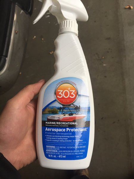

    Take your truck to the quarter car wash and spray the engine down with degreaser then hit it with the pressure washer. After that let it dry off on the ride home and then go over everything with clean rags and a bottle of 303 aerospace protectant.

    Easy enough. No problems hitting everything in the engine bay with a pressure washer?

    Nope, these things are put together pretty well and there's no distributor cap or anything like that to worry about getting wet.
    Here is the stuff I use
