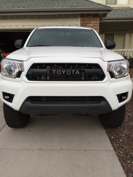

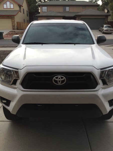

    Plastidip tip: Heat the can up under warm water before use. It will make it less (chunky) not as much texture to it. You will use a little more paint then not doing that but it should make it apply a little more even :thumbsup:
    Plasti-dip with clear coat dip
    Factory color matched
