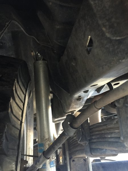

    This is mine at full stuff.
    What back spacing do you have

    And i never thought about it tell now and you never asked and i dont go around seeing if people have wheel spacers. :D

    I have no idea, all I know is that they are dick cepek "torque" wheels. 15 by 8 or 8.5 I think

    It's all good, I think I'm going to pick up these wheel spacers from @RockyMtnTRD and we'll be good to go

    Plus I'm going to have rear bump stops, you don't. So I won't have as much tuck as you do so I should be fine

    That has a little little bit to do with things. Like a 1/4 inch. So you ould have 1/4 of an inch better clearence then i do but i have 1.25 inch spacers and you do not so your still an inch into your shock.

    You mean 16x8? On the website it shows 16x8 with 6x5.5" bolt pattern as having 4.5" backspacing
    http://www.dickcepek.com/wheels/dc-torque/

    I'm going to go meet up with @RockyMtnTRD to get those spacers later today. So I will have 1.25 spacers AND bump stops :thumbsup:

    I don't know if 4.5 inch backspacing is good or bad Haha

    The less backspacing you have the more the wheel sticks out and the more clearance you get for a shackle flip.
