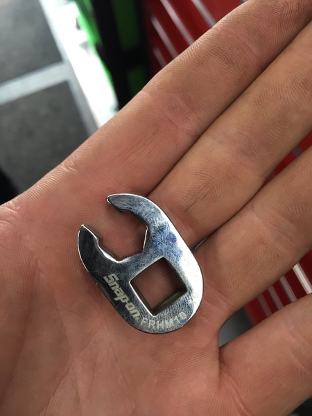

    Bought the perfect tool to make Tacoma rear brake lines a breeze :thumbsup:

    $20 for this dumb little thing though. Stupid snap-on prices...

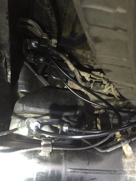

    Putting on my new brake lines today, they seem excessively long like they might rub on stuff and get a hole over time. How do you have yours routed @3378jakesr5

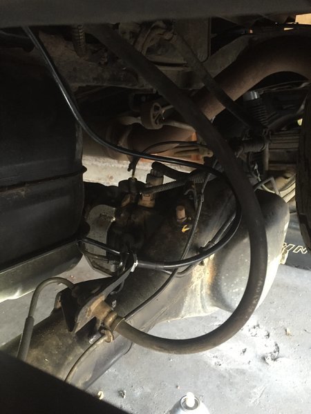

    I did, I also got the orientation figured out so they don't rub... Looks good to me :thumbsup:

    Holy crap those are long. I did a slight coil wrap on mine as I installed them so they wouldn't rub on anything.

    That's how long Jake said I needed them because of the shock tower relocate. What's a coil wrap?

    Where you twist the line when installing so it coils like a snake

    Just a mild winding of the line so it kind of looks coiled. Just helps take up a bit of the slack. You don't coil it much.
    How long are the shocks you put on? With your shackle flip your droop will be limited by the Dakar springs since they are factory length. You have plenty of brake line there.
