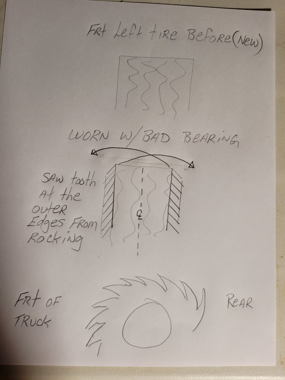

    I want to tag a little diagnostic info to those reading this in the future.
    Here are some of the observations I have found on my truck prior to replacing the bearing.
    If running your hand accross the tire ( at the outter edge).
    You will feel it smooth from back to front, but sharp from front to back ( like a saw tooth).
    See the attached drawing.
    This comes from the tire rocking on the centerline ( so no wear at the center).
    But the edges onside and out have this sawtooth feel to them.
    When I measured the amount of axial play on my axle, it was roughly 0.060 with the bearing.
    And now about 0.10 with the ECGS bushing.

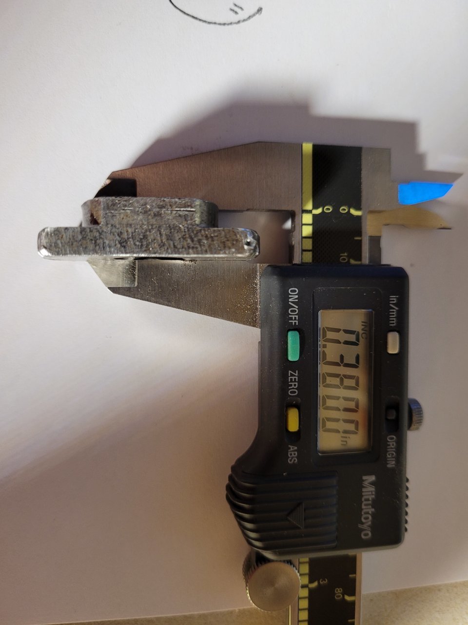

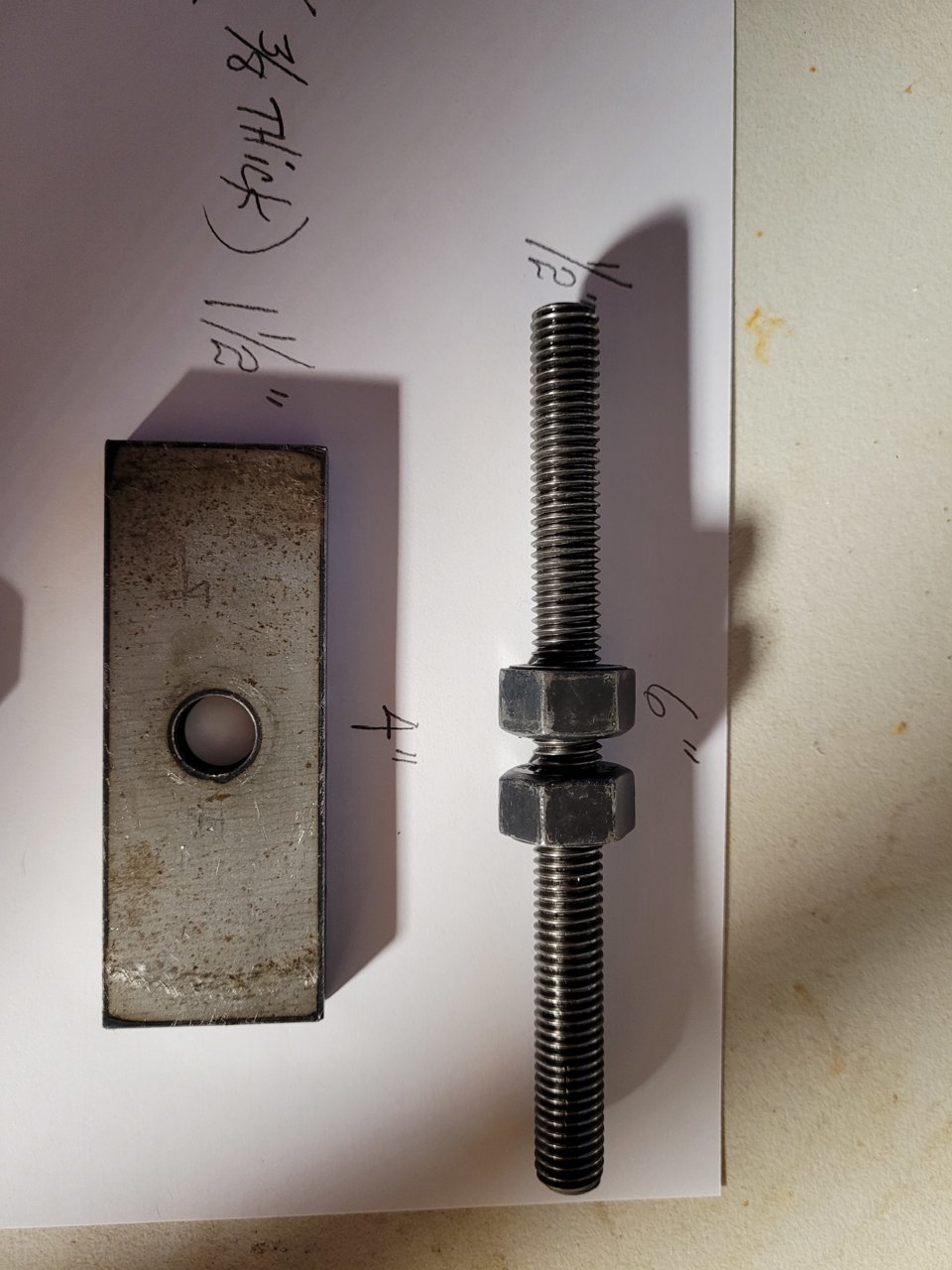

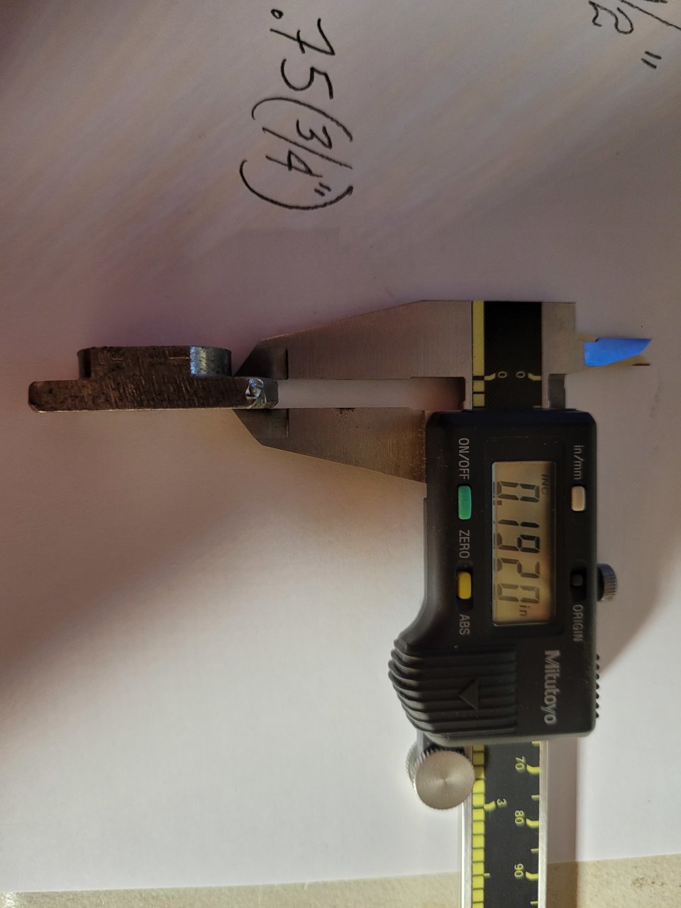

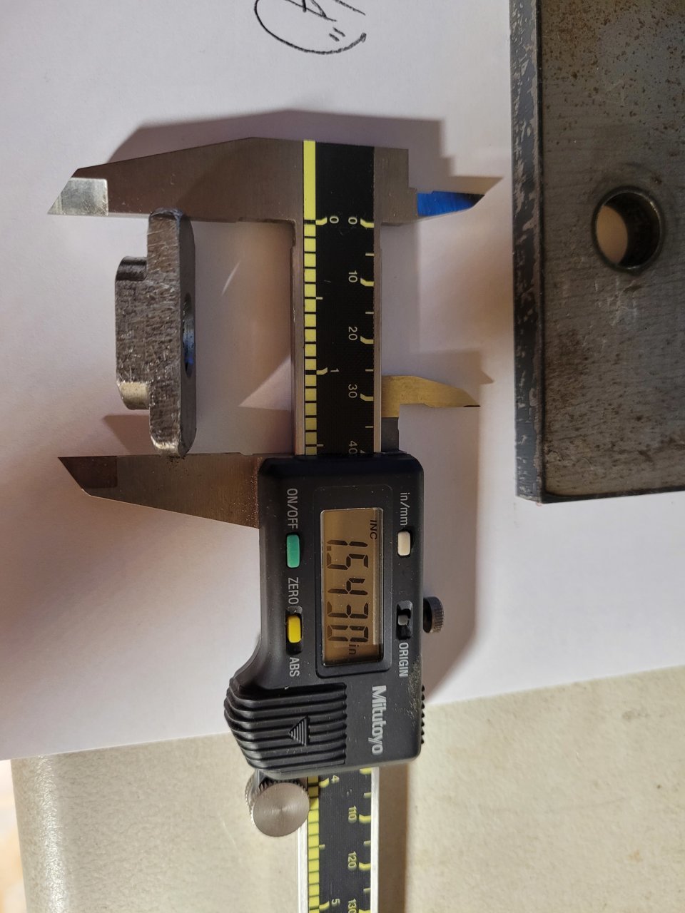

    Here are a couple of pictures of the official ECGS tool attached.
    Someone creative could use this information if really stuck ( doing so is not encouraged, the tool probably has a patent right attached to it).
    I'm not certaain about that, so you do so at your own discretion..

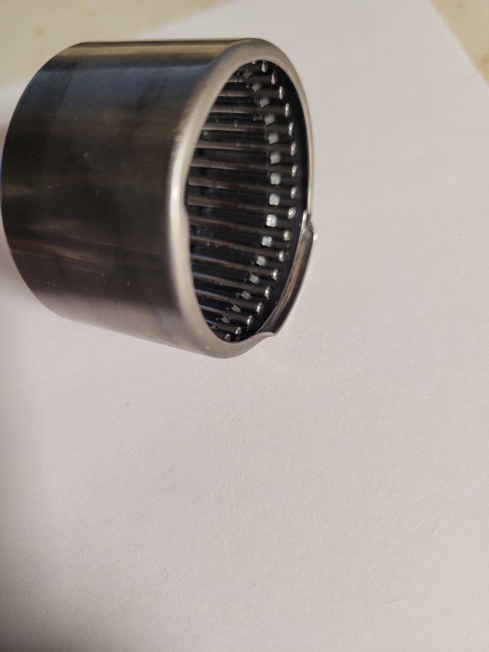

    I've also attached a picture of what the bushing looks like once it is removed.
    The lower extended lip on the bearing that we see, is from tool being knocked into position with a drift ( or a punch).

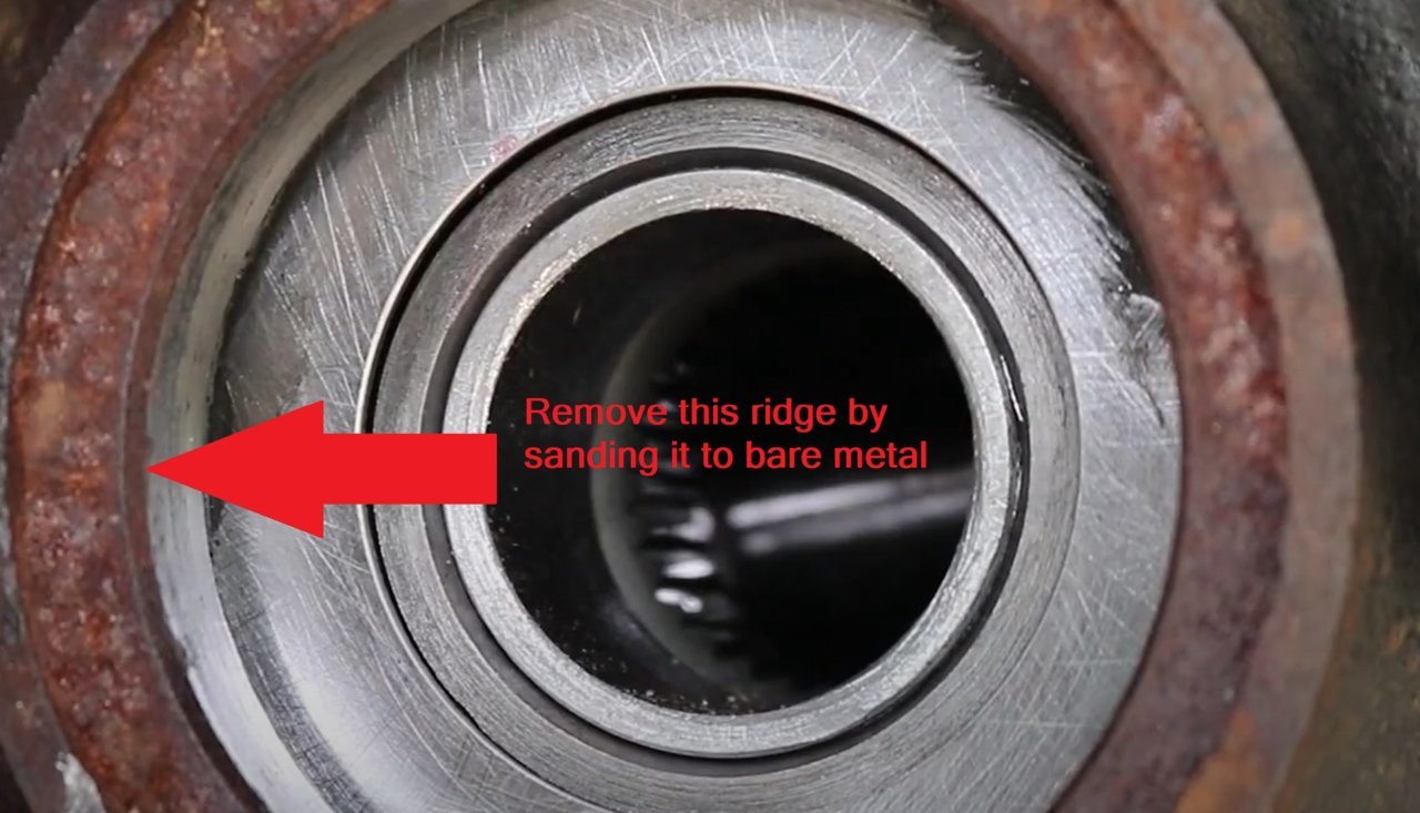

    Fyi,
    I replaced the second axle seal Saturday.
    At first I had some difficultes getting it in straight.
    Being a Saturday afternoon, no dealer and no after market parts open.
    I thought to err on the side of caution.
    So more advice to you all doing this.
    Sand the rusted ridge where the seal is installed.
    Once the ridge is removed and a light coat of grease on the seal.
    It was night to day , to install
    Trust me, you will wrinkle the seals outside if you try installing it without removing the rusted ridge.
    I ruined 1 seal thinking it wasn't that bad.
    Once removed, it went in like a bad joke.
    So don't be pig headed like me!
    Since the repair, the vibration is 50% better.

    sanded ridge.jpg Here is a picture of the ridge to be removed.
    The rusted ridge is the result of the seal being installed (recessed) by about 3-5mm.
