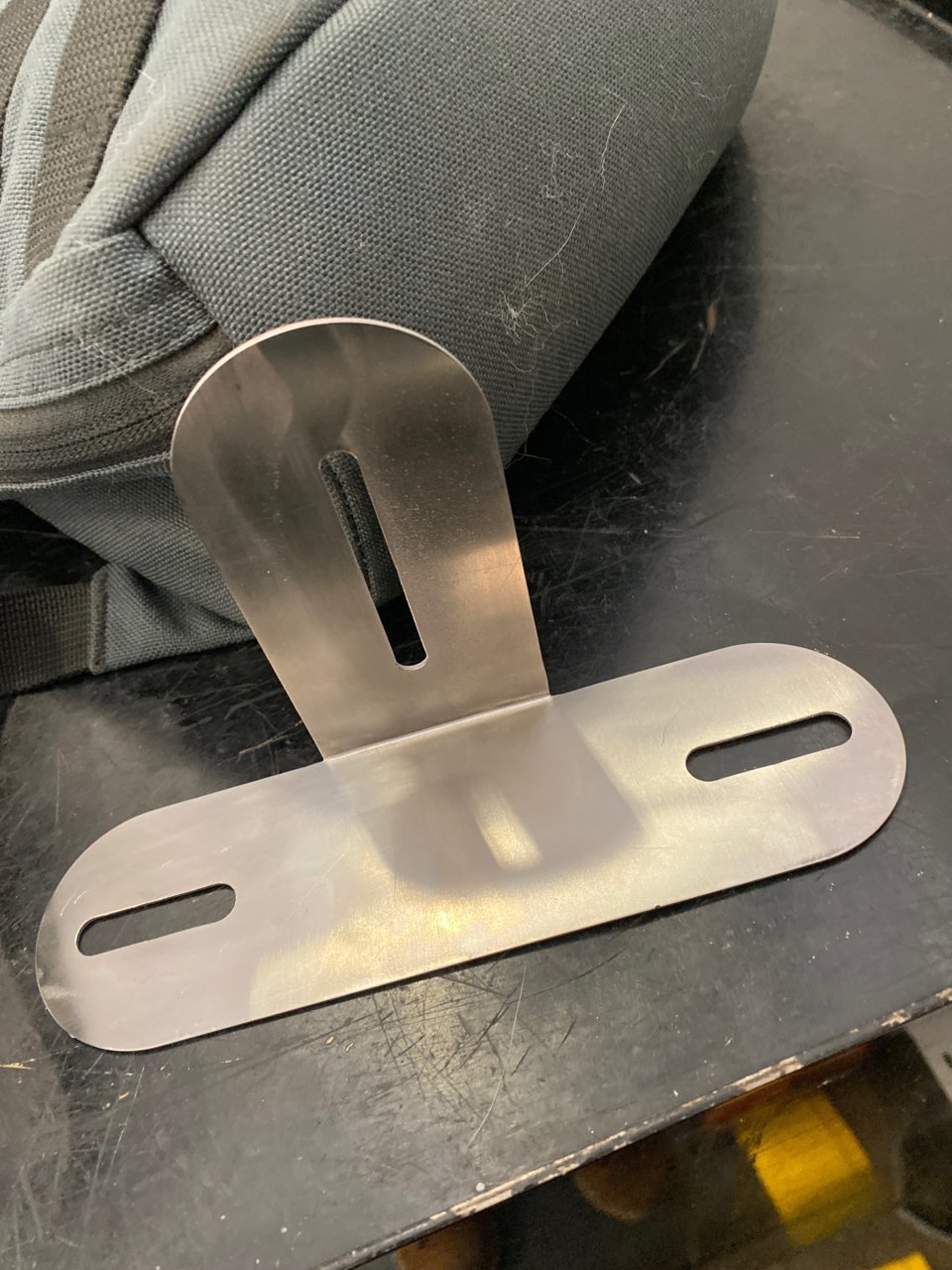

    Someone may or may not have used a multimillion dollar government facility to make me a vaguely penis shaped winch control box mount. Not gonna name names though.

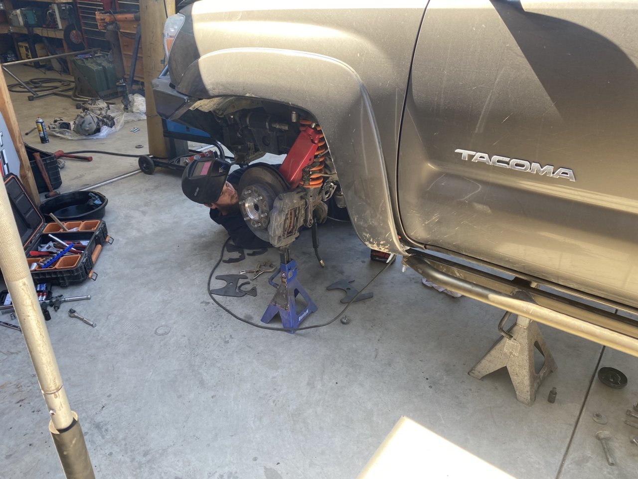

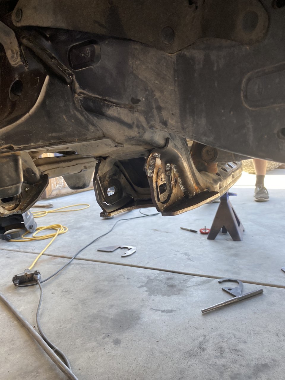

    Black trucks diff has been pulled. Tomorrow @desertjunkie760 will help me pull the diff out of the brown truck and then take advantage of all the extra space to weld in the Marlin Crawler LCA Brace. Once that's done we'll install the 4.56 gears and Harrop e-locker and wire both the lockers up.

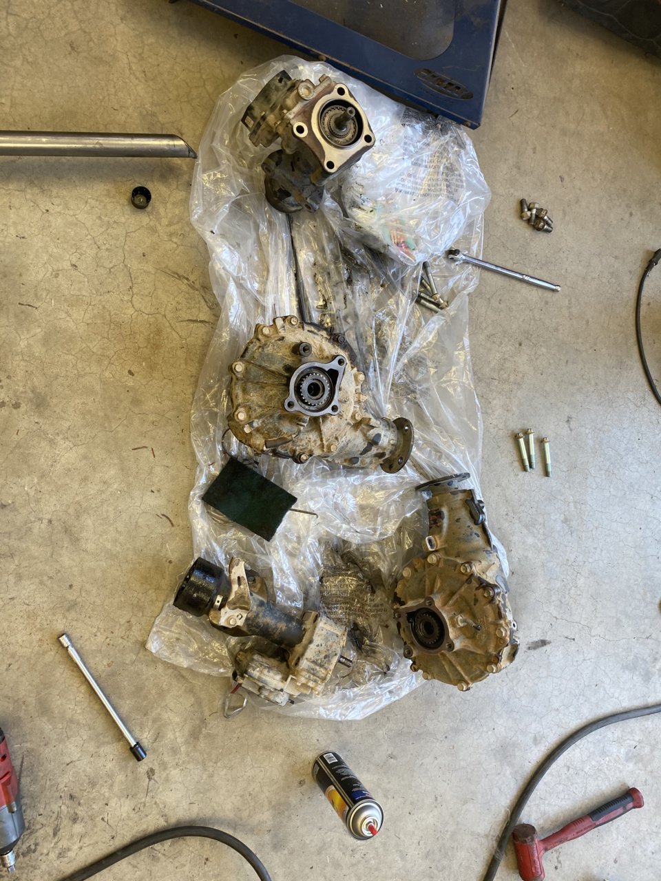

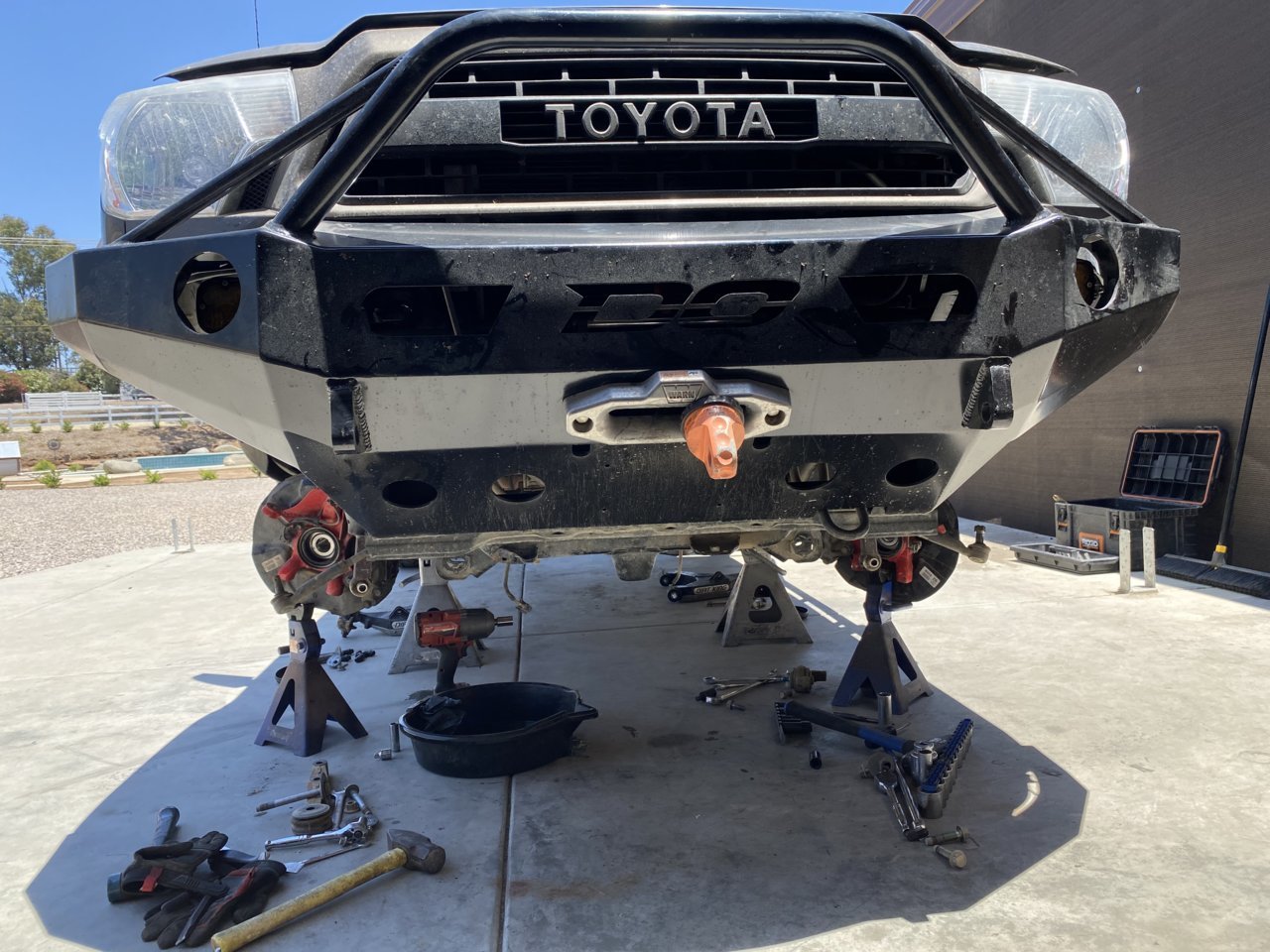

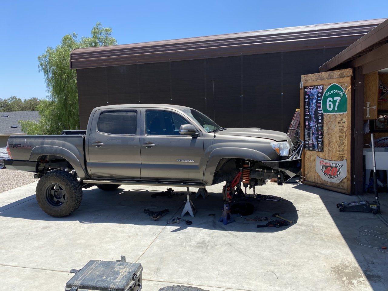

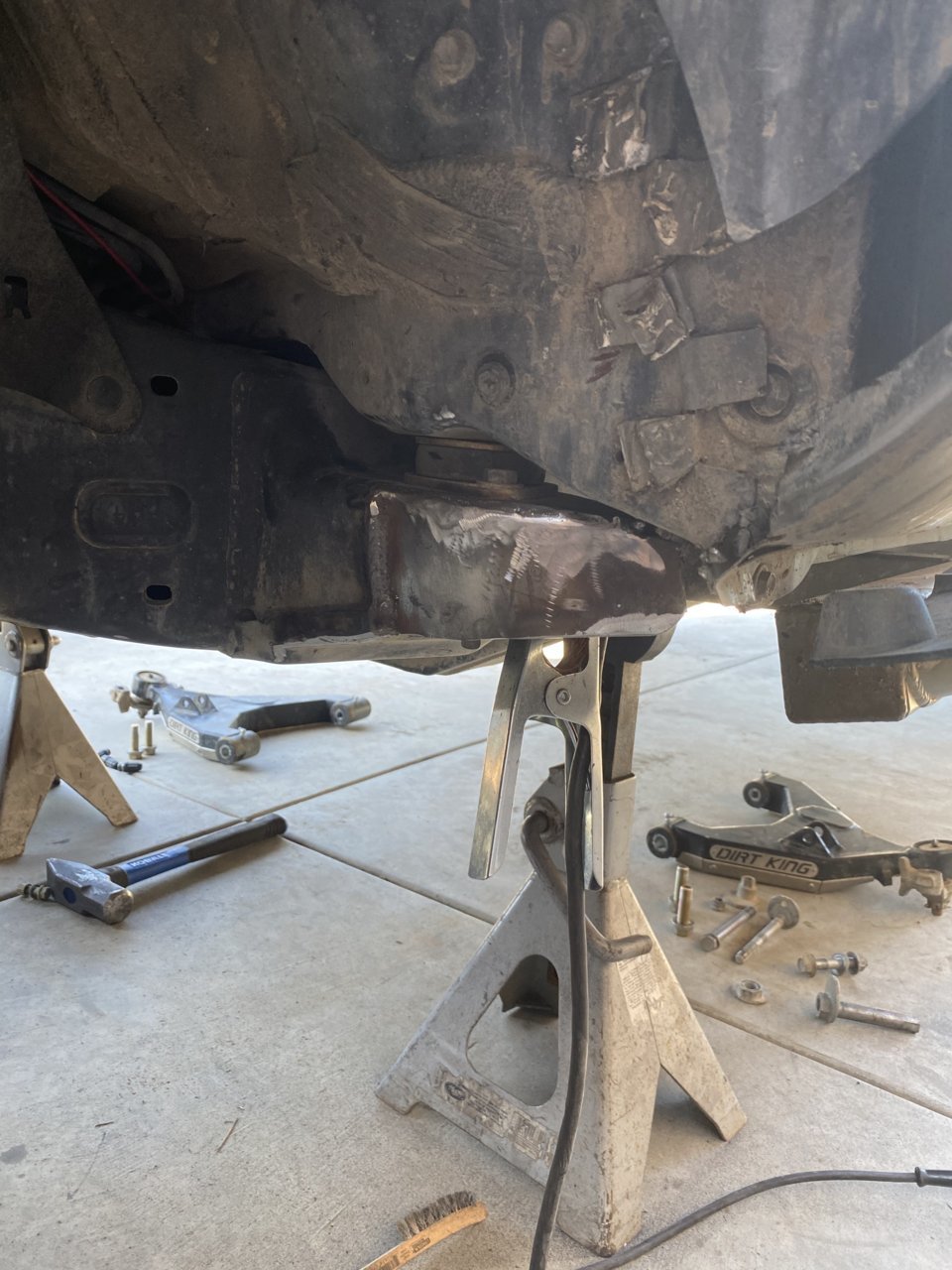

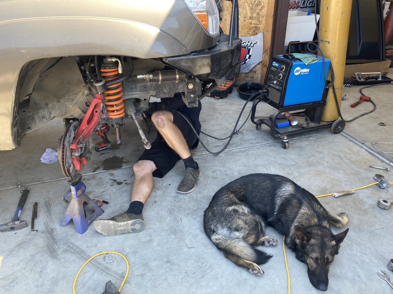

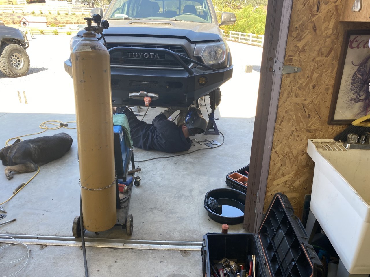

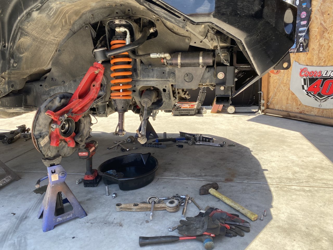

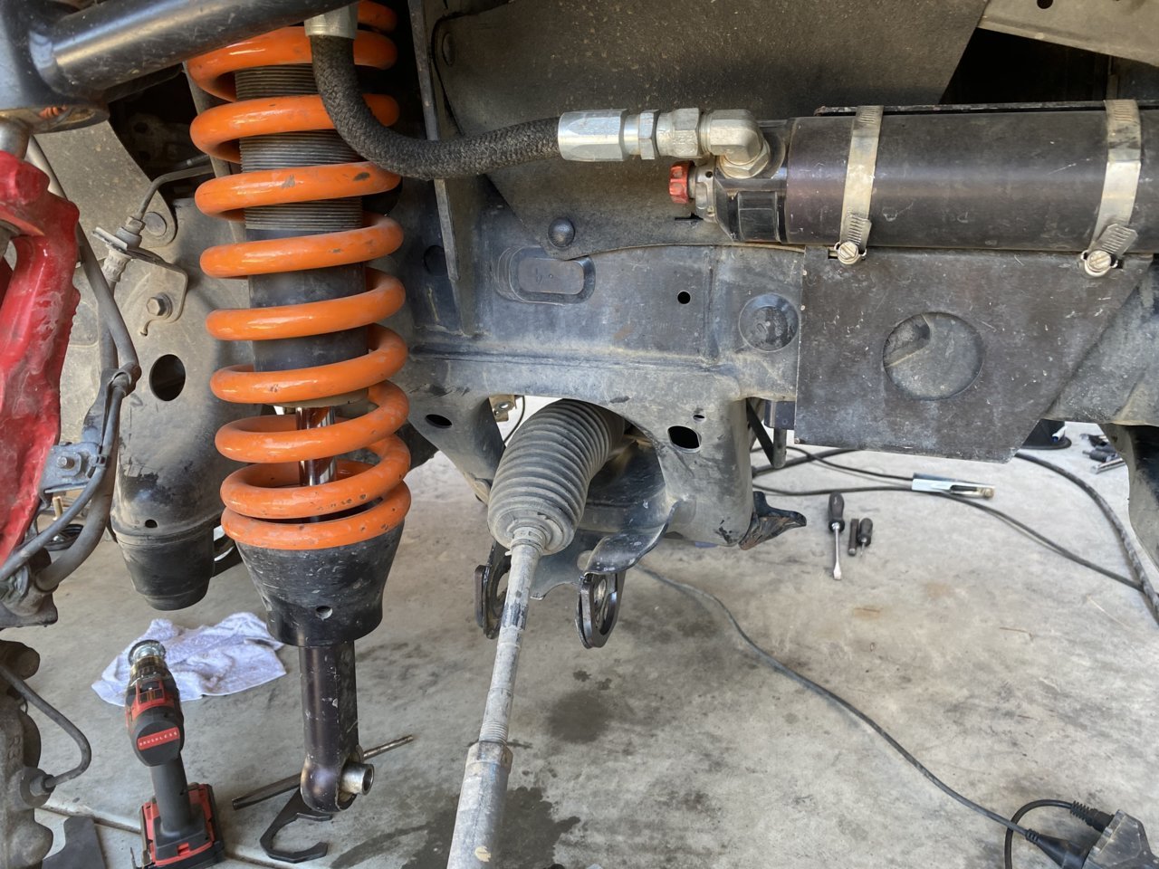

    Step 1: Remove front diff and LCAs
    7E8B7701-9B64-4334-A894-2ACCDB5C0017.jpg 48983BE3-980B-4468-BDBF-3678148717A9.jpg 2C50DEE0-1645-4533-A47C-BE9A4D52C9D6.jpg
    Step 2: Trade ADD tubes, the old actuator will stay with the black truck.
    Step 3: Watch @desertjunkie760 weld
    BB4C37AB-4688-418A-9E77-1C24F401C7F1.jpg E3FEF763-FAB5-44C3-9F06-299CCC184919.jpg 212B5581-6C01-4CD7-9FA2-1B933810A2B4.jpg

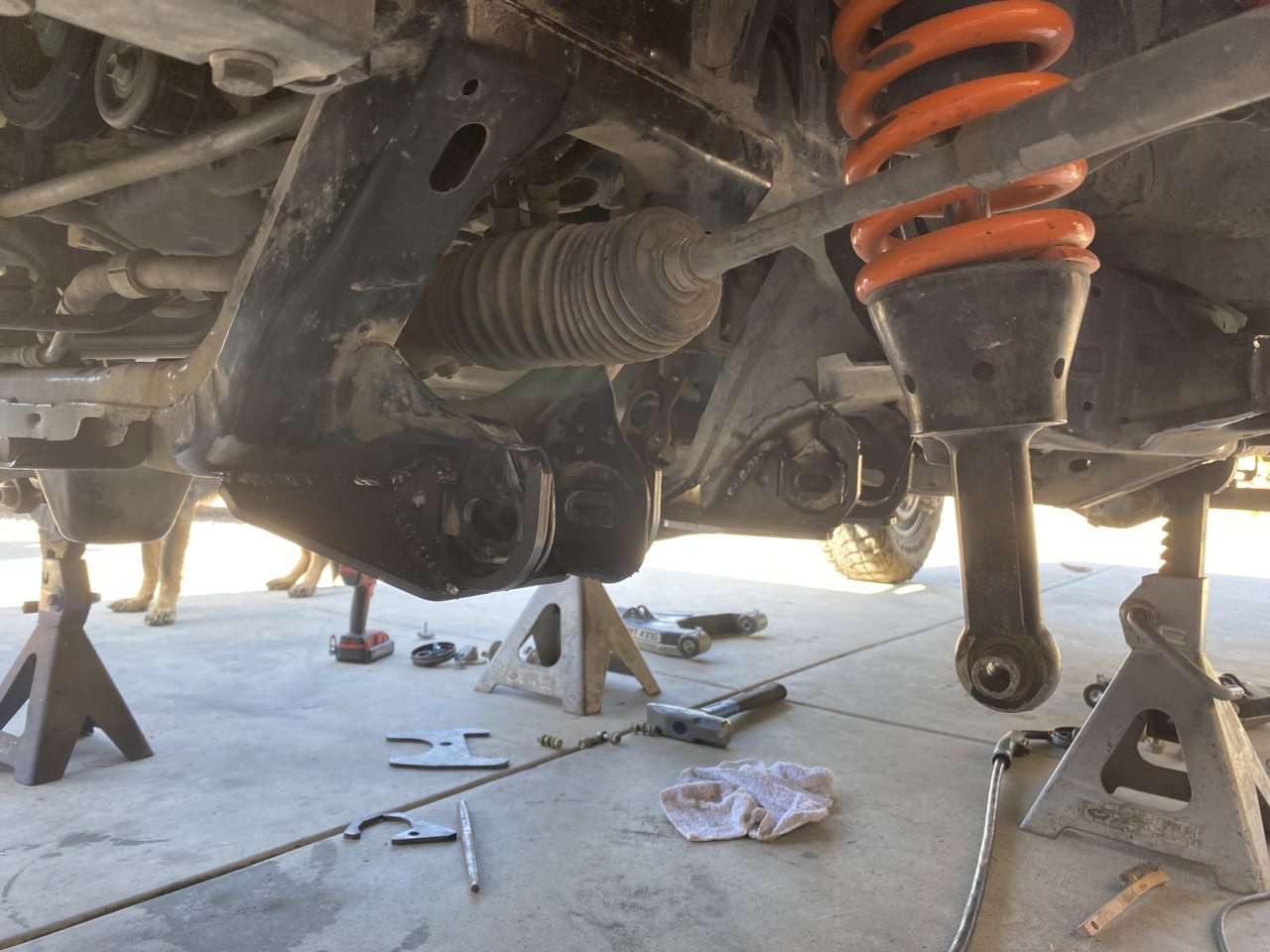

    Step 4: Have driver’s side Marlin Crawler LCA Braces installed.
    F8E52682-9FED-4018-ADD5-E67BF70E7B17.jpg 927A32E9-473C-4EE7-9FF5-BA59243A7F42.jpg 3704BFC7-DA0D-48F8-A09C-CBD68AF8F9D7.jpg
    Step 5: Finish welding driver’s side CMC
    Not pictured: The step where we drink beer.
    To Be Continued...

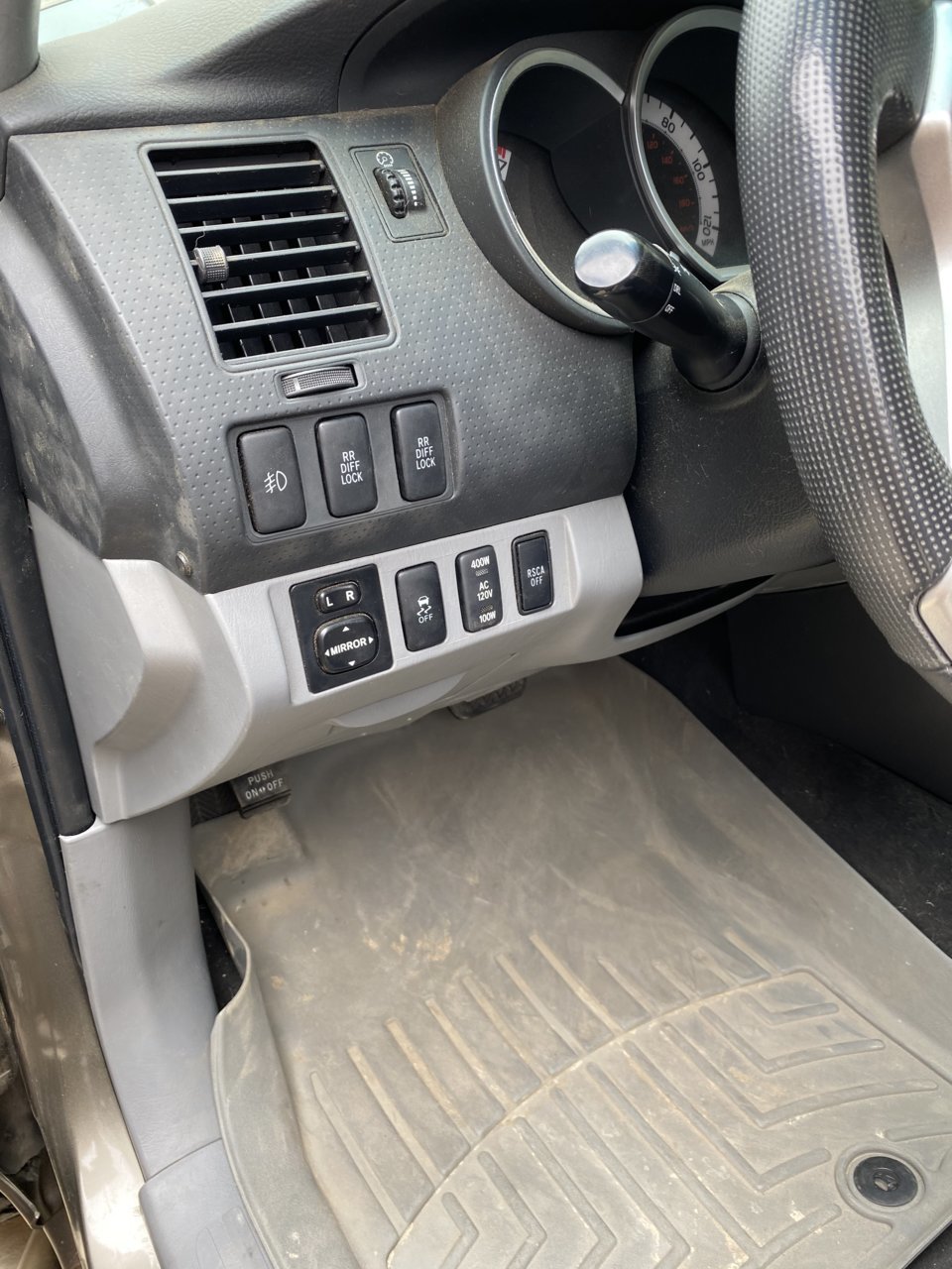

    Is that 2nd rear diff lock button you hit when you really, really want it to be locked?
    hoarder23[QUOTED][OP] likes this.

    I think there's an older fj series that has a different lock switch for front/rear. Only thing, you have to trigger the rear in order to trigger the front.

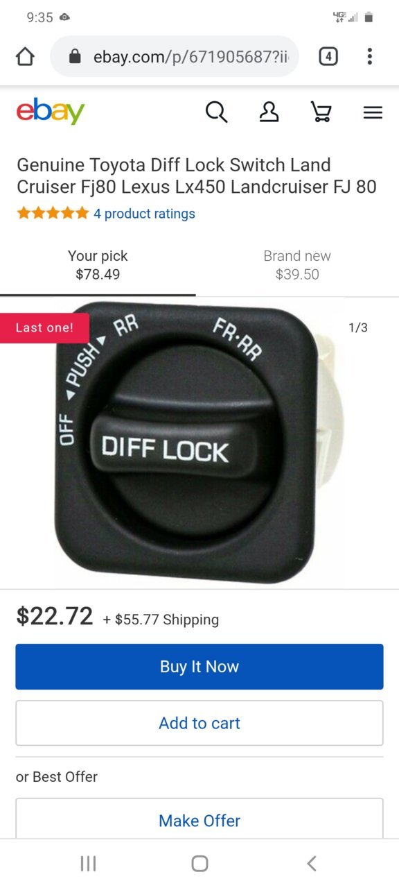

    Yeah, @Cruiser Brothers includes that with the Harrops but I couldn’t find a good spot to mount it. The two stock Tacoma buttons are the cleanest way I’ve found to do it. Left is front, right is rear.
