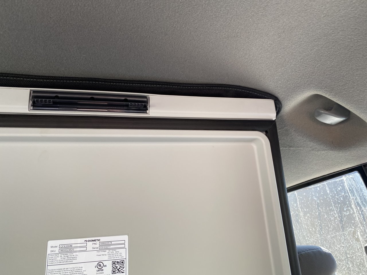

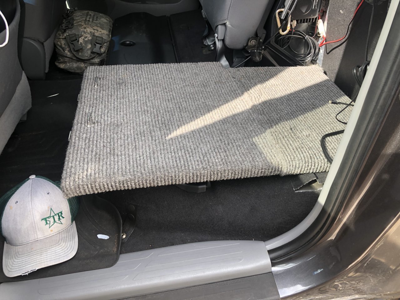

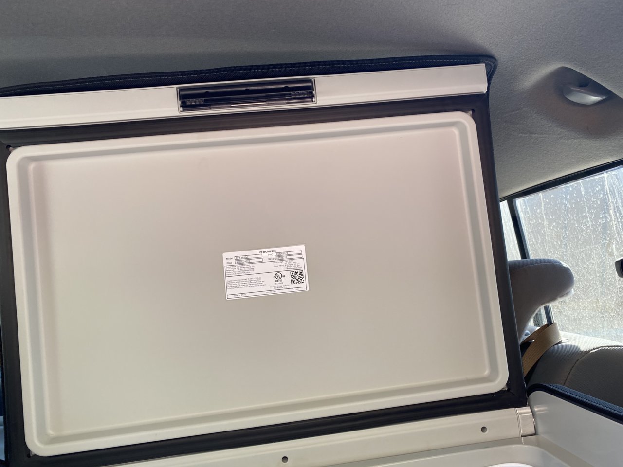

    The temp setup of the fridge is meh. It didn’t fit happily with the seat just folded down so I pulled the lower section that flips forward. @Naveronski sitting on the seat back with the lower section installed the cover on the lid just barely grazes the roof.
    After pulling the lower section it’s at an angle that doesn’t allow the driver’s seat to sit in my preferred position. The front is lower and the back sits higher causing the lid to rub the roof when it’s opened.
    I will likely build a platform using the hinges from the seat bottom with spacers lifting it up a bit to keep the storage space usable. Also pulling the storage bin from the rear wall should help.

    Using the seat hinge/mount from the seat bottom will be a good plan :thumbsup:

    That’s what I have now.

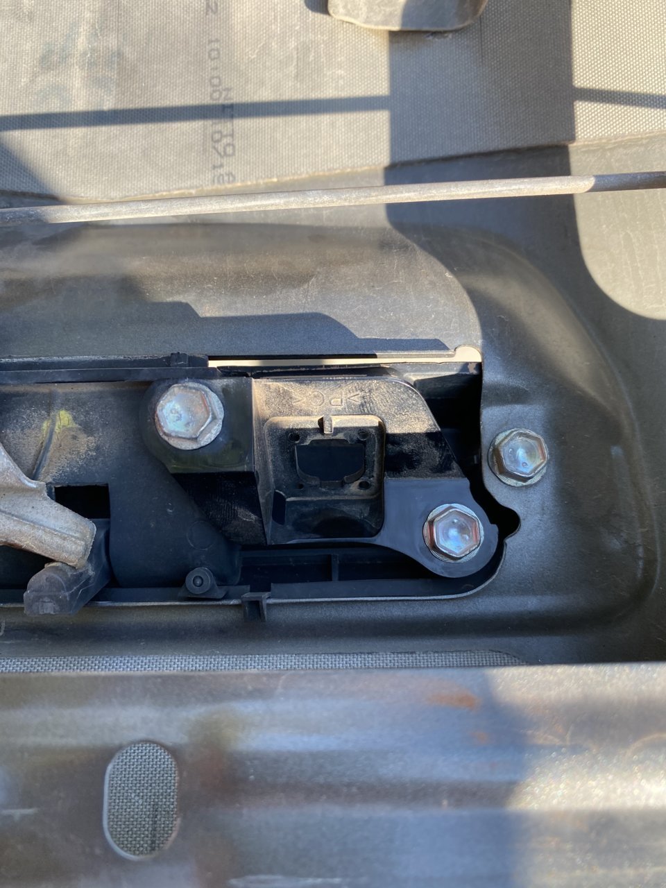

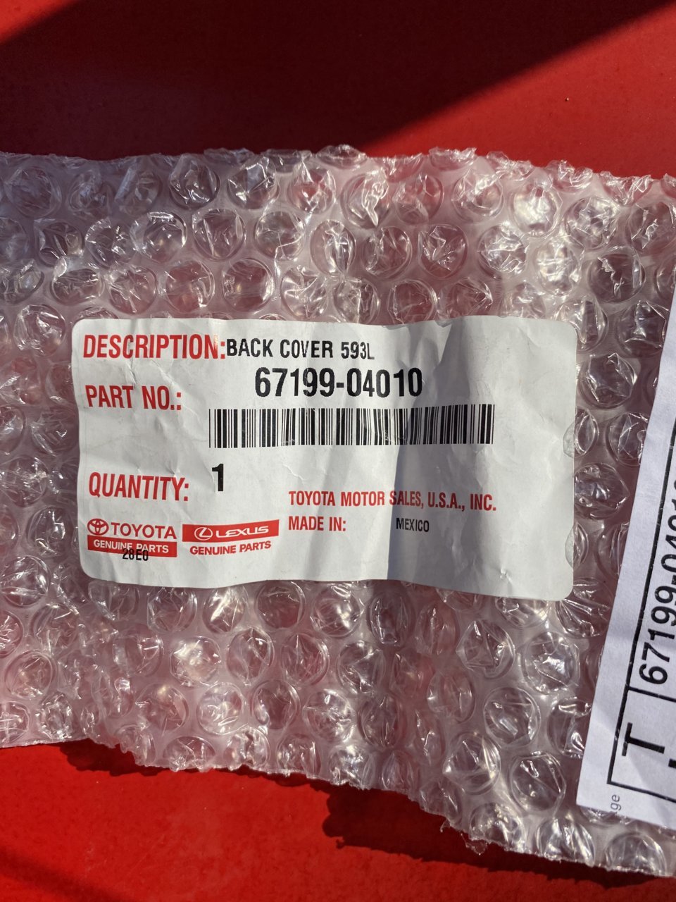

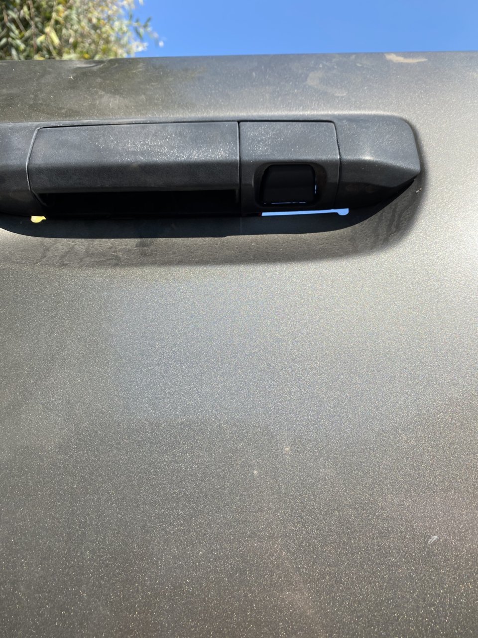

    Spent a bit of the afternoon changing out the rear camera mount in the tailgate with a blank plate and replacing some poorly installed rivnuts for the tailgate.
    The old
    B4167BB2-D2E9-49EF-892E-19D01C2F8AEC.jpg 7ED10939-2075-4B07-A5FA-DCBC022AA4E4.jpg
    The new
    3129328A-7E20-41DA-A051-84FA4DF1FB1E.jpg 51BE2799-B19B-439C-9EF3-B8BB07B064C5.jpg 404F4CF1-C6AD-45C7-9550-43E7D56C944E.jpg
    Hopefully it will cut down on water and dust intrusion to the inside of the tailgate. The part number for anyone else that’s interested is 67199-04010.
