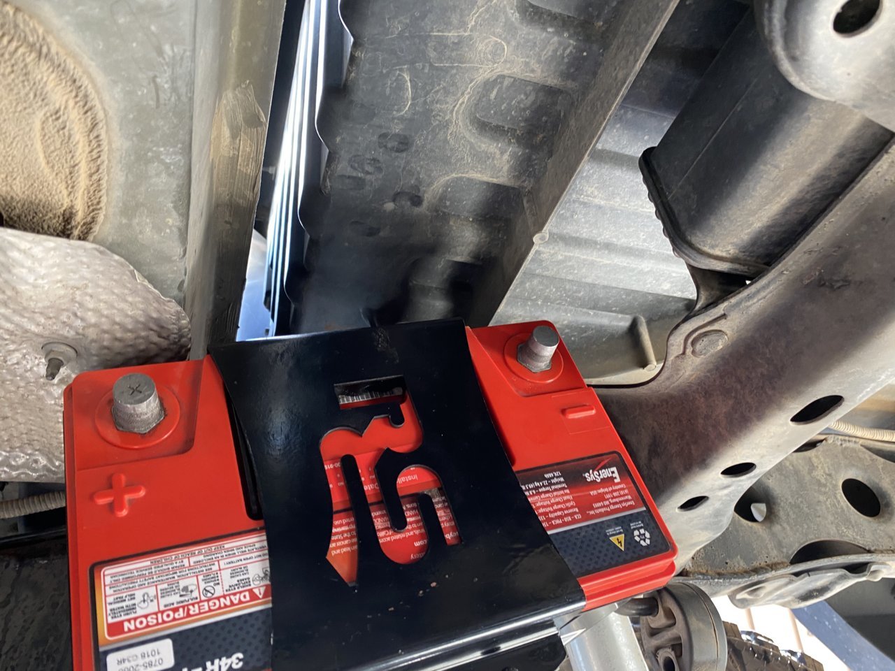

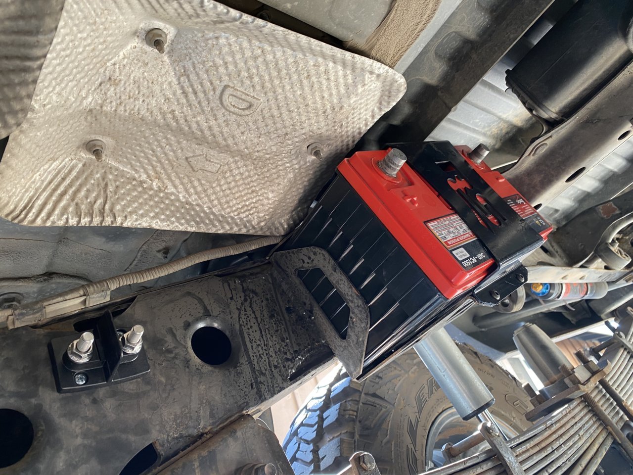

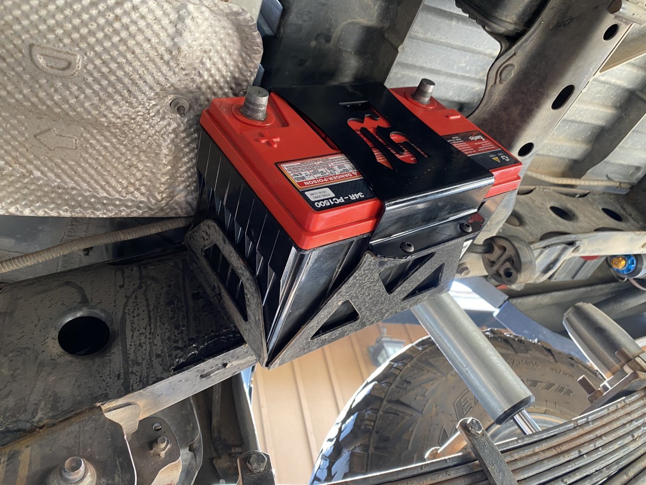

    Did some work on the battery relocate today
    Got the Odyssey 34R-PC1500 into the Ruffstuff Specialties battery box on the passenger side frame under the bed. First mounted it with the words up but didn't like the position of the terminals so flipped it.
    0AE44B26-2D18-46BF-9C47-2C4BD6500E13.jpg A47FD001-E7AC-41CA-AEF4-6D77FD811E2B.jpg
    Bolted the Blue Sea Systems Dual Power Post to the frame boxing plates just forward of the battery.979BA792-7628-480E-AD7C-8B0AB00D74C7.jpg
    The cheap set of battery terminal wires I got at the Vatozone wouldn't properly secure to the negative terminal so I abandoned that plan. The optional ground wire from the @SDHQ OFFROAD Billet Battery Terminal Upgrade Kit was too short to reach between the two so that will get used else where.
    E3654697-1458-4909-A65F-79A1A5BBFD5E.jpg A08FA133-DFD2-4DF3-9034-87235626BF30.jpg

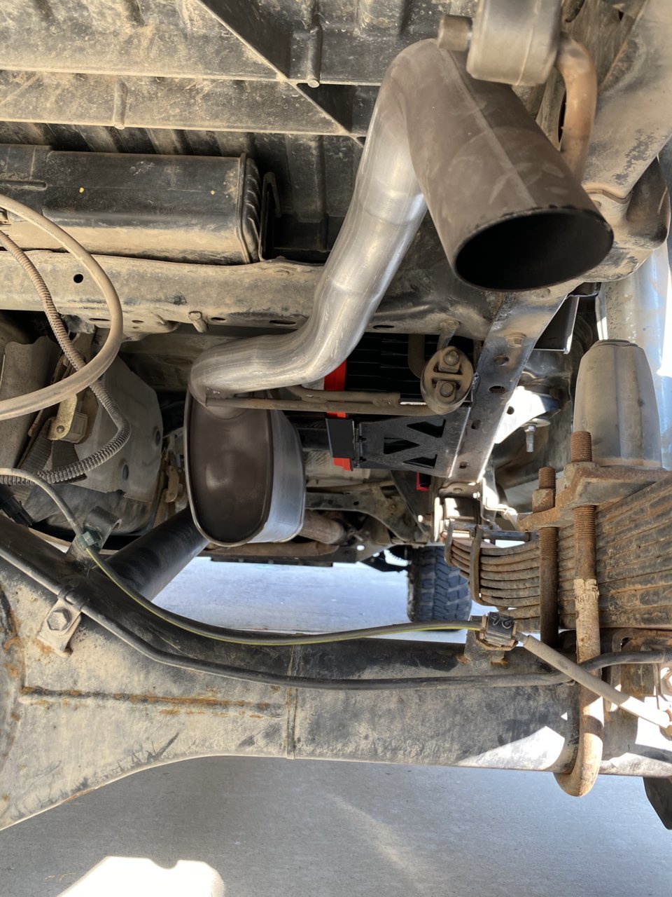

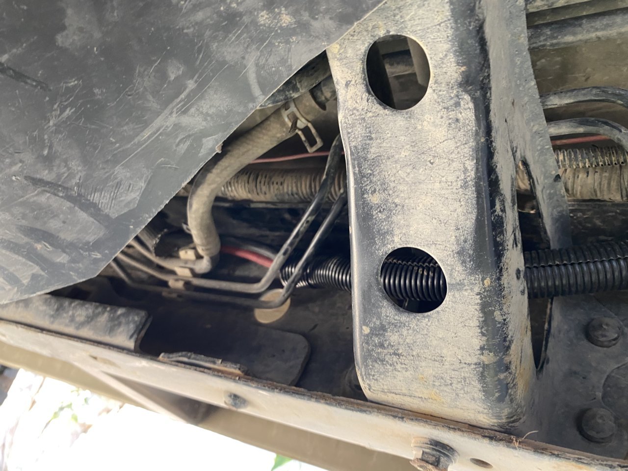

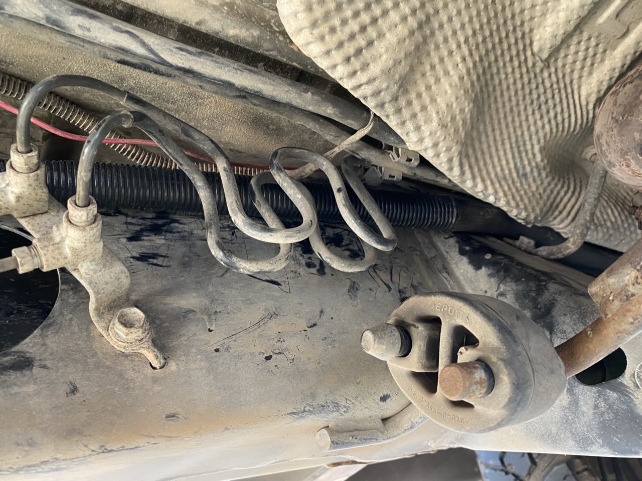

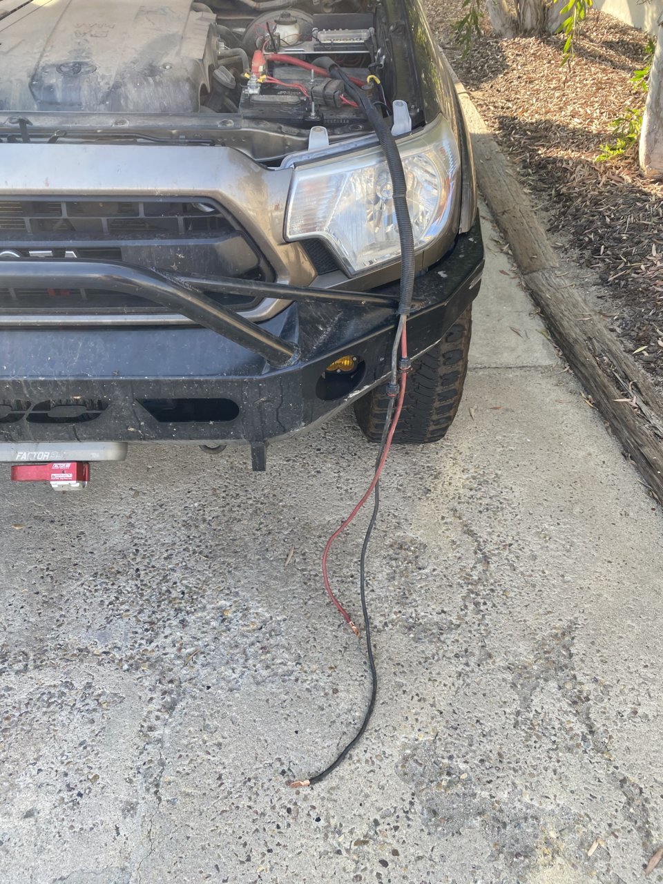

    I routed the extended battery harness I got from @MountainBikeRdr through the crossmember over the gas tank and then along the inside of the driver's side frame rail. It's about 5 feet longer than I need it to be so I will use the extra to go between the terminal lugs and the PowerPost.
    55833EF0-F394-4D97-8009-8911453EA20B.jpg 5C6F763C-8AB9-4A4A-8FEA-11BC4607004A.jpg 7A87461F-E619-4C35-9FBC-7EB767A599AB.jpg 94D36A8D-3550-4399-88AD-6D71848E918E.jpg
    I still need to figure out exactly what I'll use in the stock battery location to connect into the stock setup but likely another Dual PowerPost.

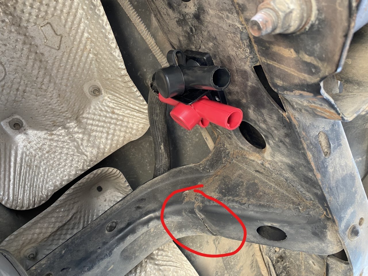

    desertjunkie760
    desertjunkie760 @DesertJunkie760 (IG)
    Apr 11, 2016
    #183963
    9,140
    Shane
    2011 MGM DCSB TRD Sport 4x4
    Check My Sig.
    What is that? o_O
  5. Oct 12, 2020 at 8:49 AM
    #525
    hoarder23
    hoarder23 [OP] Truck fell over
    Aug 14, 2012
    #84787
    12,866
    Shay
    NJ
    15 Pyrite Mica DCSB Sport
    Scratches
    Normal, that crossmember is two pieces of metal and the weld is on the inside.

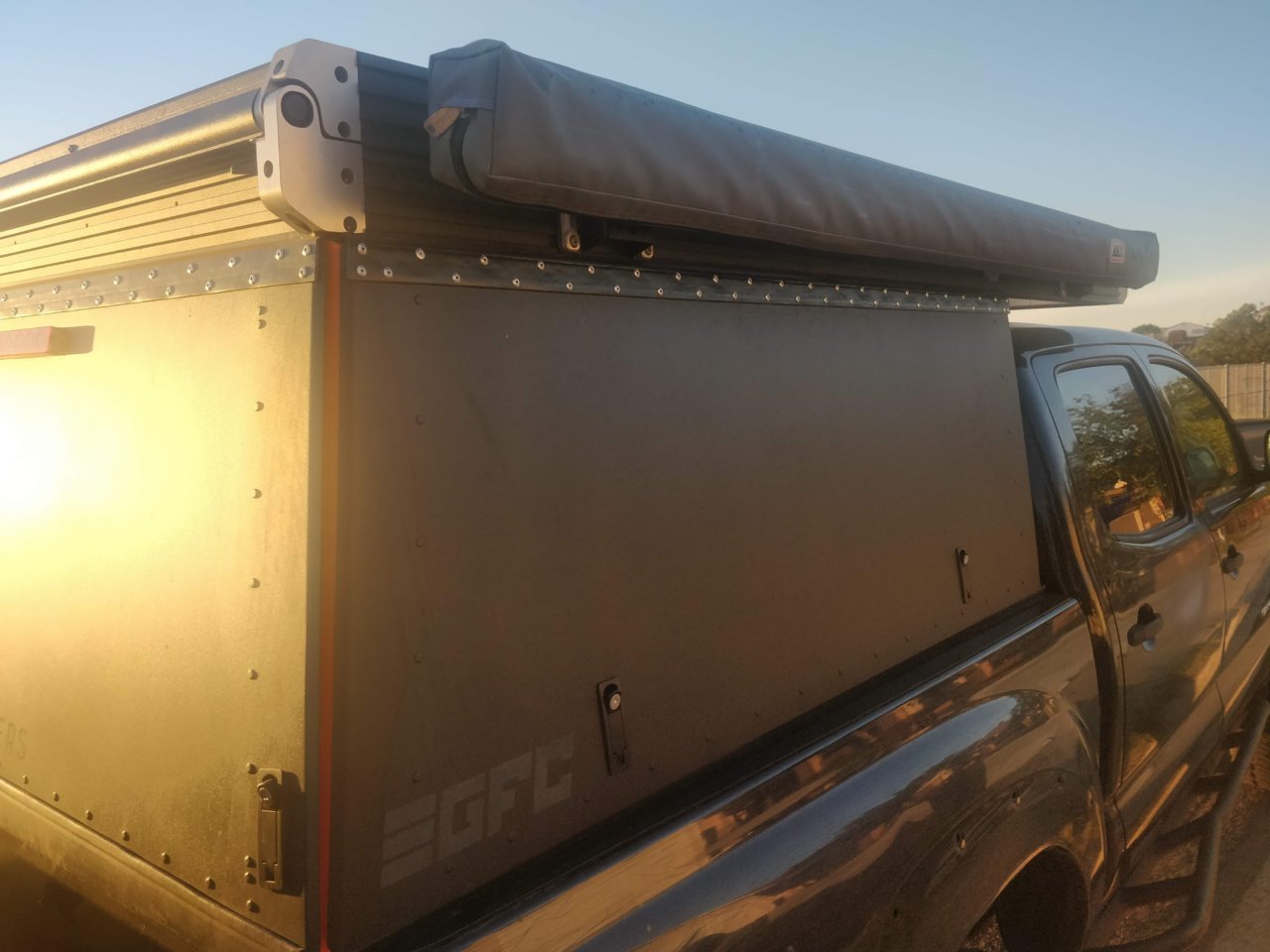

    So it doesn't look like I'll be able to source the @RelentlessFab Bed Rail Caps they make for @Iggy at Vagabond before it's time to move the camper over, so I'll be recoating the KB Doodoo steel caps I currently have on the black truck. Trying to decide on a color for the rails, Baron Red to match the swingouts? Matte Black to be boring? Blaze Orange to match the GFC frame? Something cooler? The bronze didn't match well enough on the sliders to use it for the rails.

    If it will be visible around the GFC, orange to match the GFC.
  8. Oct 27, 2020 at 5:17 PM
    #528
    cwadej
    cwadej Ballerina Award winner
    Feb 23, 2018
    #245352
    1,234
    Right Here
    2011 Access Cab 4x4
    and if not, red to match swingouts
  9. Oct 27, 2020 at 5:18 PM
    #529
    hoarder23
    Aug 14, 2012
    #84787
    12,866
    Shay
    NJ
    Scratches
    You can see the outside edge with the camper mounted. So it would match the little bit of orange frame that pops out. It was a plan if I had kept the black truck. EEA89E17-7224-48DF-8C86-BB7C28DCD16B.jpg
