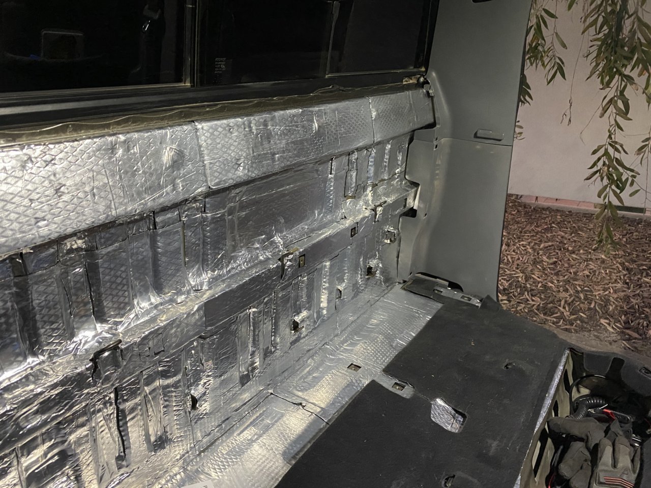

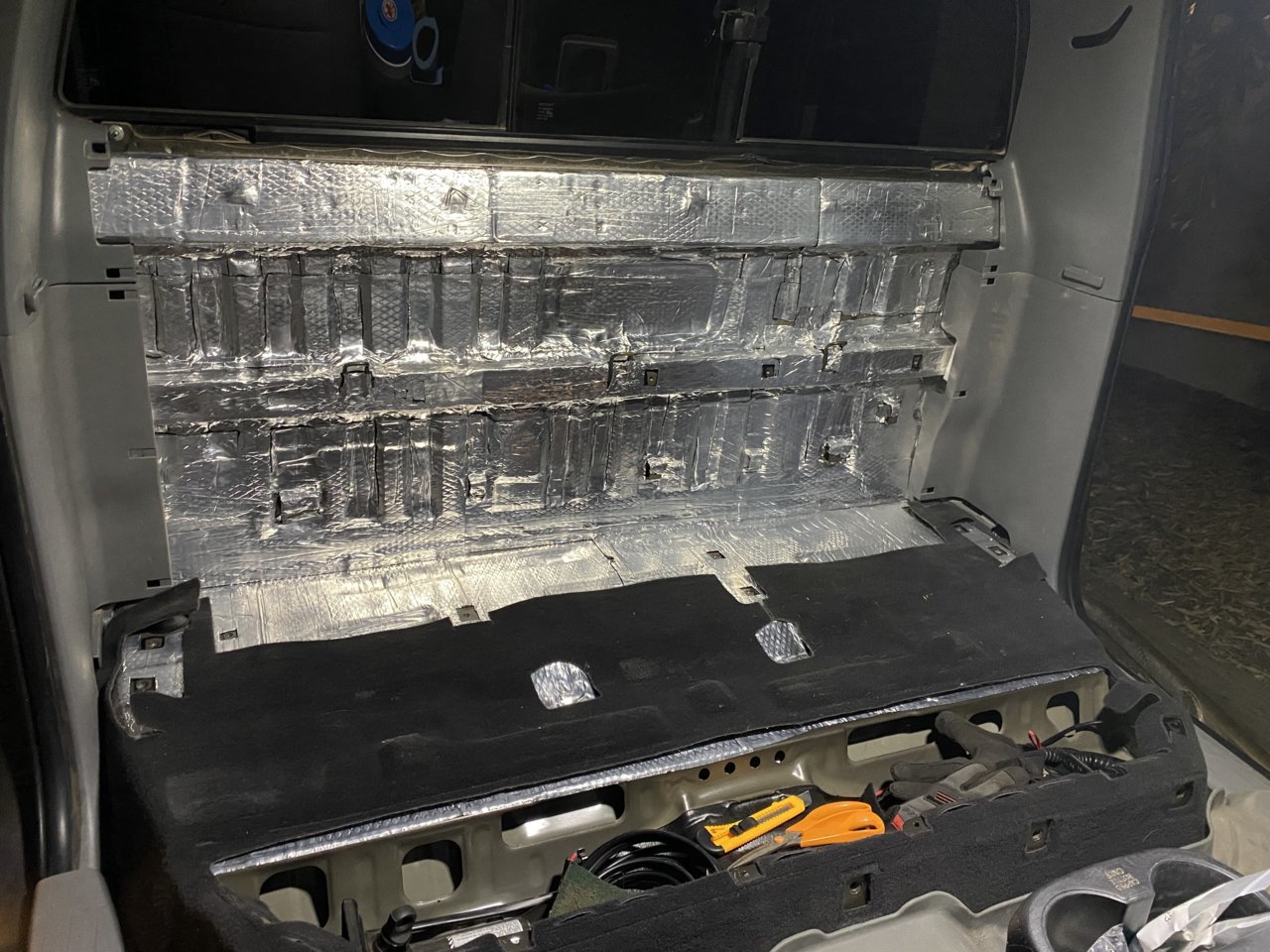

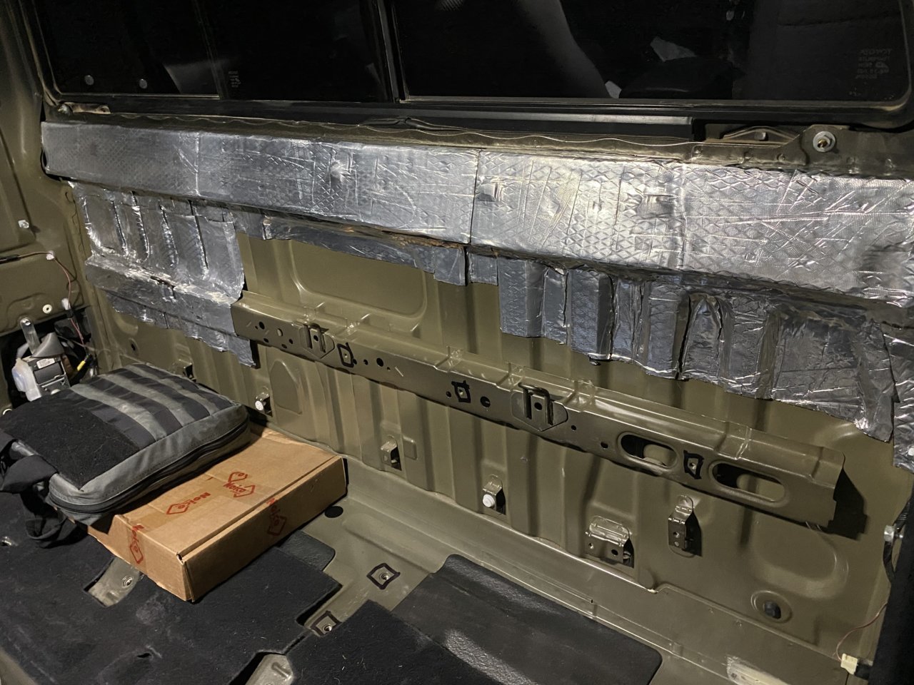

    I wish someone had told me how awful installing this stuff is. Goose Gear Back Seat delete is here and some missing hardware bits show up tomorrow so no more slacking. I took care of the back wall panels from the kit which was simple but the truck is a bit more complicated. FE0723F0-0713-45C4-9301-9A191C5D6EAE.jpg

    What makes it so awful?

    I’m talking about the sound deadening material, trying to form foil-backed used bubble gum into the less than flat surface that is the cab of a Tacoma is not my idea of a good time. But no seats means it’s very noisy so it has to be done.

    Yeah I knew you meant the sound deadening. I haven’t used it before, nor have I looked into its install. Always thought it just stuck on with relative ease aside from “fitting” the different shapes. Molding used bubble gum doesn’t sound fun haha.
    I hear you on having to do it with the seat delete though. Good call!

    You are supposed to smash all the little bubbles flat, gonna have to start over.
    Did you remove the stock stuff down to bare metal or just install over it?

    i used an aluminium ice cream scoop mostly, then a friend lent me his rollers, so
    i put this stuff only on metal, so moved the stock stuff. this took hours and hours i might add, like 6-8 each truck (i went up C pillars and filled in around seatbelt with rolled up bits of foam - an old sleeping mat - and as far forward as the under seat cubbies)
    i want to do the rear window, and at least the rear part of the roof, but maybe later...

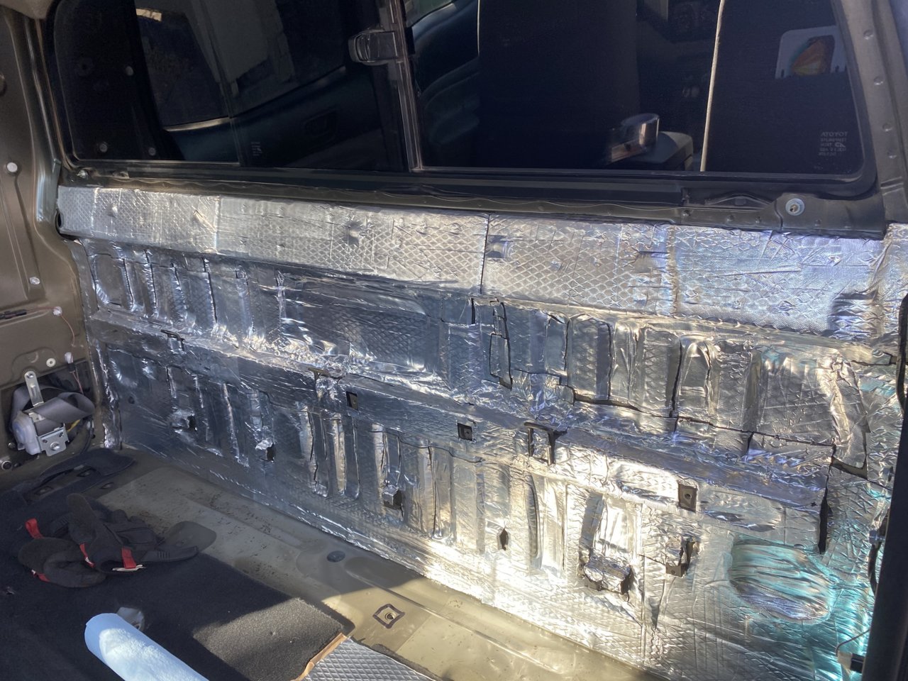

    Back wall done, now to move onto the floor, hopefully it’s easier since it’s less complicated. The missing hardware arrived so I’d like to get everything finished up today

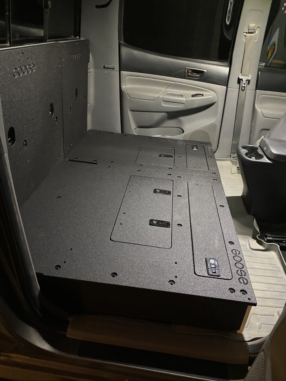

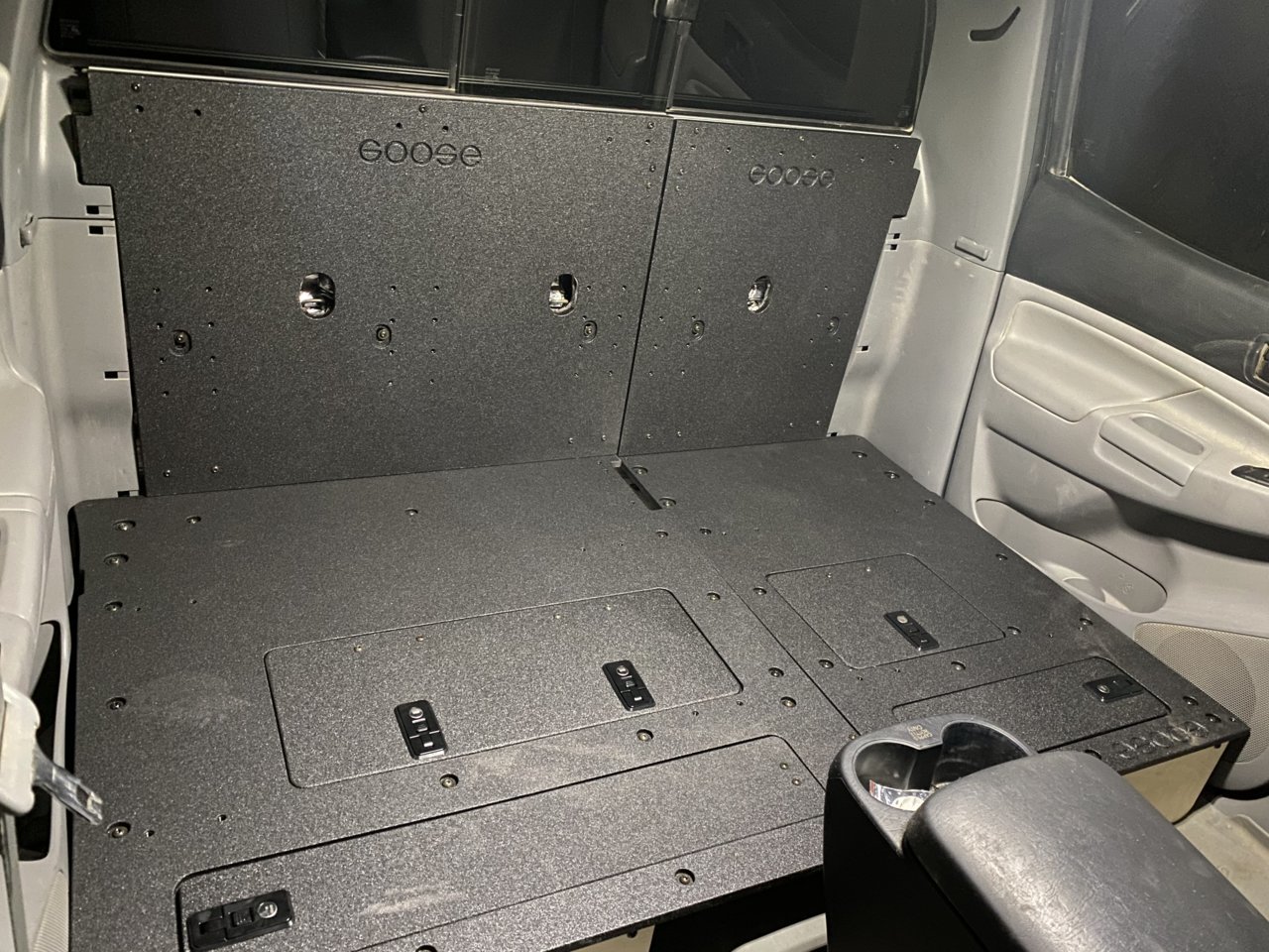

    Finished up the install of the Goose Gear Back Seat Delete. The installation of the sound deadening was no fun but hopefully it will make a difference since there won’t be thick seats to soak up road and exhaust noise.
    B46D81E7-9629-466D-8506-062060DB382B.jpg A7AB736D-7848-459F-BBFB-332B386B3392.jpg
    Now that it’s in I’ll need to figure out how to keep Belle secure but also able to wander around, how to secure the fridge and where all my stuff needs to be stashed in the different setup
