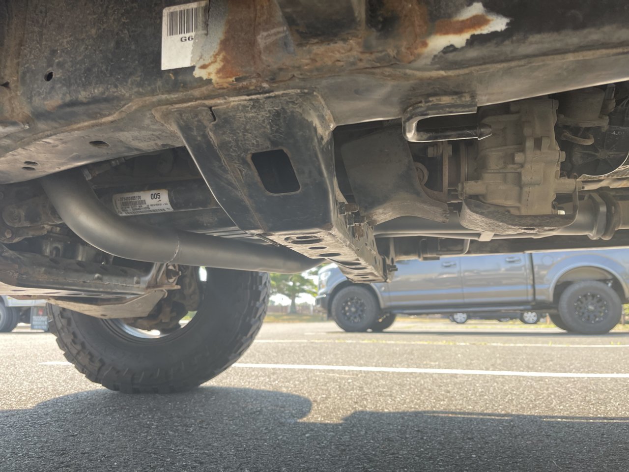

    Got the truck put back together after a week of letting things dry out while riding dirty
    6FC290BD-57B8-48B5-B30B-F9AC25FB214B.jpg DF8D2C2D-99ED-4200-9CD2-0E1578C57866.jpg

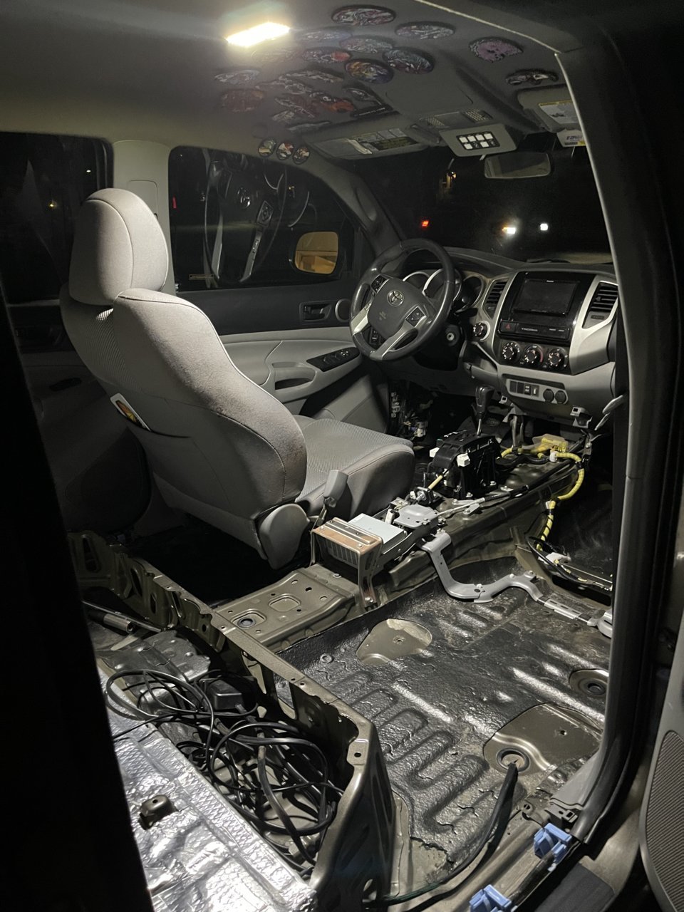

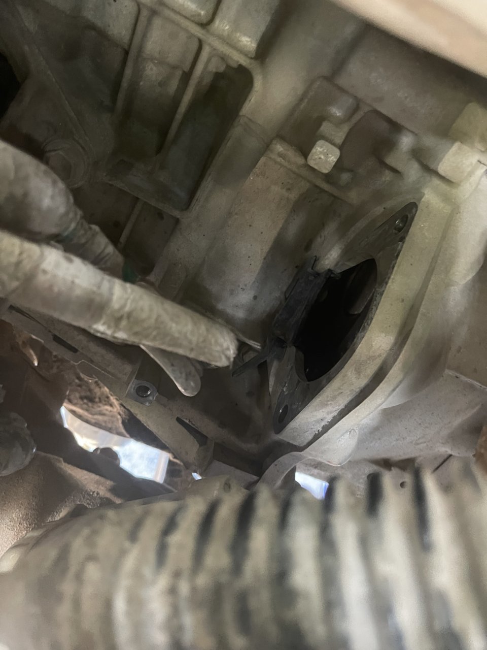

    Now the starter is giving me issues, amazingly they don’t like being underwater. Tried to pull it out last night but apparently I don’t have the skills to make that happen. The intermediate shaft wouldn’t separate and I wasn’t about to try to pull the header.
    5F8428F8-3081-4EA9-AFC4-0FC3B773A238.jpg 6077FC8C-1436-4DBA-95CC-3561F1A50454.jpg 08C53518-6ACF-4195-B195-44BAE4ED3330.jpg

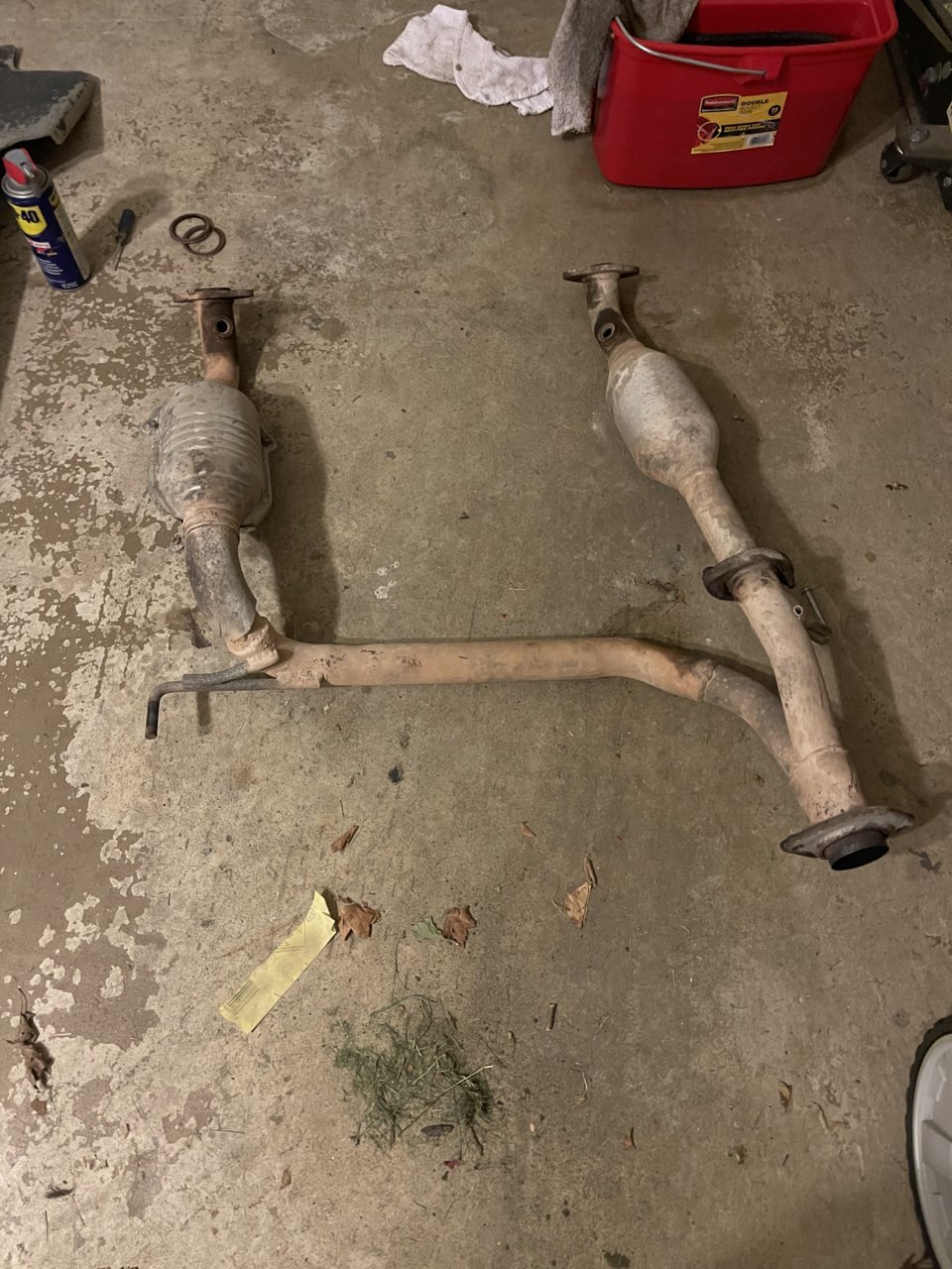

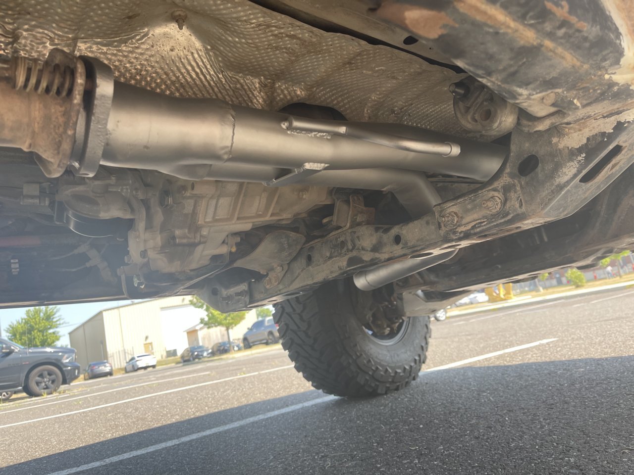

    So I didn’t take a full L I installed the URD Y pipe I got months ago from @Hawk373 It’s a much nicer setup than the chopped up OEM one it replaced.
    0E095499-41D1-41D6-B83A-E598DBAC885A.jpg 03C20C92-52A6-45A5-A03F-A5EA1384793F.jpg
    If anyone got their cats stolen or needs a reroute the OEM one is in good shape and needs a new home.

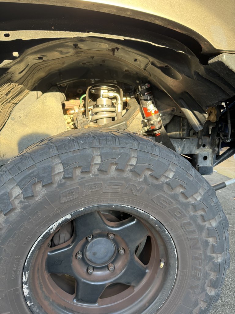

    Ordered Fox PES from @AccuTune Offroad and got tracking today, this will replace a rusty set that desperately needs an overhaul.
    Ordered some 5125s to hold it down while I send the rears in for rebuild.
    I need to figure out a new head unit, the current one randomly restarts and won’t auto connect to CarPlay because of a firmware issue that Pioneer won’t fix.
    With the fronts, I’ll also change out the tie rods and CVs, then an alignment and I’ll get some new tires to replace the current burned up set.

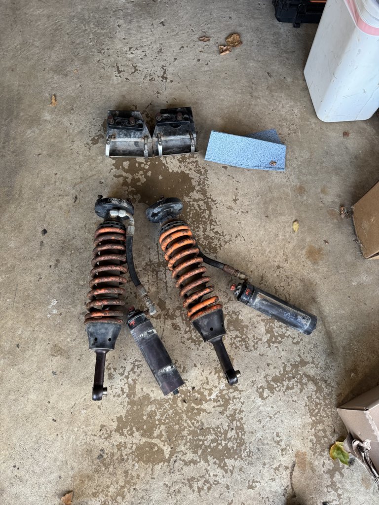

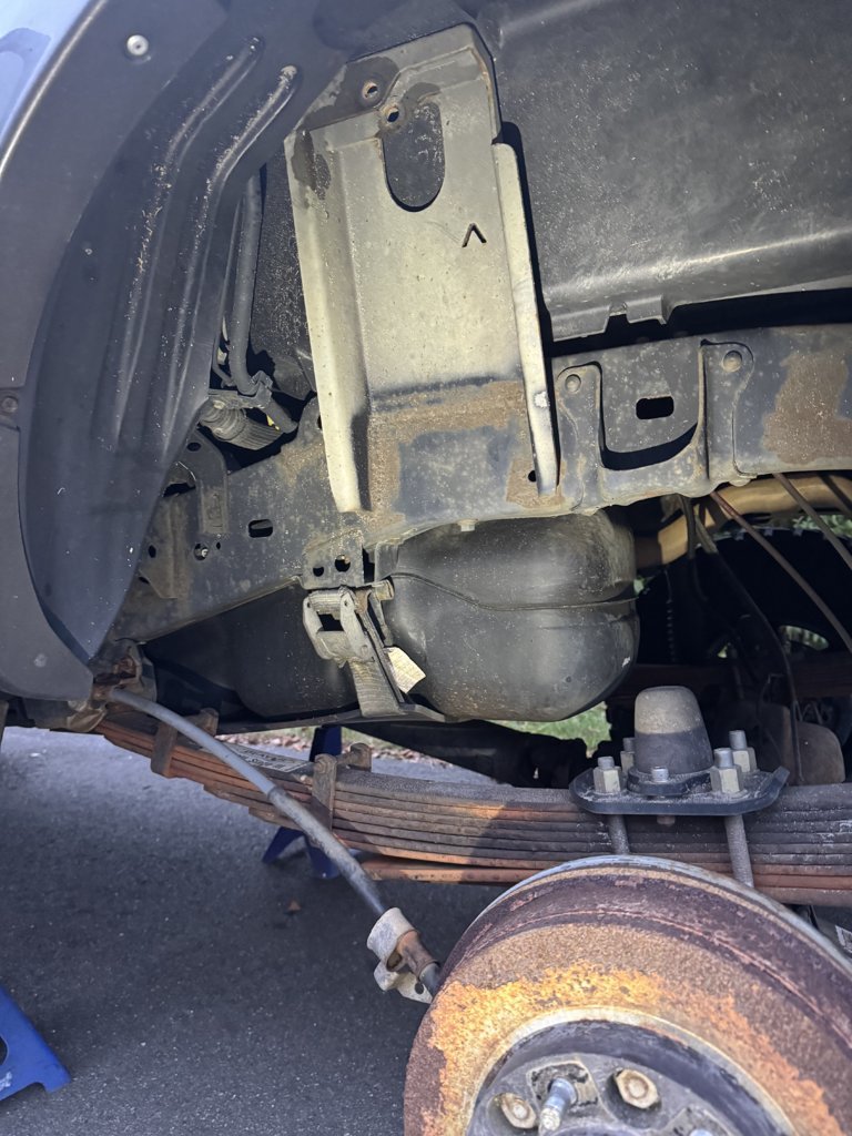

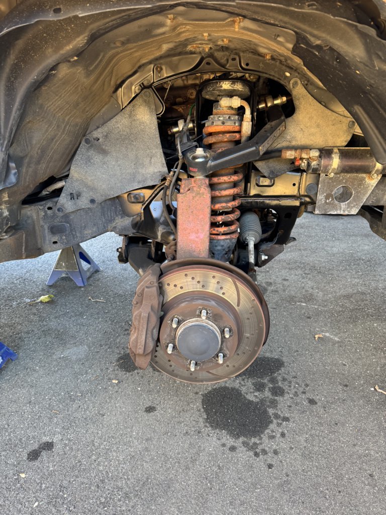

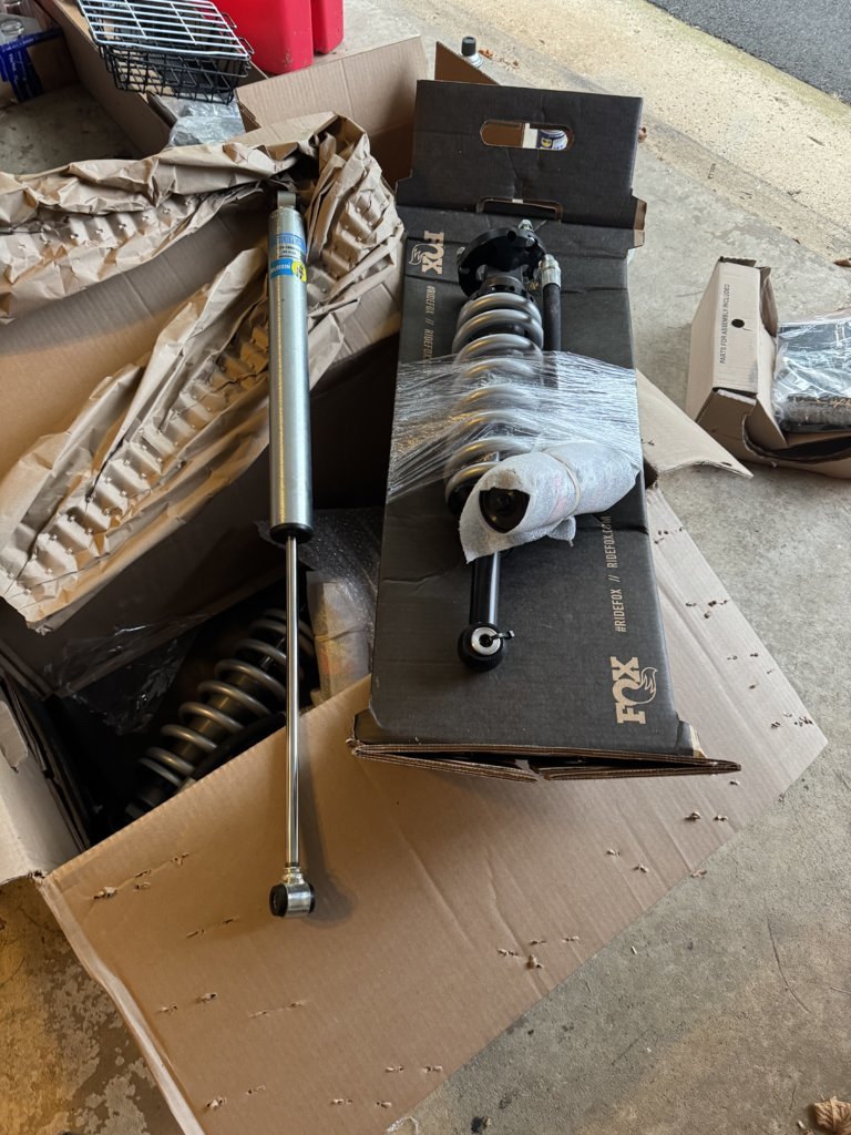

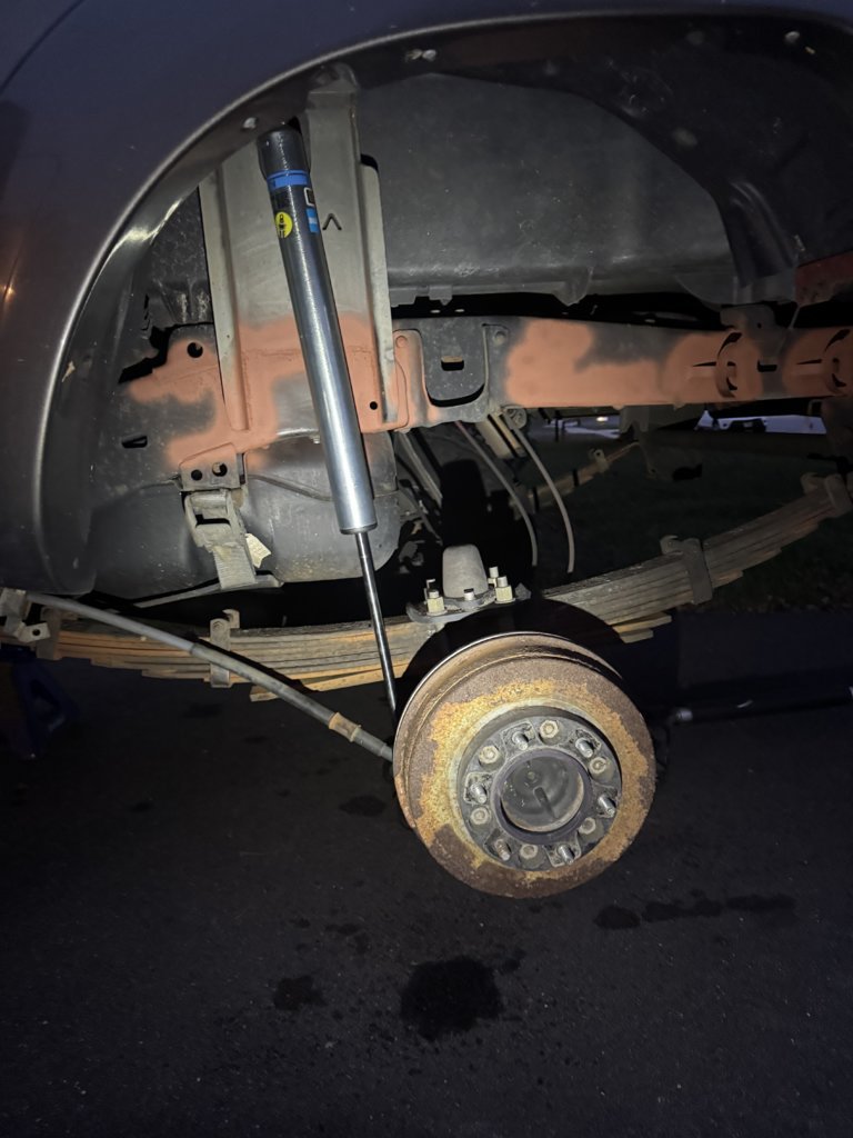

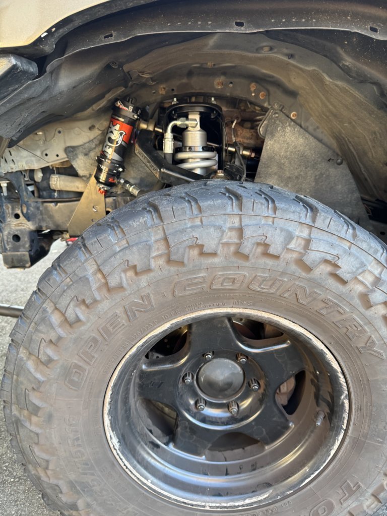

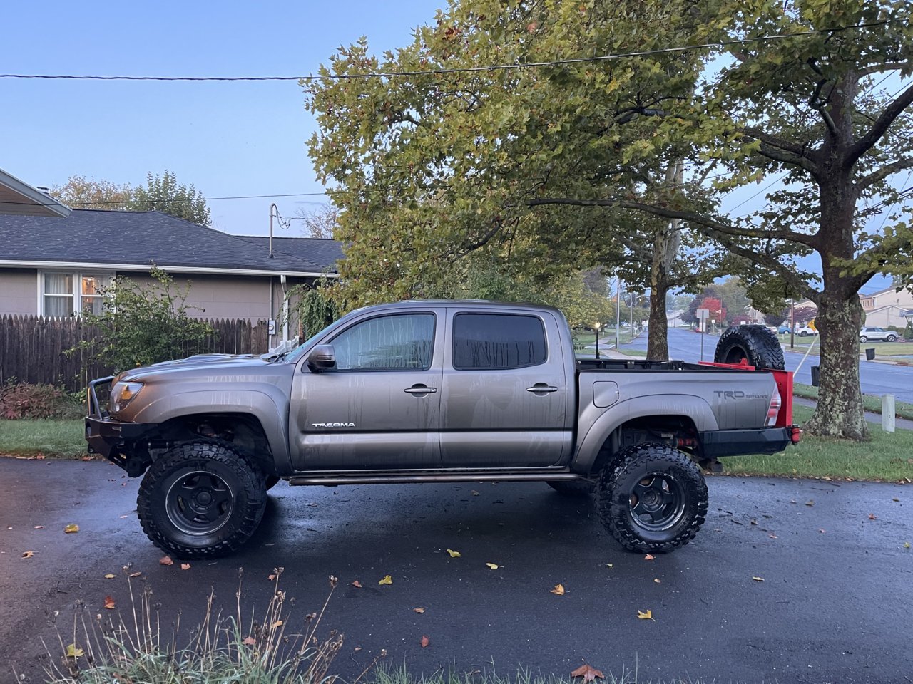

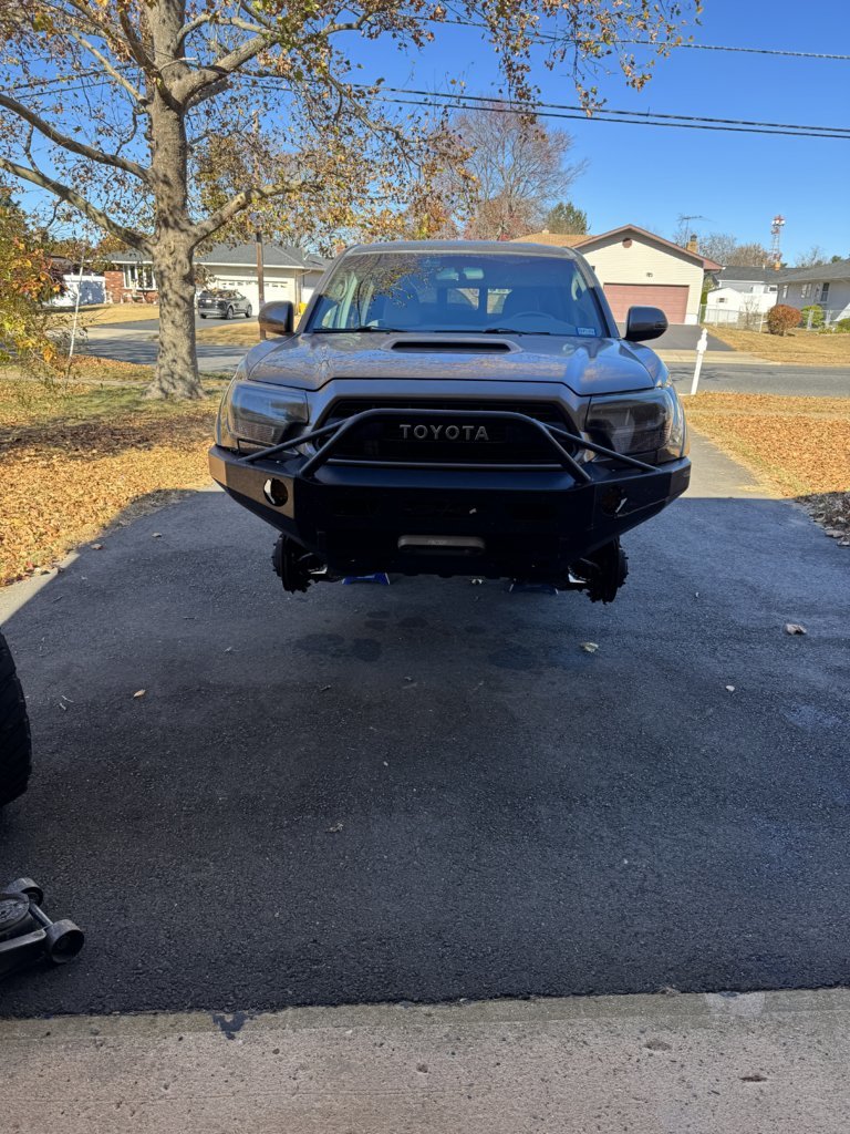

    Changed out the rears a few weeks ago to get them rebuilt.
    The new fronts and the temp rears chilling in the garage
    Prepped on a beautiful New Jersey fall day
    Things are rusty after a few years of neglect
    Old ones out, temps ones ready to drop in
    Cleaned up some rust, threw on some primer and slapped in some long skinny bois
    Some abused shocks ready to get sent to @AccuTune Offroad for some love

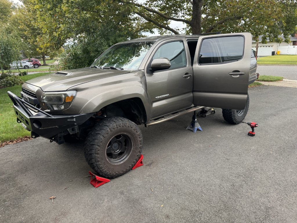

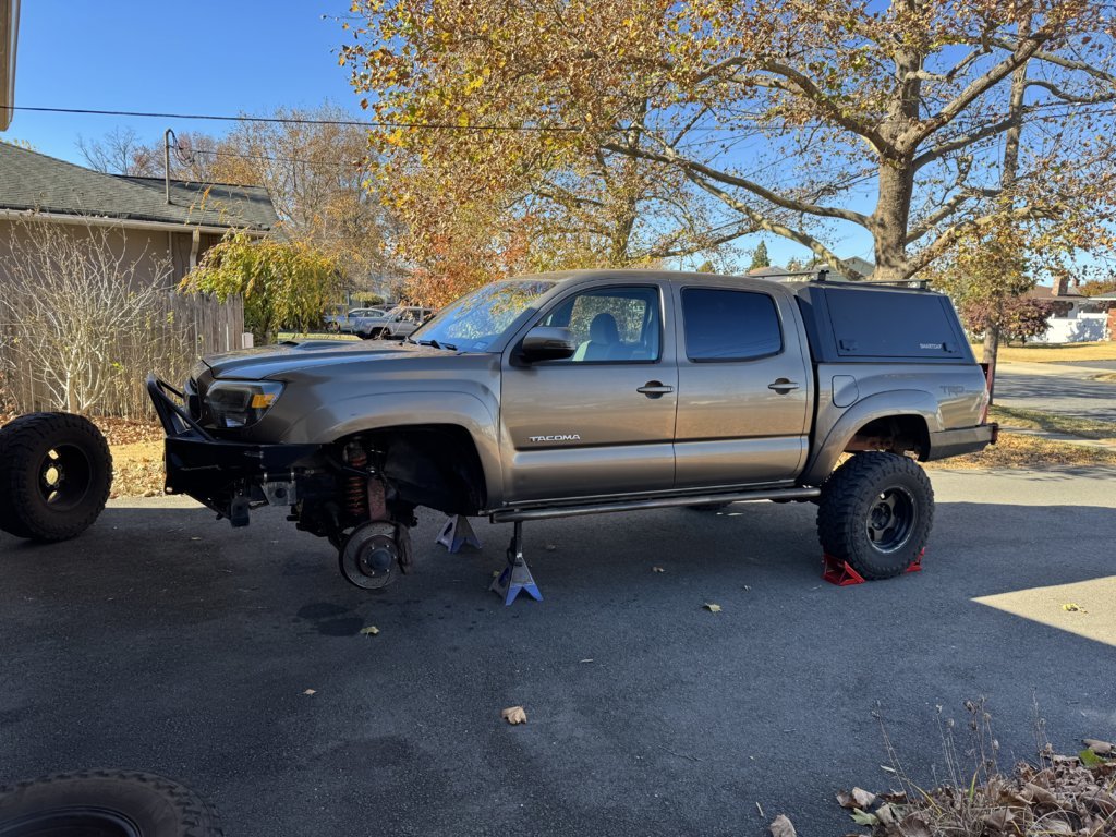

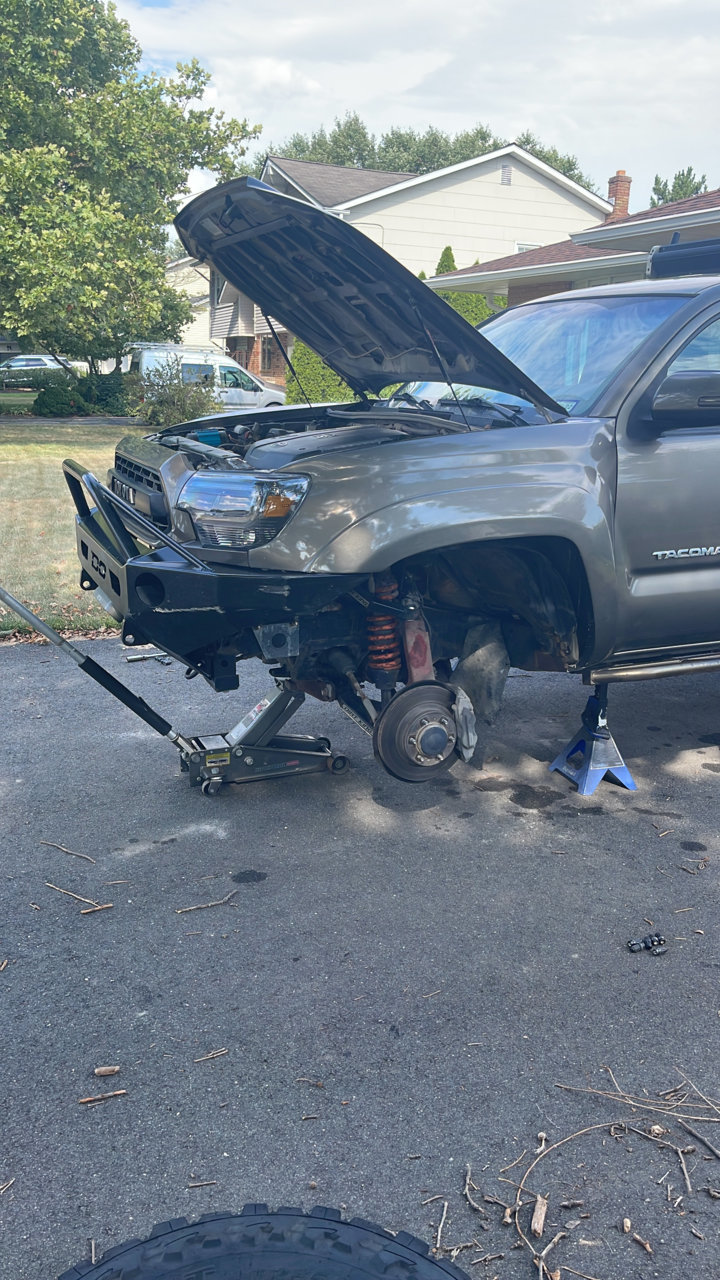

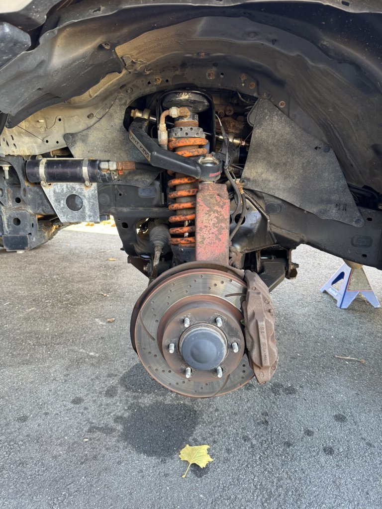

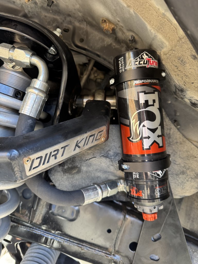

    Ready to swap the new ones in on Saturday

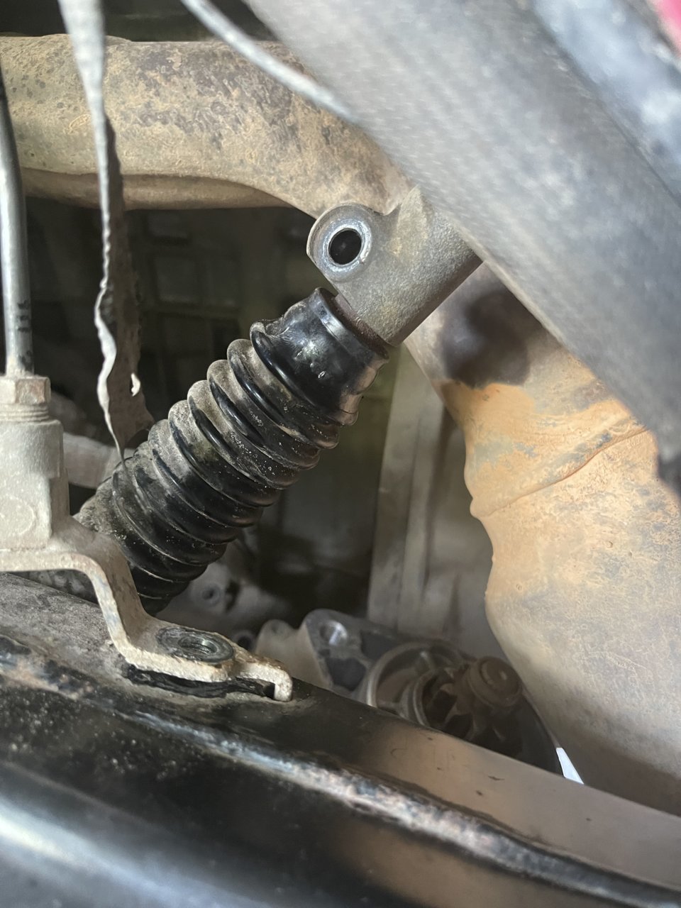

    Everything is rusty and the CVs need new boots, there will be more rehab work IMG_5623.jpg IMG_5624.jpg
    These reservoir brackets for the PES are doodoo, I spent as much time trying to get them right as all the rest IMG_5625.jpg
    I got skunked on day 1 by a lower shock bolt that was seized to the bushing, sprayed lots of penetrant and booked the lift at work today. Once it was in the air and the penetrant had two days to creep it only took one swing of the hammer and brought it back home to finish in the driveway

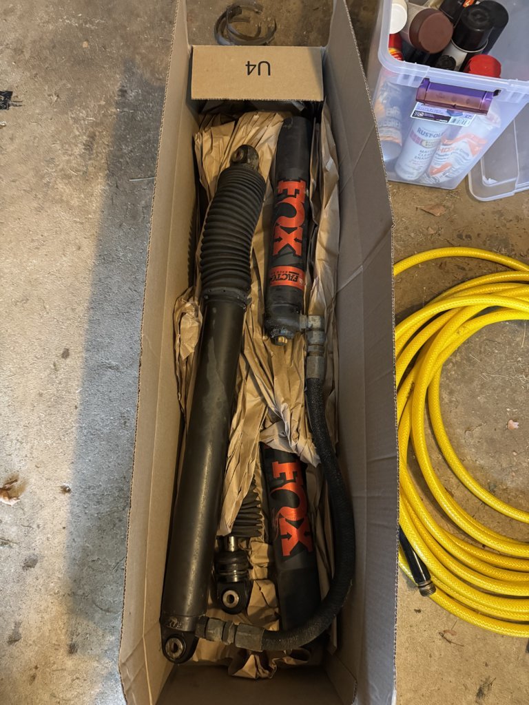

    Rears came back from Accutune yesterday so that will be next weekends project. And the fronts will get sent out for rebuild.

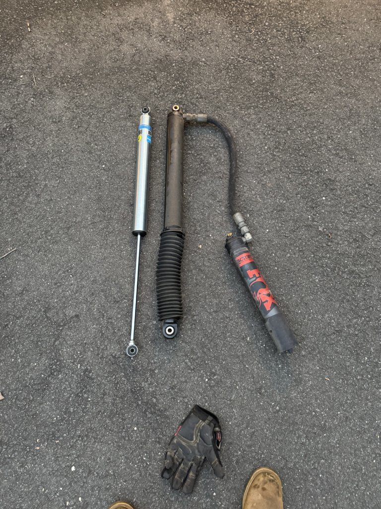

    What rear Bilsteins are these?
    Also, did you know @AShive92 can rebuild suspension? He's just down the road from you in PA
    AShive92 likes this.
  19. Nov 12, 2024 at 8:05 AM
    #699
    hoarder23
    hoarder23 [OP] Truck fell over
    Aug 14, 2012
    #84787
    12,887
    Shay
    NJ
    15 Pyrite Mica DCSB Sport

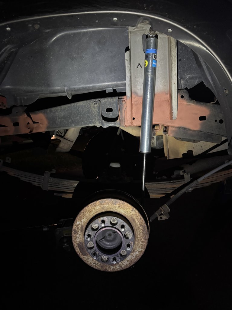

    Scratches
    They are 5125 series p/n 33-185576, 14" travel. Great option for those with a relocate just for looks, rode well on the pavement and were only $161 for one new one used from Amazon.
    @AShive92 are you up to date on your tetanus shot? wanna take a crack at these? These need be rebuilt to sell, so saving shipping would be nice.
