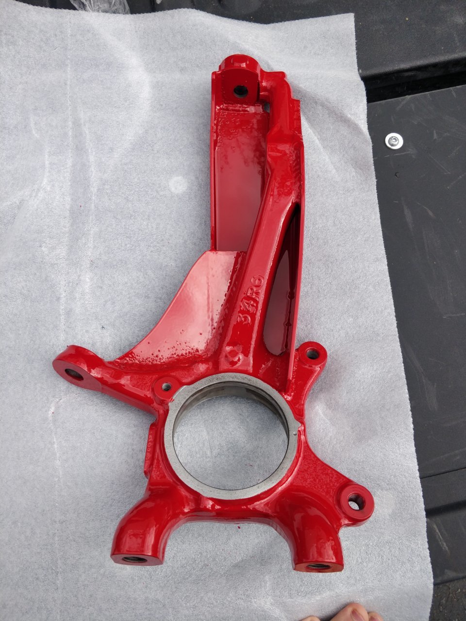

    Scratches
  11. Apr 17, 2020 at 5:35 PM
    #151
    Naveronski
    Naveronski Well-Known Member
    Sep 14, 2013
    #112501
    9,506
    Fort Worth
    2014 MGM DCSB TRD:OR
    Looks like the spindles were properly masked. I wish mine had been.

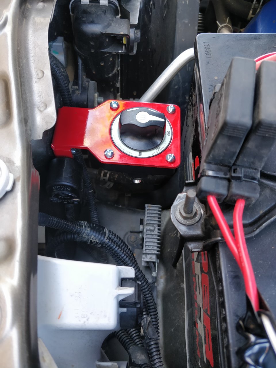

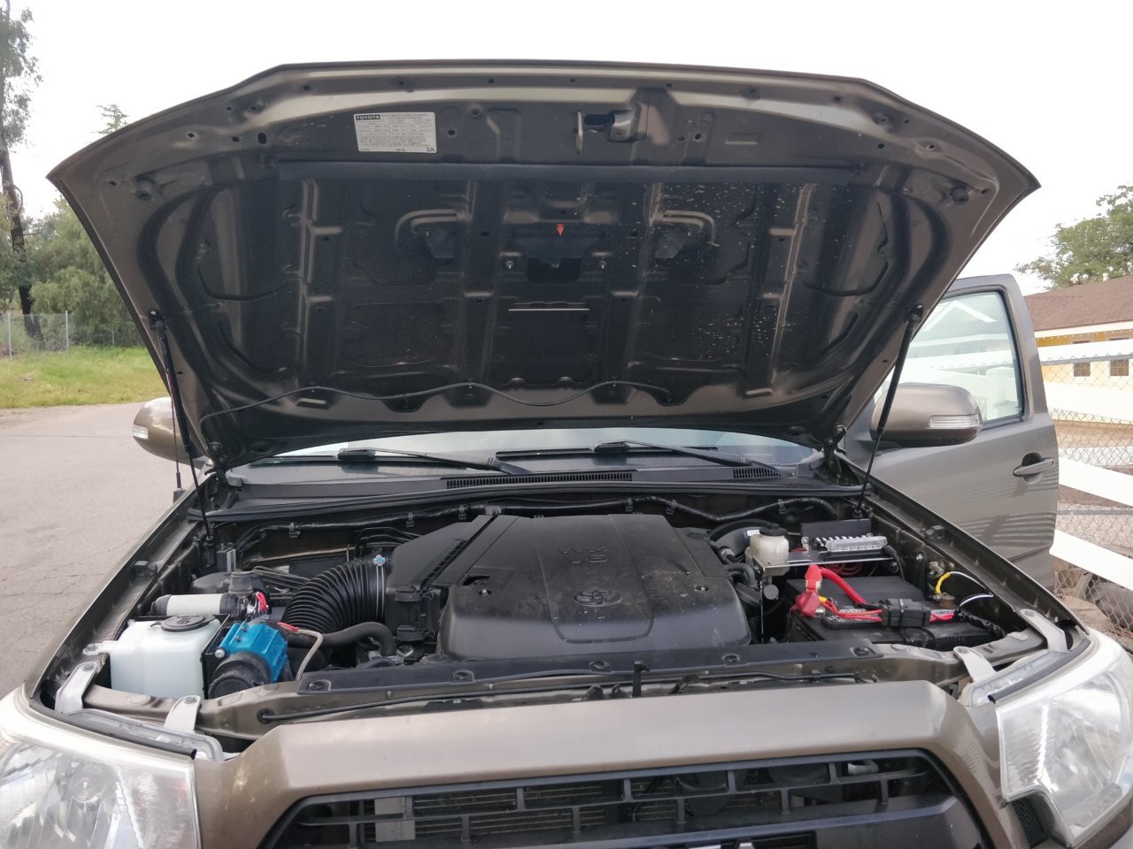

    Today was a productive day.

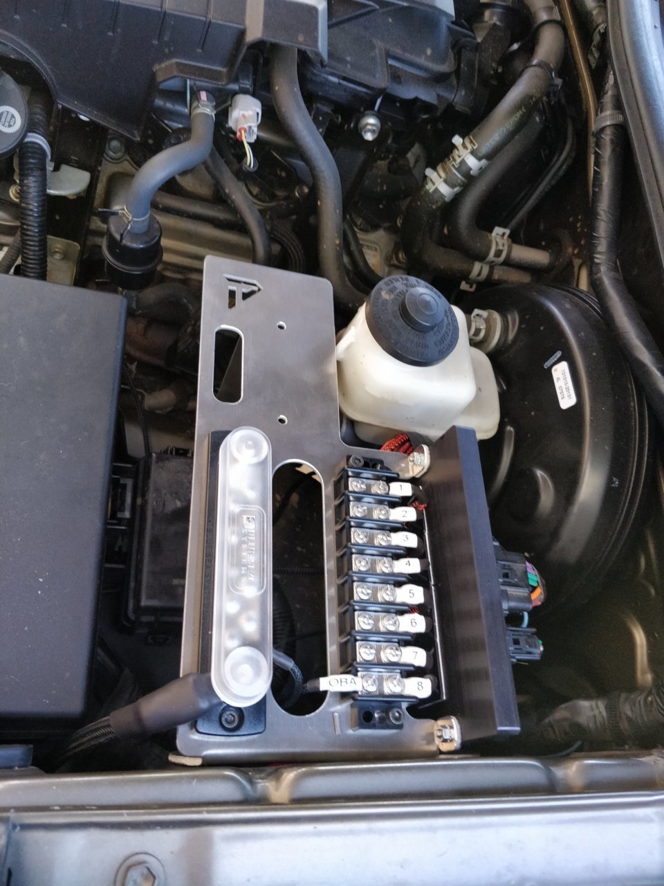

    @AY_ARONTRD got the Switch-Pros SP9100 installed using a Powertrays mount from @Mr.PowerTrays and I mounted the touchpanel in the overhead console using a mount from @MESO IMG_20200426_132850.jpg IMG_20200426_143243.jpg IMG_20200426_143326.jpg IMG_20200426_143336.jpg IMG_20200426_143126.jpg
    The ARB Twin Compressor is finally working, no more stealing air from my friends. Ignore the mess around the battery, that is temporary pending a relocation.
    And I need to start putting on stickers, so far I need one.
    I also got the radio installed, no more Entune. That was a hassle and a half but it seems like it was totally worth it. I'll come back around to that when I finish it. So far it's a Pioneer AVH-W4500NEX, wired using a Maestro idatalink RR and a bunch of other cables. Waiting on some speaker accessories to change out the fronts and the black truck to steal the Sirius Tuner.

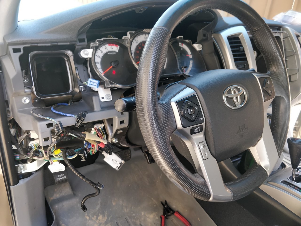

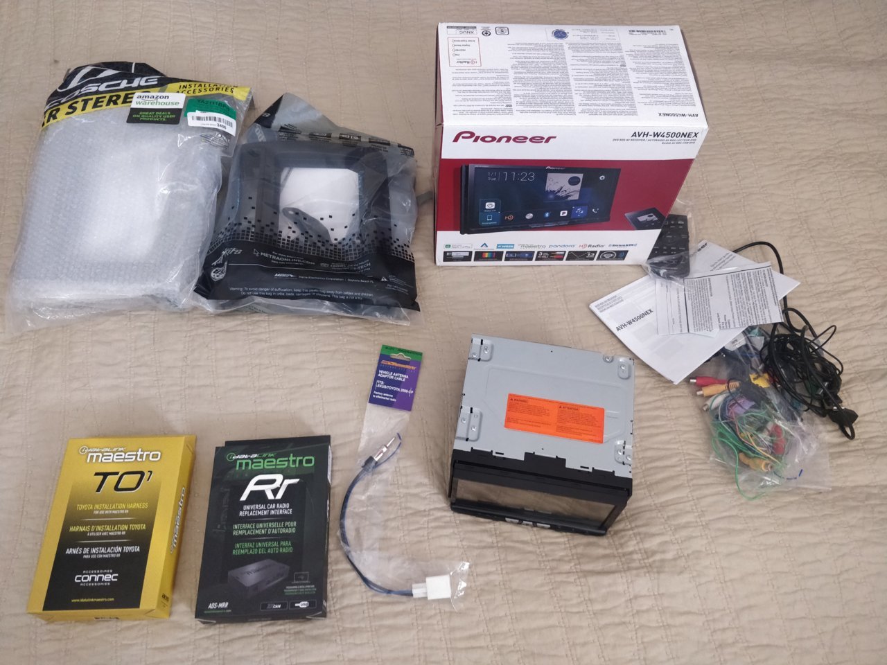

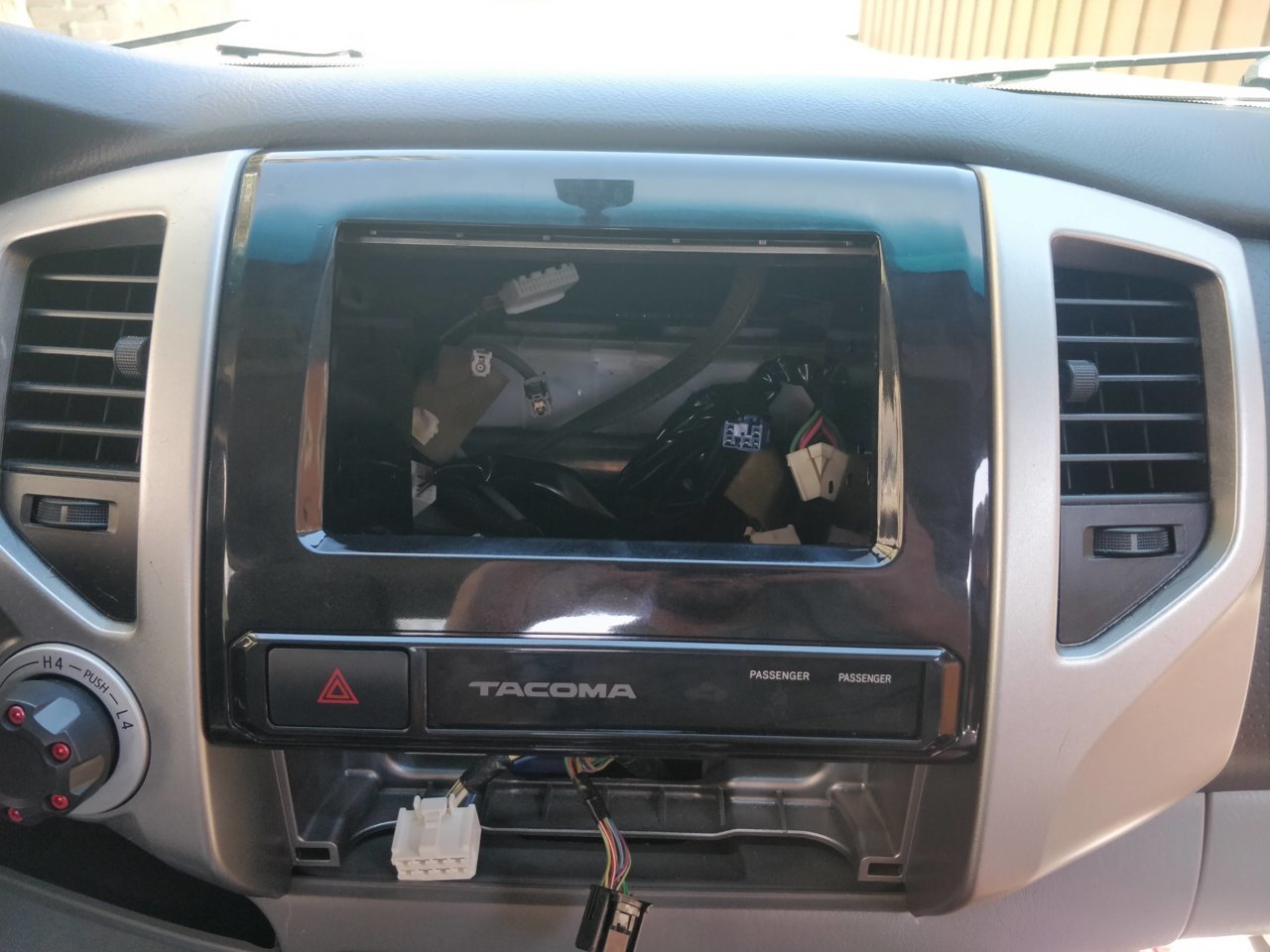

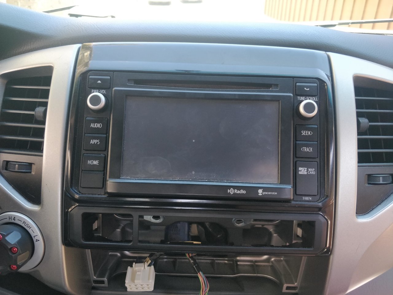

    Some of the prep work for the stereo install
    The pile of parts to make it happen
    I bought both available dash kits after reading reviews here, This is the Scosche unit that I ended up using. It has a very similar finish to the stock bezel in my truck and comes with metal mounting brackets.IMG_20200423_155657.jpg
    The Metra dash kit. It has a matte finish that is similar to the stock hazard light and airbag indicator panel. It comes with plastic mounting brackets.IMG_20200423_155923.jpg

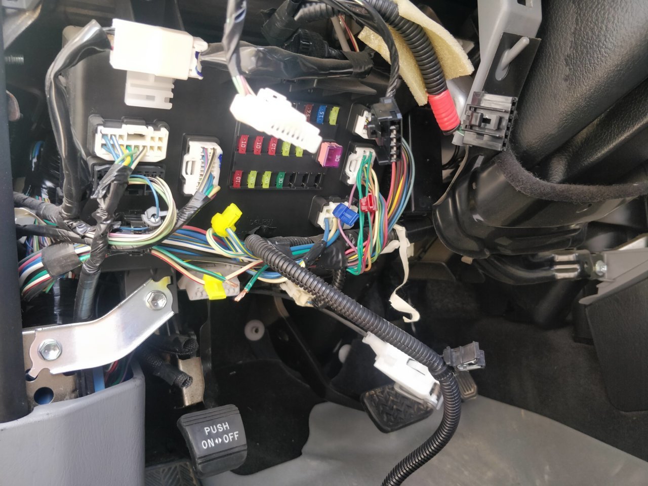

    Ripped out the trash alarm system that the dealer paid some minimum wage tech to install. They tried to charge me like $1,500 for it. I should have charged them to repair the wiring they tapped into.
    Soldering the idatalink Maestro harness to the radio harness. Massive pain in the ass and @AY_ARONTRD had to help me finish it. But it works great and integrates the steering wheel controls, an OBDII sensor and several other inputs quite nicely.IMG_20200425_205340.jpg

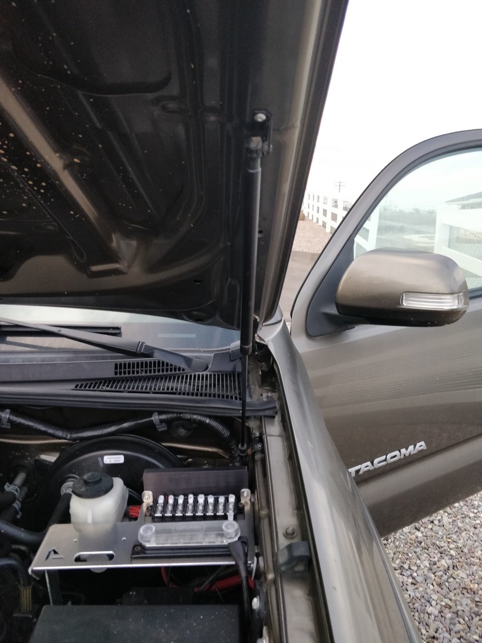

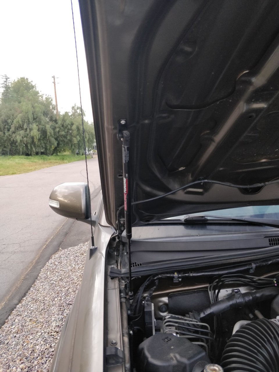

    Bought a rivet gun and installed the @RedlineTuning QuickLIFT PLUS hood struts from the black truck. No more working around a prop rod.
