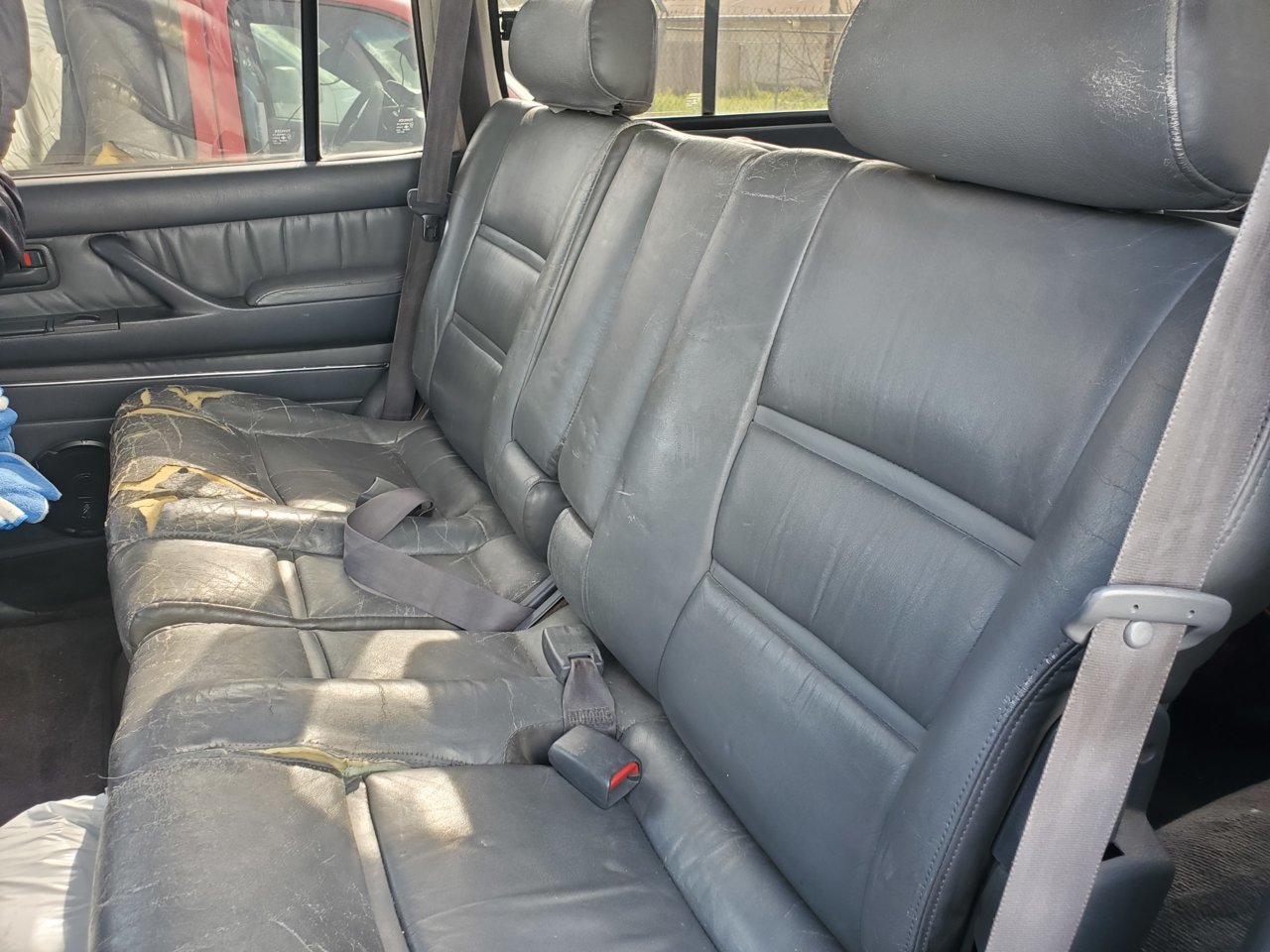

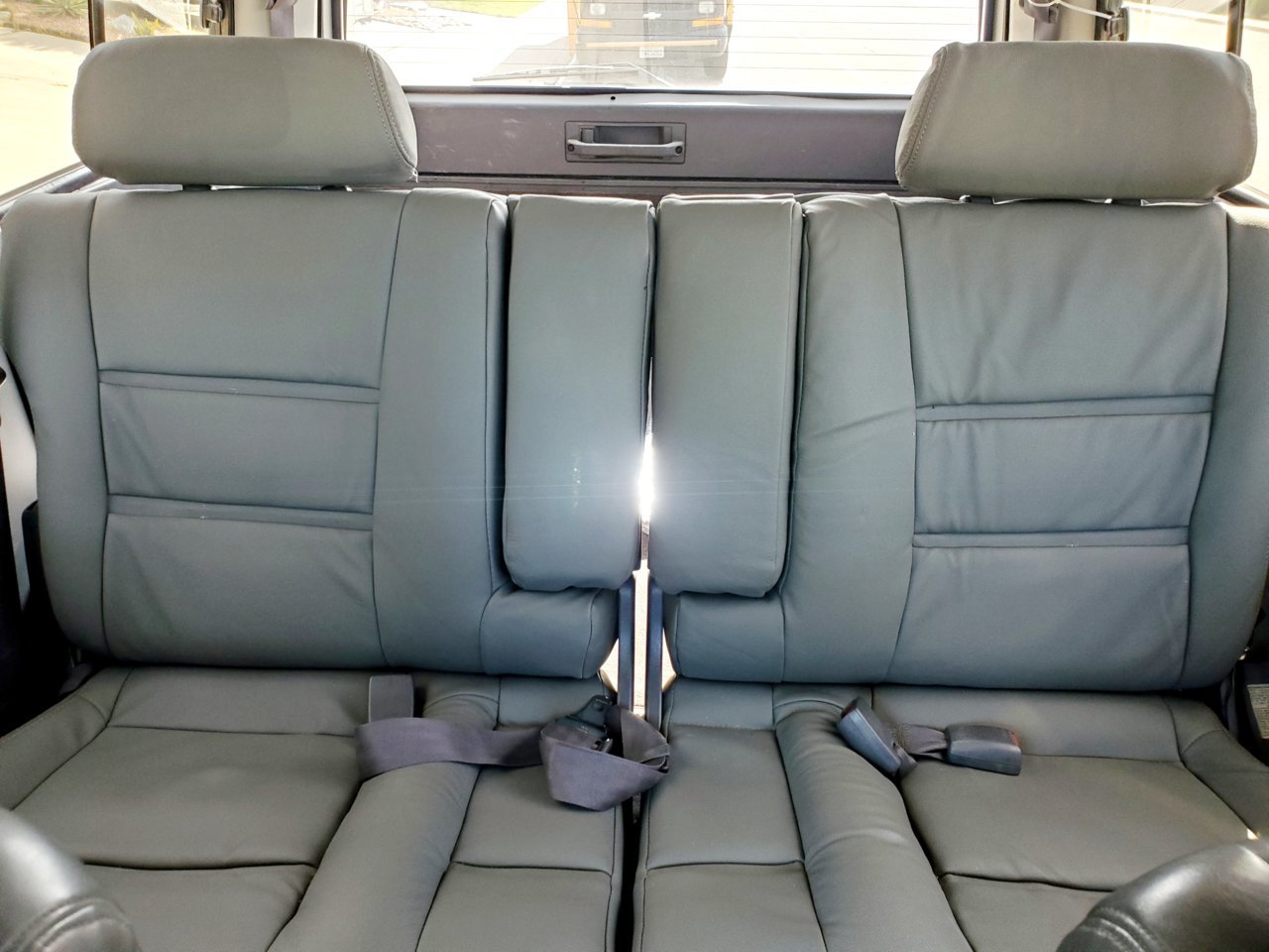

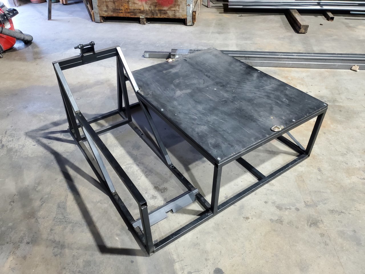

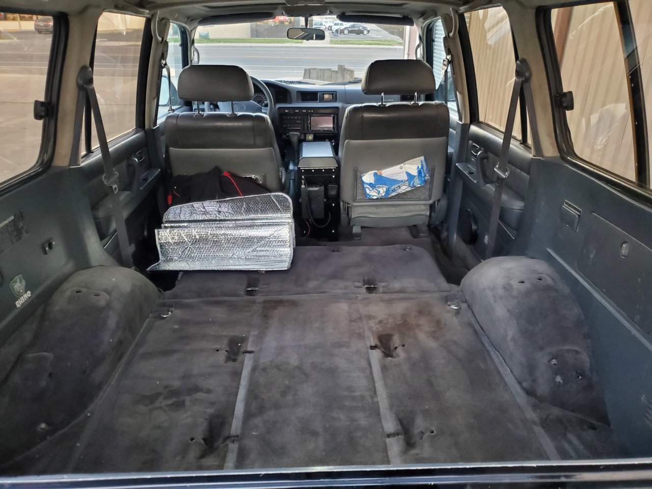

    Well, jungle gym removed :burp:
    Posted it on FB yota club, and aside from a few being tagged, no takers. Must not be many LC owners near me.
    Rear is filthy; it's pretty torn too so I may need to source a new rear carpet section.
    Last night, I had a sudden desire to remove the front seat covers (free for anyone before I toss them).
    I was genuinely surprised to see what great shape the passenger seat is.
    Makes me glad I went with dim gray leather from Lseat.com

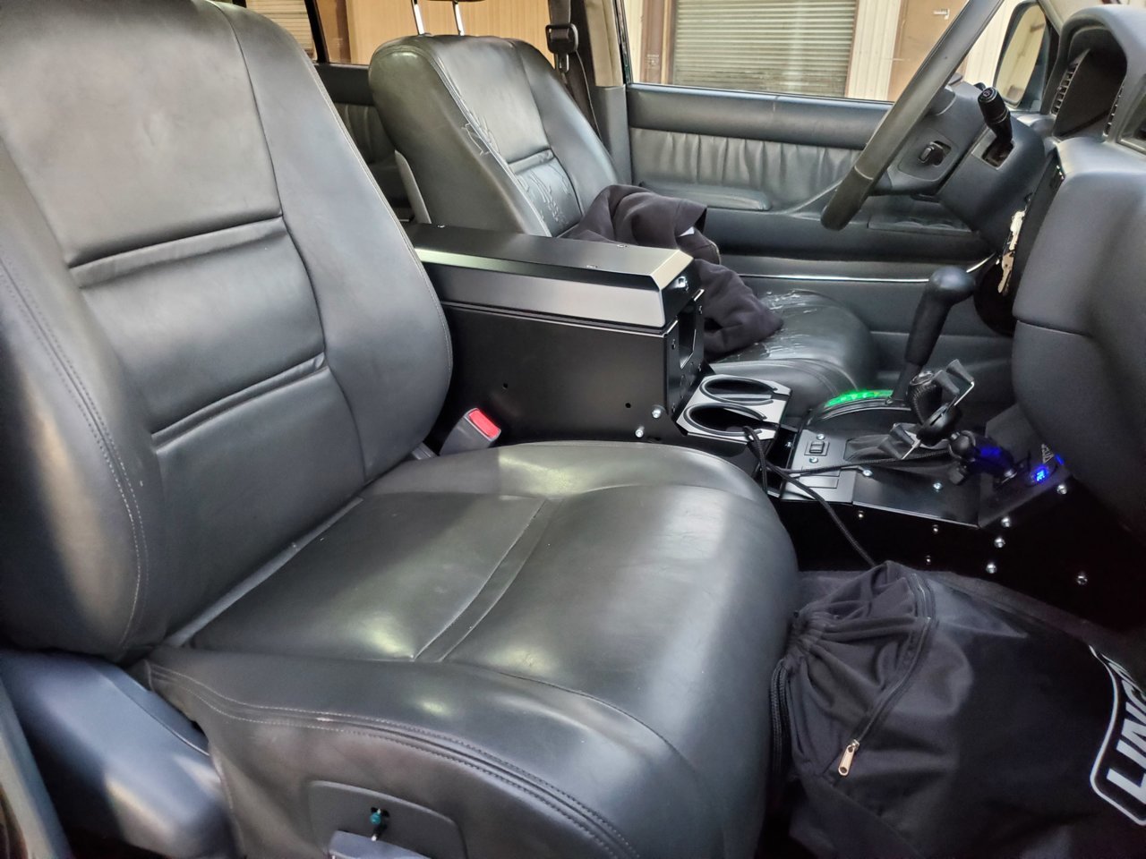

    On second thought, I may want to replace the leather on the passenger seat.
    Main reason is the shade is slightly darker on the factory seat. That and the new leather is really soft.
    It'll give me a chance to figure out the motor situation as well; it works but dies out shortly after until I let it rest again. Having gone with an aftermarket seat would mean figuring out the heater situation below the seat.

    The heaters are really easy to figure out. Take it out and loop the lines until you're ready to take out the lines. The only thing you have to do is patch the hole on the floor. I would just pop rivet in a flat piece of metal with some body sealer around the edges

    They're a high risk part, the lines always break or leak at the t fittings. Should really remove em at the engine side too

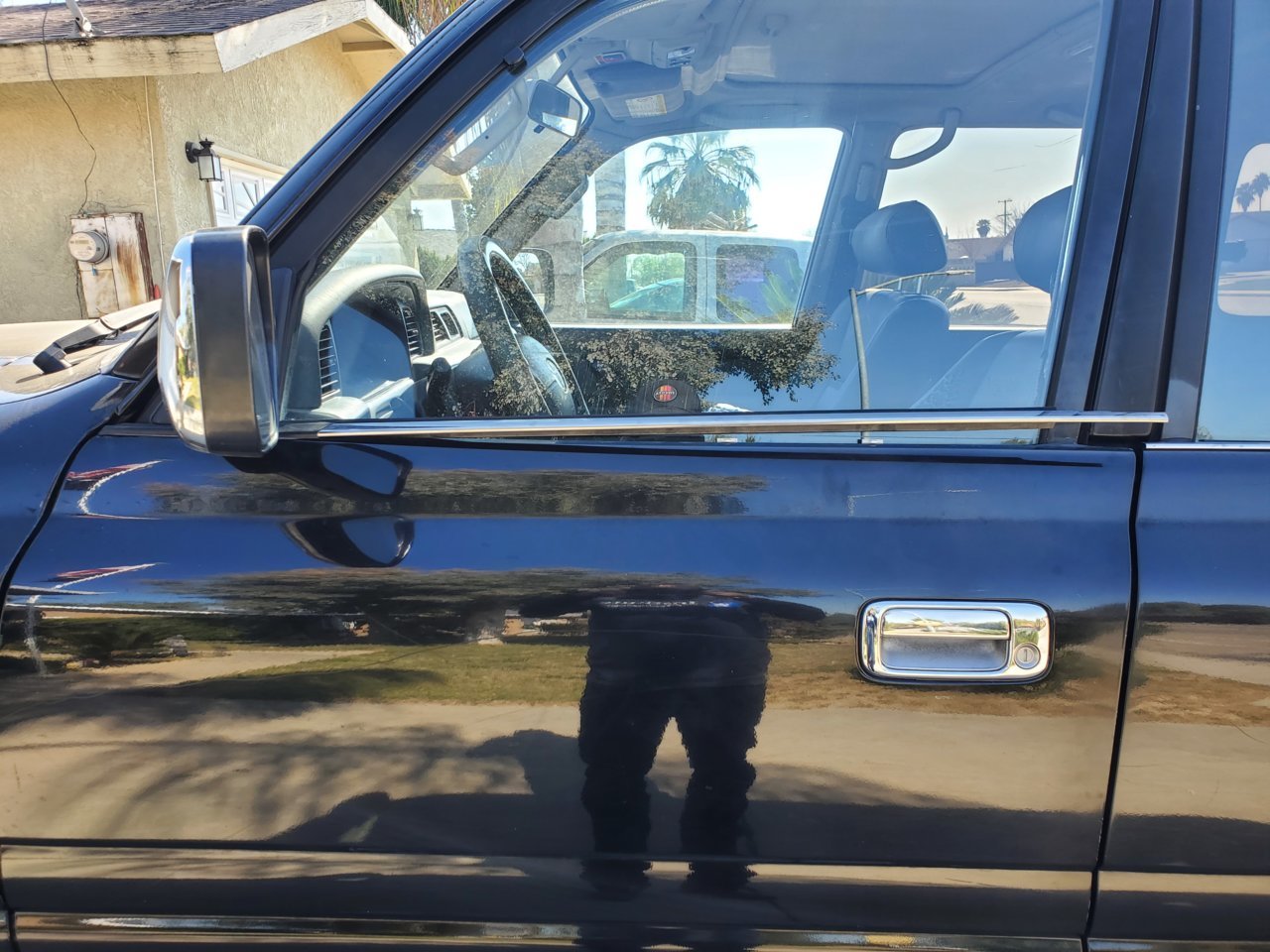

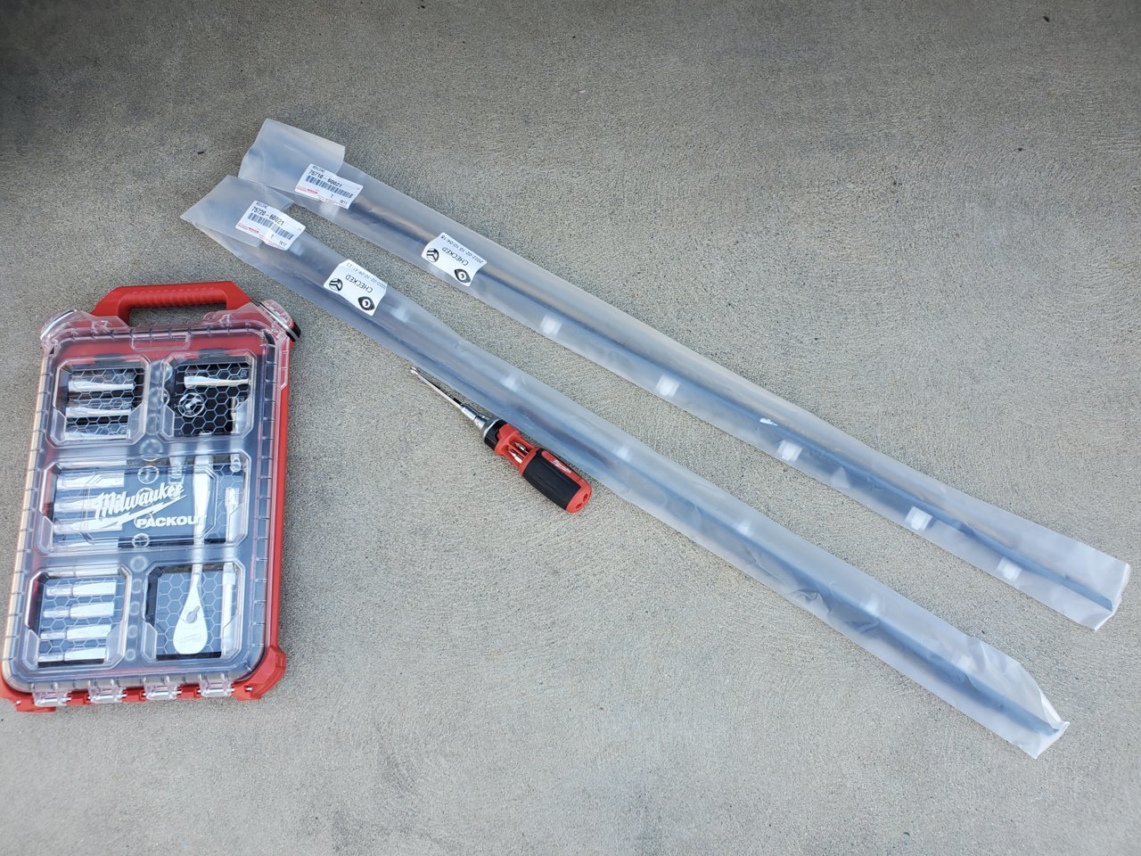

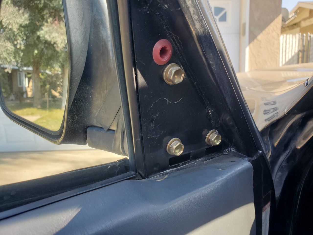

    So, if you've got an LC and your window trim needs replacing....spend the 5 minutes it takes to replace it.
    Got one for each side cause, you know.
    The old trim, hanging out like a night crawler on a busy street.
    It doesn't help that the white clips broke as well, but here's the main reason why the rear popped up and out.
    The tab broke at the end broke as well.
    Removing that screw, and undoing the 3x 10mm bolts holding the mirror (not completely), you should able to pull the forward most part of the trim out. There's one last clip there.
    Lower the window to uninstall.
    Keep window lowered to ease install of new trim.
    Discard old piece, and done.
    Really, I should've bought the rears as well. I will do so to match, but for now it's "enough".

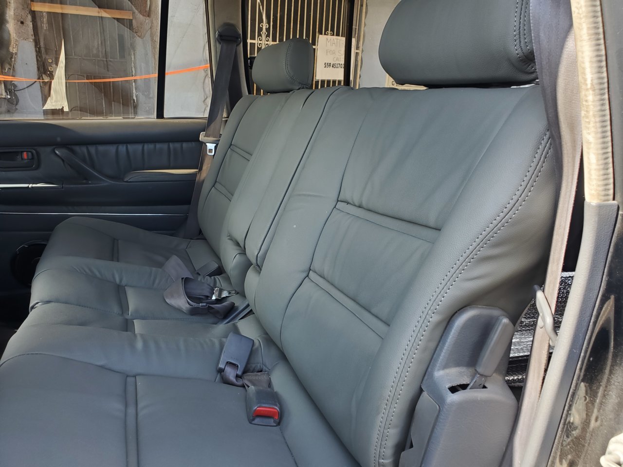

    Out with the old...
    ...and in with the new :burp:
    The seats really could've come out better, having left them out in the sun so the leather is easier to stretch and work with, but I needed the seats back today.
    I will say, it's so much softer than the old stuff.
