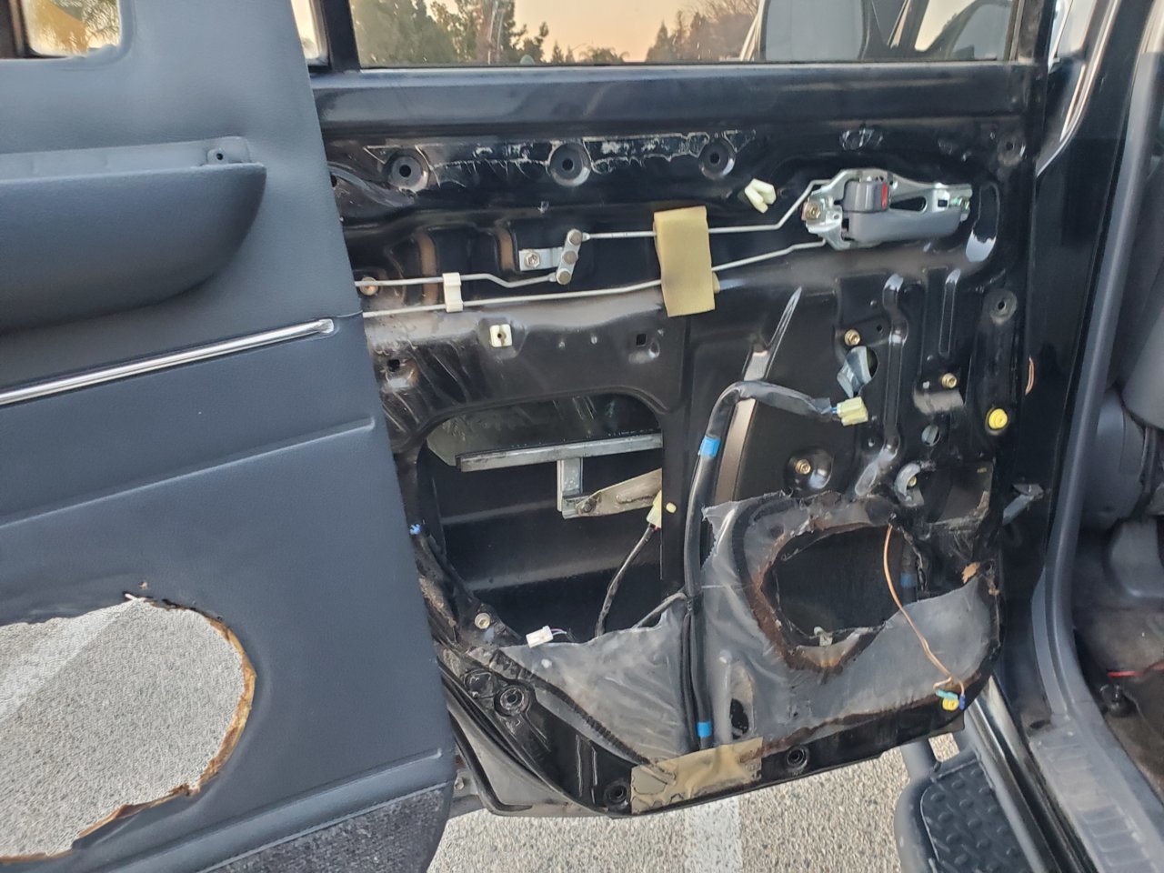

    There's something special about the guy that Danny sold the LC to before it came to me :crazy:
    Anyway, I decided to clean my door panels and wipe everything down. While I was doing so, I decided to figure out why the driver rear window didn't go down. Quick diagnosis found out that the switch was unplugged!
    However, Pandora's box was opened; I roll the window down only for it to fall off the track and fall down!
    It's now fixed, but the issue was that the 'track' that's attached to the bottom of the window had shifted too far to the right.
    Below you'll see the track is almost level with the rubber lining. It was shifted a good 2-3" causing the roller wheel on the regulator to fall out the track.
    All done!

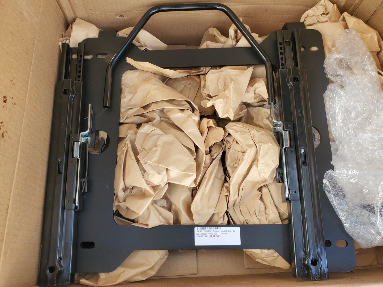

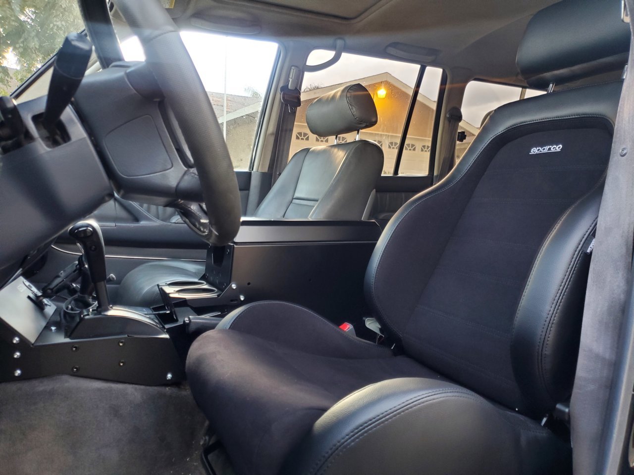

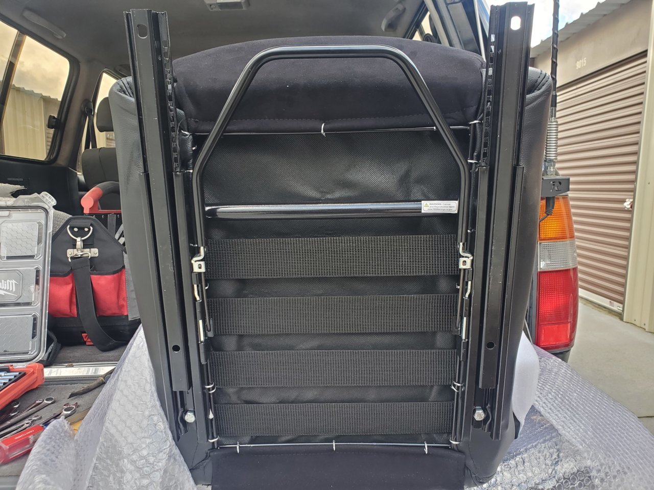

    Man, what can I say...I've waited quite enough for this bracket so when it came in, I left work early to start my install :rofl:
    The bracket and track/slider do come separately, but I mocked them up to get an idea as to how it's oriented.
    I could've made one at work, but I hate the thought of how inconvenient it'd be to bolt and unbolt my seat several times just to fab something up.
    One thing I didn't realize is, no hardware is included.
    No worries, I've got an ACE here locally. A quick call to Sparco revealed that their hardware kit consists of M8 x 1.25 bolts, 16mm long. The pitch is important as that's what the seat bottom is threaded for. You can use whatever M8 nut and bolt combination for the base to the track/slider though.
    If you opt for the base alone, you'll just need the 4 bolts. If you buy the base and track/slider, you'll need 8 bolts, 4 nuts, and 4 washers. Hope this helps anyone looking to buy a Sparco seat in the future.
    Instructions aren't included, but it's not rocket science.
    Best way to go about it is to adjust the seat track to expose the holes needed to thread your bolts in for your seat bottom. Do this for both the top and bottom bolts.
    Once that's done, adjust the track/slider so it's near center. You'll need to do this as you actually have less travel with the base on than you do without. Don't worry, the adjustment is plenty it's just that the bottom bar collides with the base if you have the seat too far back.

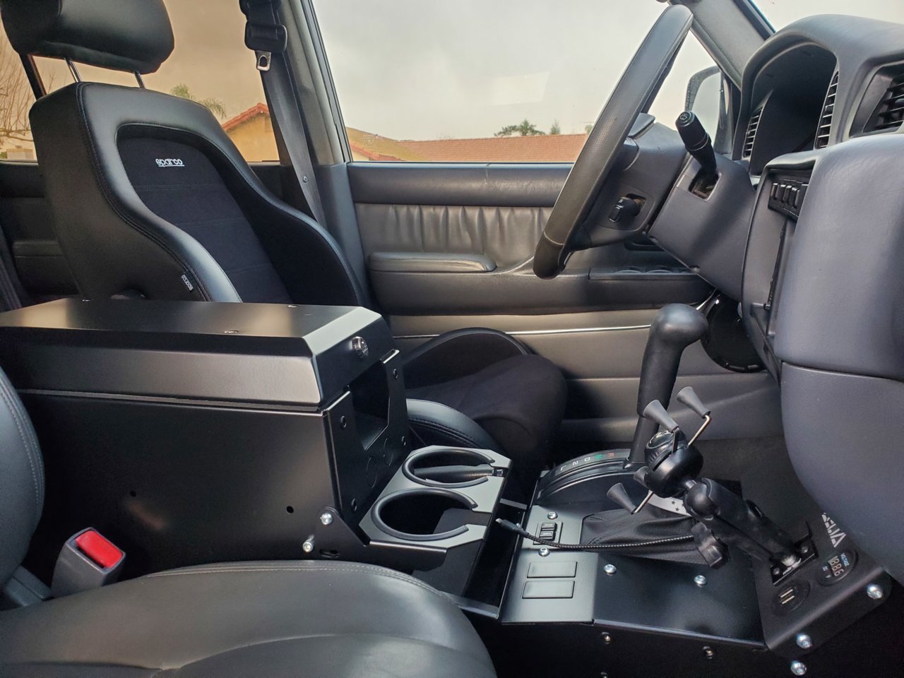

    Sparco really meant for this to be a factory replacement; '93-94 LC's have the seatbelt buckle mounted to the floor whereas '95 and up have the buckle mounted to the seat itself.
    Let's not forget, the factory seat needs to be removed!
    With that out of the way, it was time for the new seat to go in.
    Holy shit does it look good!
    Initial thoughts?
    The seat feels a bit firmer than my worn factory seat.
    Here's what's crazy; I can drive around with my factory seat and shortly after develop a little bit of pain in my lower back. I've tried the lumbar, the side bolster adjustment, everything and no matter what I can only make it hurt slightly less.
    The firmer Sparco left no pain at all. No sudden sharp pain after small adjustments, especially after getting up and out. I'm legitimately impressed.
    If you're a bigger build, or have a bigger butt, you won't find these seats to fit well. Being a smaller build though, I feel this seat just hugs and holds me, very supportive actually. They feel better than the seats I've got in my Corvette even.
    My only gripe is that the seat bottom is slightly taller than I thought it would be. That's fine as I'll learn to enter and exit just like my Corvettes.
    Can't wait until this seat really breaks in and feels much better in the long run!
