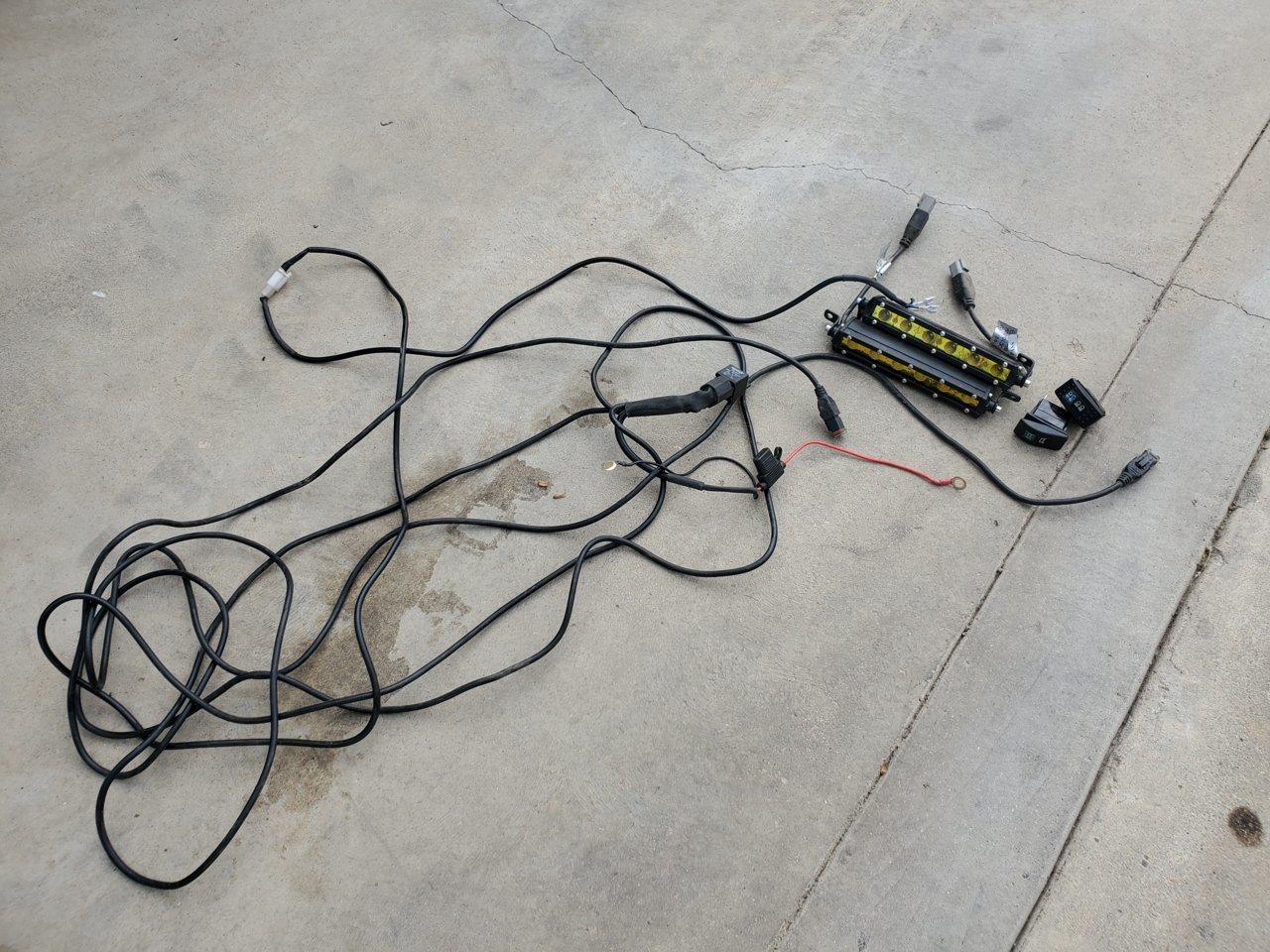

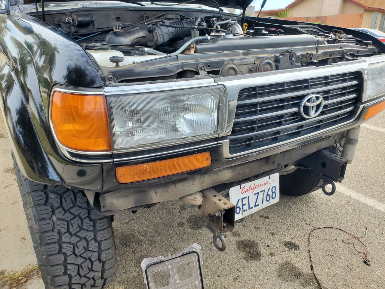

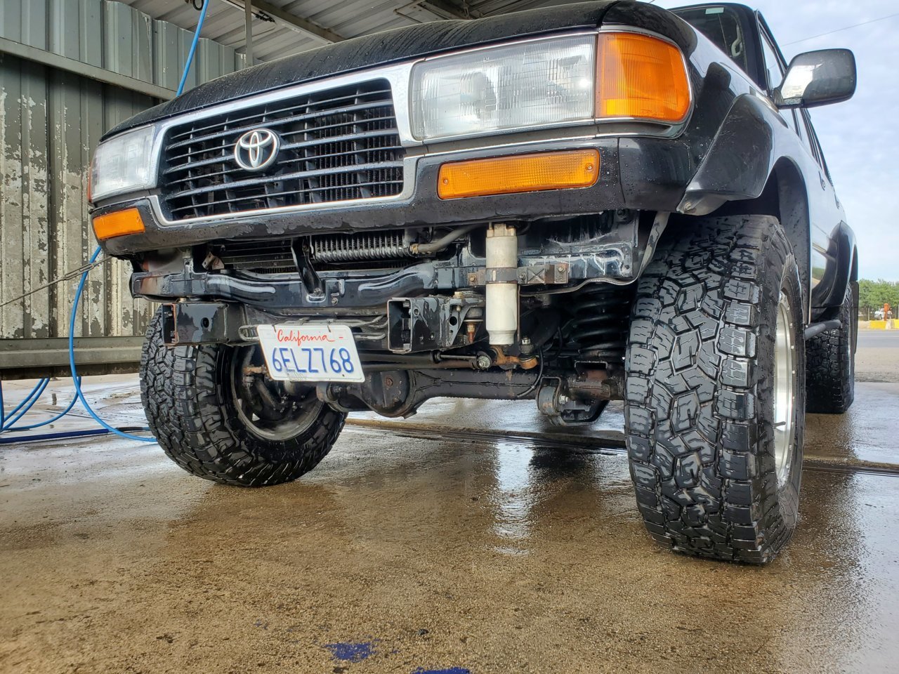

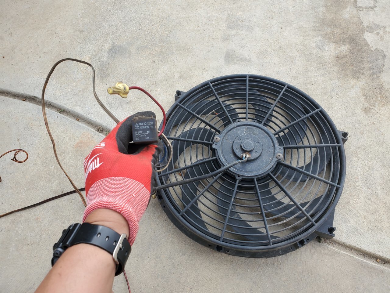

    Well, I did a thing in preperation of my new Coastal Offroad bumper.
    I've had a ton of wiring that I've wanted to get off for awhile; about 3 owners ago an auxiliary fan was installed. Poorly really.
    Anyway, there was wiring that was incomplete, as well as a relay and a few grounds. Well the auxiliary fan never ran or fired up, or maybe it never got hot enough to turn on.
    To start, I pulled the fog lights and respective wiring and switches. Shame that they're getting thrown away.
    Once disconnected and uninstalled, the front bumper could be removed.
    Which in turn, made room to remove this crap.
    Now that everything's off, I figured now is a better time than ever to pressure wash all the dirt and grime off.
    "No bumper who dis"
    #ziptiemod

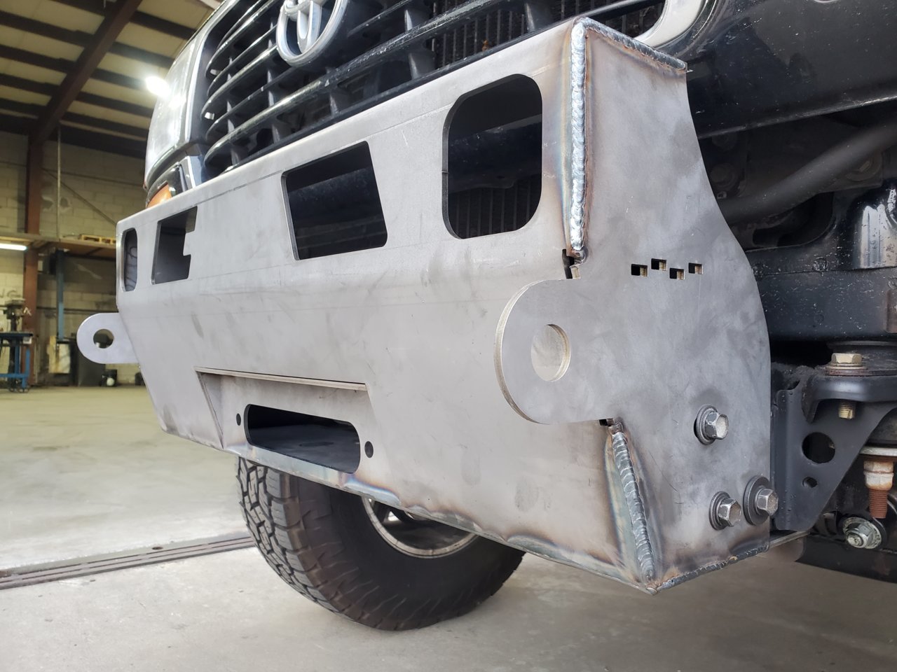

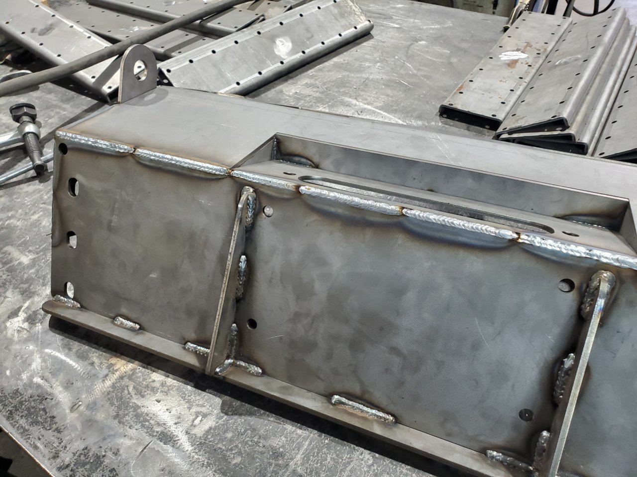

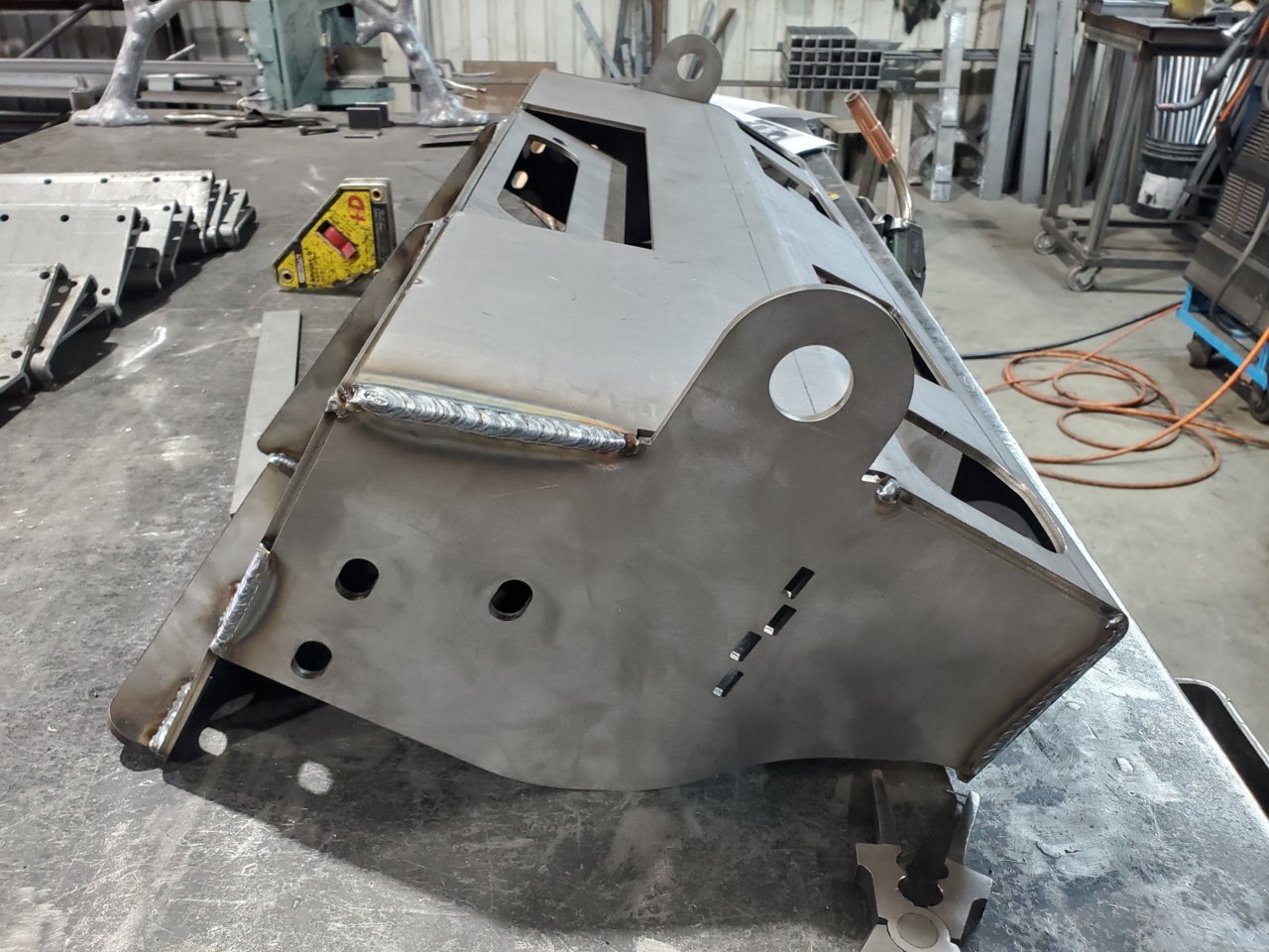

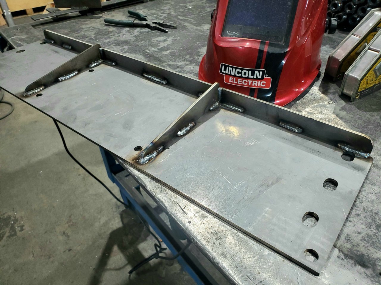

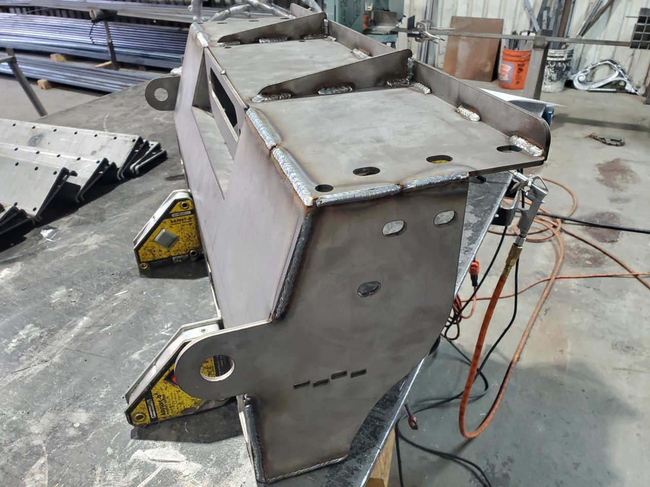

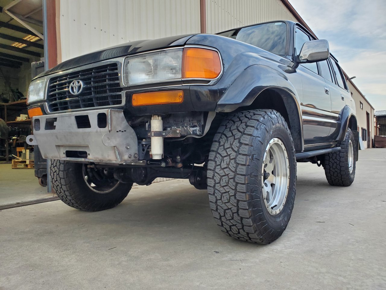

    Today I decided to mostly finish up my bumper.
    Just a quick recap as to what's been done already. Bottom plate with gussets welded.
    With the shop clear, I thought I'd move the welder as close to outside as I could.
    First things first, affix the bottom and side plates, and tack.
    Next up was getting the rest of the pieces tacked together. Starting to look good already!
    Next up, remove the bumper and tack up the mount for the fairlead.
    This one was rather tricky and I had to give @Wulf a call cause I didn't know how much room I had to play with from the drum to the fairlead.
    Once that was in place, it was time to run some exterior beads.
    Really, I should've done this on my day off. School early in the morning with work in the afternoons is exhausting so, not the best welds.
    Killed enough time letting the metal cool between beads, and not wanting to stay all night I decided to call it "enough".
    Once I order up some lights, I'll run some more beads on the inside and finish it all up.
    Enjoy!
