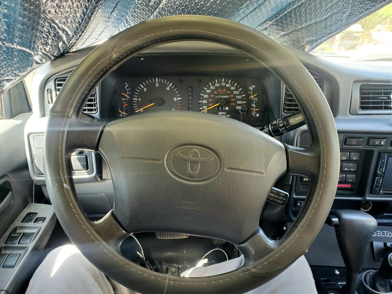

    Nice job. Very tedious yes, but so worth the effort IMO. Feels a lot better than the slip-on covers. Looks nicer too.
    Massage the leather in the areas where it's bunched up, while you drive. It'll eventually start to flatten out and look/feel better there. Worked on mine at least.

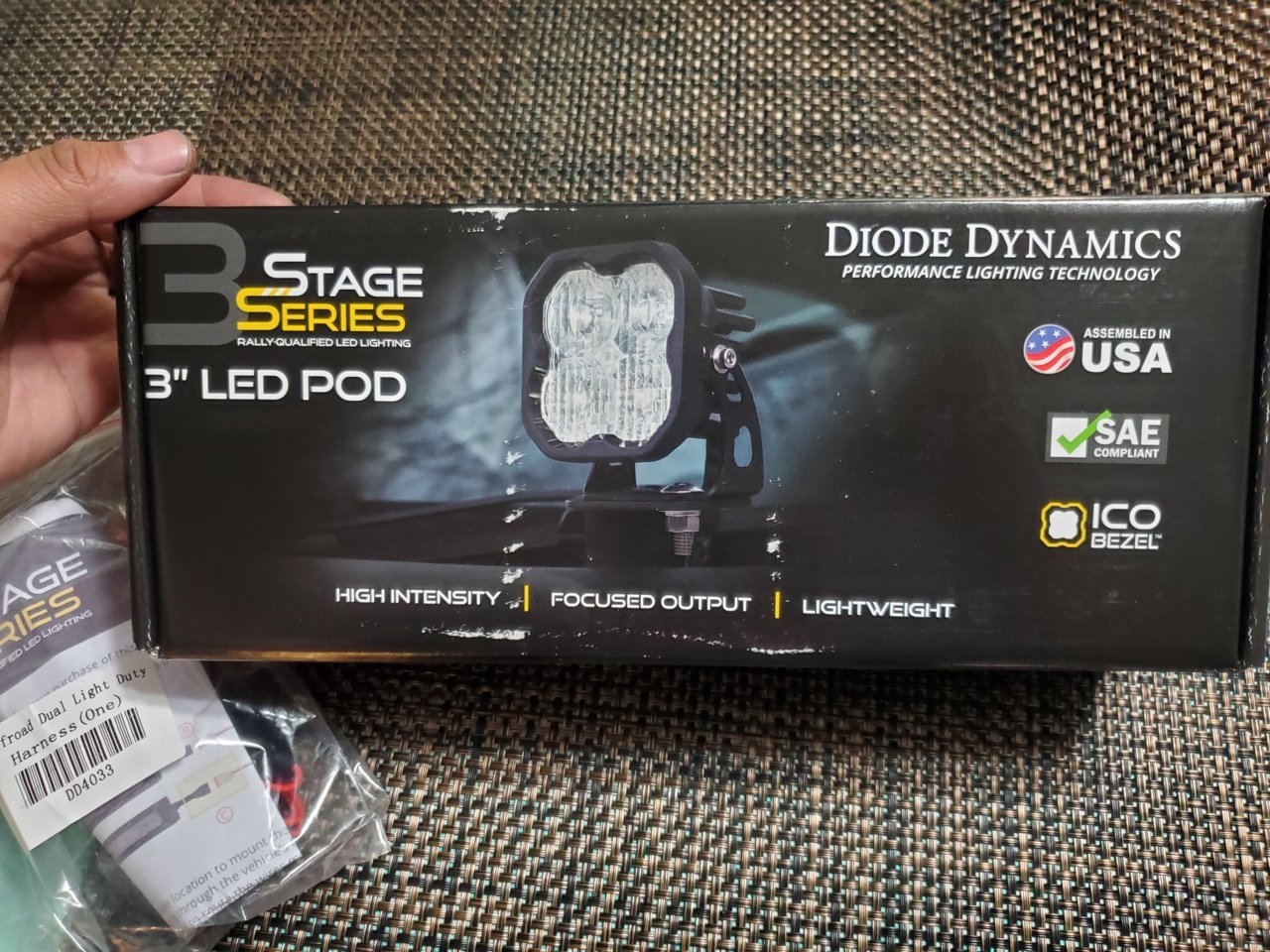

    Awe shit, lights arrived!
    Man these things look good, and really feel like quality lights.

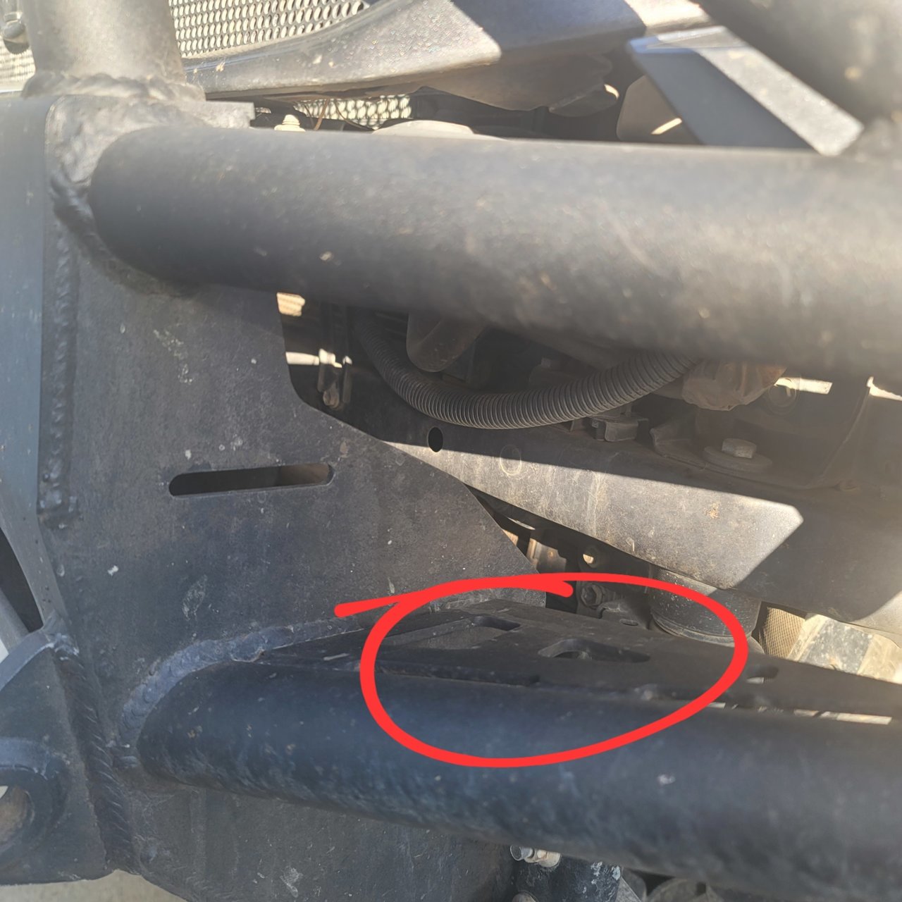

    So my bumper has two 3" x 3" cutouts in the front bumper.
    Behind it, an L-shaped bracket with a slot opening gets welded in place. That slot is what you run a bolt through to install the mount the DD lights come with.
    If you've got an opening, you can just fabricate an L-shaped bracket or hell, even use angle iron, and slot a hole into it for mounting.
    Taco-Obsessed[QUOTED] likes this.

    I have a mounting point on the vertical side and an unlevel hypotenuse mounting points on the bottom; nothing up top to connect to (yet).
    Options I see:
    1. L-bracket like you said but I think it wouldn't look good aesthetically; connect to vertical slot
    2. Get a wedge machined to make a level attachment point at the bottom hypotenuse.
    3. Make an attachment point up top; weld a flat plate to back of tube or drill through tube?
    Thoughts?

    @Taco-Obsessed
    I had to go through my pics to find your truck, and remembered this one :rofl:
    You're needing to mount it in the opening in the wings I take it?
    Taco-Obsessed likes this.

    Sucks I don't have your bumper and lights in front of me.
    I'd just figure utilizing this space to install your light mounts.

    Its not level though and I need it to be level for fog cut offs.

    The lights don't swivel in the provided mount? I know that's how I expect to get my lights to sit level.

    Too obtrusive.
