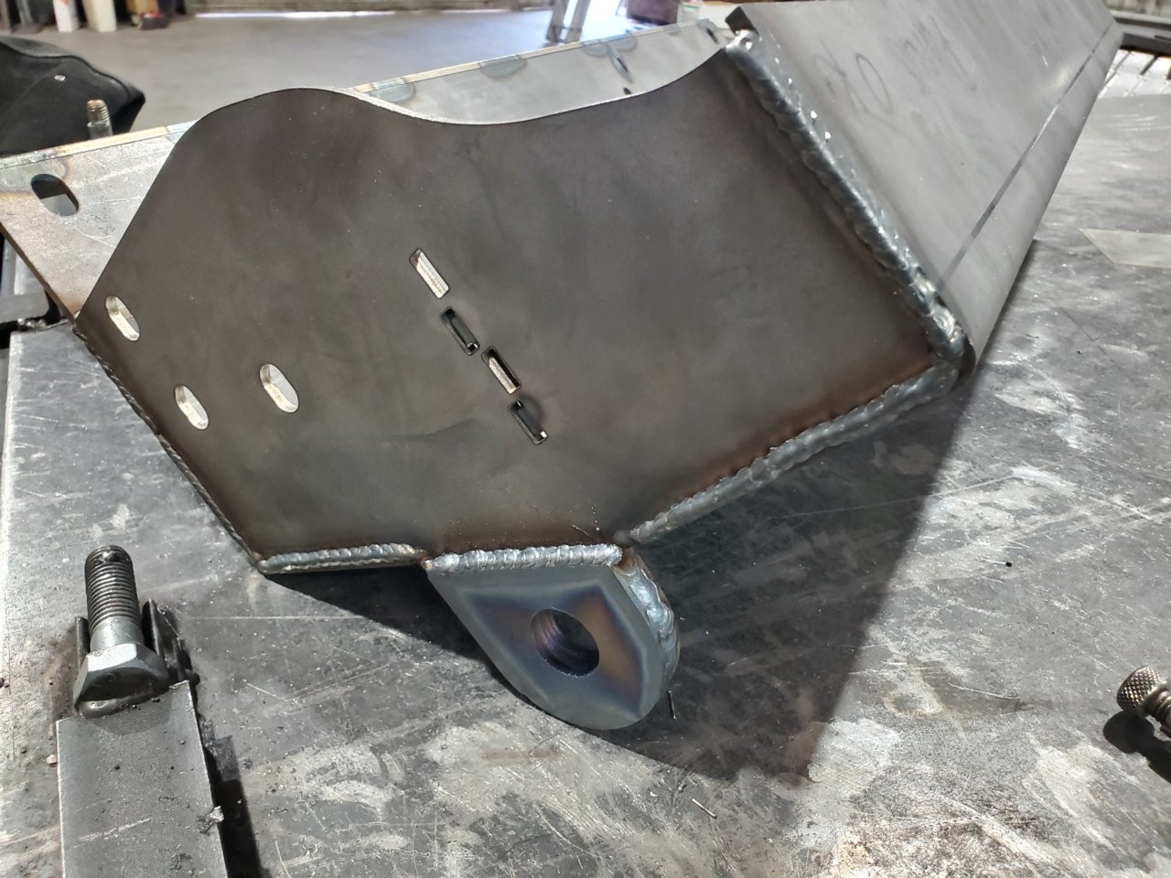

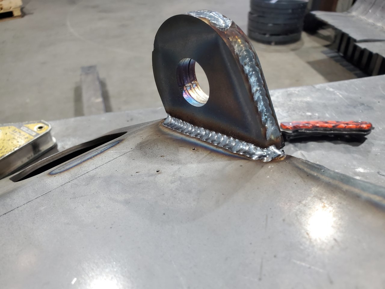

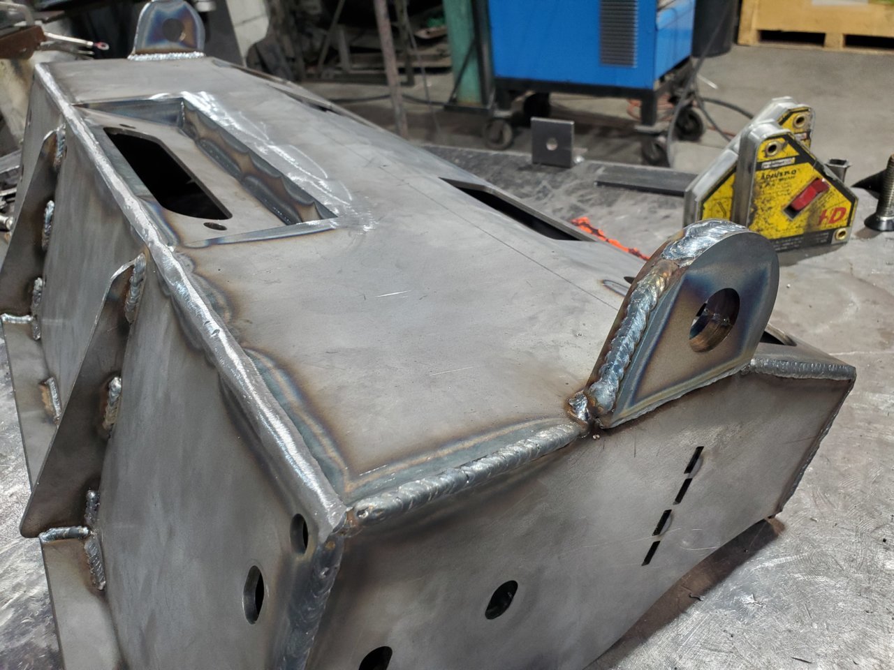

    Those welds. Rolls of nickels! Whew
    Wulf and Kwikvette[OP] like this.

    Ha thanks!

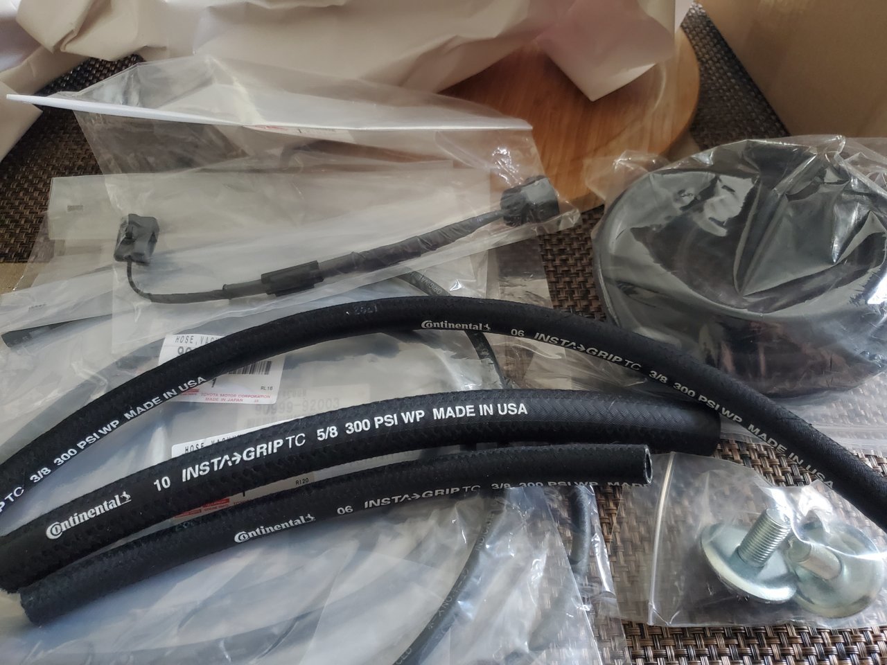

    More parts!

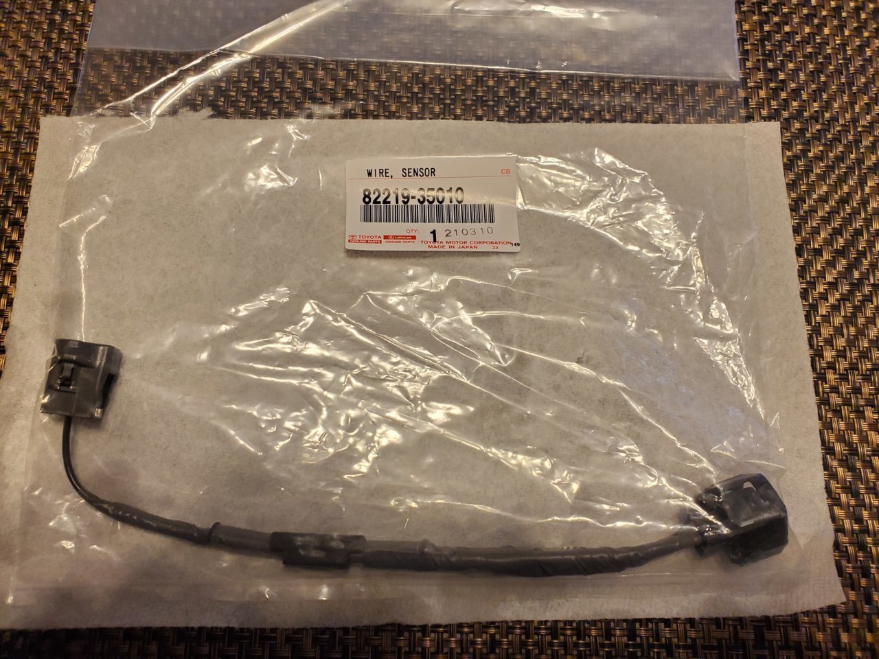

    A factory knock sensor/wire as a "just in case" because apparently, they get brittle over time and can suddenly fail.
    Some high quality silicone hose to replace many of the cracked lines I have currently.
    The thicker, pre-cut pieces are meant to replace the low pressure power steering lines as one of mine is leaking.
    Last but not least, spare rear lower shock mount bolts, in case I break the set that's currently in place.

    DAmn, wish my welds looked like that!!
    Wulf and Kwikvette[QUOTED][OP] like this.

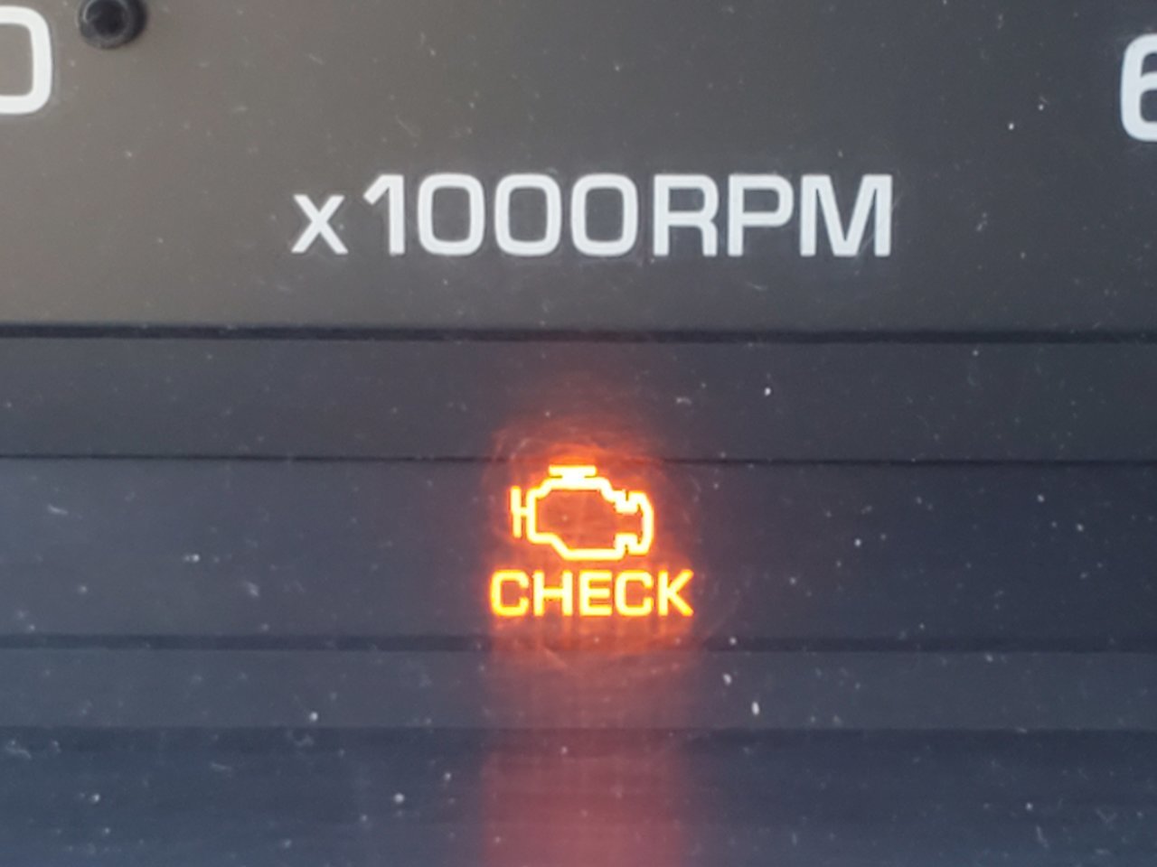

    A shitbox isn't a shitbox without a CEL right?
    Responsible owners however, always carry an OBD scan tool in each of their cars :evil:

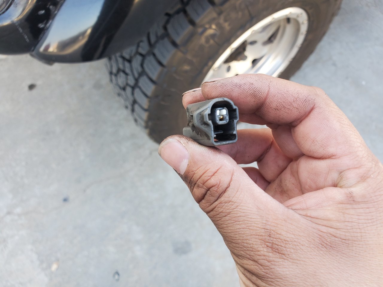

    Got the light this morning on my way to school, so once I arrived I quickly ran the code reader; P0325 for Knock Sensor Bank 1.
    Seeing as how I would have school for several hours, followed by work soon afterward, I decided to wait until after work to pop the hood.

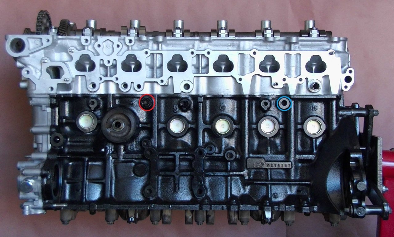

    Fortunately, when I posted about it @Speedytech7 was quick to post this picture depicting their location; there's 2 total, circled in Red and Blue.
    I cannot make this up but that package I received yesterday actually includes a plug for the knock sensor. I bought it "just because" after stumbling upon a common issue with these vehicles some days back.
    So I decided to wrap up early at work and check under the hood as by now it should be "cold" enough to stick an arm in there. That's when I was presented with this; a plug without a wire.
    Apparently, the plug is tied in to a main harness, and cannot be purchased separately. So what Joey at Wit's End does is he sells a harness offered by Toyota, and suggests cutting and using the section that offers a replacement plug.
    Hoping this new plug end will give me many more years of trouble-free service!
