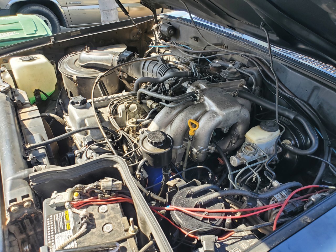

    Rather than just cut the harness in half, I decided to take it apart to get the full length of the wire.
    Easily crimped the loose wire to the new stuff and used the lower part of the intake manifold to shrink the heatshrink :bananadead:
    While I was there, figured it was a better time than any to replace what vacuum lines I could replace.
    Have a ton of the factory stuff, so those just get cut up to replace what I need.
    The silicone tubing Todd suggested came in handy to replace the bigger stuff. You slip it on any of these fittings and that stuff just grips it nice and tight.
    No more CEL (for now)!
