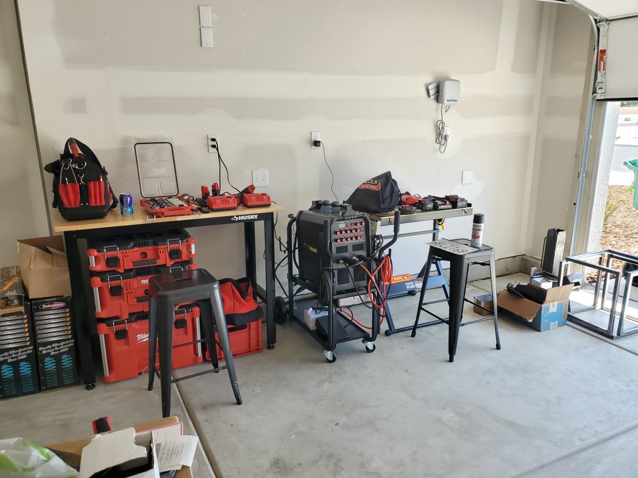

    With my newfound working area, I'm glad to start getting shit done at my own place! Been so very long since I had my own garage. Got the bulk of my tools out now, just need to buy wall cabinets and a large drawer/cabinet for consumables.

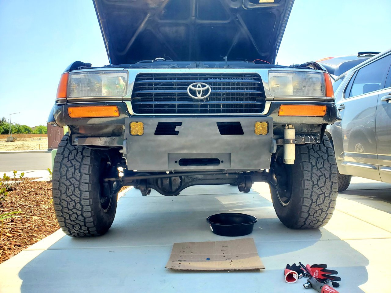

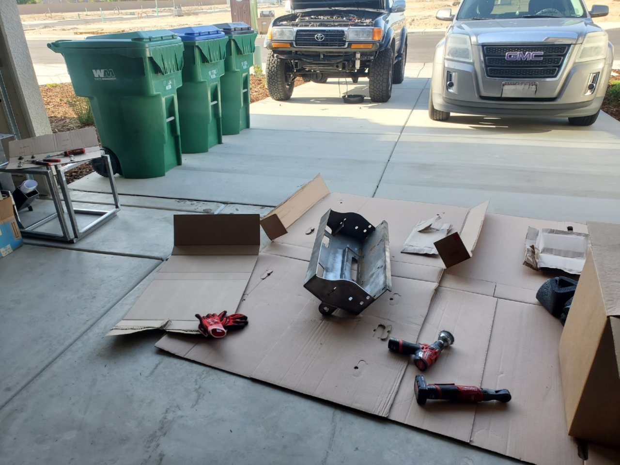

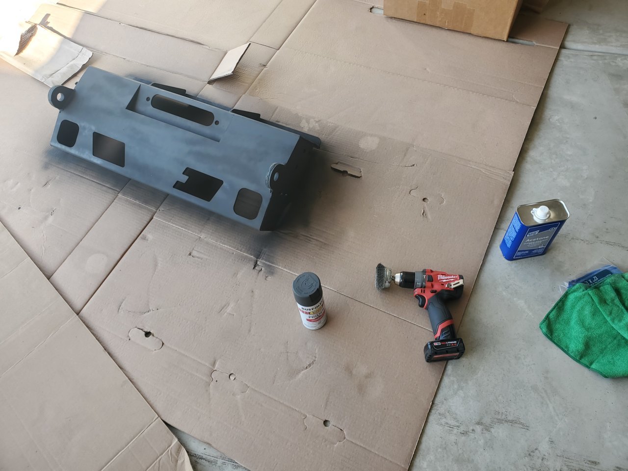

    Onto the LC; with the rain lately I had accumulated quite a bit of surface rust. Off the bitch goes!
    Hit it for the longest time with my wire wheel. After that, a bit of acetone to wipe it clean and on with the primer.
    Not trying to win any beauty contests, this was more or less just to protect the surface.
    All good to go!
    And if anyone asks about the drip pan, shitbox life got it? :luvya:

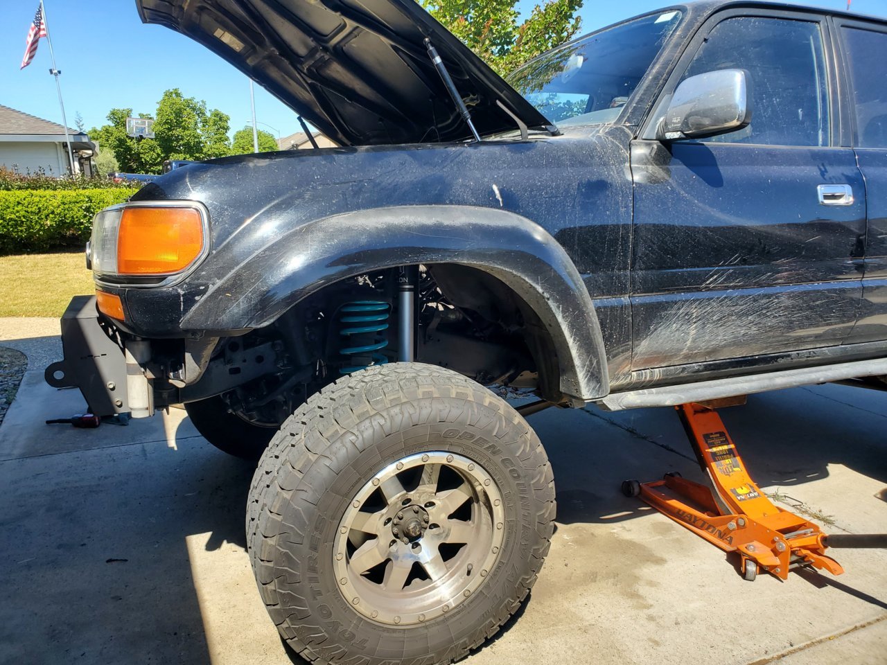

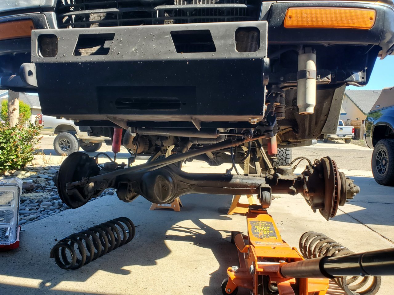

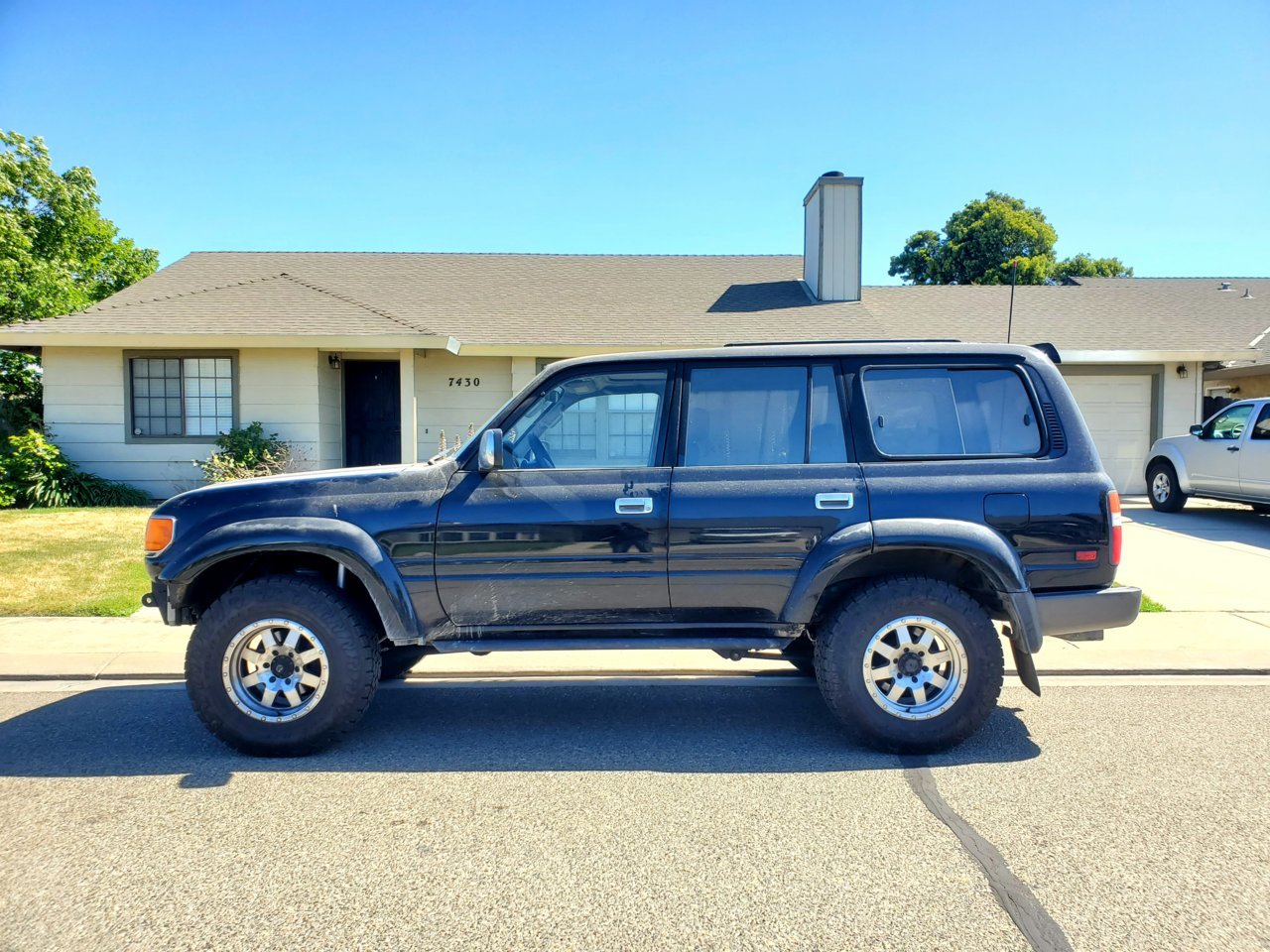

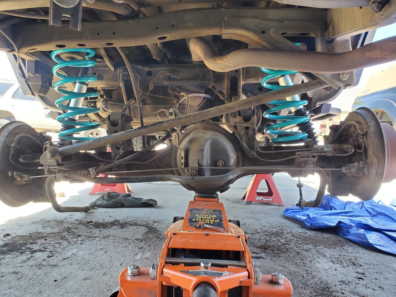

    While everyone's lifting their trucks, I lowered my LC :burp:
    Had a fun ass time today as @El Taco Diablo hosted a mod party at his house. His son, as well as @essjay was there so plenty of hands on deck to help each other out.
    What's funny is that the only real difficult part is the constant raising and lowering due to all the damn travel :rofl:
    Got that Bluetooth Suspension Mod :burp:

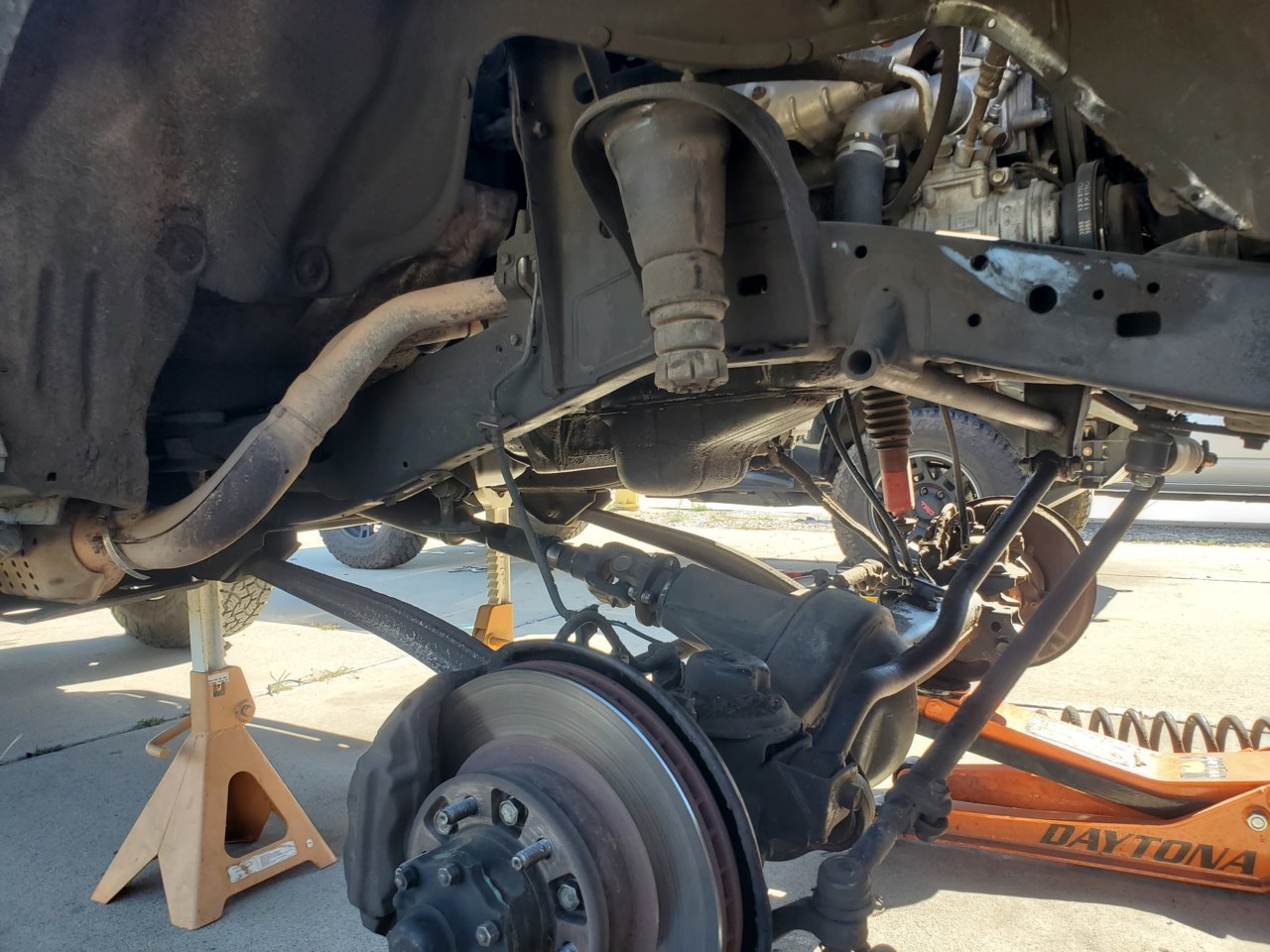

    I must say, this was just to raise it and get the jackstands out from under the frame; so much droop!
    Tire wasn't even off the ground, had plenty more to go. At this point my brake lines were my limit straps.

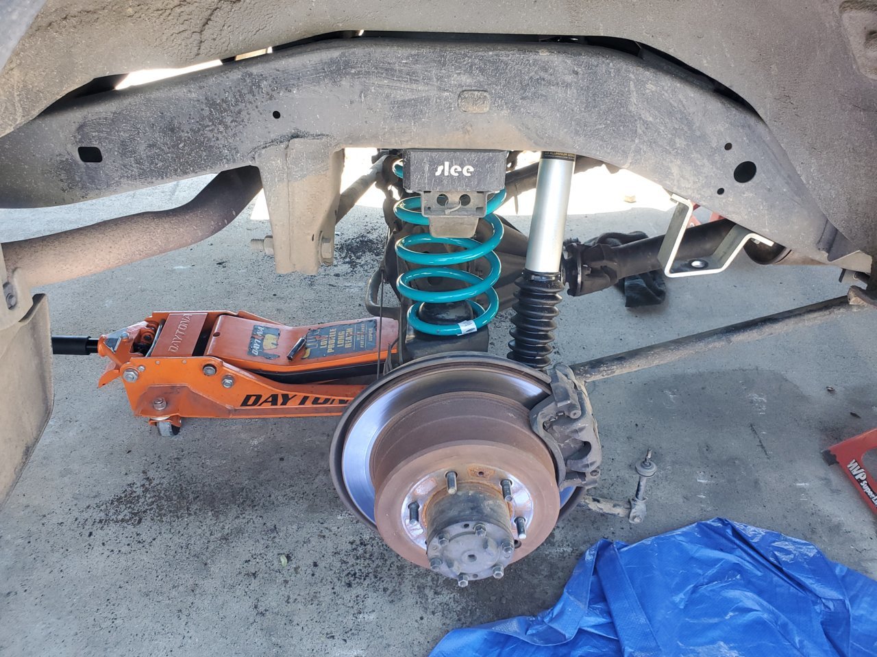

    Onto the rears.

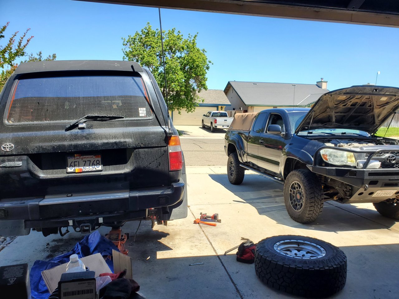

    Chris meanwhile was replacing his serpentine belt while Matt and Robert were back and forth between helping both of us.
    Shocks and coils are in!
    I must say, I'm freaking stoked about the new stance.
    The front end sits just a hair higher, yet the rear lowered quite a bit so she sits damn near level.
    The drive back? Man, it drives soooooo much better now!

    Why'd you put the rear bump lowering blocks on?
  16. May 16, 2022 at 6:48 AM
    #656
    Kwikvette
    Kwikvette [OP] Well-Known Member Vendor
    Feb 27, 2019
    #284735
    79,780
    Fresno County
    4 run, 2 don't
    I didn't!
    Meant to take them off, especially since the rear sits a tad lower. They're old (and dirty) as you can see.
    They're coming off before a shakedown run.
  17. May 16, 2022 at 6:48 AM
    #657
    Kwikvette
    Feb 27, 2019
    #284735
    79,780
    Fresno County
    4 run, 2 don't
    Thank you!
    Taco critter likes this.
  18. May 16, 2022 at 6:49 AM
    #658
    Speedytech7
    Feb 20, 2014
    #123587
    57,252
    924 W Garland Ave, Spokane, WA 99205
    It's less Tacoma and more mod
    You have stock equivalent springs, as long as your shock don't bottom out you can take those blocks out and gain more total uptravel
  19. May 16, 2022 at 6:50 AM
    #659
    Kwikvette
    Feb 27, 2019
    #284735
    79,780
    Fresno County
    4 run, 2 don't
    Oh for sure.
    If you noticed up above, my damn shocks have more travel than my coils even.
    I need to invest in an extended brake line for the rear.
  20. May 16, 2022 at 6:51 AM
    #660
    Speedytech7
    Feb 20, 2014
    #123587
    57,252
    Might put a tiny coil spacer in the rear if you want a bit of rake then
    Kwikvette[QUOTED][OP] likes this.
