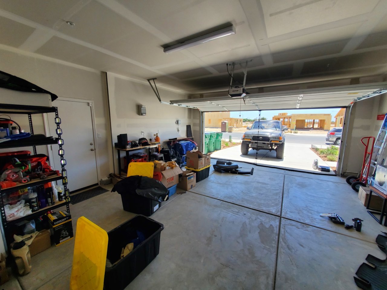

    No oil discussion here; would hate to attract 3rd Genners.
    But yeah I've always used Mobil 1 Synthetic (bottom right corner outside).

    plus Walmart has bad ass deals on jugs. I like that garage screen thing! Sweet!
