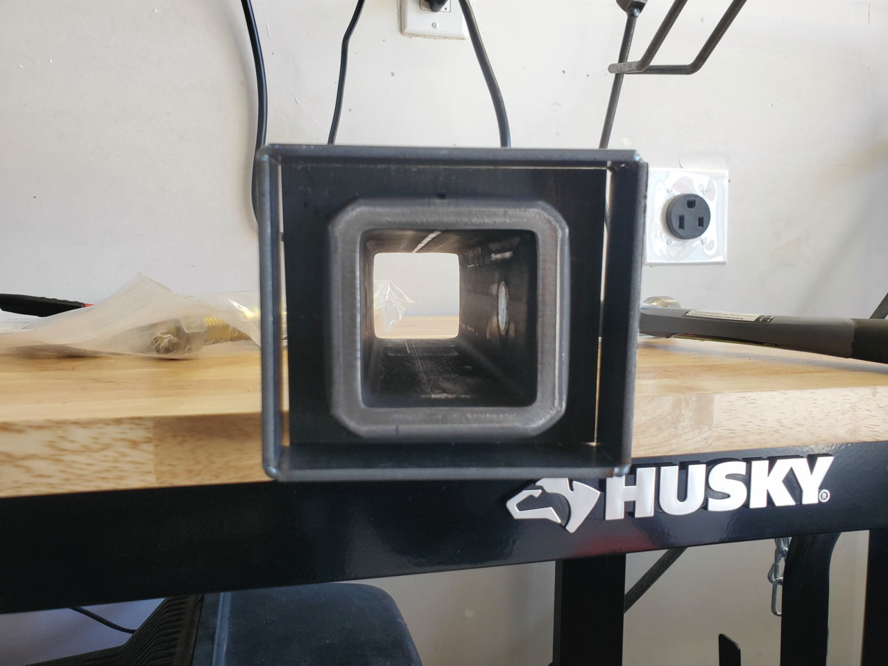

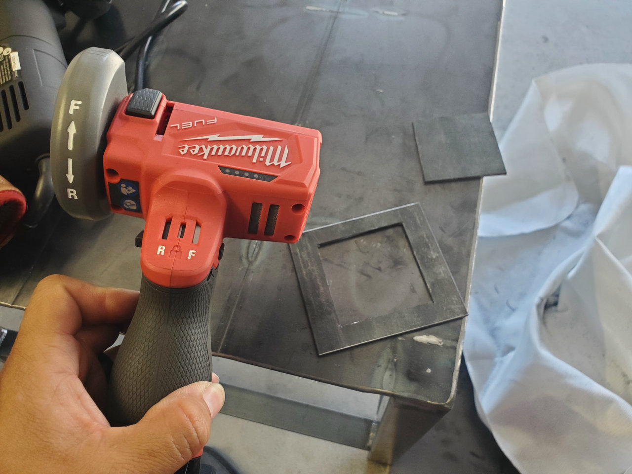

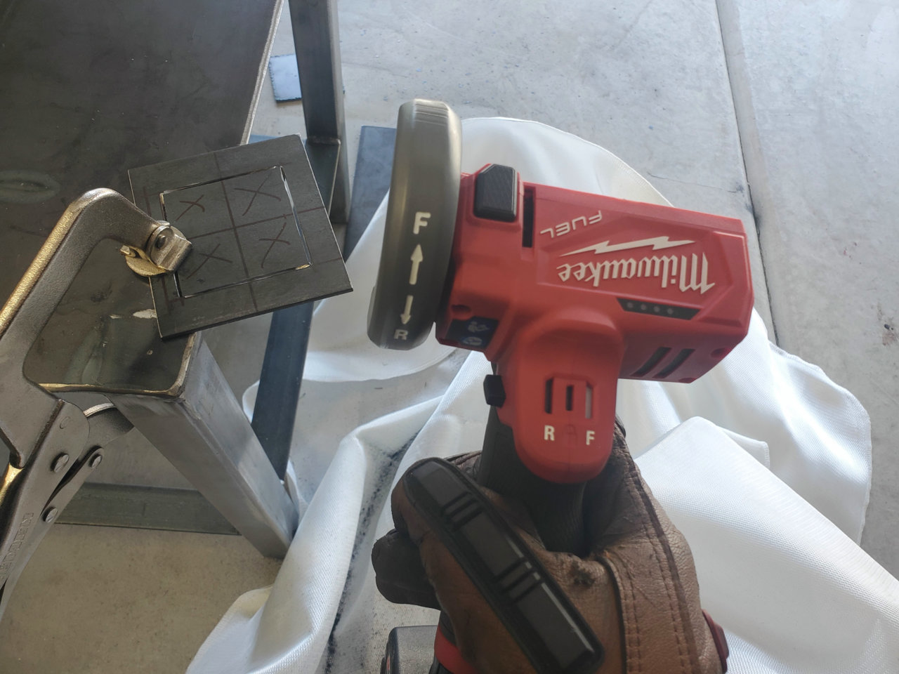

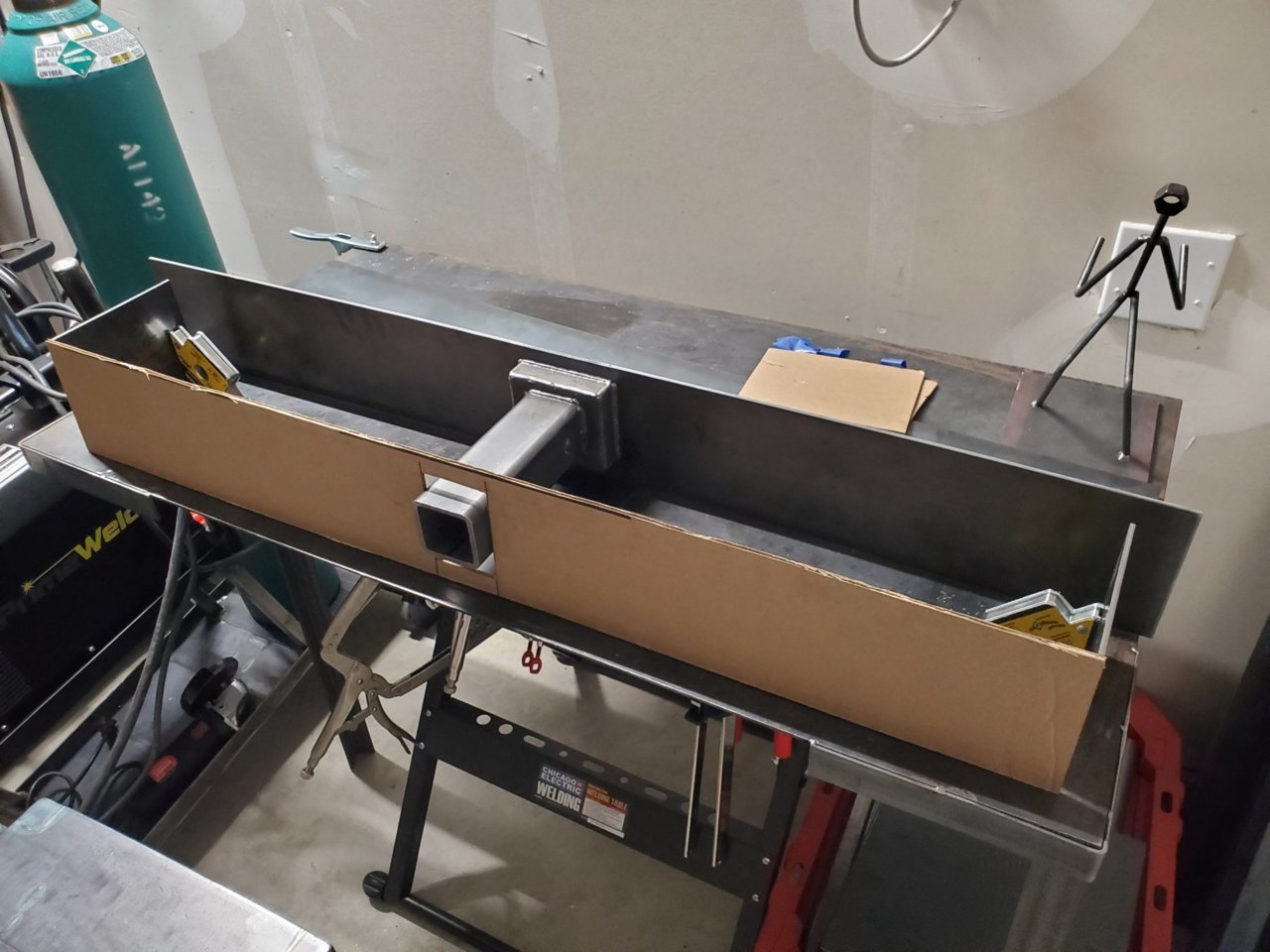

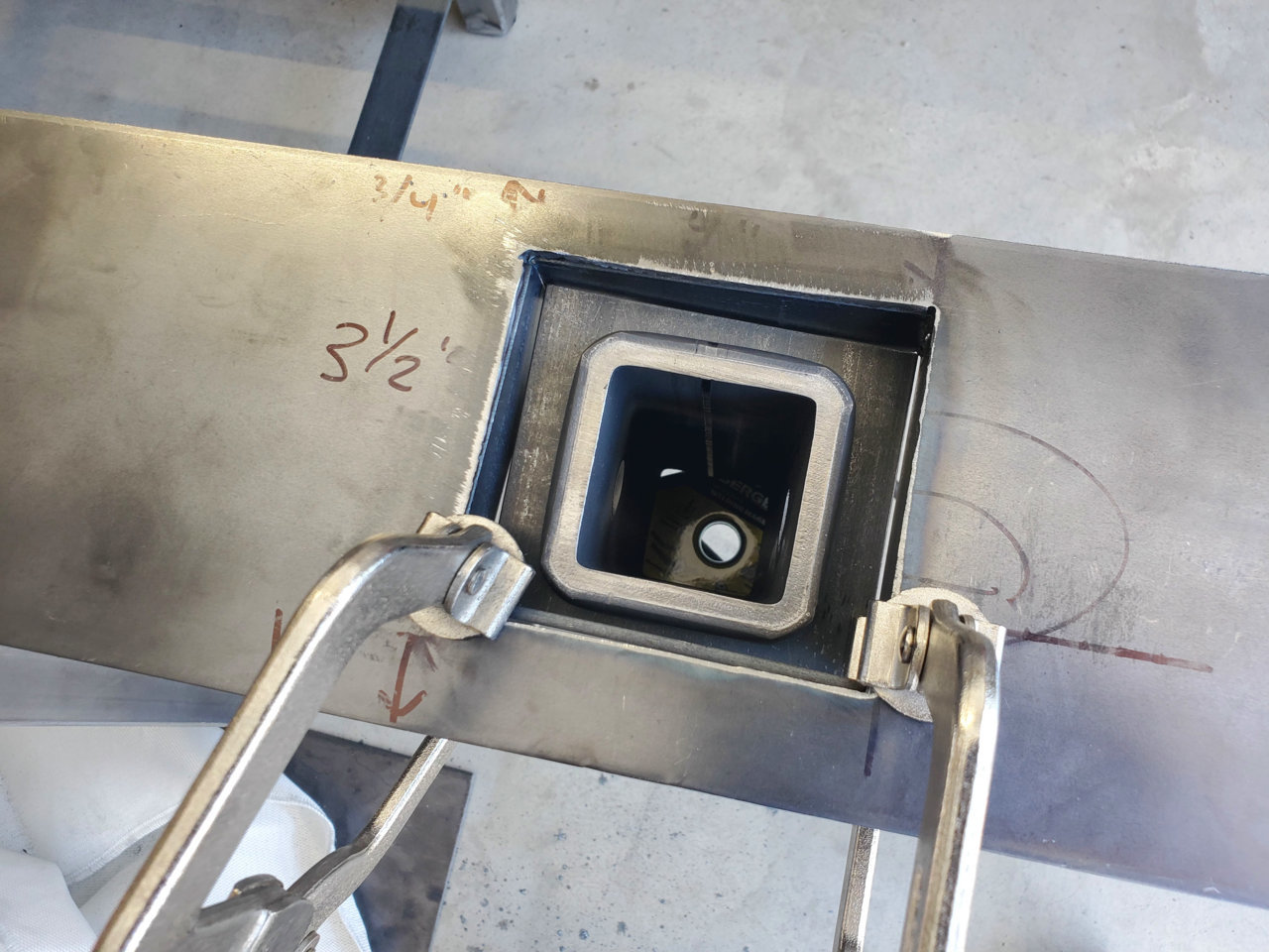

    I put way too much effort into this stupid thing, all for aesthetic reasons too :facepalm:
    Milwaukee mini cut-off tool for the win.
    Figured I'd get straighter lines on such a small cut out versus the plasma cutter.
    Test fit.
    Least the hitch face is done, just need to tack it up.
    Lock pin will be accessible from underneath the bumper as this was all thought out.

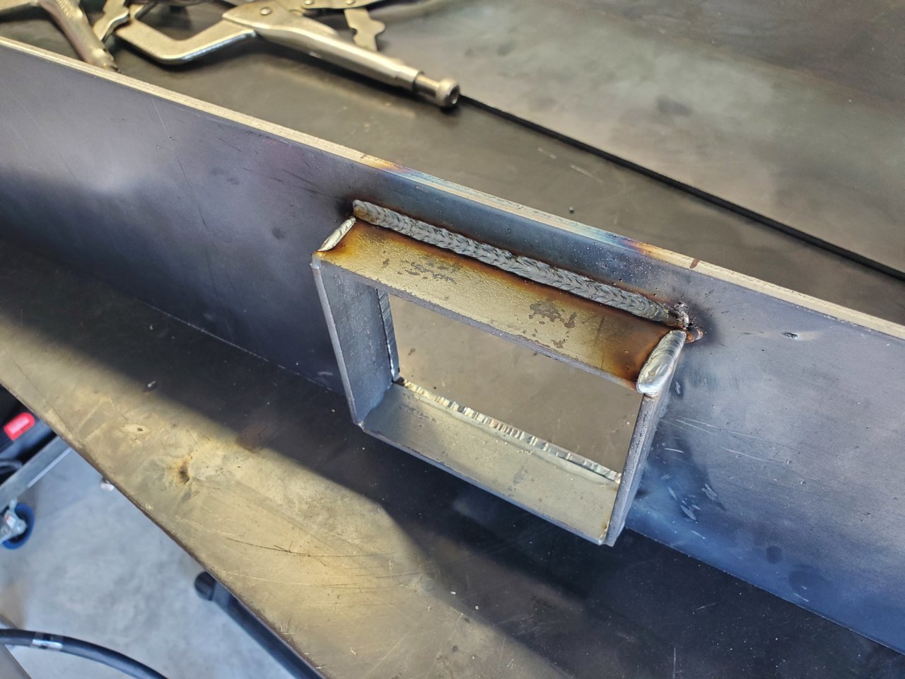

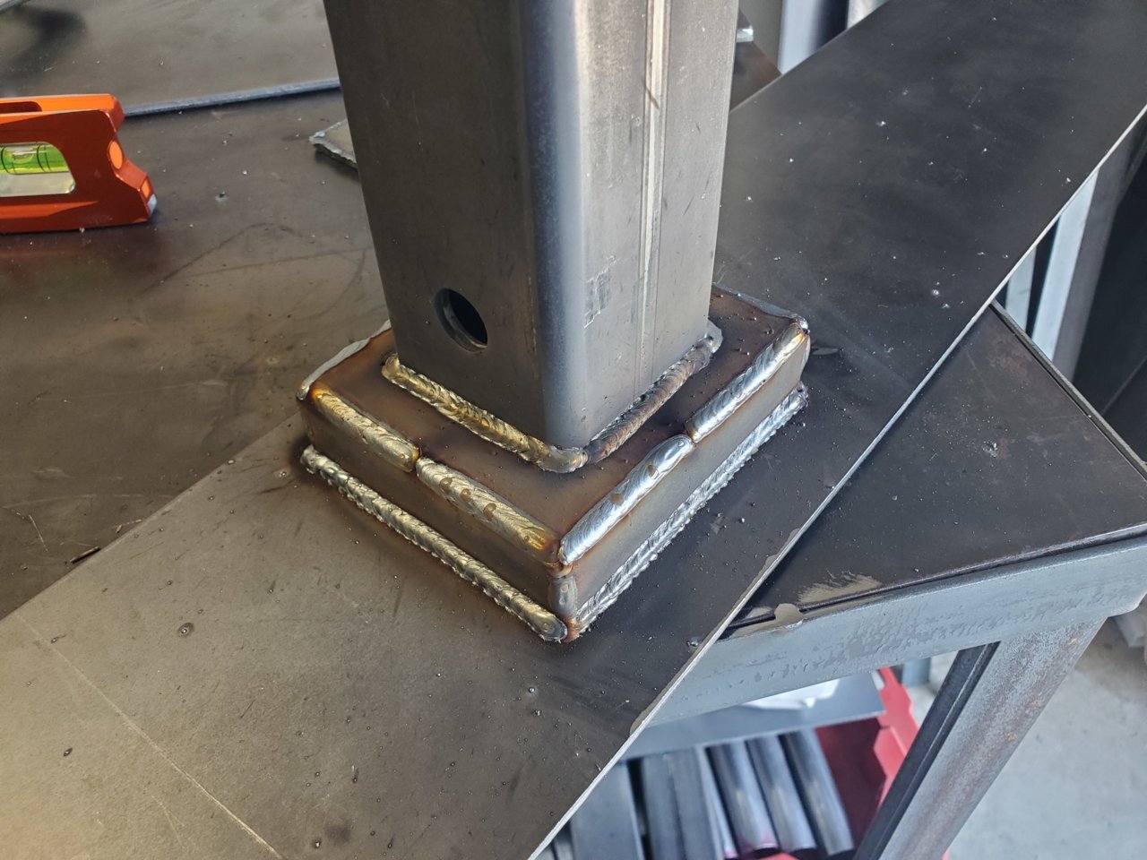

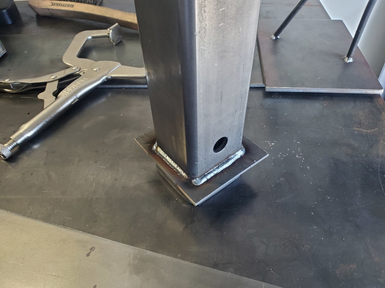

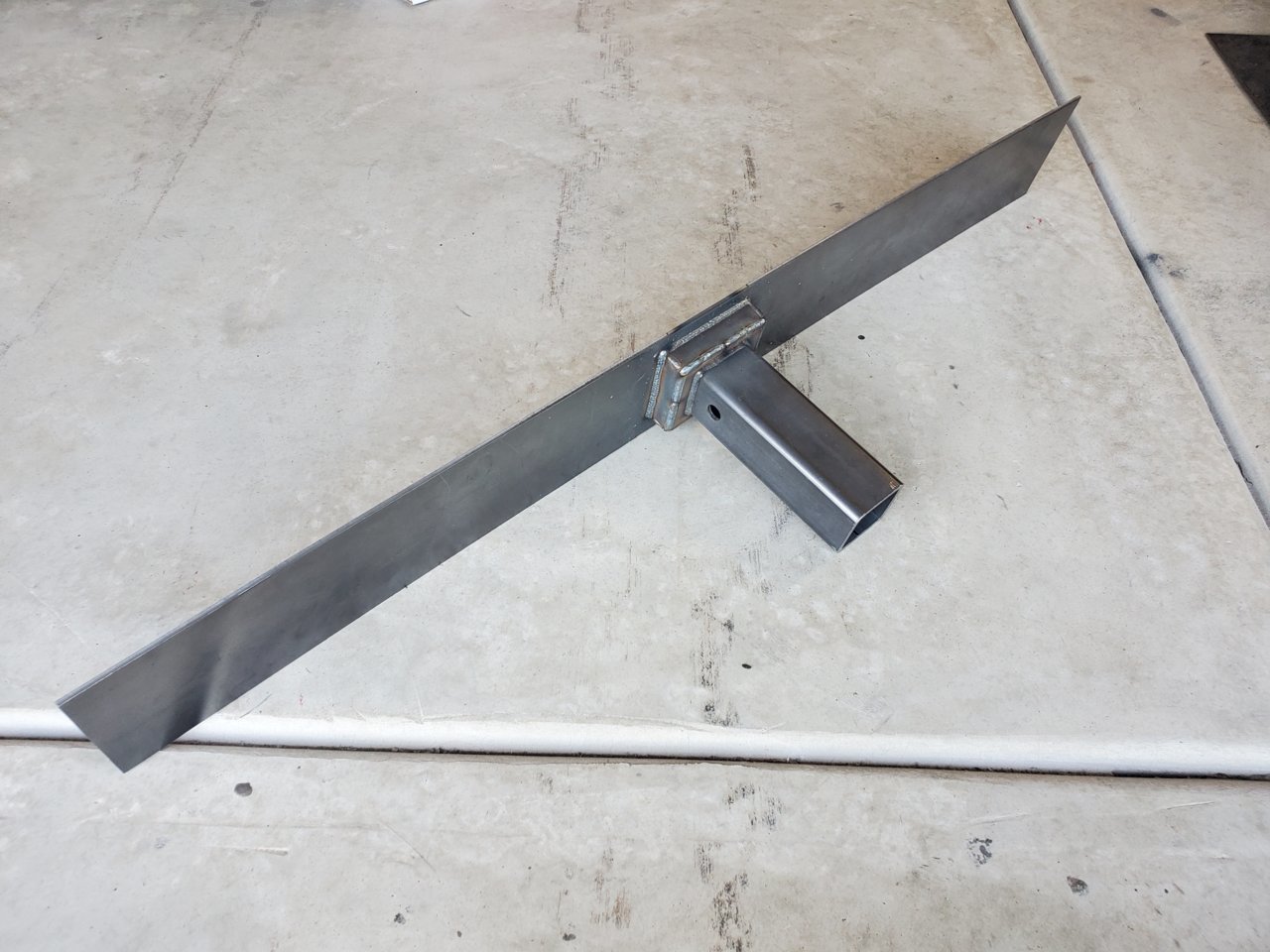

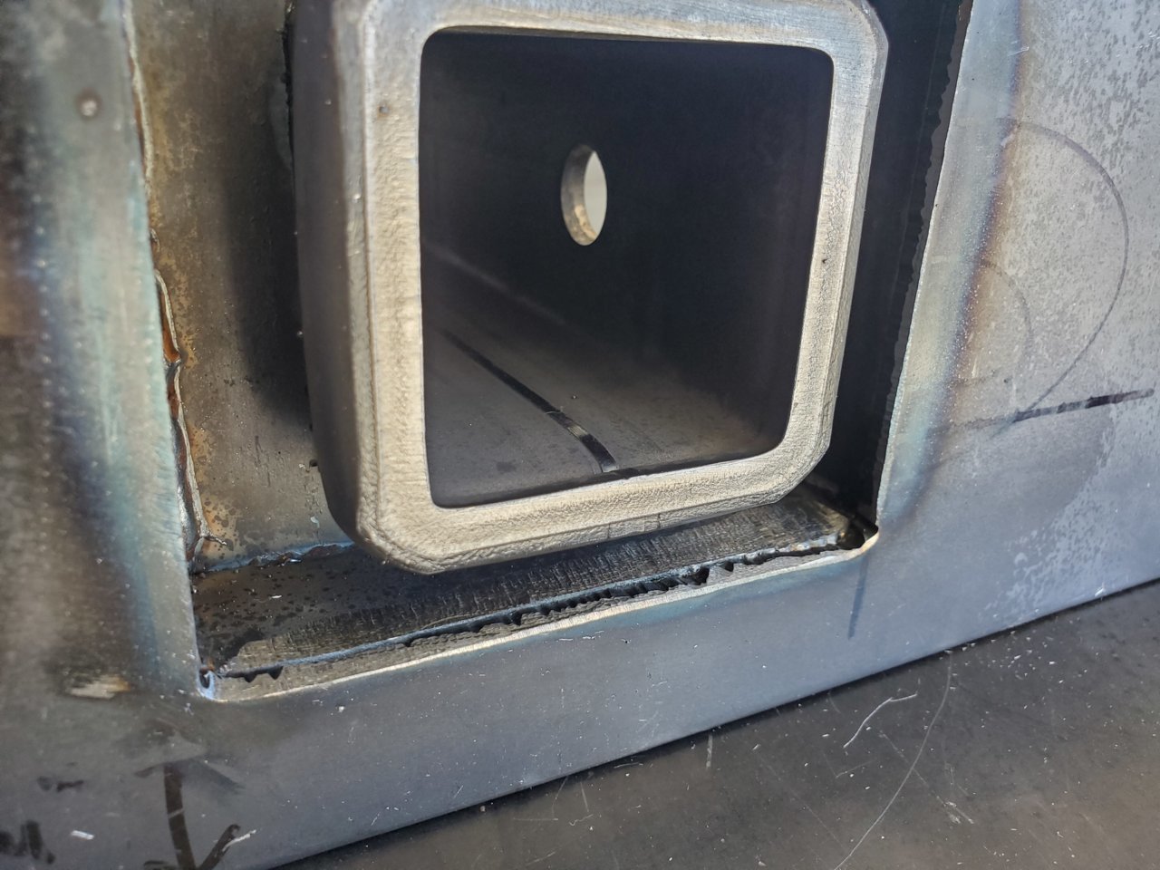

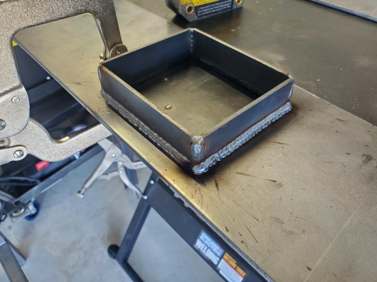

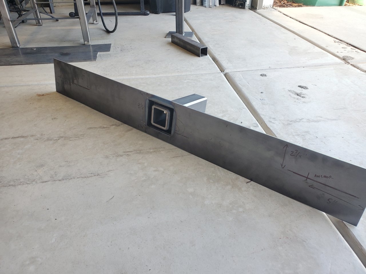

    With a slight bit of motivation, I pushed myself to do some welding.
    It's a tad colder than I'd normally run, but this is a non-structurally item as it's just an aesthetic piece.
    Next up was getting the "face" and the hitch welded together. I figured if I get this square and even all around, I can use it to better gauge getting squared on the bumper face.
    Once I got it squared up and tacked, I went to town.
    Not the best welds, but I had clamps in the way as I wanted to keep the face from warping due to the heat.
    Here it is!
    Only thing bugging me is being able to see that lip just below the hitch. That's what I get for plasma cutting the face.
    Think I should get a die grinder to get it smooth? What do you guys think?
    Yota X, Gunshot-6A and Taco critter like this.

    6,504
    Planet: EARTH
    What did you set it at? Temp and feed speed
  10. Aug 8, 2022 at 6:29 PM
    #890
    Kwikvette
    Kwikvette [OP] Well-Known Member Vendor
    Feb 27, 2019
    #284735
    82,889
    Fresno County
    4 run, 2 don't
    On 3/16" I normally go 21v and somewhere around 280 give or take.
    Currently at 20v and some 240.
    Have to remember, settings on one machine give different results on another machine on the same steel even.

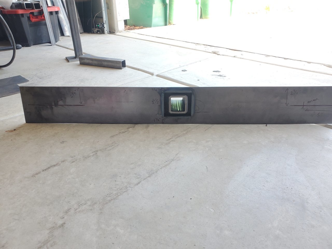

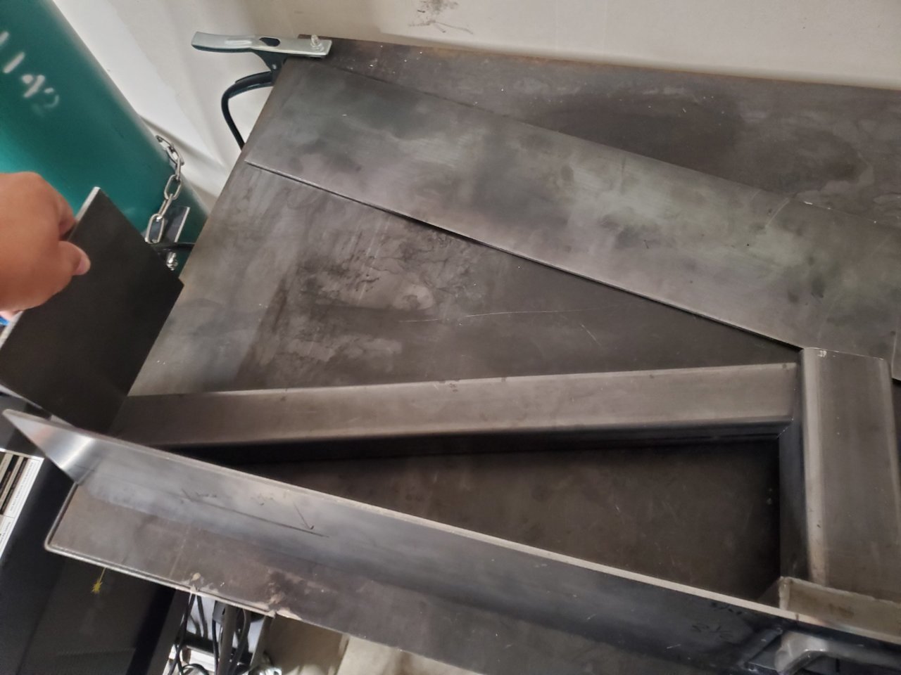

    Well, this is what I get for saving $10.
    The hitch receiver I'm using was originally intended for the 4Runner I used to have. I thought nothing of the length and went with it.
    Today, I figured I'd do some drawing up (back's killing me) since I can do that at my bench.
    With the face done, it's easier to visualize what I want to do as far as support.
    Getting the right angle and measurements is important so I mocked up my frame rails; they're 2 1/8" wide rectangular tubing.
    For maintaining some structural integrity, I intended to use the inside bolt holes that were used for the spare tire carrier.
    Here's the issue, the closest bolt holes are located quite a bit off of where the square tubing support would land. This would mean, whatever plates I use between the frame rails would need to be at least 11 1/2" long.
    This makes no sense.
    I could do one of two things:
    1. continue with the above support tubing, and weld plates on the ends of them, and weld those to the inside of the frame rails
    2. run square tubing for the total width between the frame rails, weld plates on each end, and bolt those into place all while welding the end of the hitch to the newly formed crossmember
    I do like option 1, but that means I'll have to deal with more of a hassle with cutting stuff off that's close to the crossmember.

    Would drilling holes where you want them be an option?
    I’m not sure I’m understanding the problem though.

    I want to use pre-existing holes.
    I'll just need to cut longer lengths of square tube to bring them back far enough to weld plates I can bolt in.
    Drill press arrives tomorrow.
    I want to minimize on-ground work as much as possible.

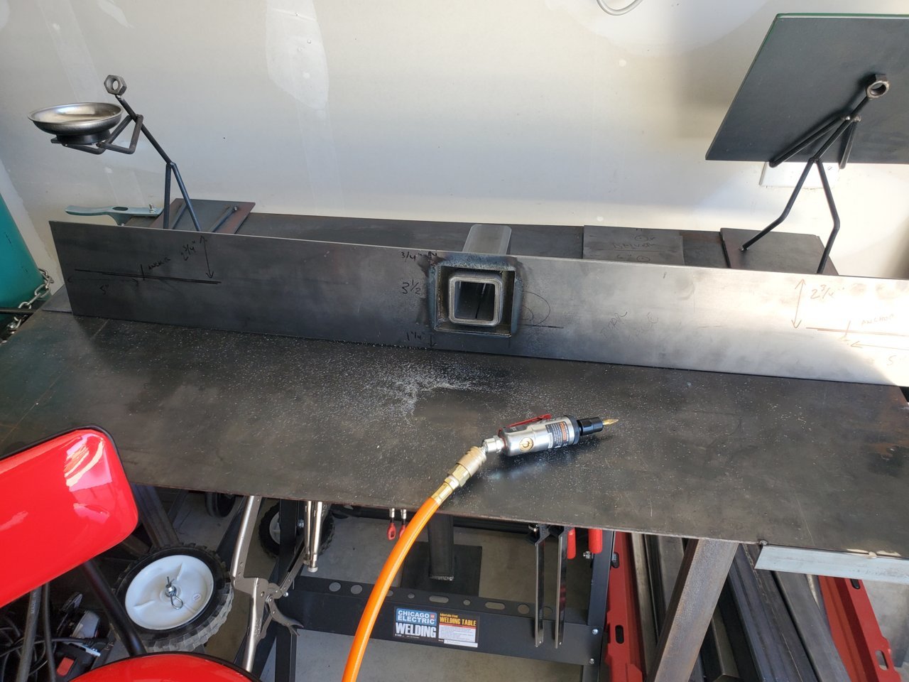

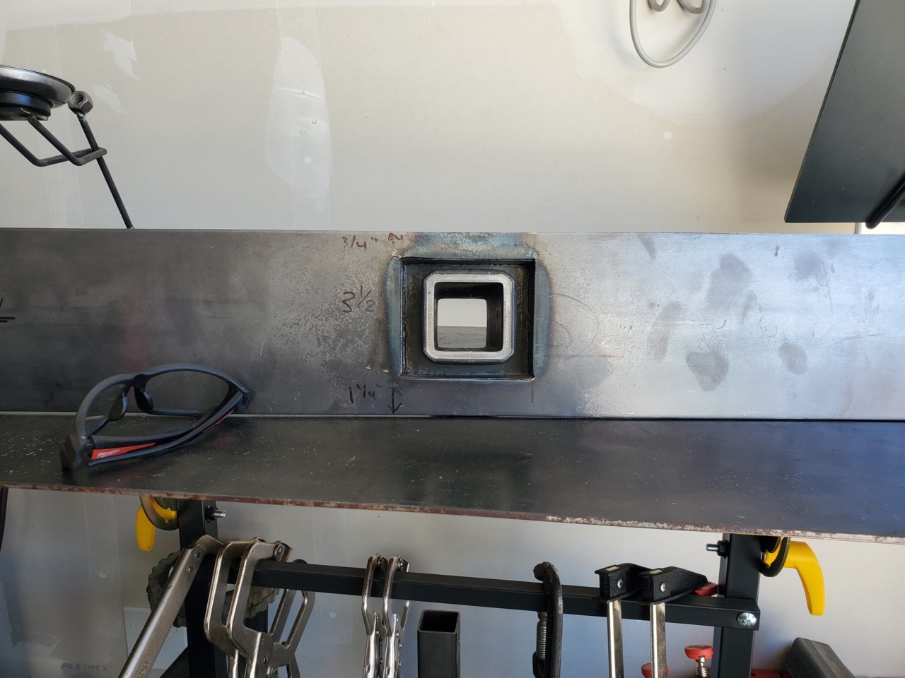

    What I did get to try out, which I was going to tag you for, was my die grinder.
    You remember I got myself that cheap Chief mini die grinder from Harbor Freight.
    Figured the important part was the burr bit so I got to put it to use.
    Got a swivel so I won't feel restricted.
    This thing just easily melts metal away. It didn't bog down a single time even though I had both the regulator set at 70psi and the built-in regulator for the die grinder set to 3/4.
    Air compressor kicked on for maybe 3 seconds and that was it, all done.
    That huge overlap is gone.
