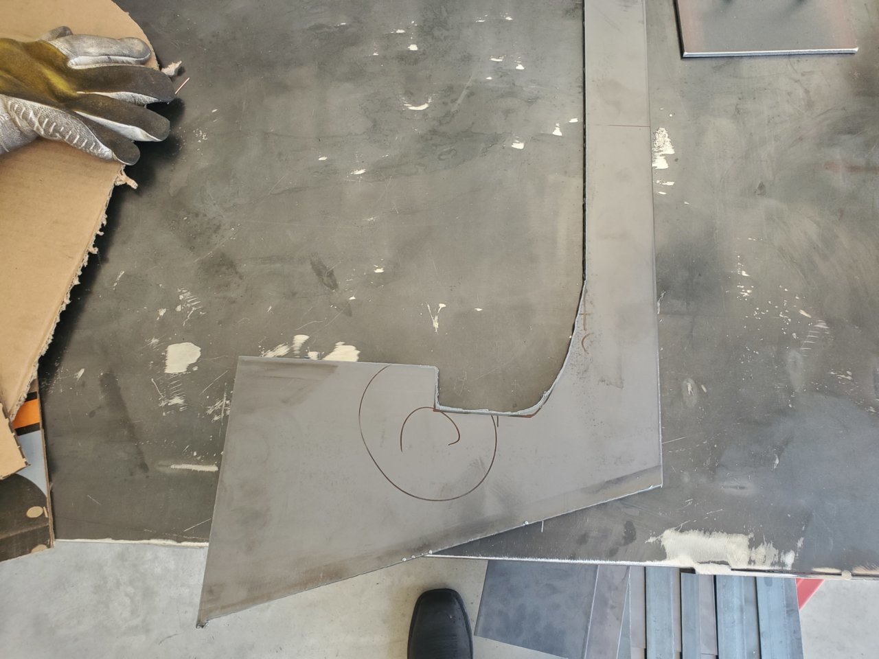

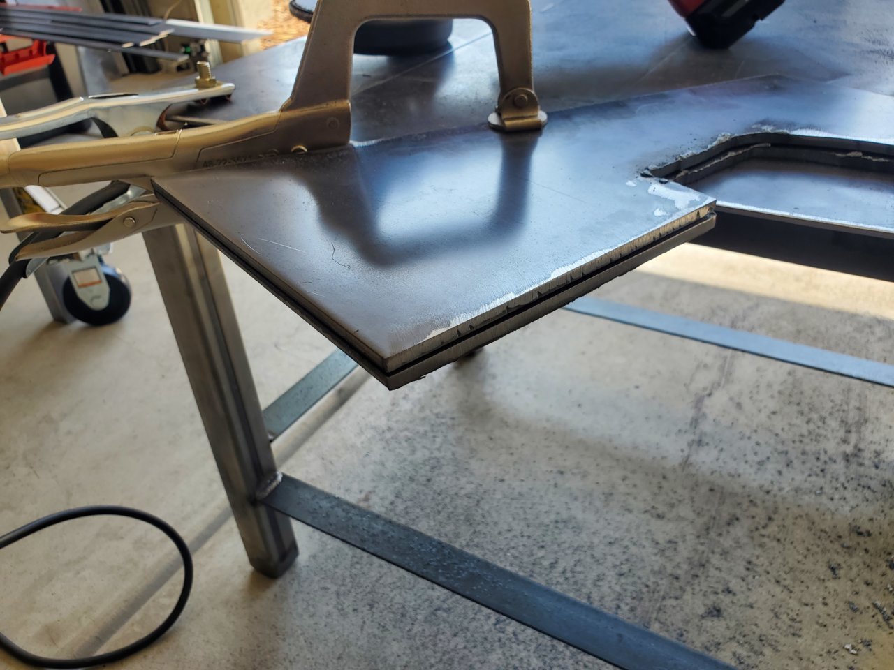

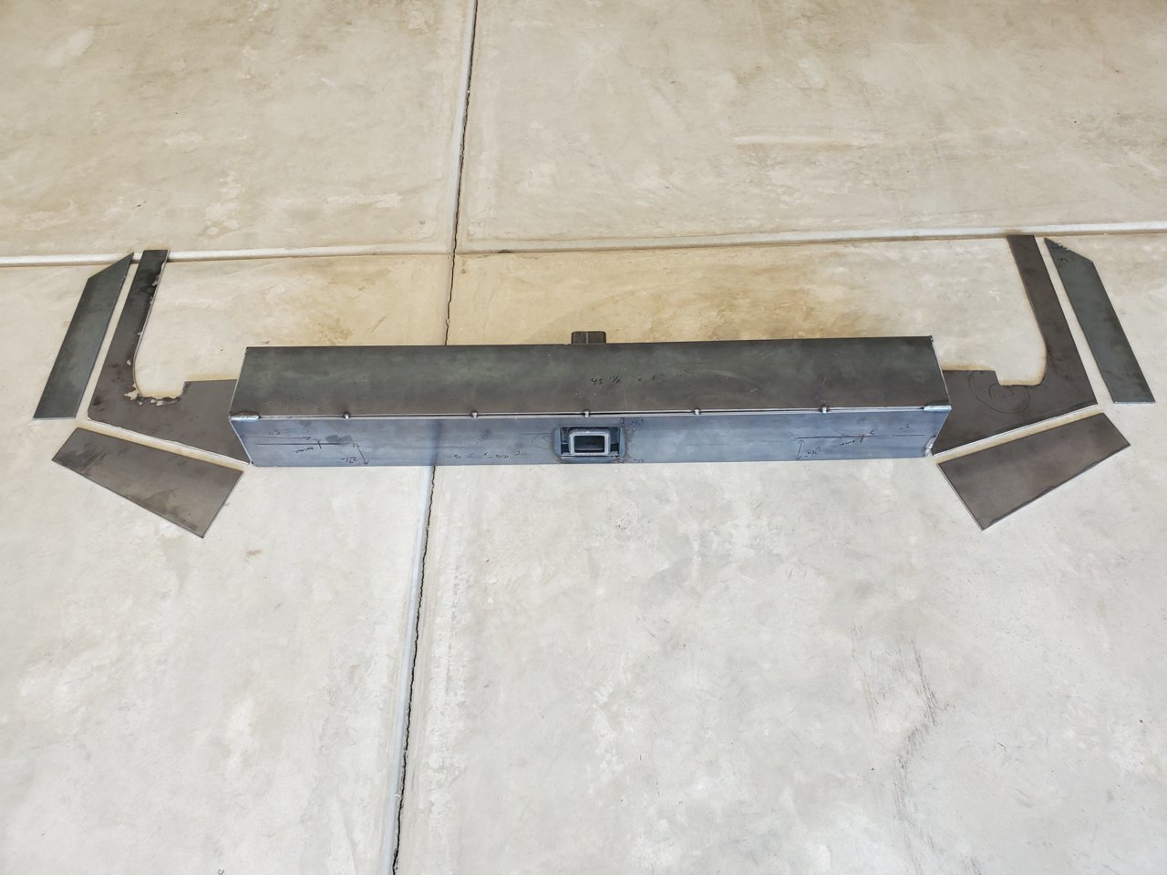

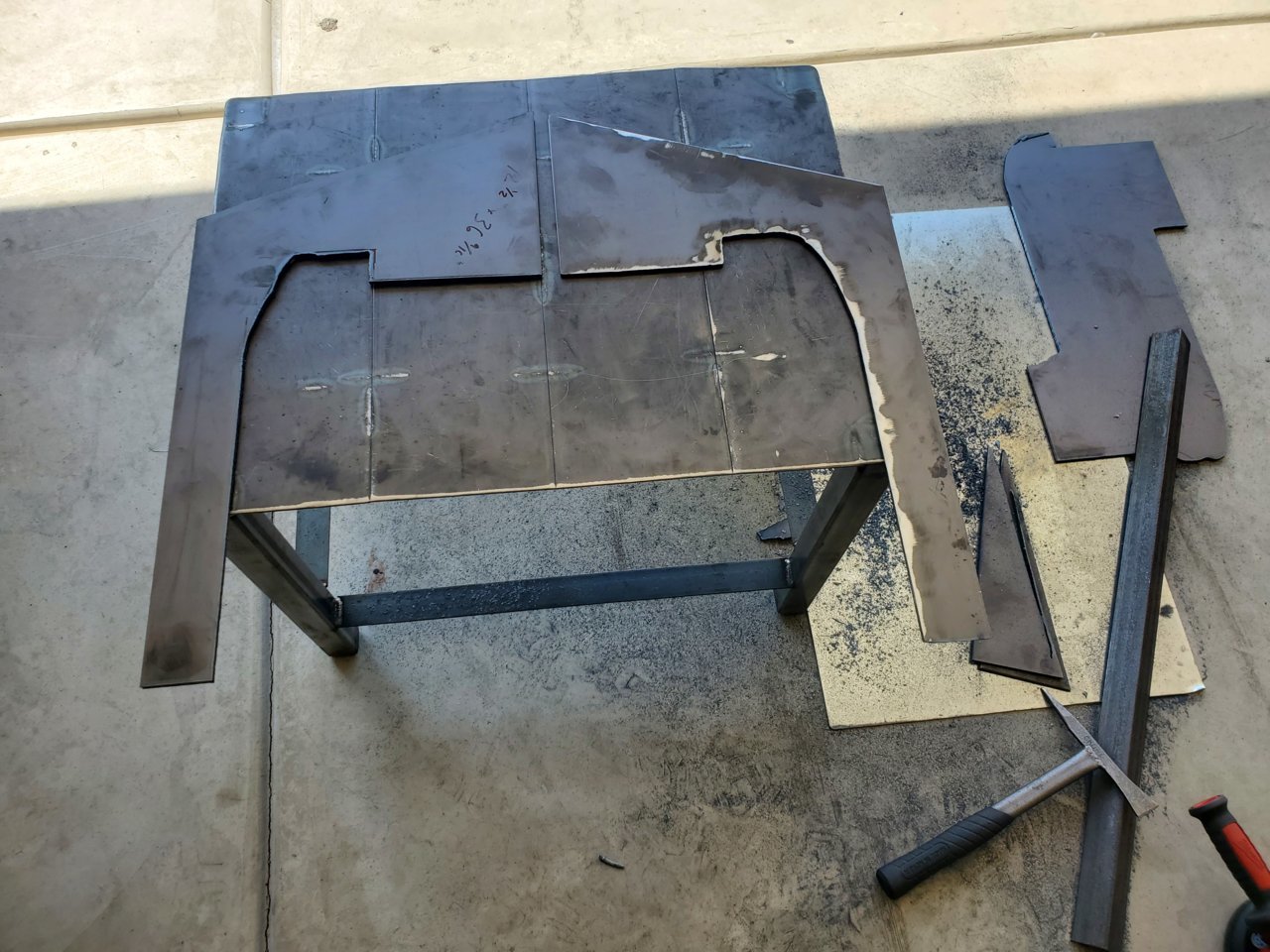

    Adding a little progress.
    After figuring out the general idea for my wings, I thought I'd get some metal cut to get a good idea of fitment.
    Here you'll see I've taken the cardboard templates and transferred them onto steel.
    Fortunately I've got a lot extra in case I fuck up :laughing:
    Being happy with the first one, I thought I'd continue onto the second.
    Here they both are!
    Going to take my time here to shapen them up and get nice even surfaces before I proceed with making the side and bottom panels.
    jubei and Rezkid like this.

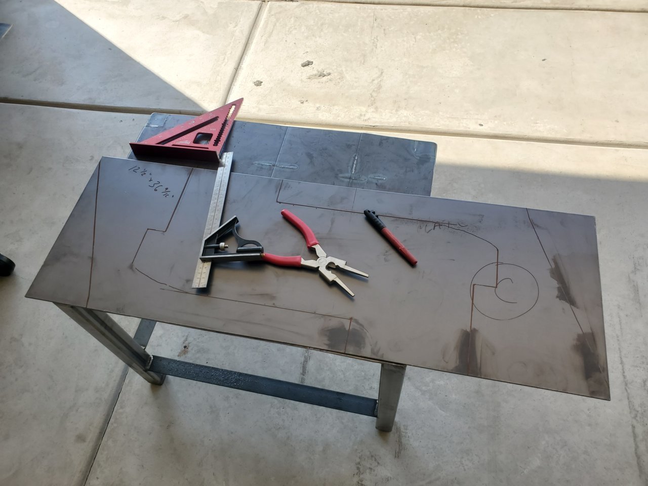

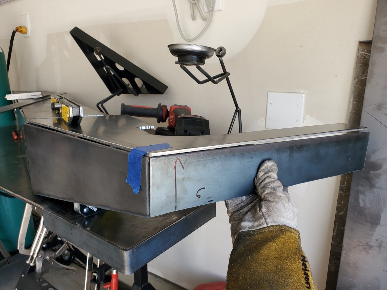

    And this is why I wish I had a CNC plasma setup; I'm stacking these parts and going all around making sure they're both mirror images of each other.
    Still need to carve out that inner curve.

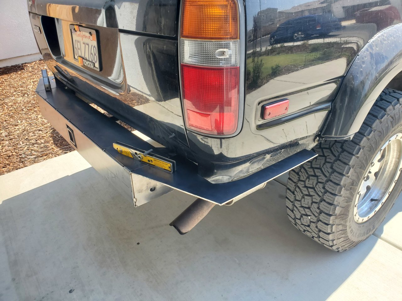

    Starting to take shape.

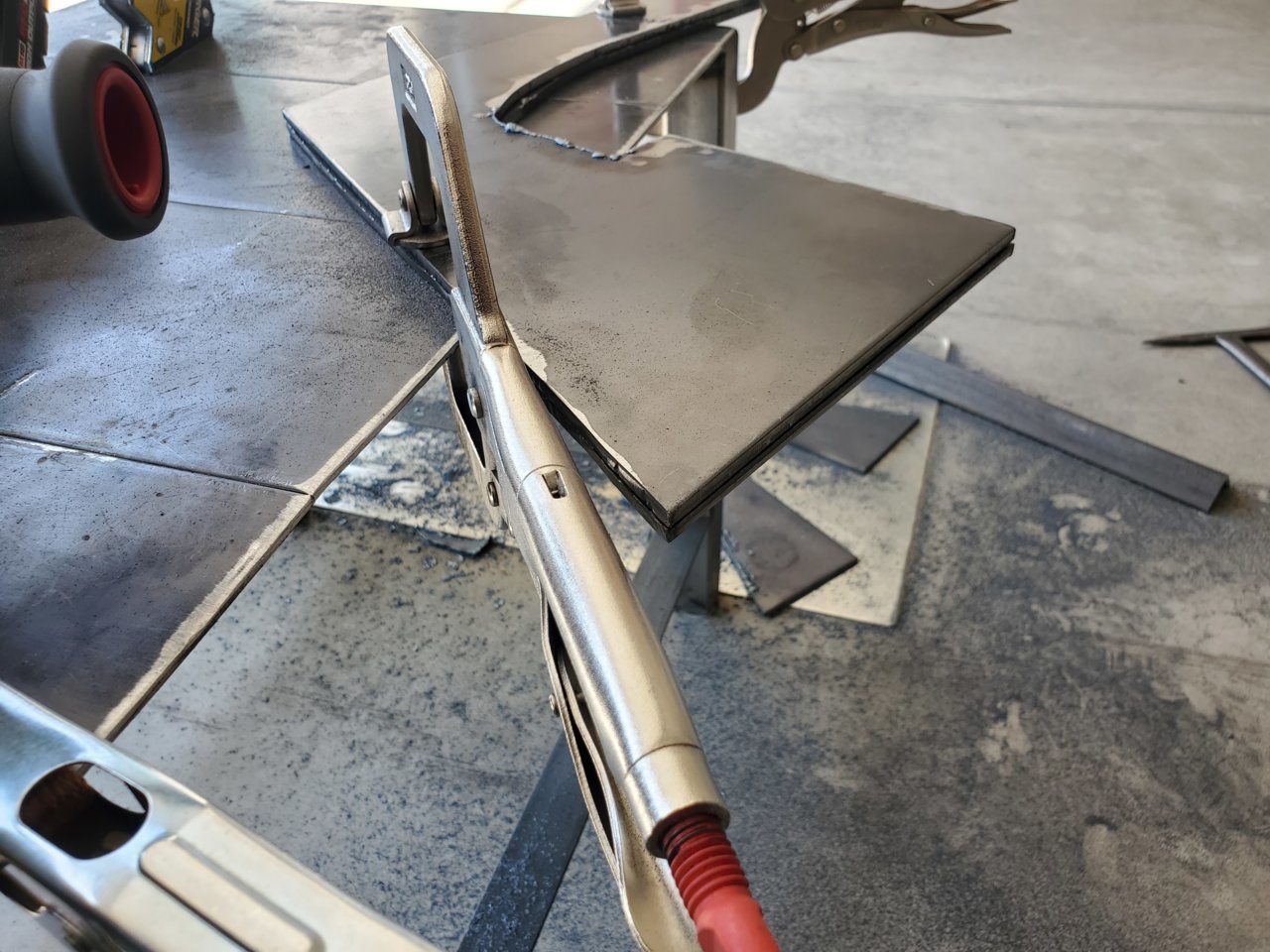

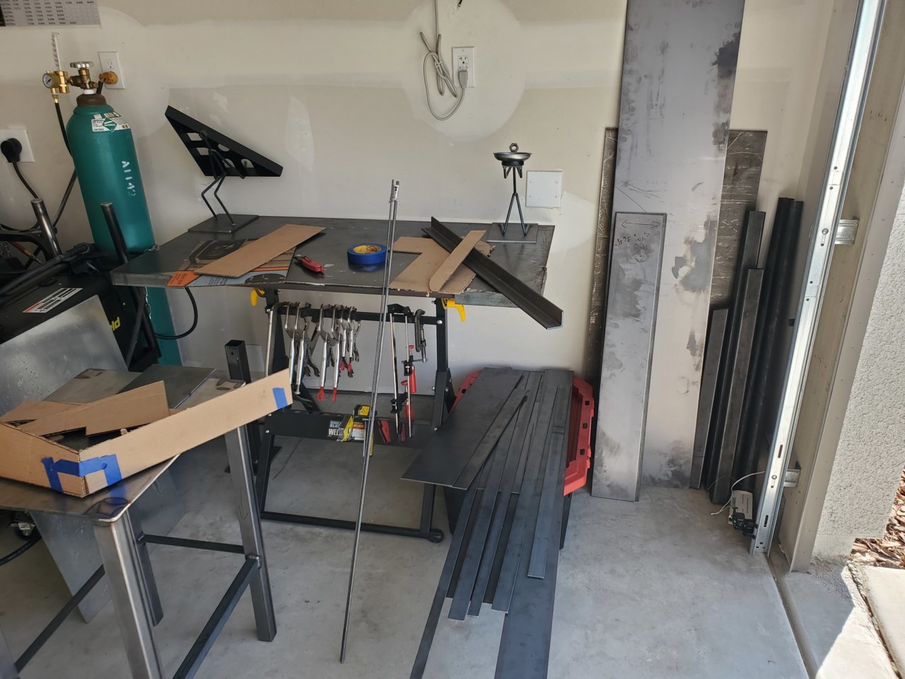

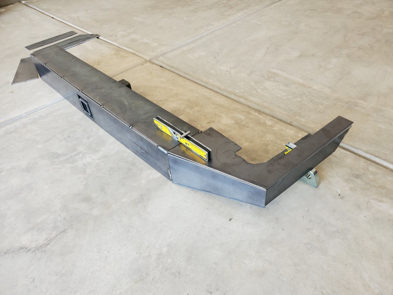

    Been feeling productive lately so thought I'd revisit my cardboard templates one more time.
    Onto cutting!
    Really coming together looking like a kit :laughing:
    Need to work on the bottom plates for the wings and start measuring out some gussets.
    Zebinator and essjay like this.

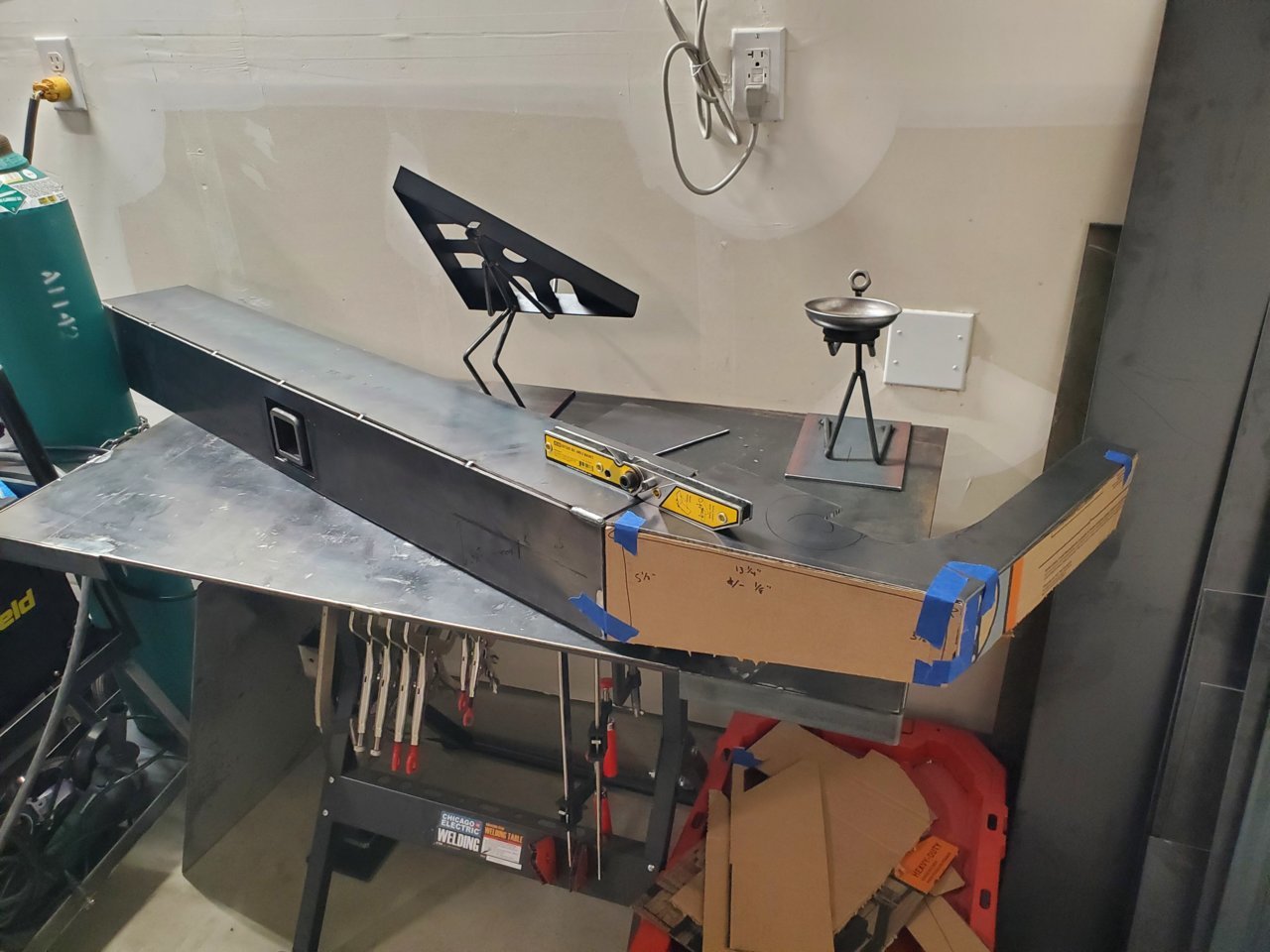

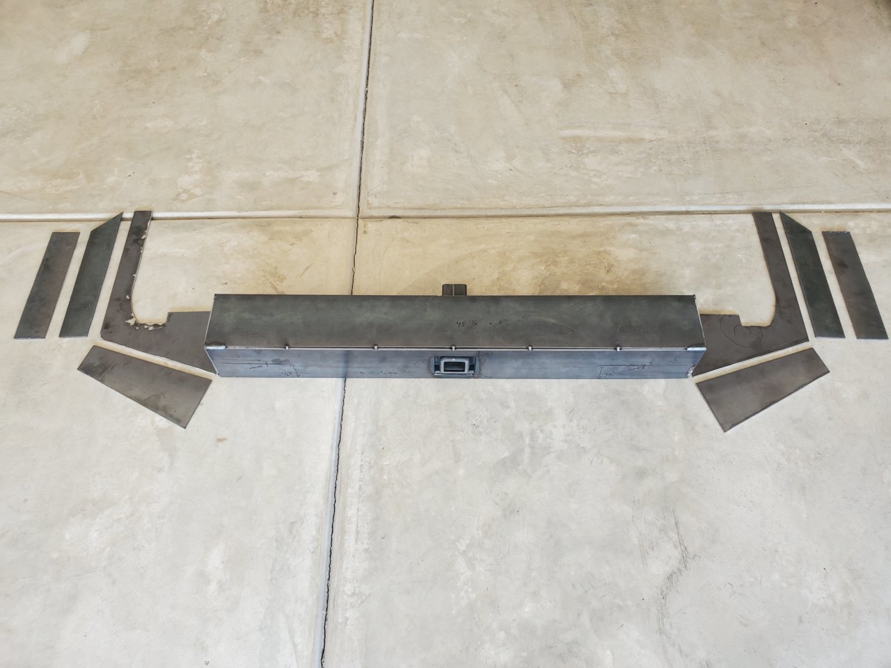

    Did get the bottom panels of the wings cut at least. Now to hit them with a flap disc and get everything cleaned up and even.
    Welding up the "base" of the bumper would have to be next before I tack the wings up against it.

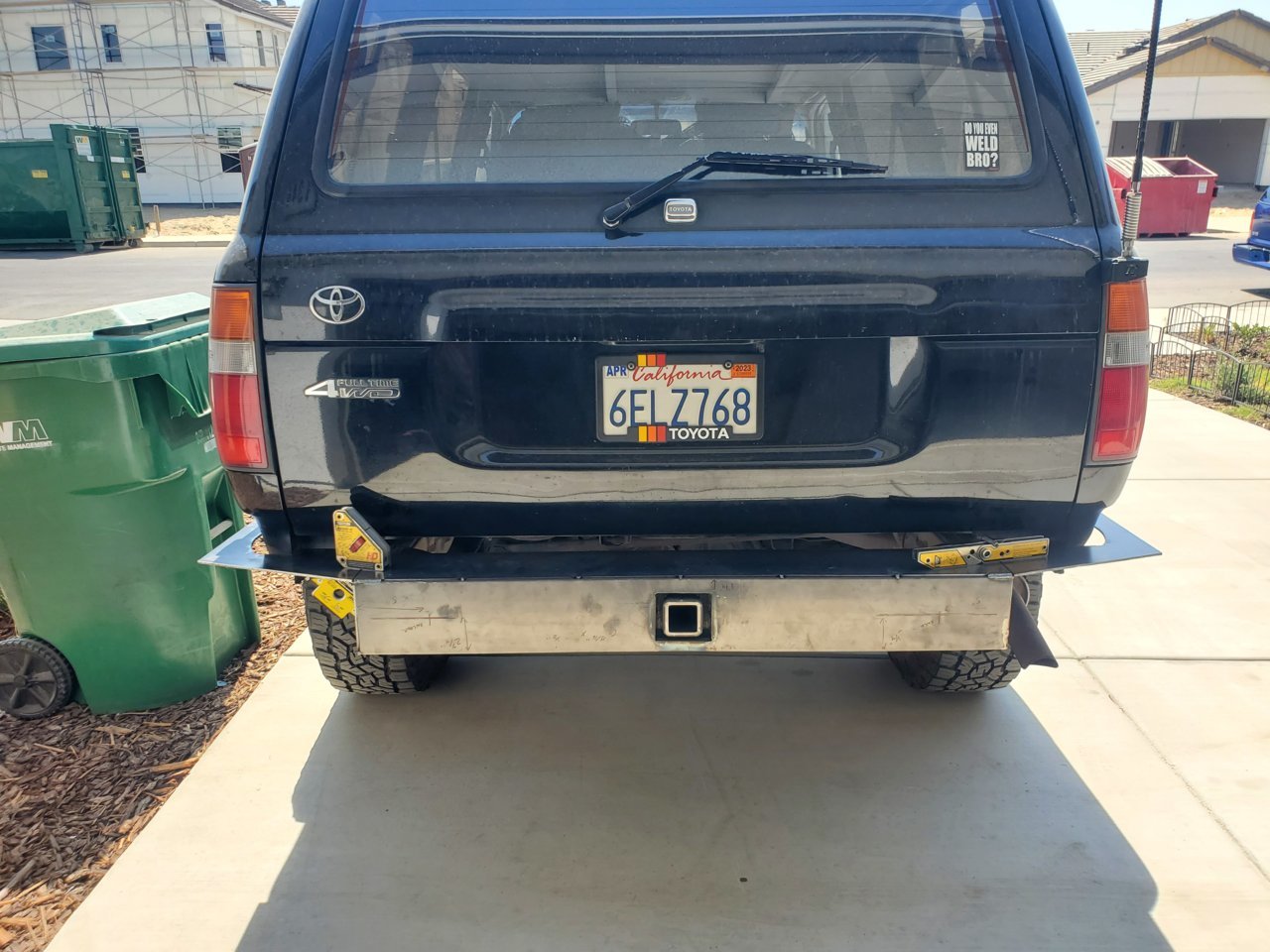

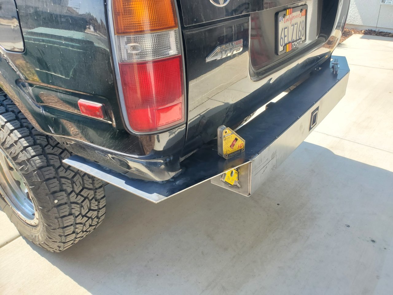

    Mock up.
