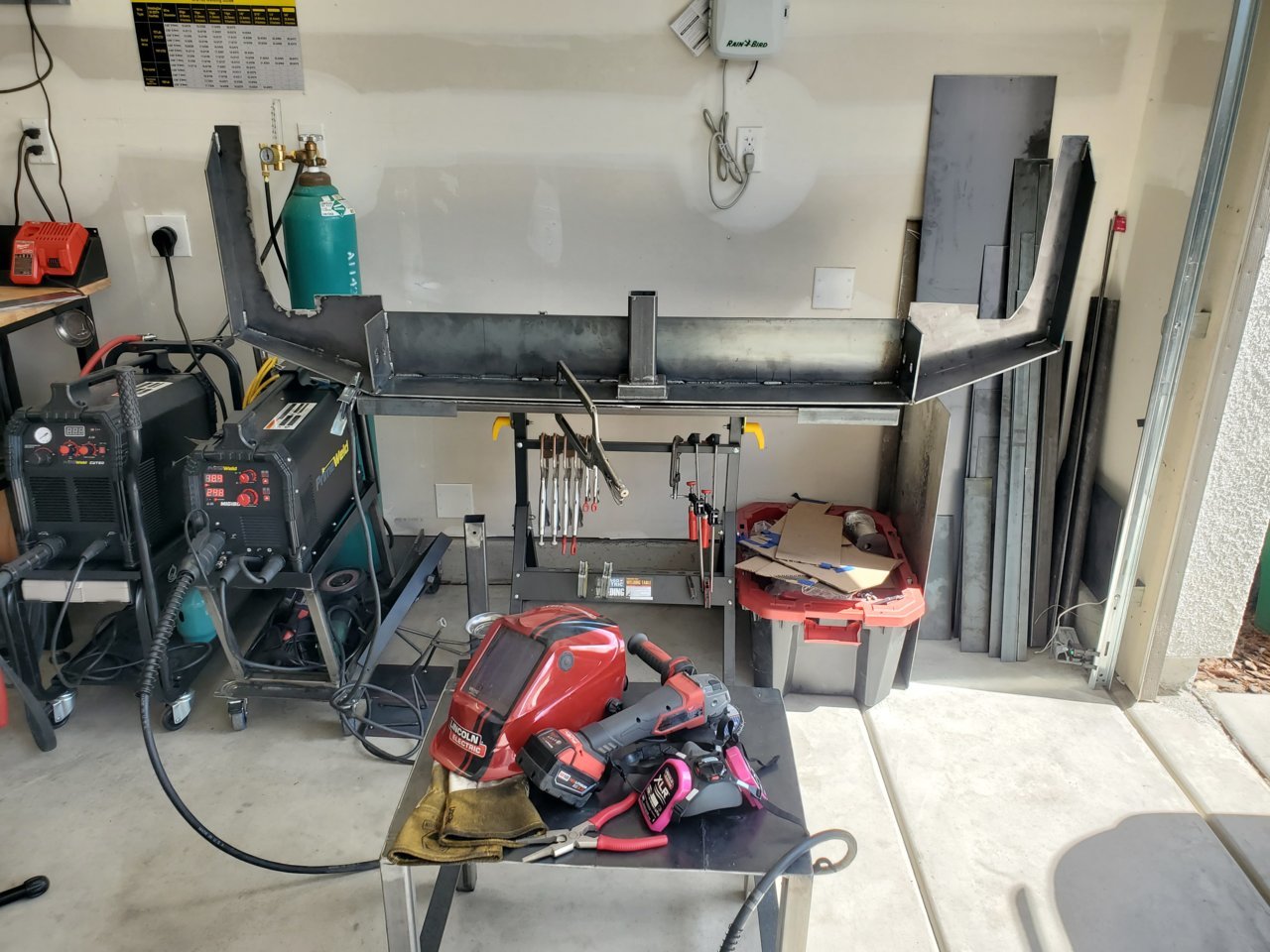

    Hmmm...this whole side thing has got me stumped from an aesthetic standpoint.
    Using the second pic, looking directly towards the back I can make it "step up" in the form of a triangle and square it up top.
    But part of me says it'll look bulky.
    I won't have to scrap the major pieces I've cut and really, I'm close to just tacking them in place versus using magnets to hold them up.

    No more magnets; all tacked in place.

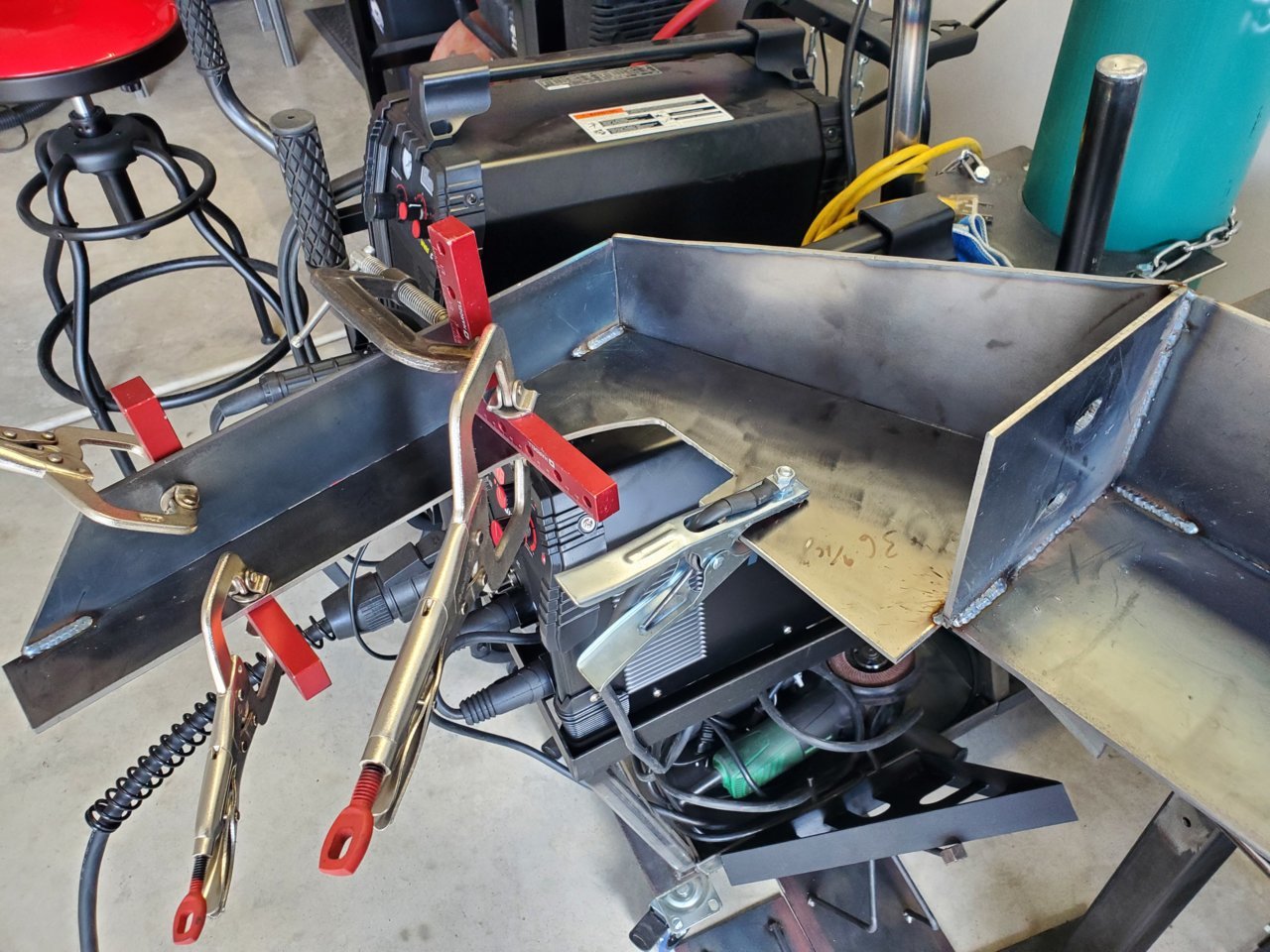

  14. Sep 20, 2022 at 12:26 PM
    #1034
    Kwikvette
    Kwikvette [OP] Well-Known Member Vendor
    Feb 27, 2019
    #284735
    82,913
    Fresno County
    4 run, 2 don't

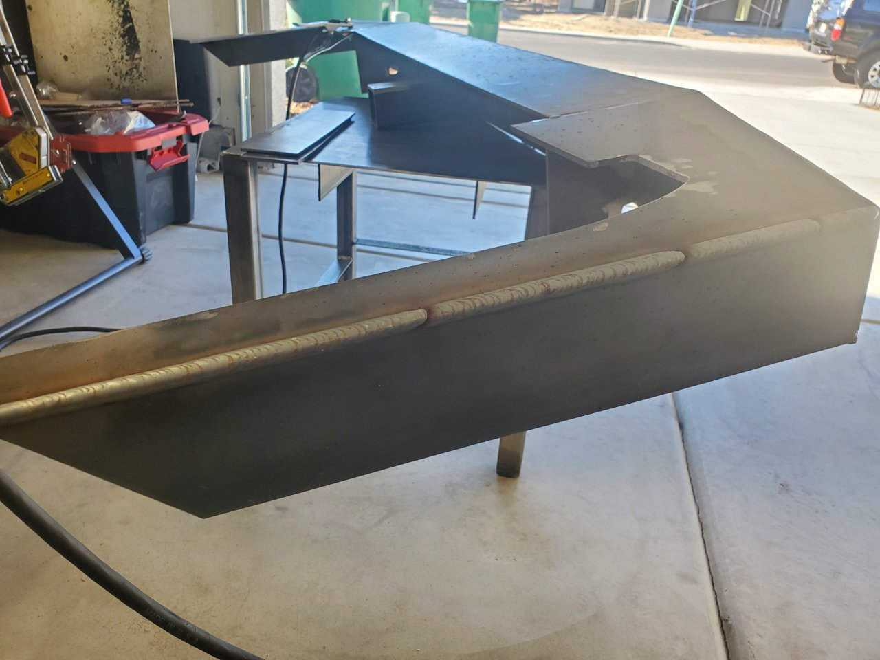

    For the meanwhile, running short seams on the inside before fully welding the outside.
    Wulf likes this.

  16. Sep 20, 2022 at 1:15 PM
    #1036
    Kwikvette
    Feb 27, 2019
    #284735
    82,913
    Fresno County
    4 run, 2 don't
    All the seams on the inside are done.
    You don't need to fully weld both sides, as long as the ends are all tied in and it's got penetration it's all good to go.
    Damn thing's a lot bigger than my welding table.
    Taco critter likes this.

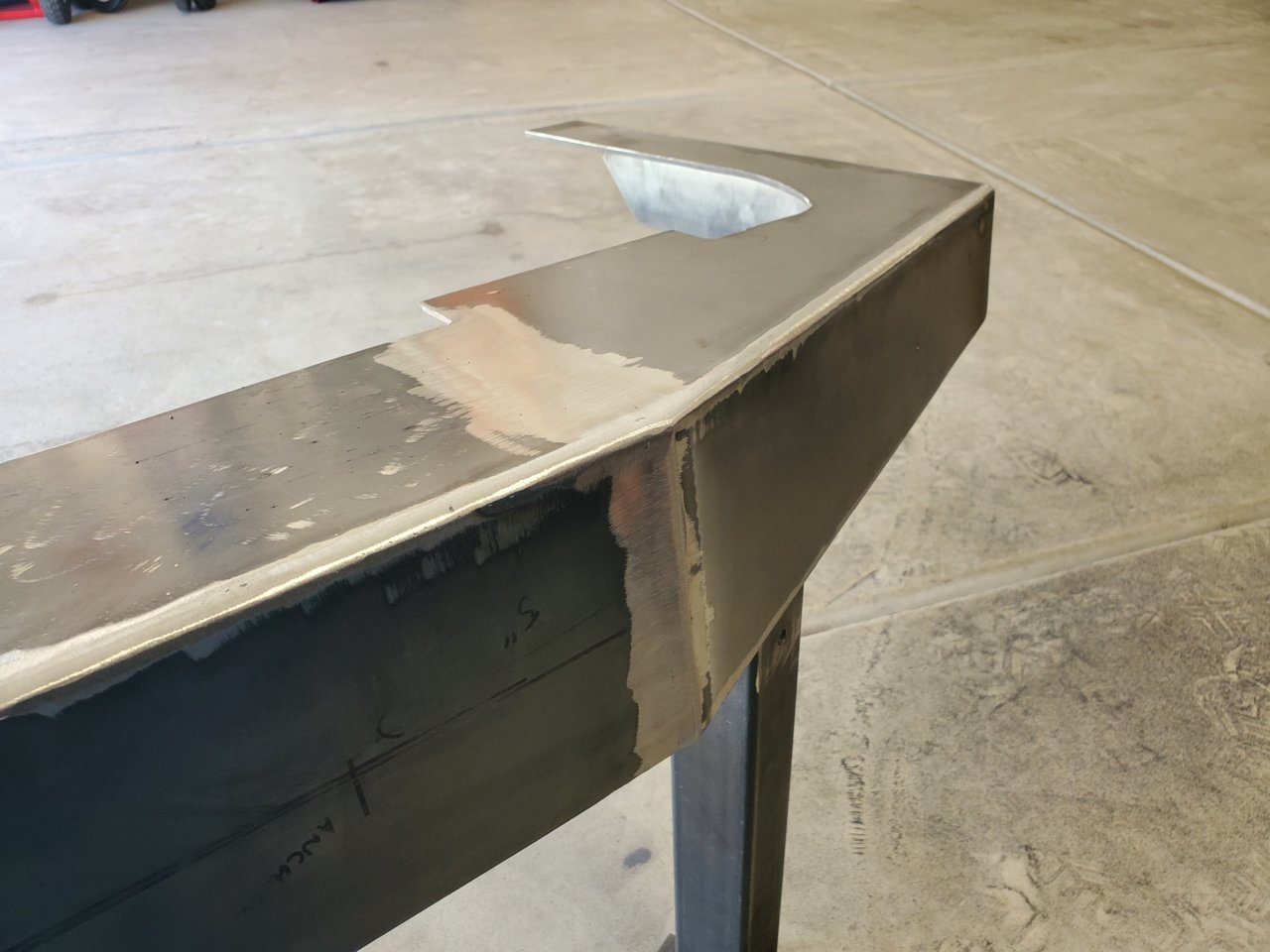

  17. Sep 20, 2022 at 2:02 PM
    #1037
    Kwikvette
    Feb 27, 2019
    #284735
    82,913
    Fresno County
    4 run, 2 don't
    Break time, will continue tomorrow.
    Welding is one thing, especially long ass single beads like these.
    But it's the grinding that takes awhile. I want smooth lines where all parts meet to be rounded out on the outside.

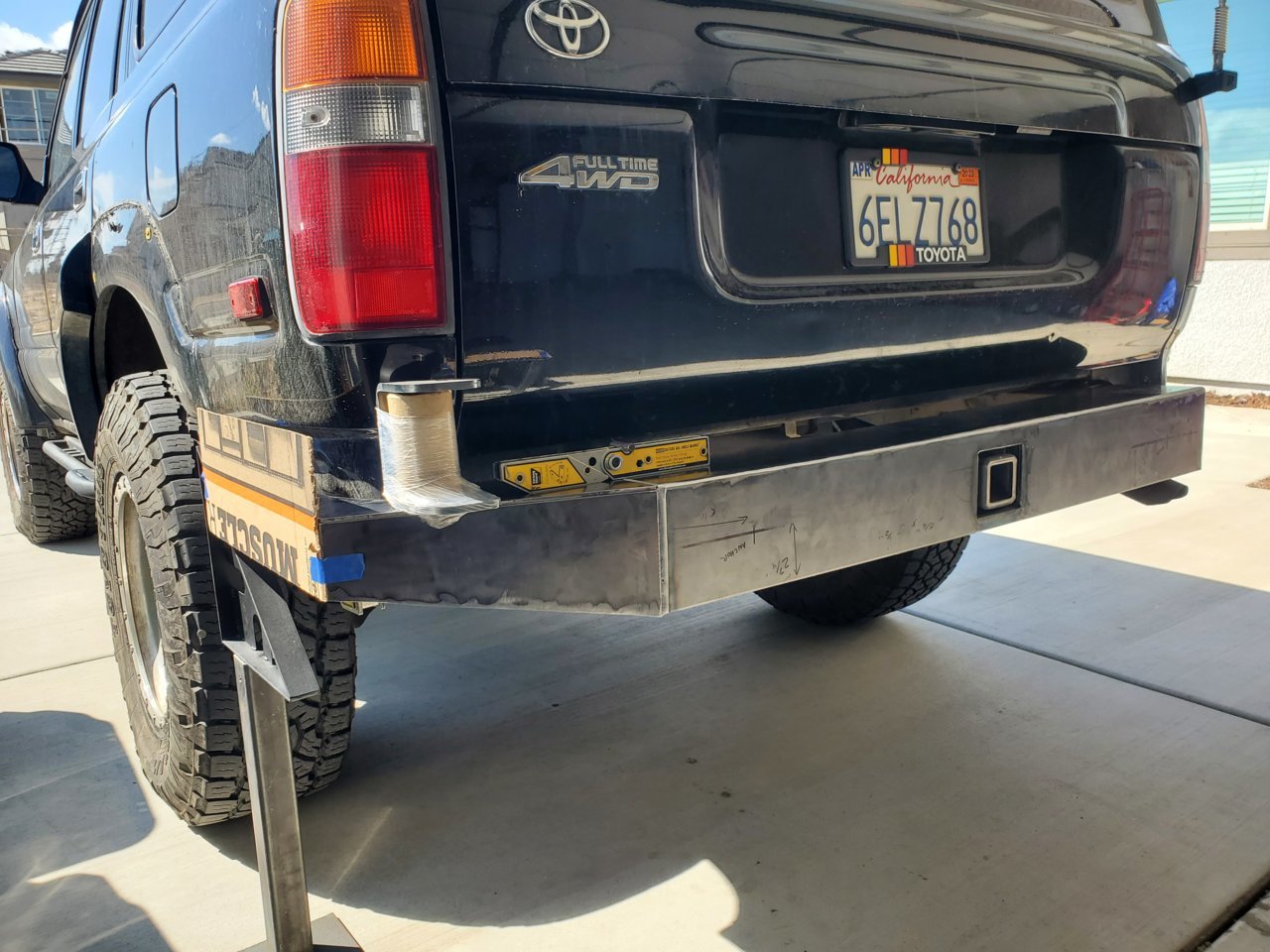

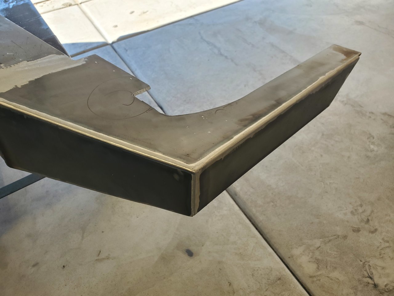

  19. Sep 22, 2022 at 10:55 AM
    #1039
    Kwikvette
    Feb 27, 2019
    #284735
    82,913
    Fresno County
    4 run, 2 don't
    Happy to say that I was able to knock out the remaining exterior welds, as well as blend all the pieces in.
    You're more anxious than I am :rofl:
    It's like @Wulf said it, starting was 80% of the battle and I hadn't really started until recently.
    A lot left to do;
    Gussets under the wings.
    Bottom plate for the wings but only after figuring out a mounting point to the frame rails.
    After that, the bumper itself will be done.
    Next step would be buying 2" square tube, 3/16" thick, and figure lengths for my swingout.
    I would like to ask on here, where does one buy a small delrin block or similar (not a round spacer) so I can use that with my stop? I see a lot of people use something similar to maintain gaps and prevent metal-on-metal.
    Rezkid and essjay like this.

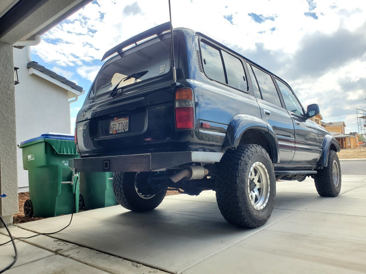

    No close-up here!
    Looks good from a distance since it's far from finished :laughing:
