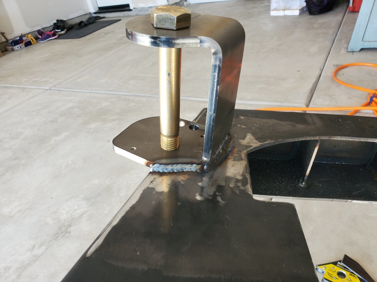

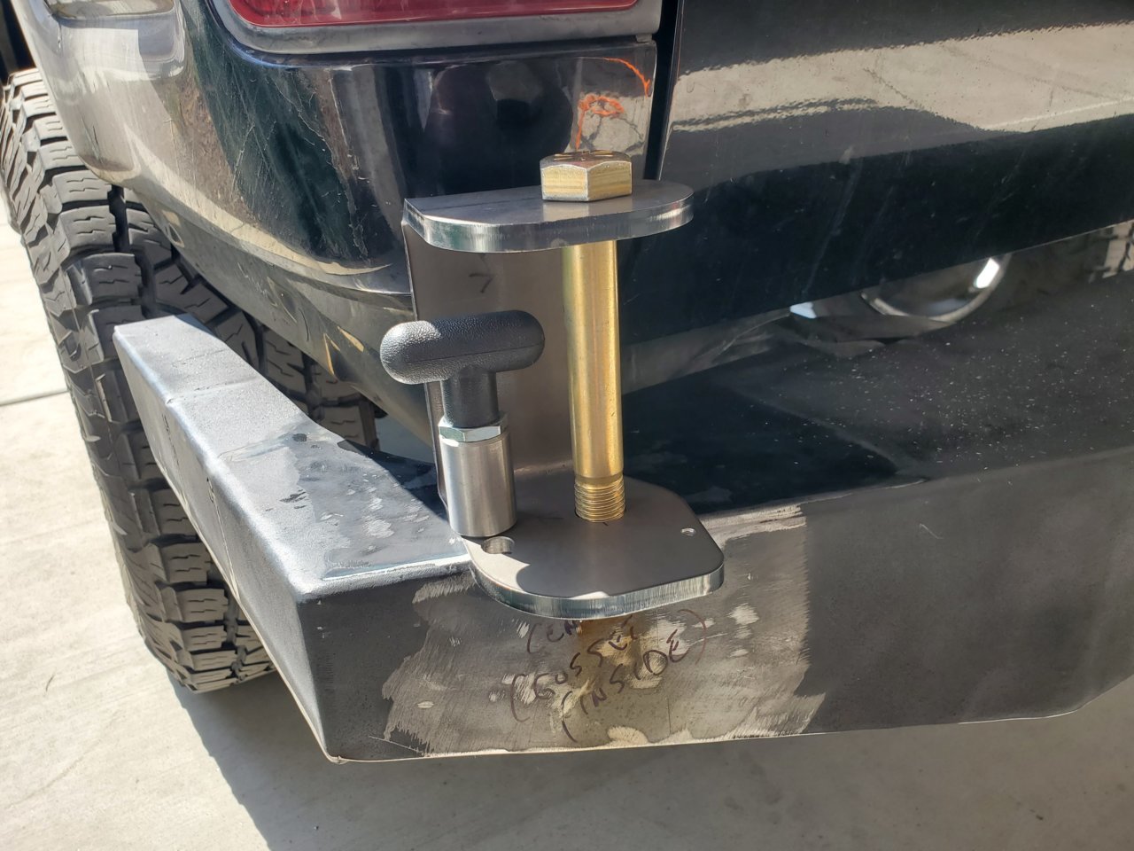

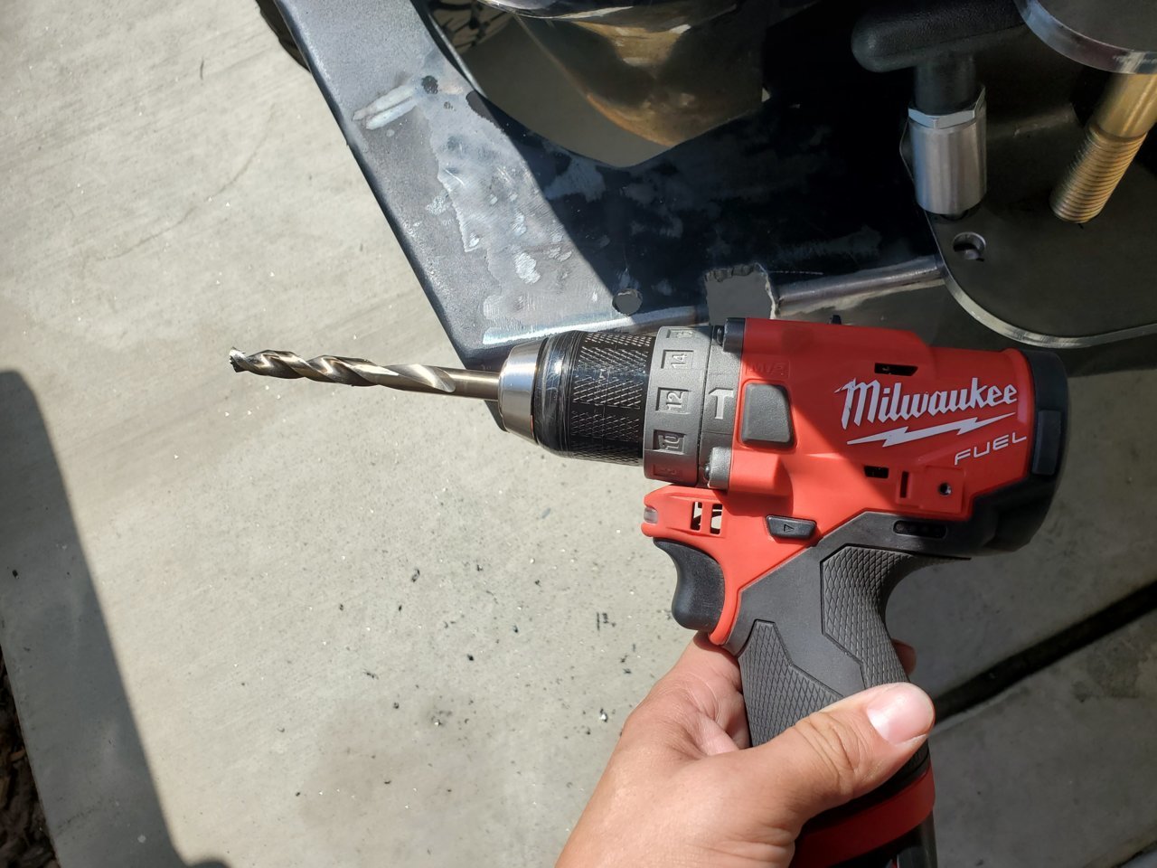

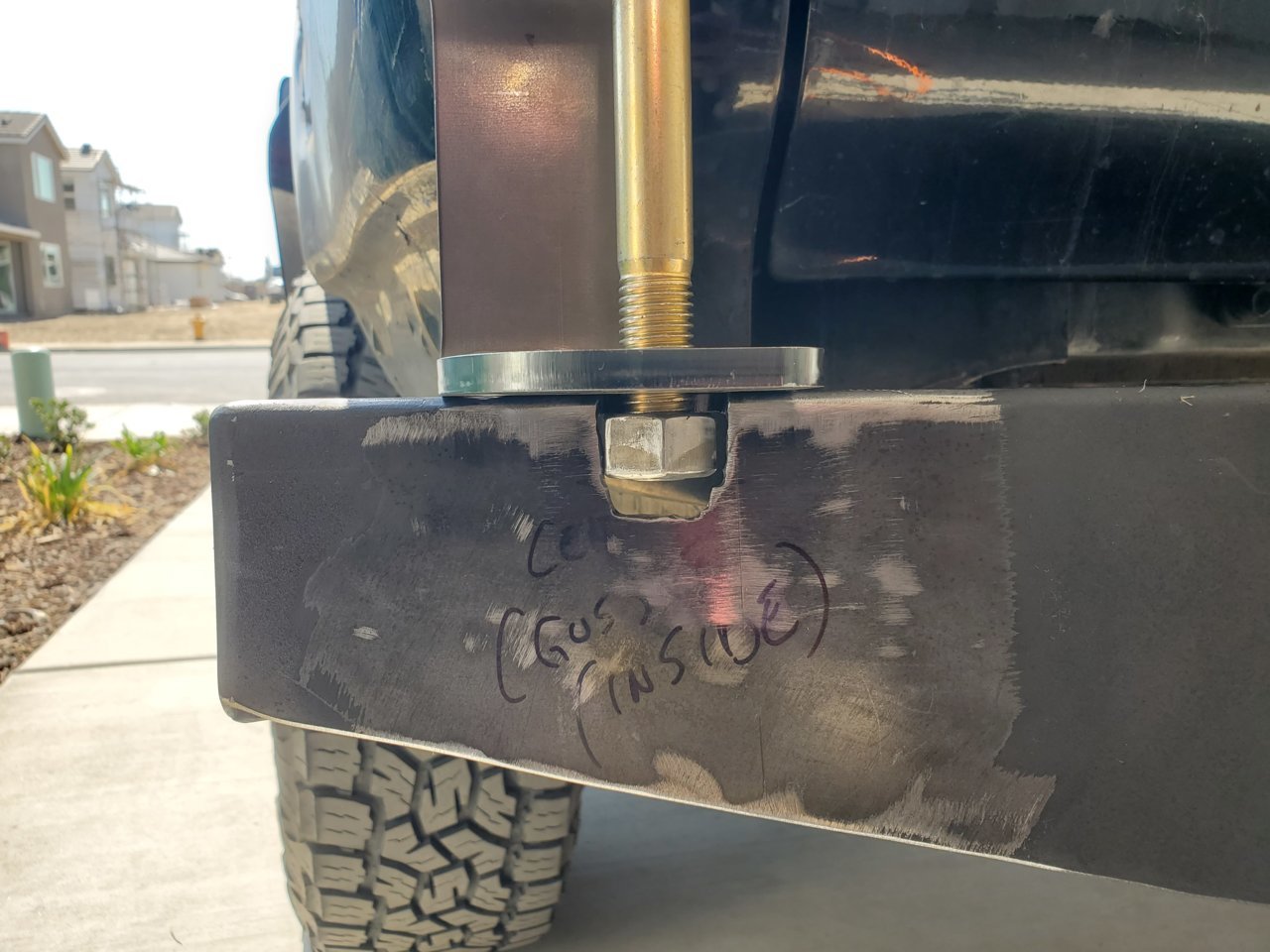

    Impressed I was able to use the little M12 to drill through this.
    The "catch" pin needed a hole drilled into the bumper so it fully engages.
    Just need to clean up a bit more to weld the nut in place but once that's in, the hinge can be tacked in place.
    Taco critter likes this.

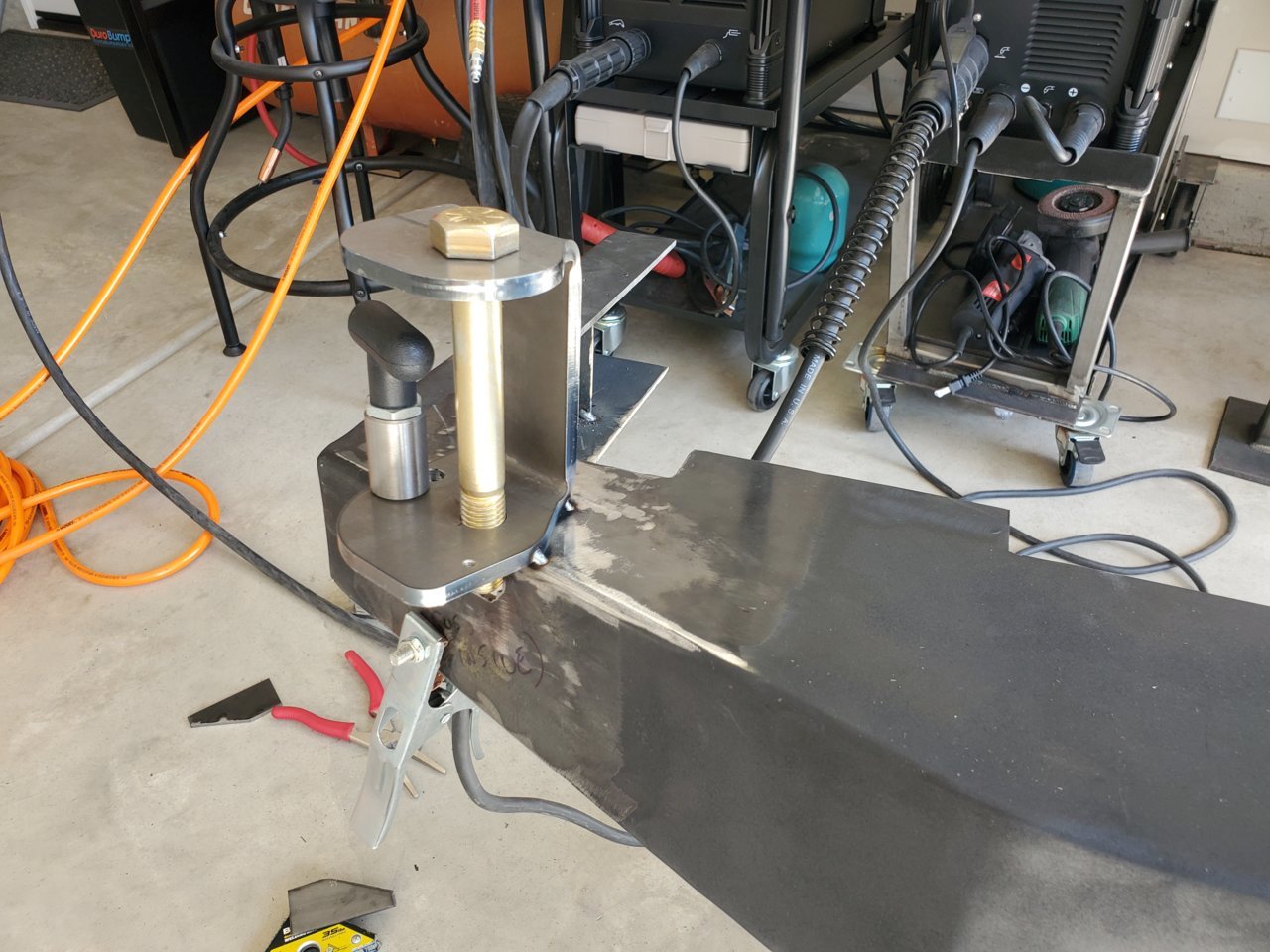

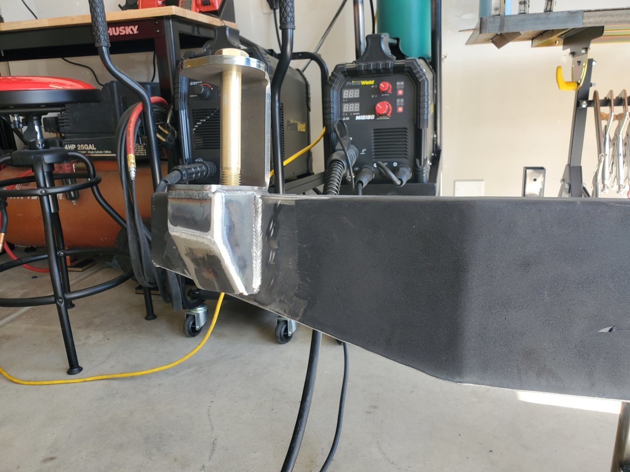

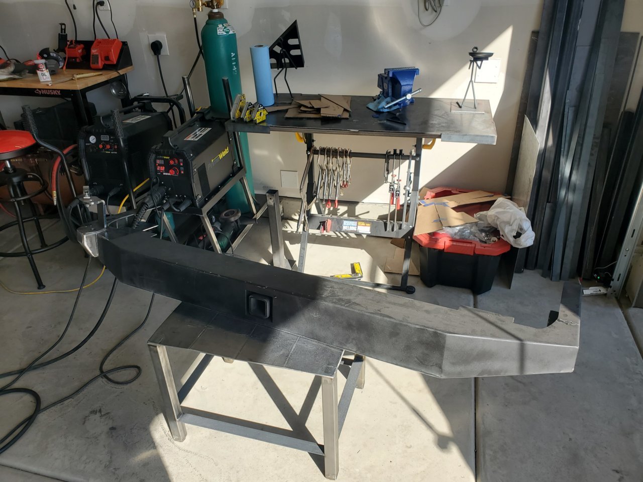

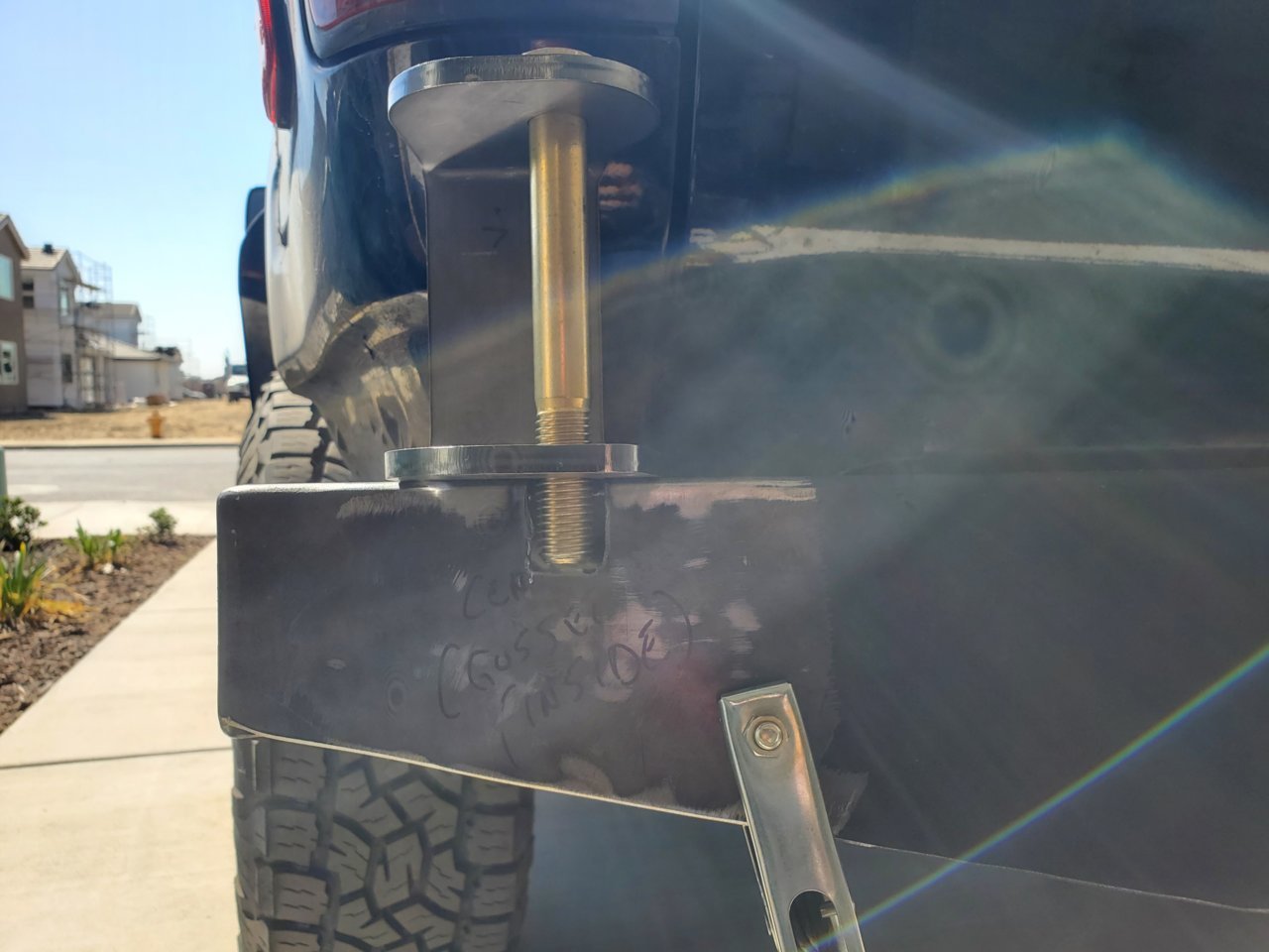

    Finally made some room; just too lazy to pull the bumper off again :annoyed:
    Keeps getting heavier and heavier.
    One of my nice gussets will go in on the inside to support the hinge.
    Two on the outside and it'll get boxed in to cover the notch.

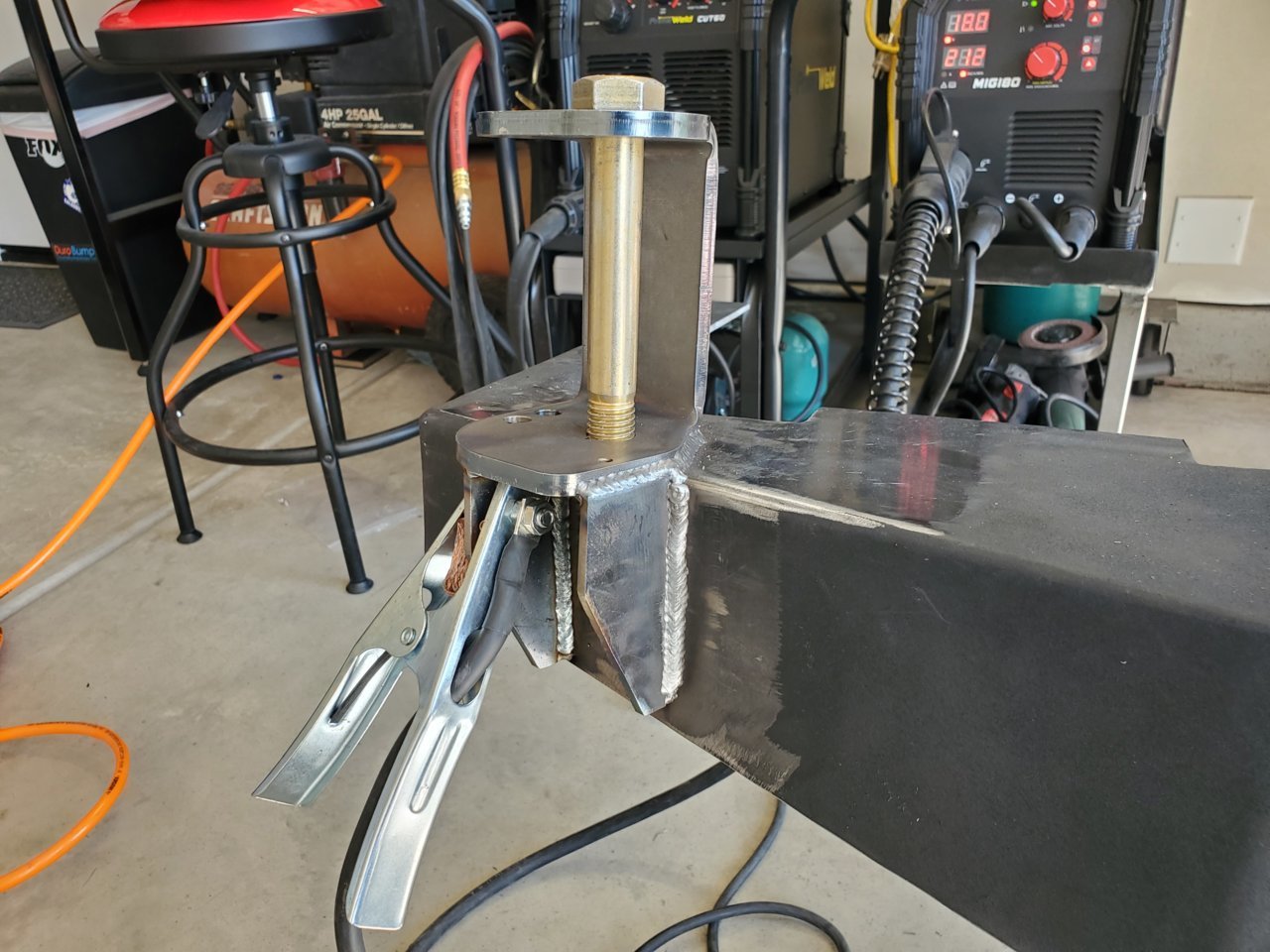

    Weld the hinge on first and then the nut. That way you don’t have to worry about warping the nut being misaligned. I’d honestly advise against welding the nut in. For me, when it comes to hardware for critical components or something that would be an absolute pain in the dick to replace later, I’d rather keep everything free moving. Not that you’ll be removing the swingout often, but if you ever manage to cross thread that welded nut, you’ll certainly be annoyed that you didn’t plan ahead.

    Sounds good and you basically answered my question. I was going to ask if I should just burn the hinge on since the swingout arm gets "centered" after everything else is on anyway.

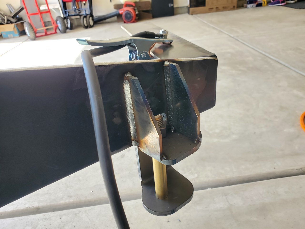

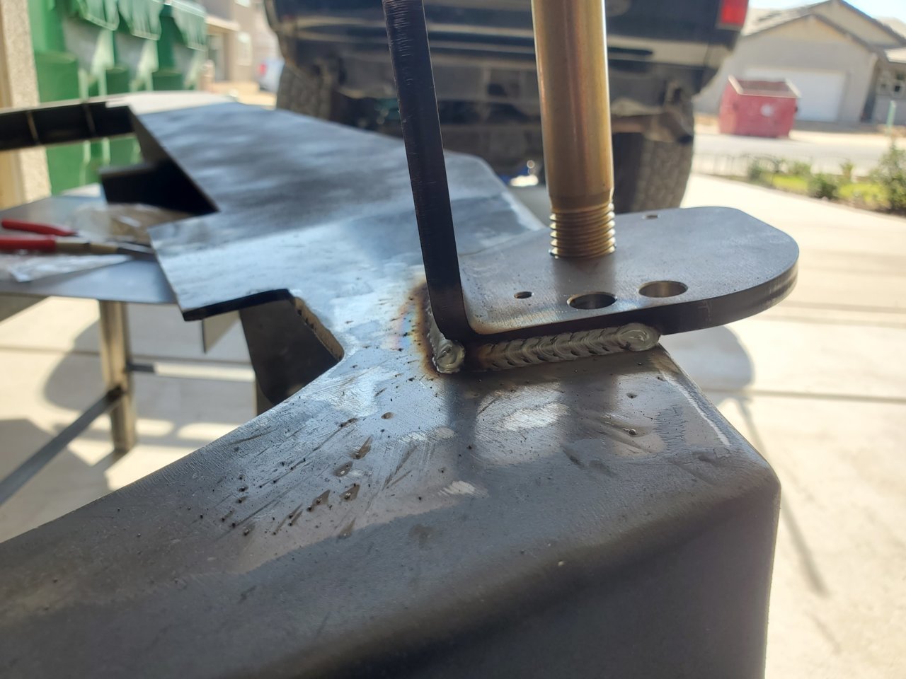

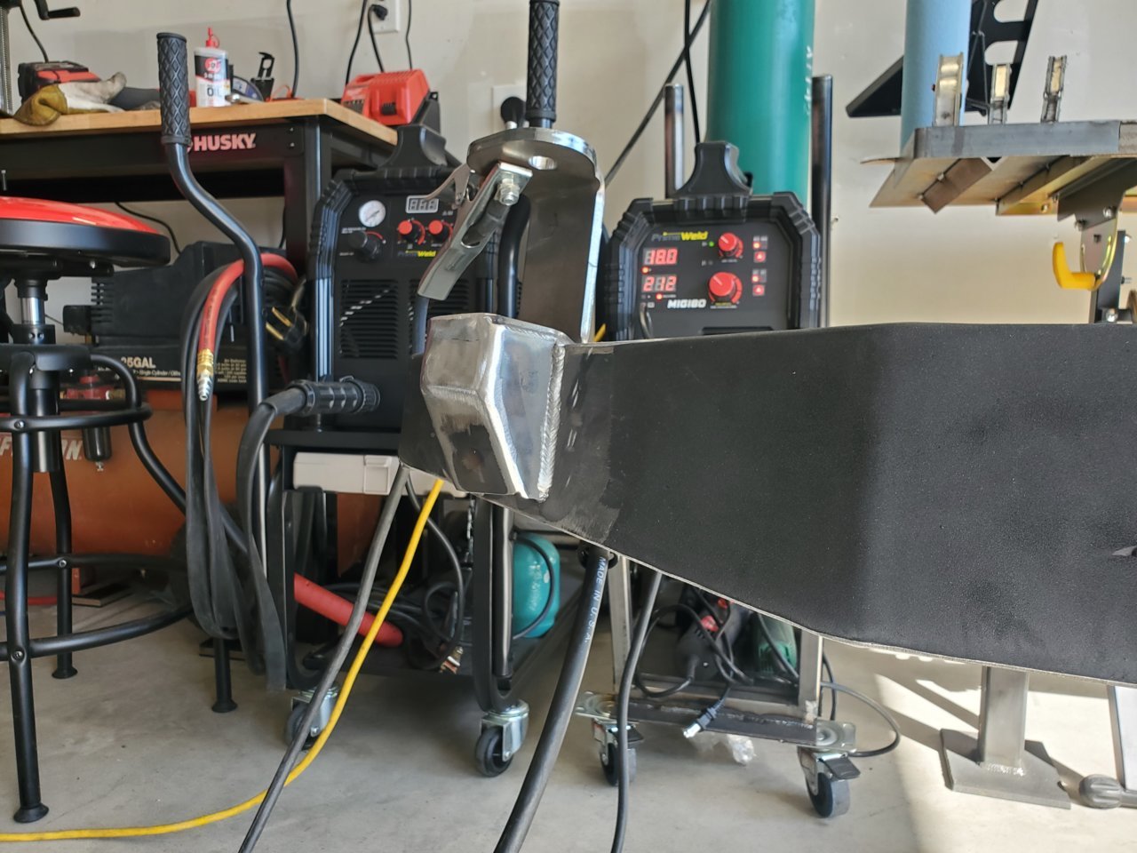

    Got it tacked in.
    Soon afterward I said fuck it and burned it in.
    Rather disappointed in my welds, but mainly because I wasn't in the most comfortable position; my fault for refusing to constantly move and flip this thing around.
    At least the gusseting is in place, now just need to cut some steel to box it in.

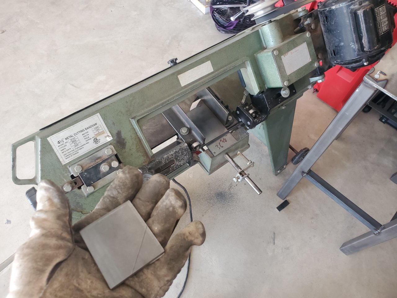

    Good ol'17 year old Harbor Freight bandsaw coming in clutch with the small pieces.
    Boxed in and plenty heavier :bananadead:
    And it's all blended in!

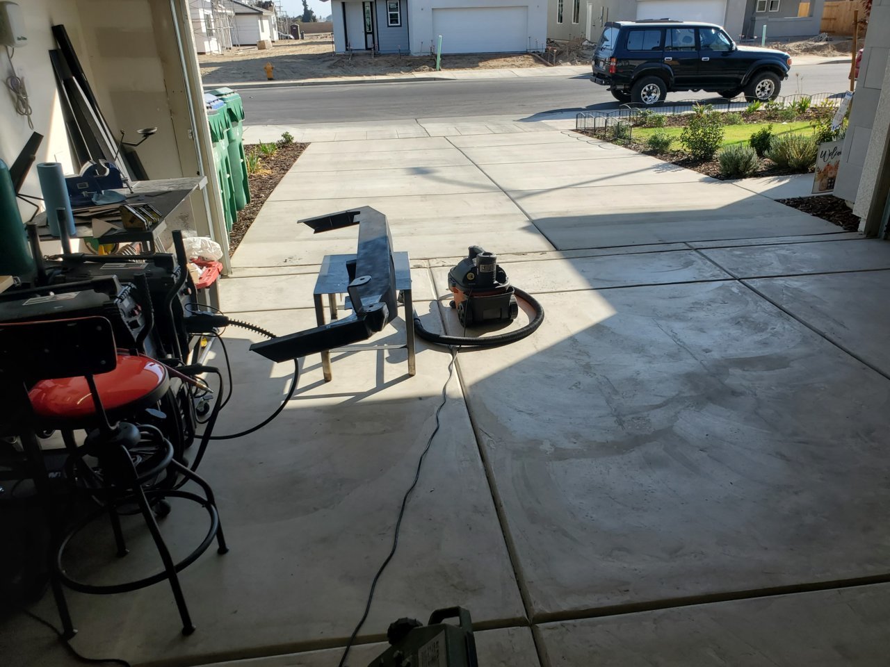

    Right?
    It's the cleanup I hate doing afterward. :bananadead:
    I sweep everything up before using the shop vac...and trust that it's a ton of metal dust everywhere.
