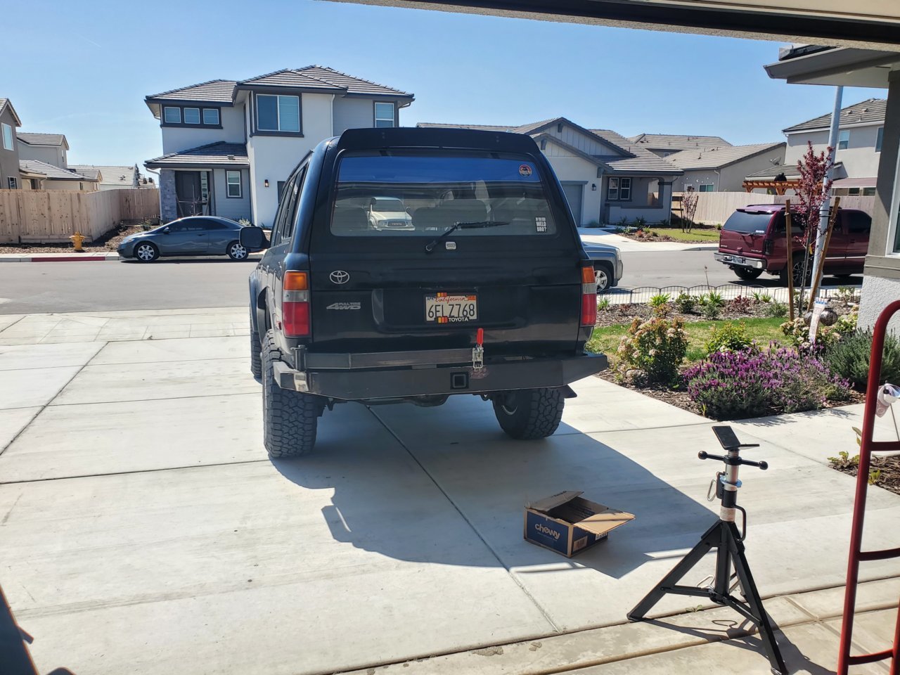

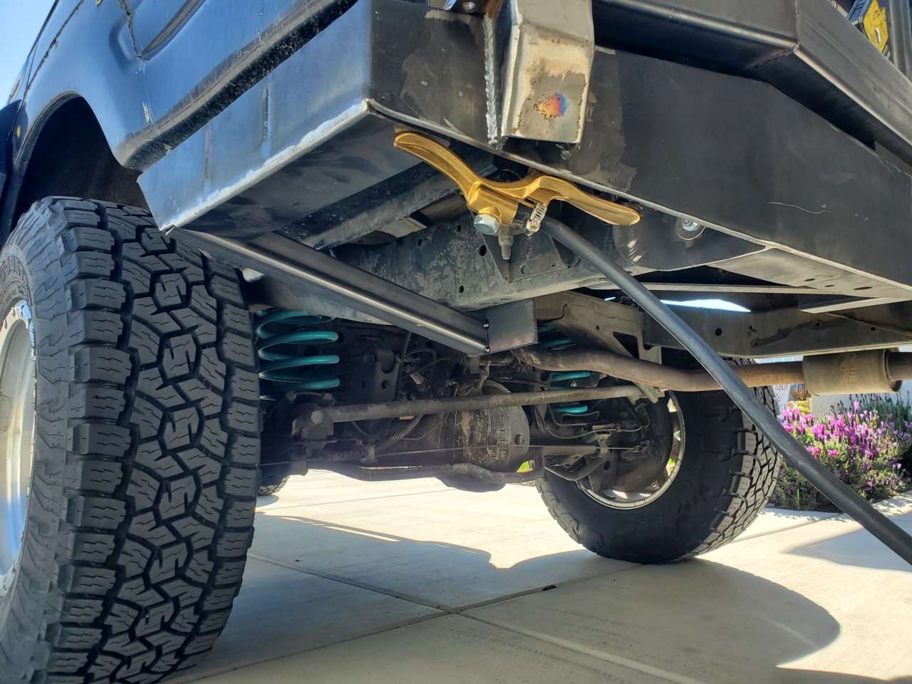

    Had made a little progress to the bumper about a week ago.
    Really, it's been mostly done for the longest with the exception of some minor supports and finishing the arm.
    Mock up.
    Making use of some 1/4" plate since I've got tons of it.
    I understand that the "mount" would be best suited as going against the face of the frame but the holes are simply holes. No weld-nut to thread a bolt through, and the holes do not go through the frame.
    In fact, the weld-nuts are on the inside and threaded so I made use of those. That and going the other way would require me to cut into the body.
    I'll gusset the inside a bit more and figure I'll cut the exhaust and do the same for the other side.
