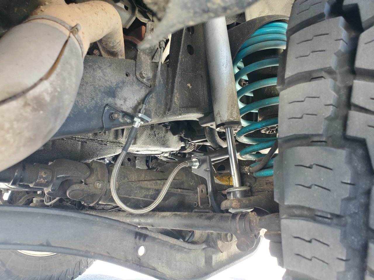

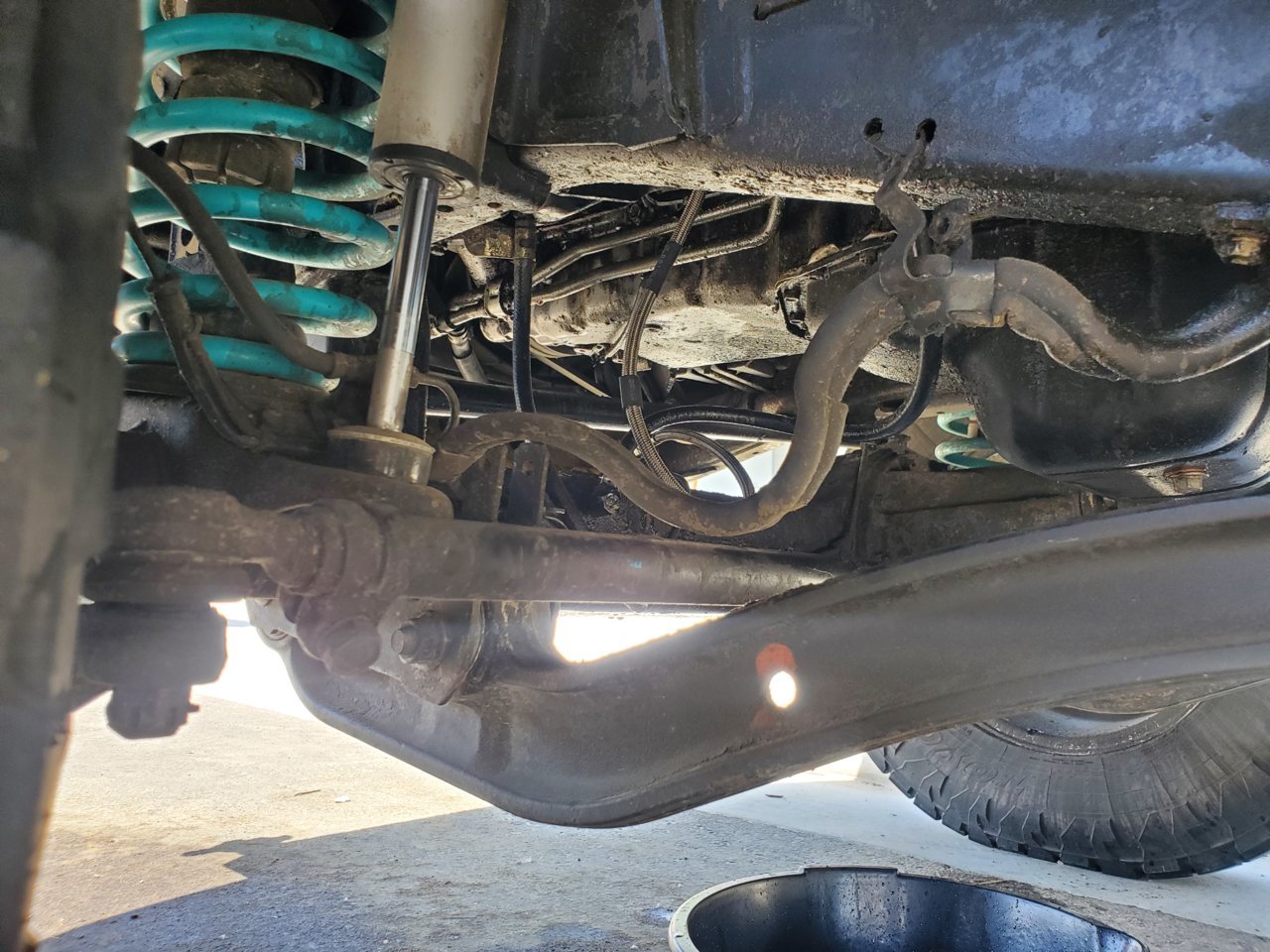

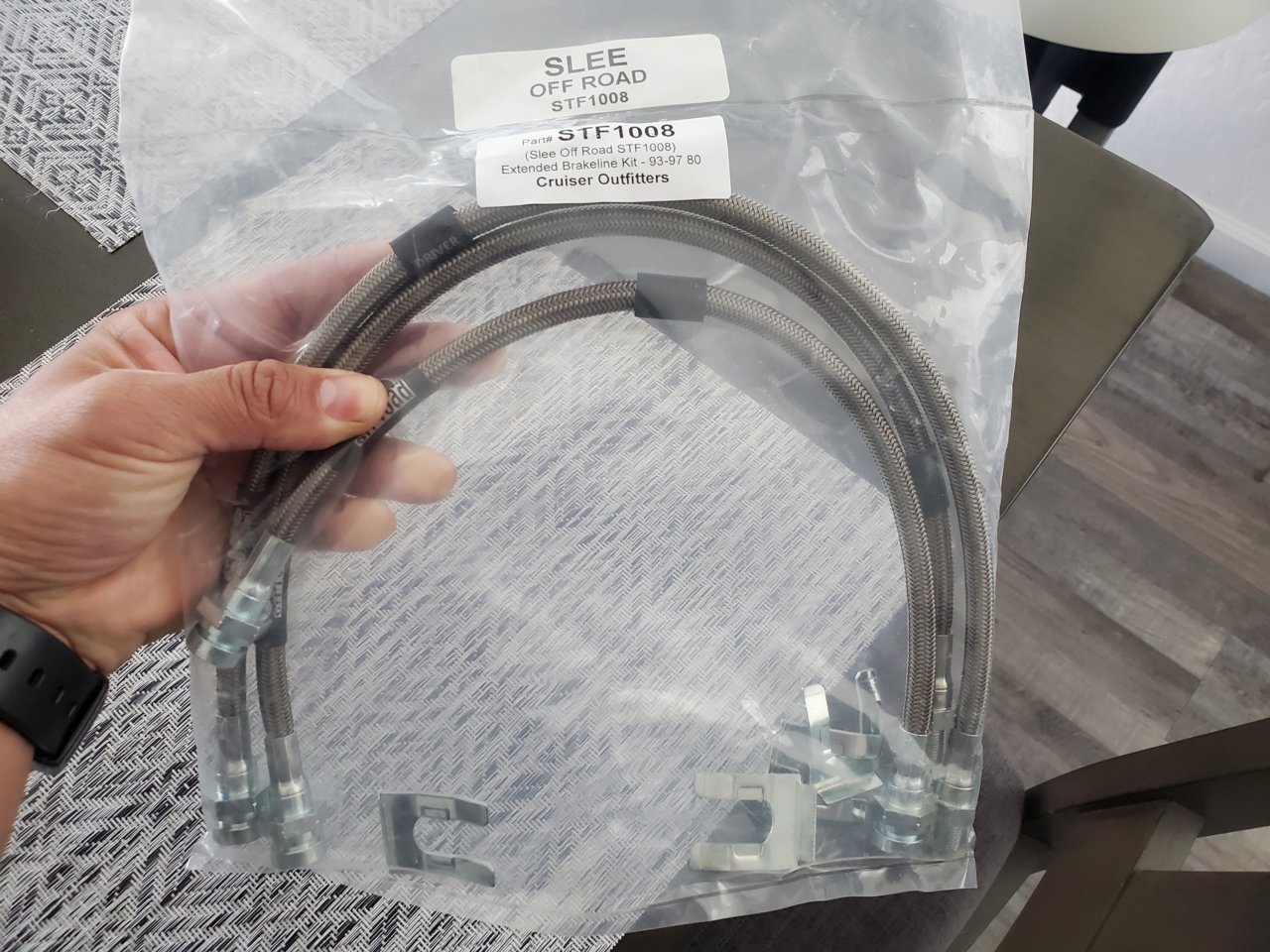

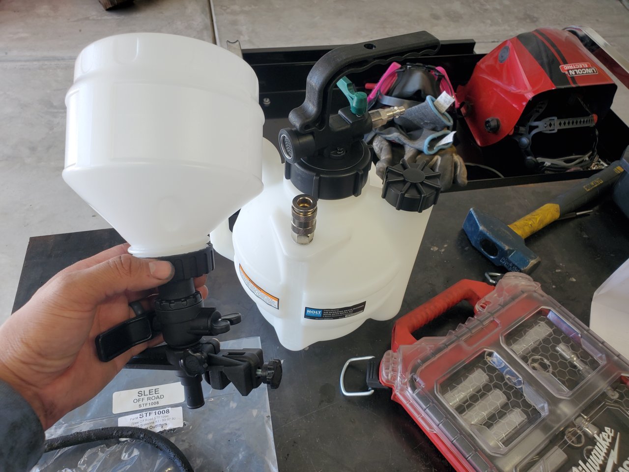

    4 run, 2 don't

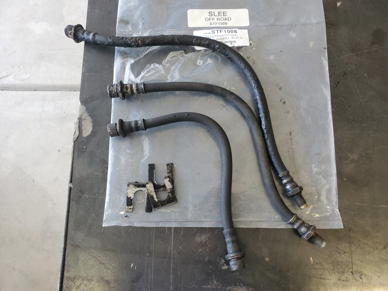

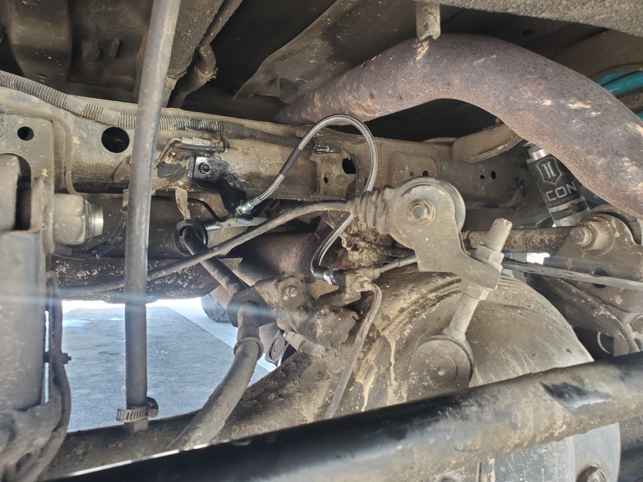

    Replaced my limit straps with new Slee stainless steel lines
    The old
    Front driver
    Front passenger
    Rear center

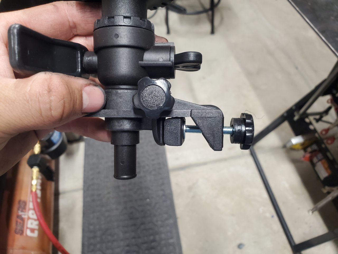

    Haven't driven it in about 2 weeks so no rush to bleed it. Once I do though it'll be a quick job with the use of this pneumatic bleed/refill system

    The pneumatic is great, can do a 15 minute brake bleed solo :D

    It's less Tacoma and more mod
    did it have the right cap for the reservoir?
    Taco critter likes this.
  5. Apr 26, 2023 at 1:36 PM
    #1225
    Kwikvette
    Kwikvette [OP] Well-Known Member Vendor
    Feb 27, 2019
    #284735
    82,923
    Fresno County
    4 run, 2 don't
    It works with even the old GM-style rectangular openings.
    It just sort of clamps to the reservoir
    Chose it based on the many great reviews, not to mention videos I've seen.

    Looking forward to it since it's also meant to suck out the old stuff from your system too.
    Will be doing a complete flush.

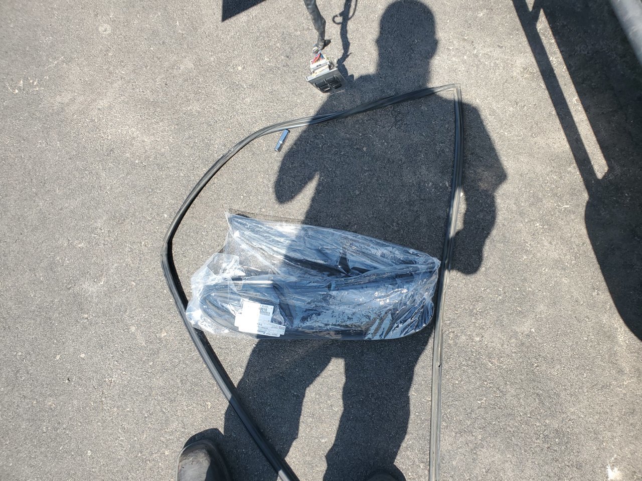

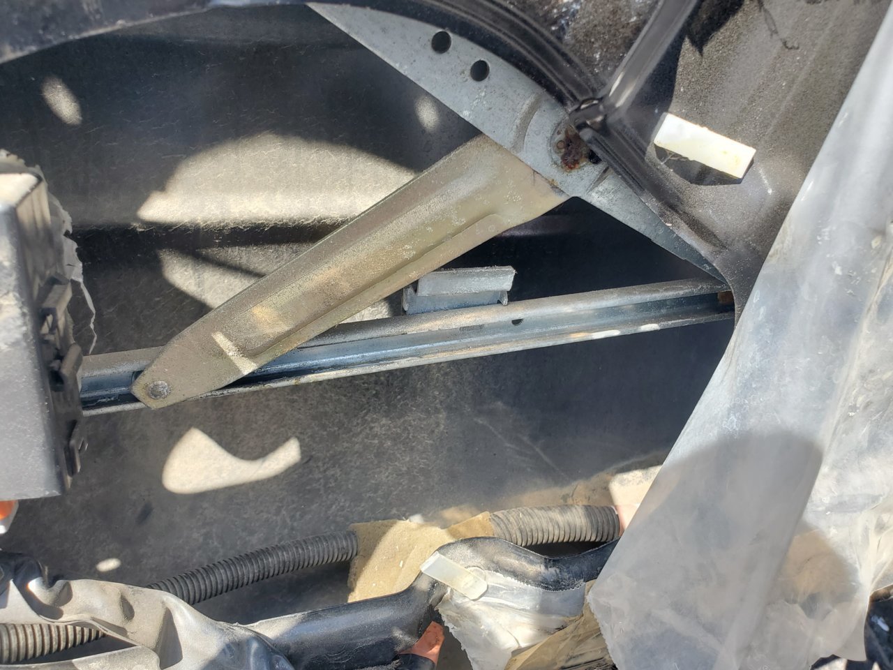

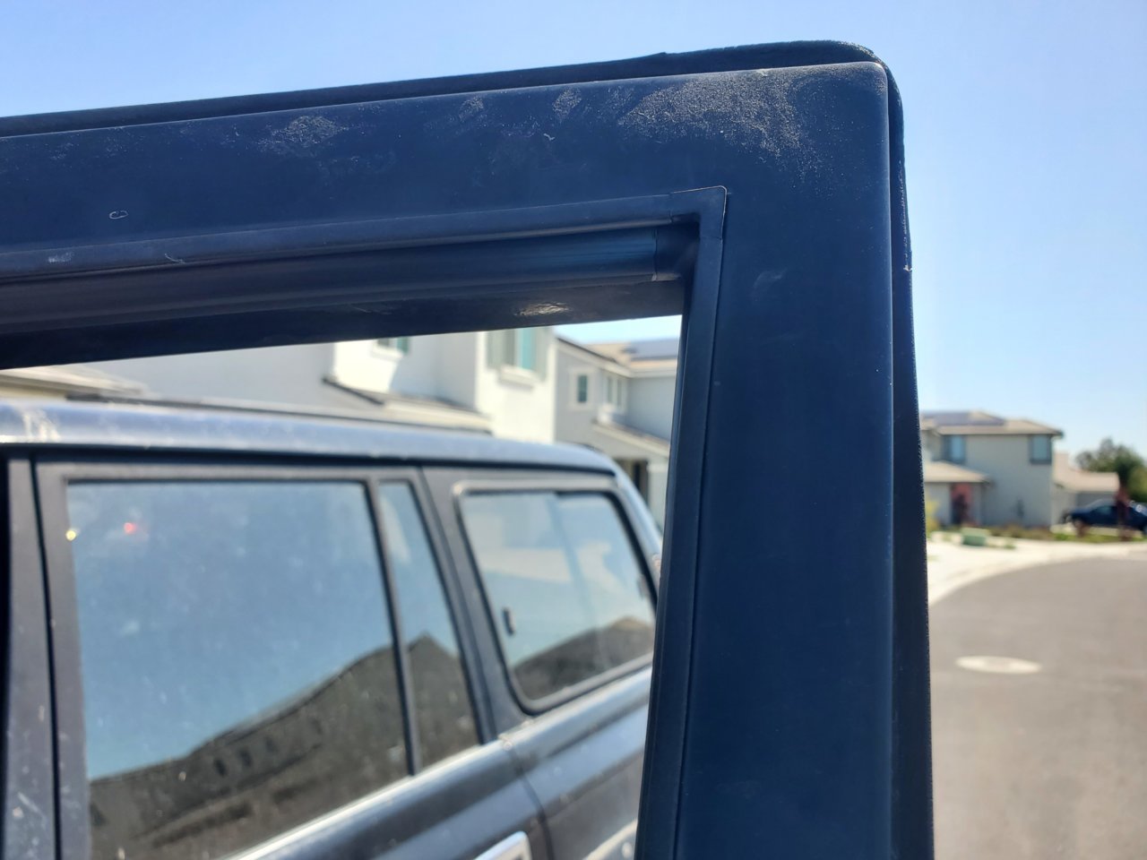

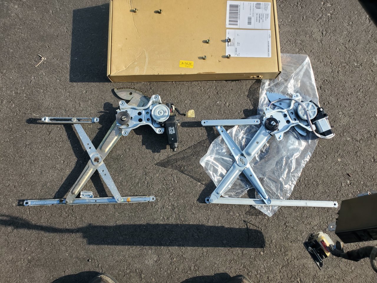

    Even though I've got this bad boy up for trade, I'm still taking care of it as needed.

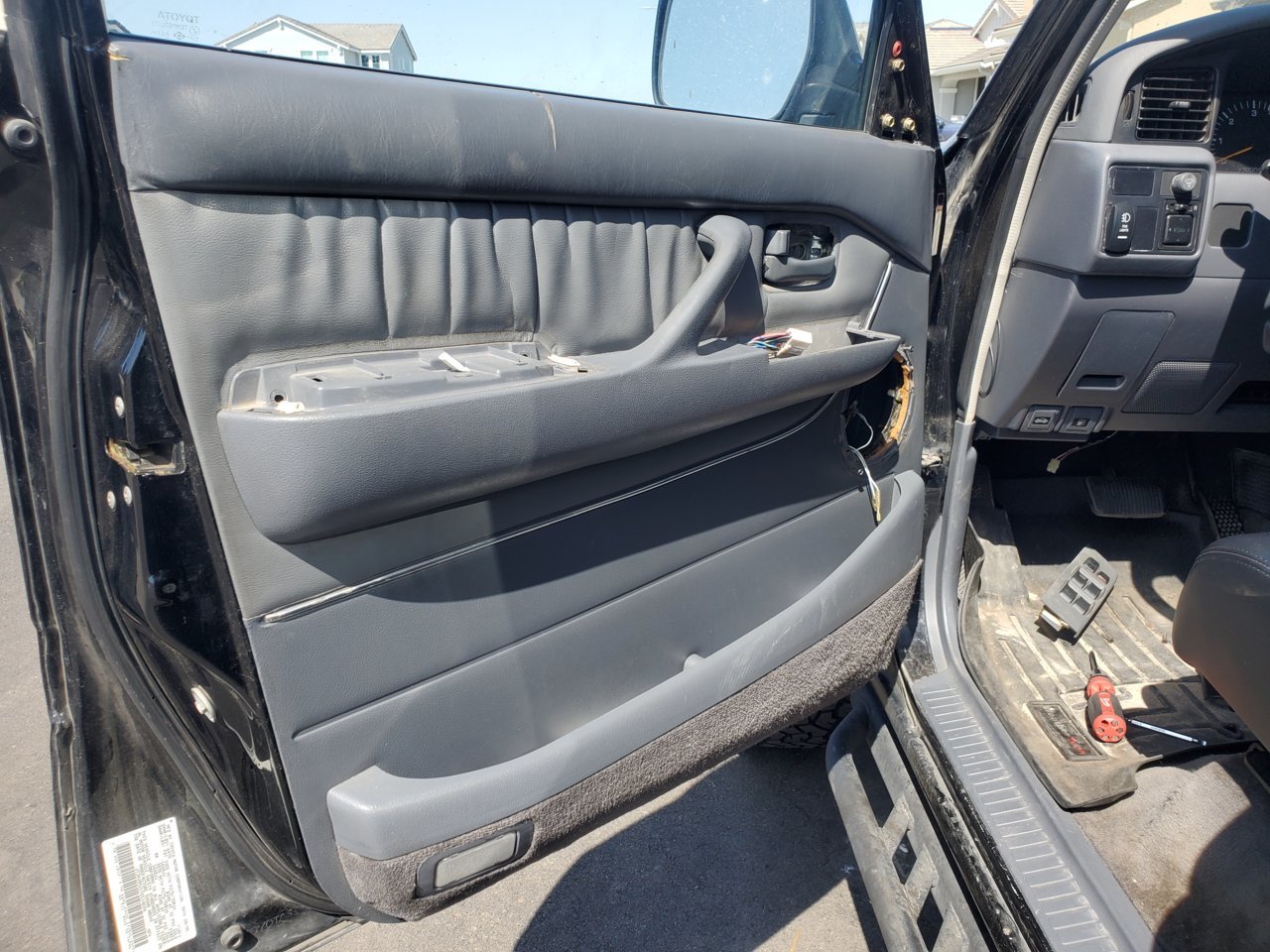

    For the past few weeks my driver side window has had an issue with going up, at first it was slow, then altogether not at all.
    Common issue with these is, after +20 years the channel run needs to be replaced. Makes sense being rubber and all.
    Anyway, door panel has to come off.
    Once that's out of the way, only two 10mm bolts hold the window to the regulator.

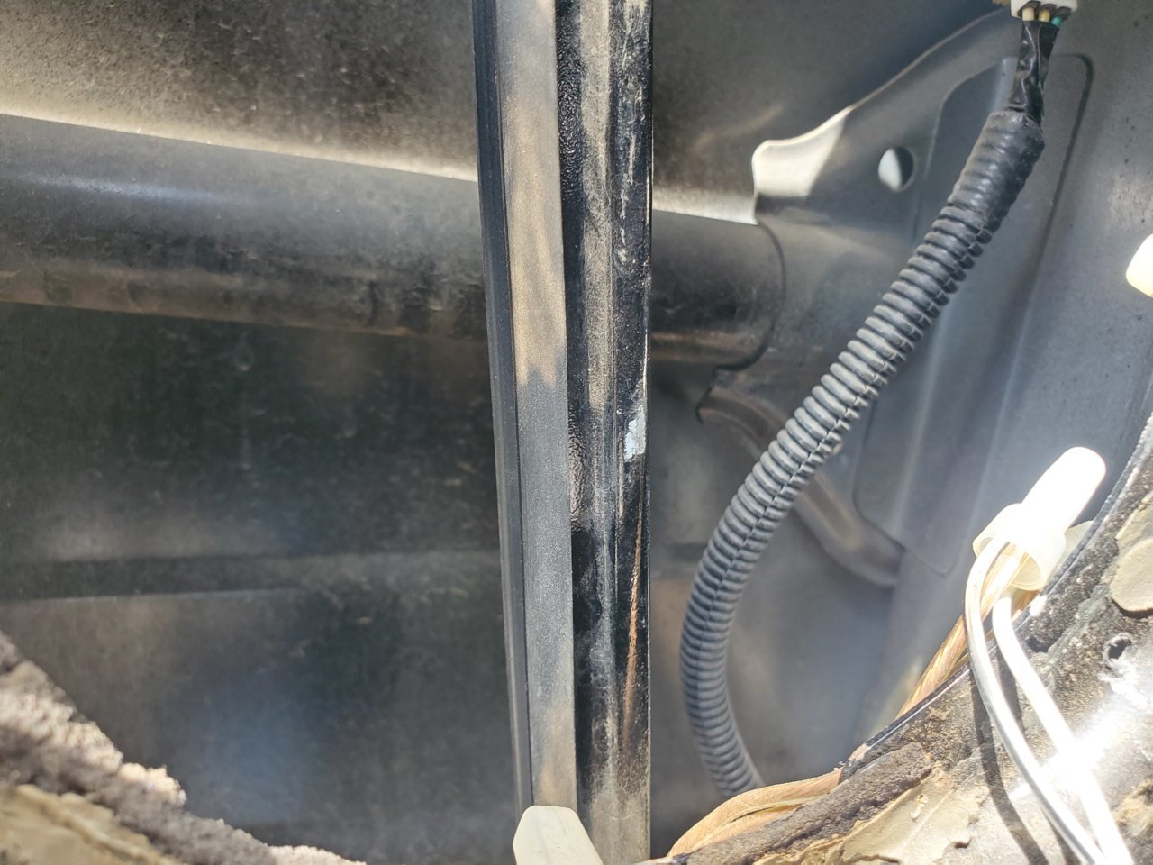

    The old channel run pulled, and the new one ready to go on.
    Super easy, just a few things to note. It is imperative you get this corner tucked up as far in as possible; no gaps!
    And the other thing is, you want the lip of the run to sit out onto the door frame.

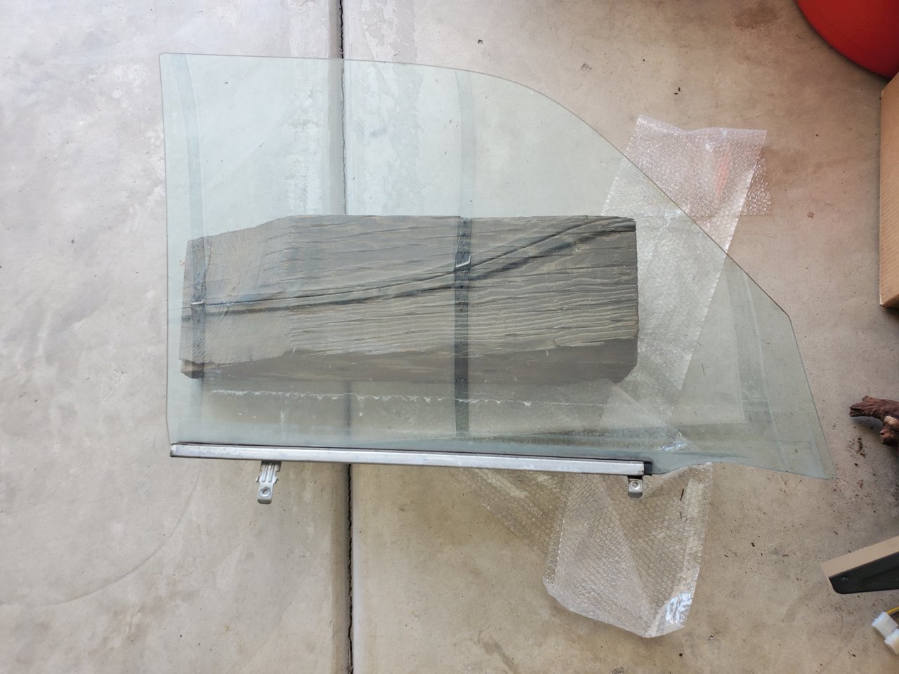

    Why did we remove the glass? Cause the channel run goes down the track which runs the height of the door.
    Also gave me an opportunity to clean this track.
    After all was said and done, my window refused to go up. Further digging told me that even though the window motor powered up fine and ran the window down, it didn't have the torque to push the window up again.
    With an old motor and regulator, I didn't want to just replace the motor so I bought a Dorman kit.
    Here's the old next to the new; only held in by six 10mm bolts and an easy to do job.
    And all good to go now!
