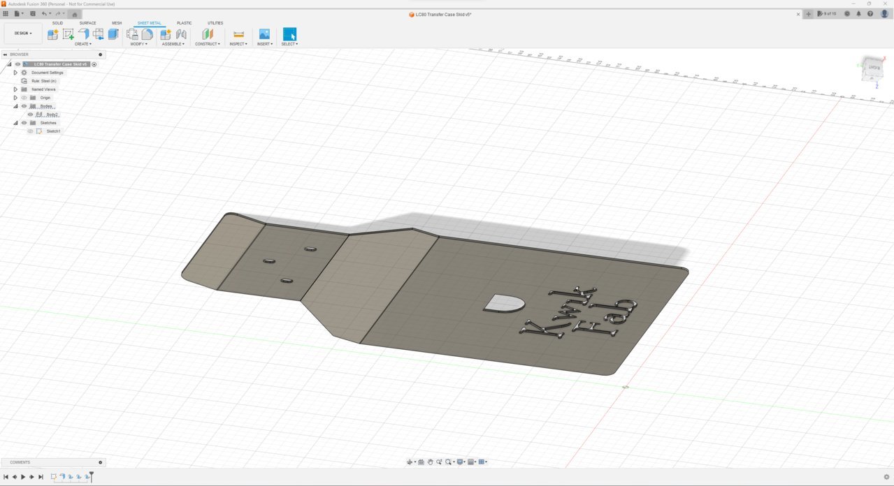

    Seeing as how my Land Cruiser is missing both the engine splash guard and transfer case skid, I figured I could address the transfer case right away.
    Here's a mock-up of what I want to create.
    Didn't really take long to draw it up and bend on CAD, 10 minutes maybe and I'm digging how it looks already. Thinking I'll minimize the branding to just two letters but we'll see unless someone wants to help me create a logo for myself? Could net you some free fab work!

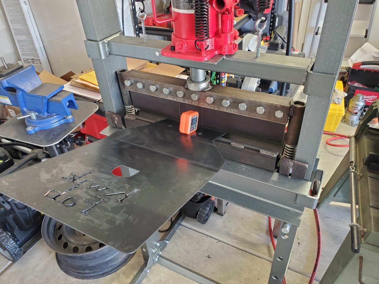

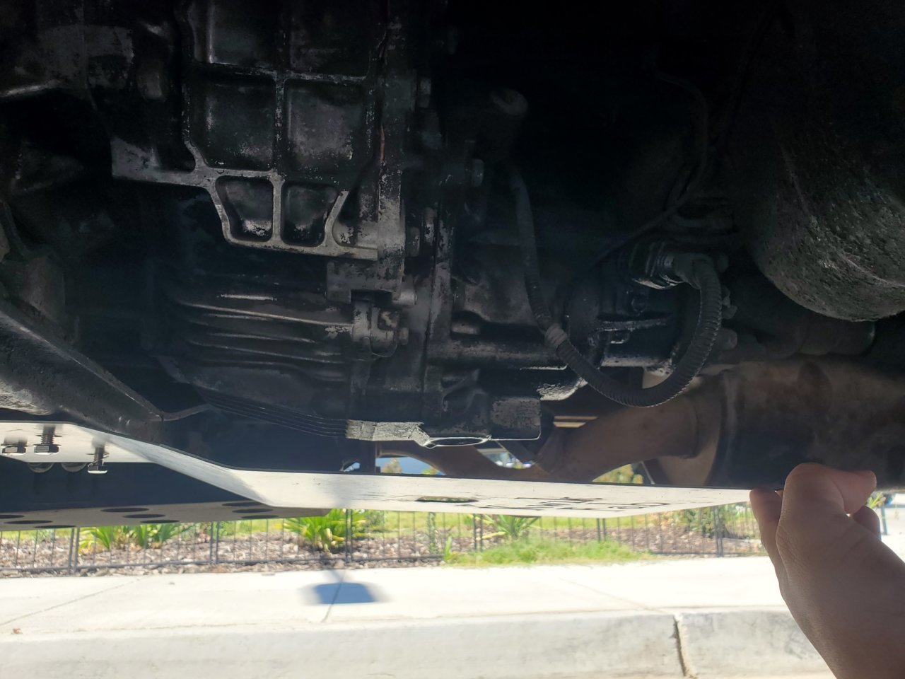

    Another 5 minutes and she's already cut! I swear I'd be pulling my hair out if I had to cut this shit with an angle grinder and/or saw.
    Few minutes on the press and done!

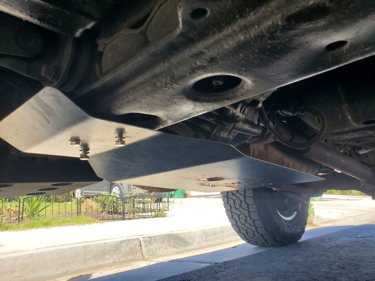

    Quick test fitting told me a few things though;
    1. the large radius bends were largely to my benefit as the front clears the crossmember wonderfully
    2. the width of the slots for the mounting hardware are so precise, the bolts have no side to side movement which brings up an issue
    3. I measured the holes on the crossmember slightly off from center to center because I am about 1/32" too close together since the threads on the hardware catch on the slots
    4. I can go slightly wider on the bends after the slots to tuck in the skid a bit more

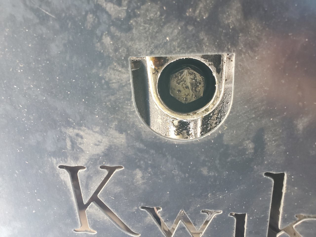

    Access to the drain plug because who wants to remove skids for servicing said items.
    The need for adjustment on the rearmost bends to gain back another inch of ground clearance or so.
    The front bend being perfect as is so nothing gets caught up underneath.
    Just need to figure out a rear mounting solution which consists of attaching the rear of the skid to the frame right above it.
    Oh and no, this isn't the skid...just a template in 16 gauge as the real skid will be in 1/4" thick steel.

    Which speaking of, I need to see why I've got a drip at the the drain plug. Should drain and fill with new fluid.

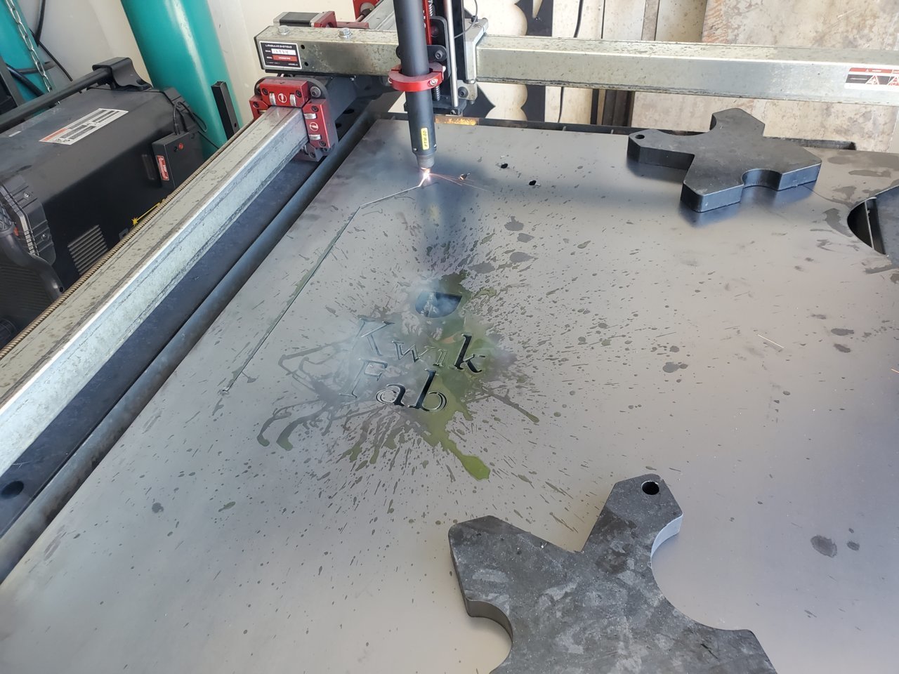

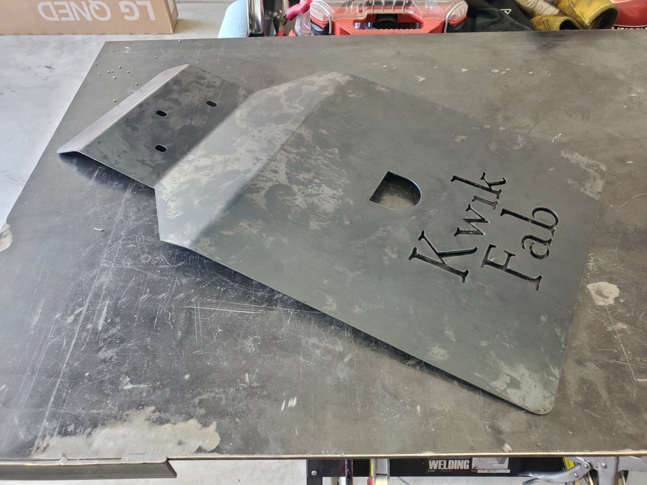

    I swear, cutting even 1/4" is like a hot knife through butter.
    Clean as expected.
    Got to bending right away; so glad I never bothered with a manual bottle jack. Air over hydraulic is the way to go for a press brake.
    Already done!

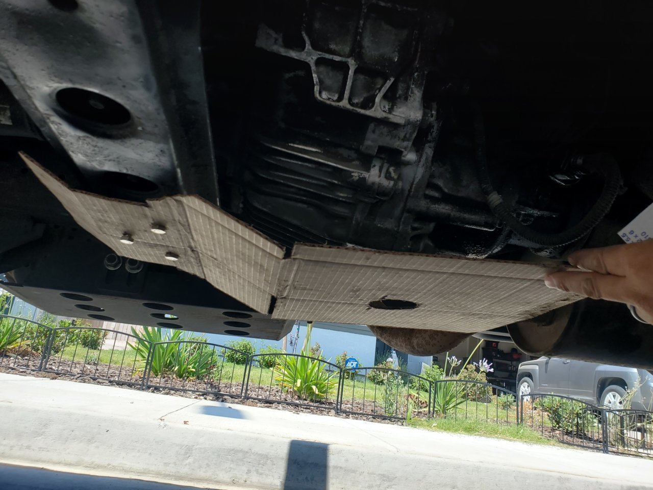

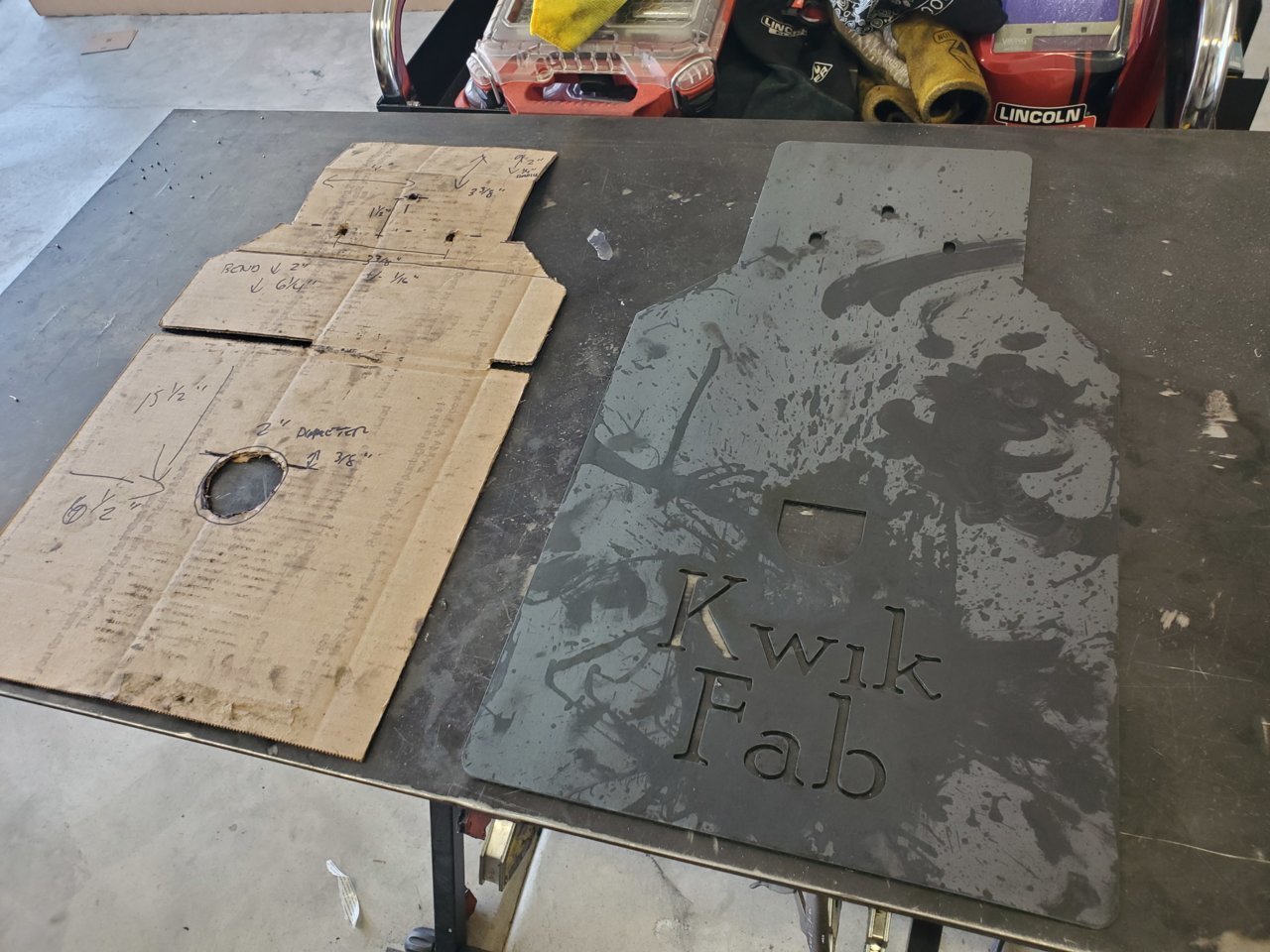

    Cardboard template -> 16 gauge -> 1/4" just like @Ozark_RegCab wanted :laughing:
    Hell most skids are 3/16" anyway so I might make another in case I run into a local LC owner.

    How much does it weigh?
  17. Jun 20, 2023 at 3:09 PM
    #1297
    Kwikvette
    Kwikvette [OP] Well-Known Member Vendor
    Feb 27, 2019
    #284735
    80,895
    Fresno County
    4 run, 2 don't
    That's a good question, being roughly 2 square feet (minus some inches here and there for the letters and drain slot and 1/4" weighing 10.21lbs per, about 20lbs without mounting leg and brackets.
    Tour991 and Ozark_RegCab[QUOTED] like this.
  18. Jun 20, 2023 at 3:15 PM
    #1298
    Kwikvette
    Feb 27, 2019
    #284735
    80,895
    Fresno County
    4 run, 2 don't
    Weighs in at 17.2lbs.
    Hefty for a tiny thing.
    Ozark_RegCab likes this.
