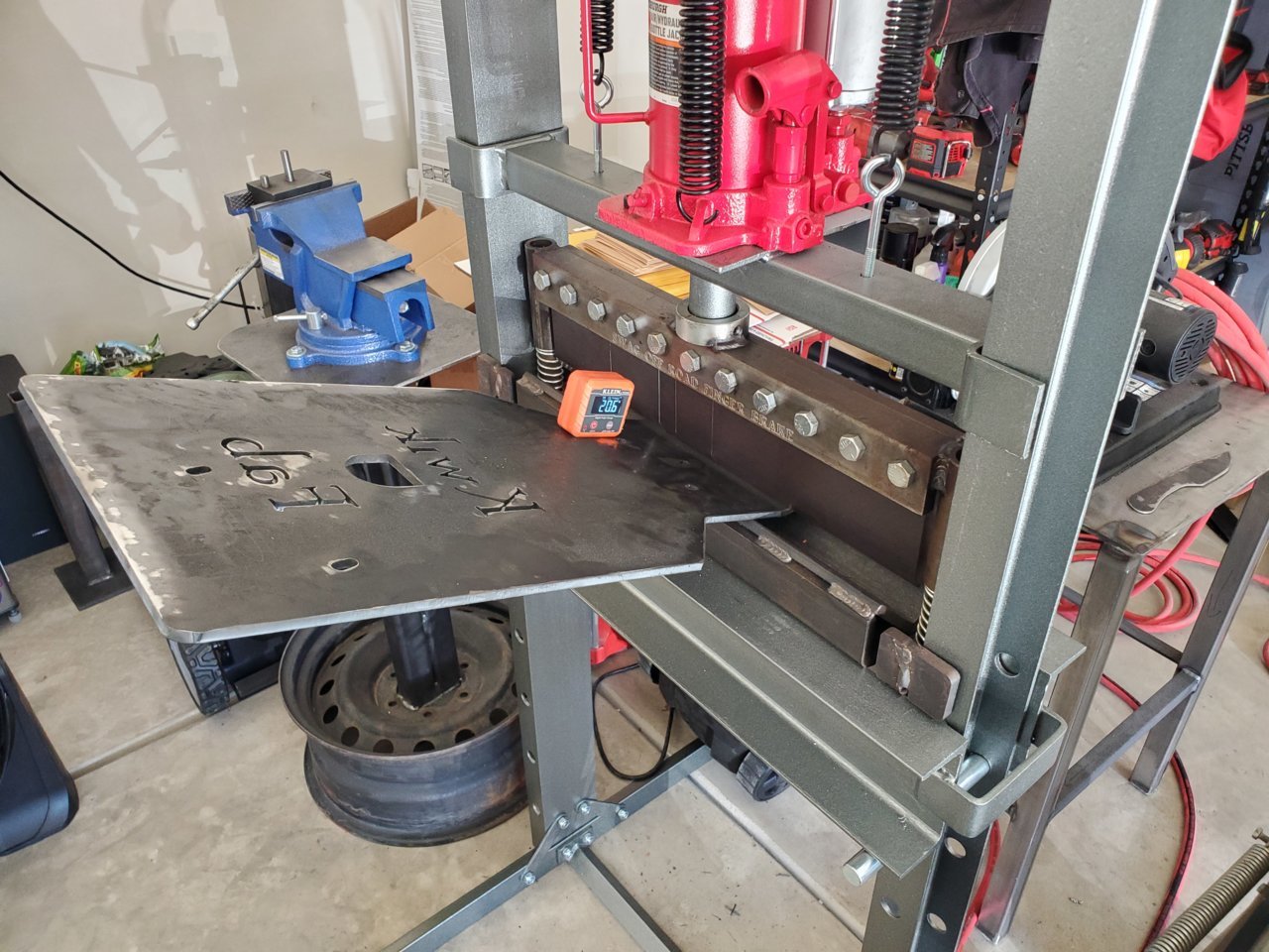

    Was really hoping it'd come out as good as I imagined it; really looks like a fab shop made it versus just some dude in his garage drinking beer and listening to Rebelution:rofl:

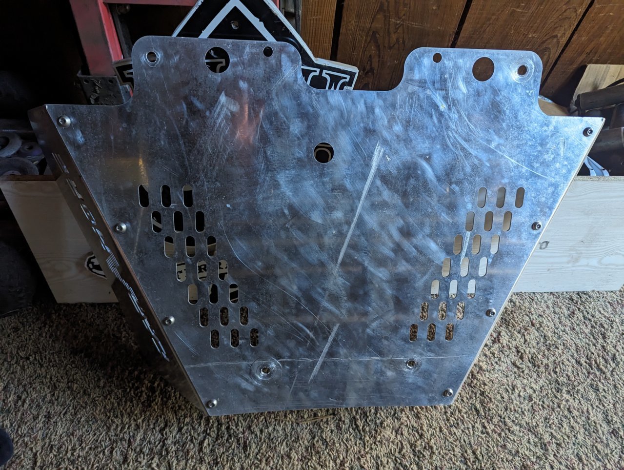

    It looks professional. I want a Kwikfab transmission skid for the 2nd gen. Can you duplicate this?

    Mild steel is perfect. The tcase skid is steel and the front is aluminum so its all mixed anyway.

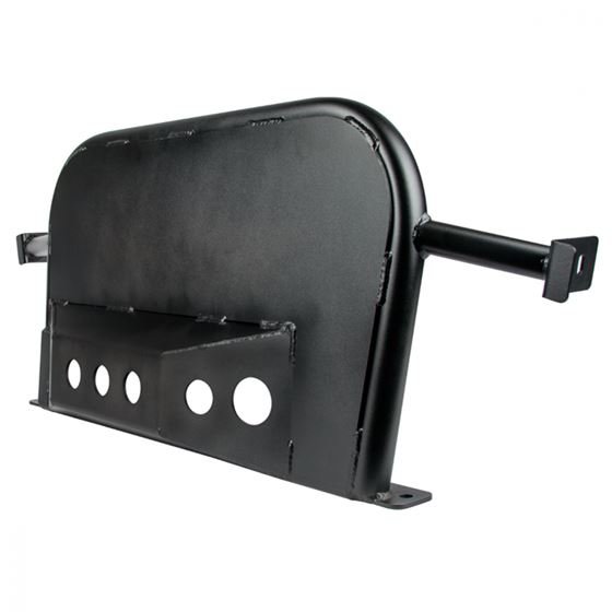

    This is the tcase skid

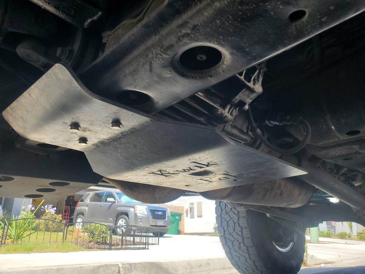

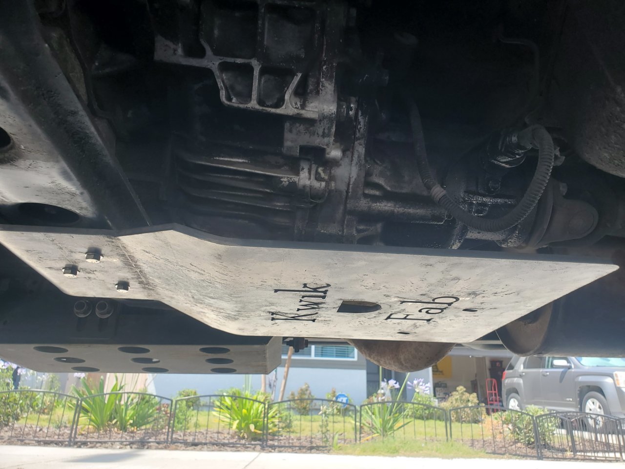

    Haven't had much time today to do anything and it's definitely too hot to do shit now.

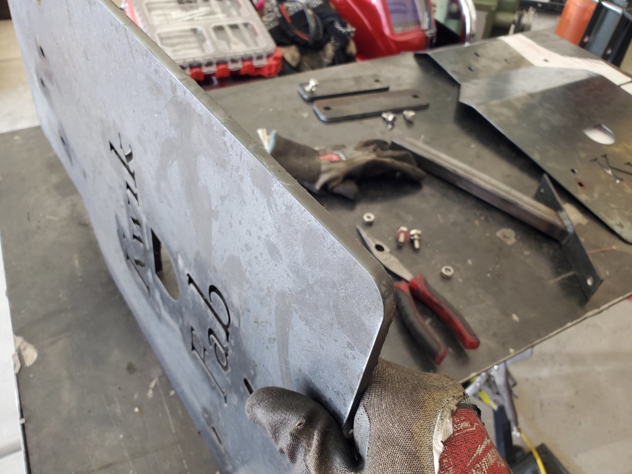

    Anyway, thought I'd just check the skid's fitment with that minor adjustment of 1/32".
    Guess what?
    Fucker's mint.
    And the bracket I made to clamp to the frame is perfect.
    Fast method would be, make another bracket and use that to sandwich the frame.
    Another that I like is getting a U bolt, and going around the frame in the form of a C just the way most sliders for these vehicles use.
    Once I've decided, I'd just need to cut some square tube, weld the mounting bracket to each end, and bolt it all up.
    Had a last minute idea last night to cut some "rings" to weld around the two rear/lower most slotted openings. This would protect the bolt heads in the event that they get hit.

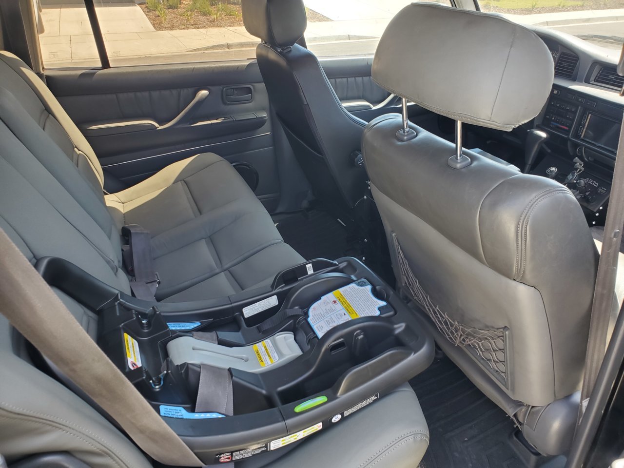

    That wasn't the biggest mod today though; finally installed that extra car seat base for the extra car seat we got from our baby shower.
    Land Cruiser just went full dad mode :muscleflexing:
