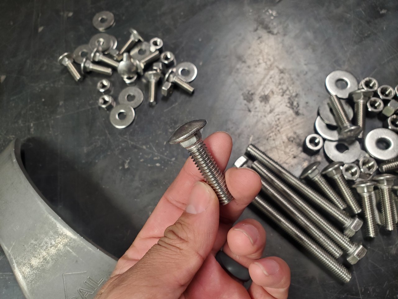

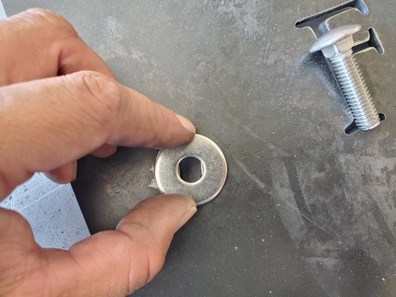

    Classic example is my skid.
    Really it's a one day job, and I pretty much did it within that time frame since I've been super busy with home+baby stuff in between. I've got what, a total of 3 hours into it including the templates?
    Anyway, I always wanted to run carriage bolts for the two most rear bolts (since they sit lower) so I ordered some in 5/8" recently. I run metric for everything, so I ran these slots for M10 hardware originally.
    Knowing I made the slots a hair wider (for not so super tight tolerances) I thought I'd get away with it.
    Nope, and I don't want to widen the slots cause I would want them square as they are now so...I'm hoping to try two 5/16" carriage bolts tomorrow and finish it up.
    If not then just the usual M10 hardware I've got laying around.
    Yota X[QUOTED] likes this.

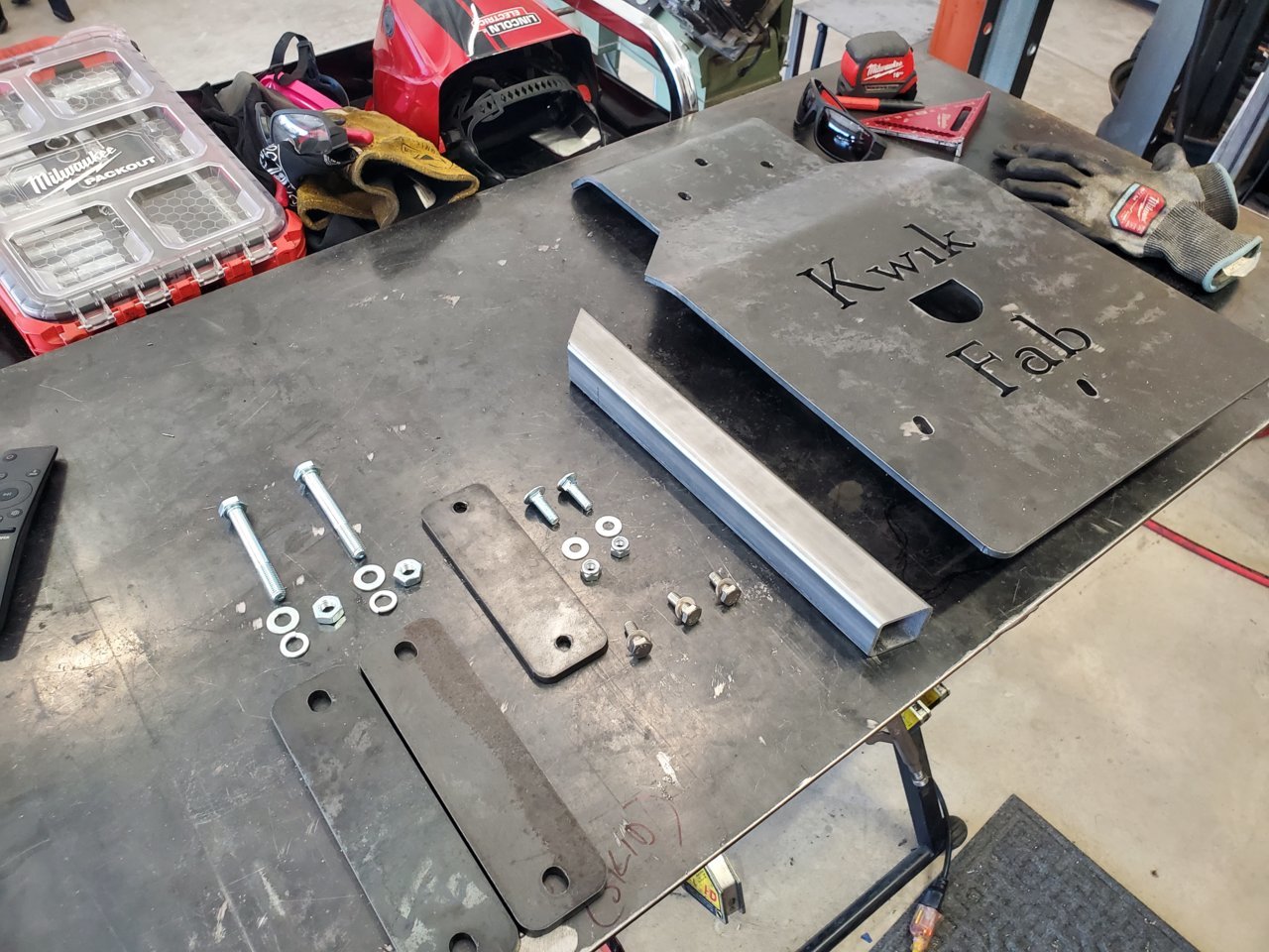

    Little time to myself so figured I'd work up the skid mounting. Cut the last remaining mounting bracket and went up to figure out fitment.
    Parts laid out; all stainless steel hardware (pictured is some zinc hardware I later swapped out).
    Order of 5/16" carriage bolts arrived just in time and they're a perfect fit.
    We were talking about hardware...how missing a bolt could really set you back. Well, that fucking shit happened today.
    The M10 80mm bolts I picked up to sandwich the frame are in 1.25 pitch; every single M10 nut at home is 1.50 pitch and I have a shit ton :facepalm:
    No worries, I can still figure out fitment by zip tying the mounts around the frame to keep it in place. And no, space is way too tight for a clamp to fit.

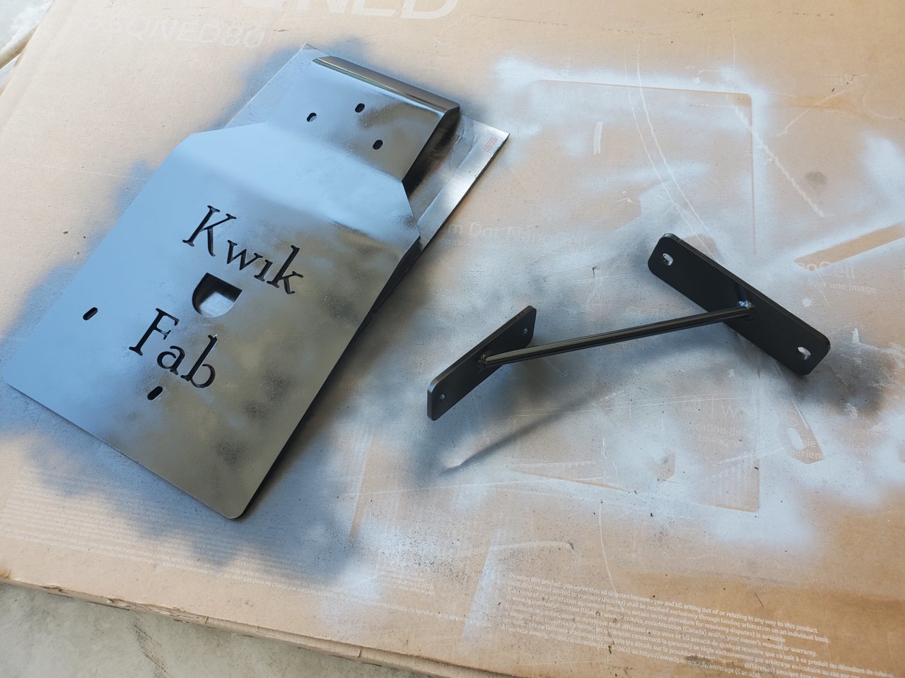

    Moving forward to get shit going, found it way too difficult to - hold my welding mask since I can't wear my hood underneath, hold a mount, torch, and arm all at once. Doing shit alone sucks so I opted to create a temporary solution.
    Used some of that 1/2" solid rod to mock up the rear mount. I don't expect to hit big rocks this Wednesday so this mount will be more than enough. Once I'm back, I can mock it up with square tube as intended, and go with the U bolt method around the frame.
    While the paint dries, I figure it's time to grab the right hardware and it'll be ready for install once it all dries up.

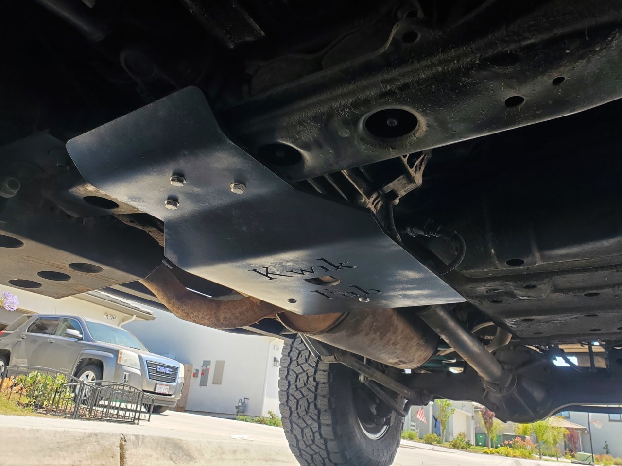

    Will mount it up today and figure what the next project will be.
    Taco critter likes this.
  10. Jun 26, 2023 at 11:29 AM
    #1370
    Kwikvette
    Kwikvette [OP] Well-Known Member Vendor
    Feb 27, 2019
    #284735
    80,910
    Fresno County
    4 run, 2 don't

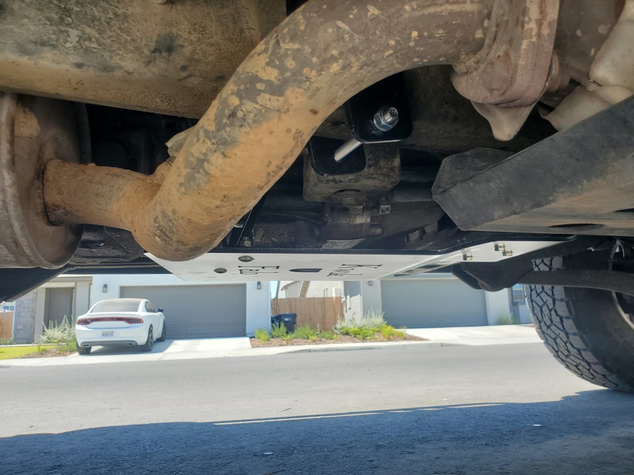

    Bolts showed up and she looking beefy AF :muscleflexing:
    Paint looks worse in pictures for some reason.
    Here's that rear mount sandwiched to the frame.
    Yota X and 02hilux like this.

    Can you believe hardware was holding me back? :rofl:
    Now I have a lot of extra 5/16" and 3/8" carriage bolts all in stainless steel.

    Be cautious, most SS are not rated for high strength. Don't ask me I know.
    Yota X likes this.

    The carriage bolts are the only ones not rated, the rest are 8.8 but the carriage bolt would only see damage at the exposed head.

    Take that back, grade 18-8 stainless which makes it just weaker than grade 8.
    No biggie but hey, learned something new on the carriage bolts.
