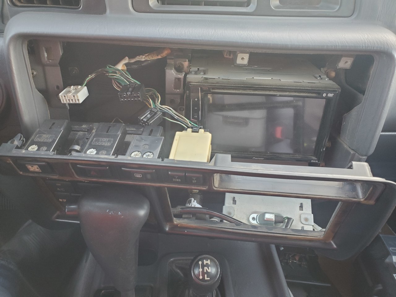

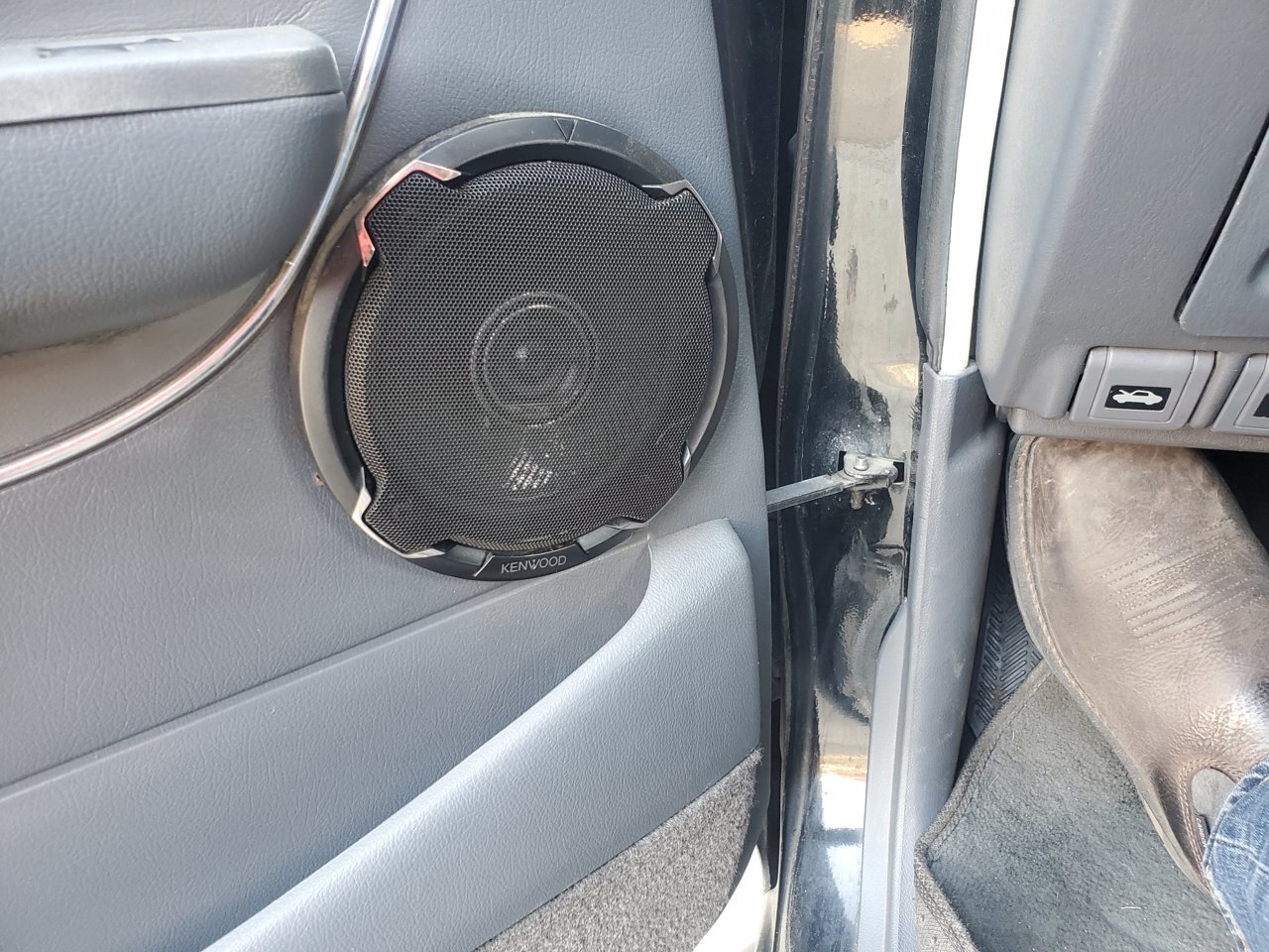

    So, because some dumbass contracted COVID, class was cancelled for today and won't resume until Tuesday.
    Figured with nothing else to do, I thought I'd diagnose the fucked up stereo situation. For one, if you messed with the FADE and BALANCE features on the headunit, you'd arrive with some interesting results.
    FRONT and REAR didn't have any effect on things; going LEFT would result in getting only front passenger sound, and going RIGHT gave me rear driver sound. I was hoping with the limited time before my COVID appointment (made at 10AM) I'd pull the center console and stereo.
    Thank you Toyota for making nearly every one of your radio removals as easy as 4 bolts and a tug.
    I was hoping to find something at least half-way promising due to the fact that I've got Kenwood speakers installed both up front and in the rear second row.

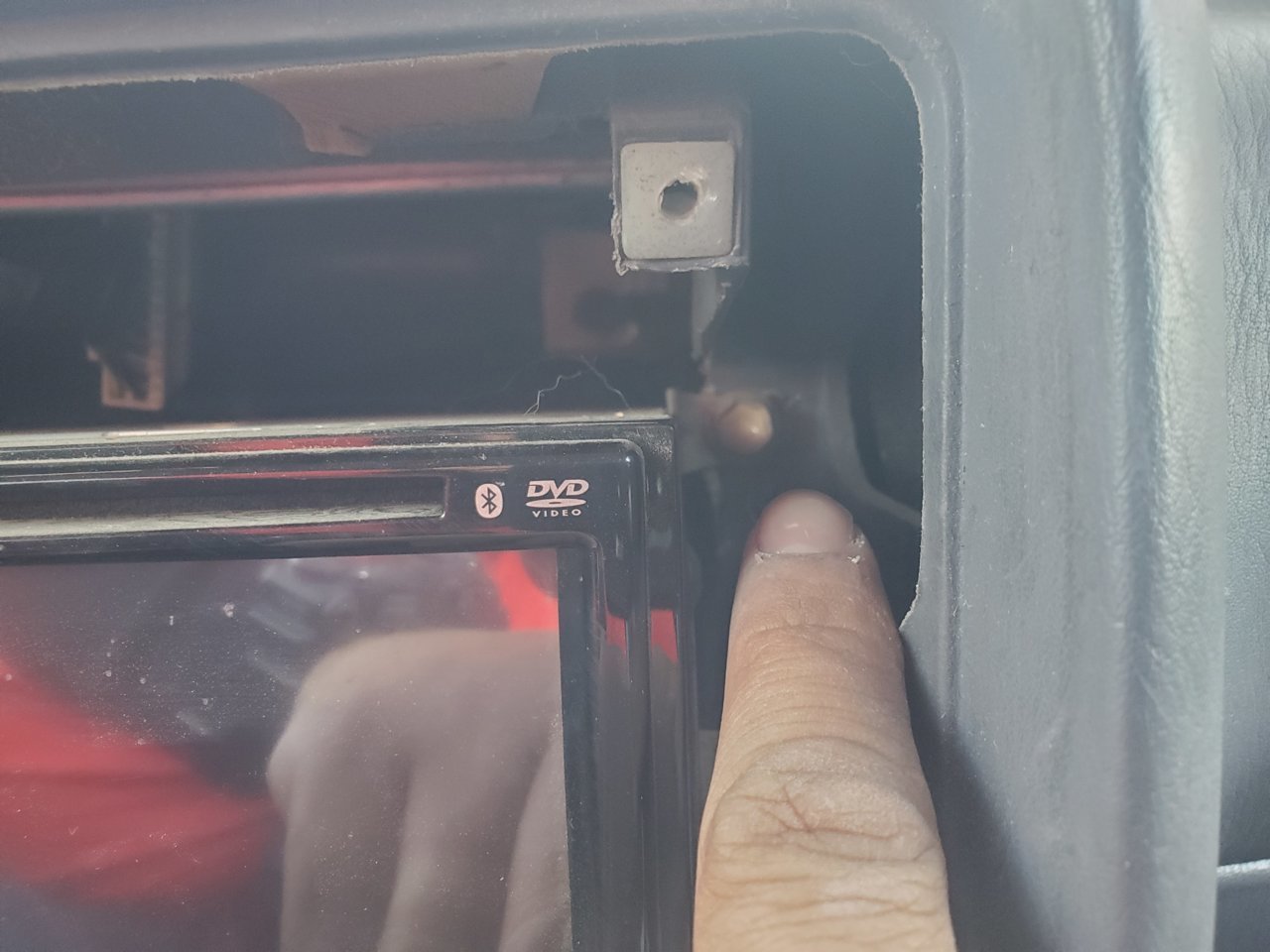

    Once the center was removed, I ran into my first obstacle; a bolt in lieu of your standard philips head bolt.

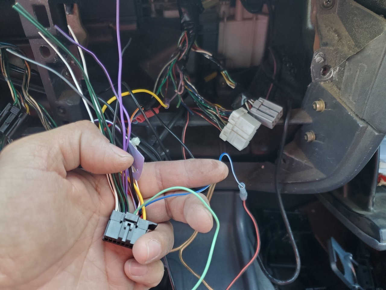

    The fuckery had only began, once I pulled the stereo I was introduced to this.
    Fuck me.

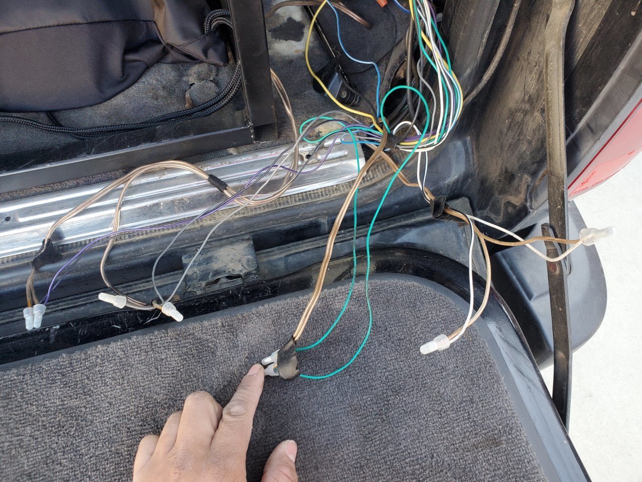

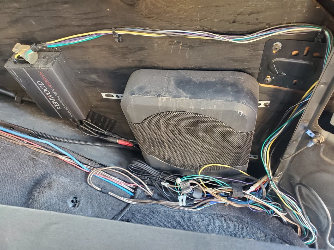

    Normally, one would buy a harness adapter and properly connect said harness wire ends to that of the aftermarket headunit. In this case, the previous owner simply tapped into the factory harness and made a mess of shit.
    Seeing now that the speakers weren't being powered by the headunit, I thought I'd take a chance and see what was running in the rear. What lead me to do this was the fact that I found some RCA cables as well as some 'amp turn on' leads.
    Low and behold, my own clusterfuck tucked neatly behind the panel.
    On the plus side, it's cool seeing that I've got a 4-channel amp and a self-amplified subwoofer. Not only that, a backboard where the amplifier and subwoofer are bolted into place.

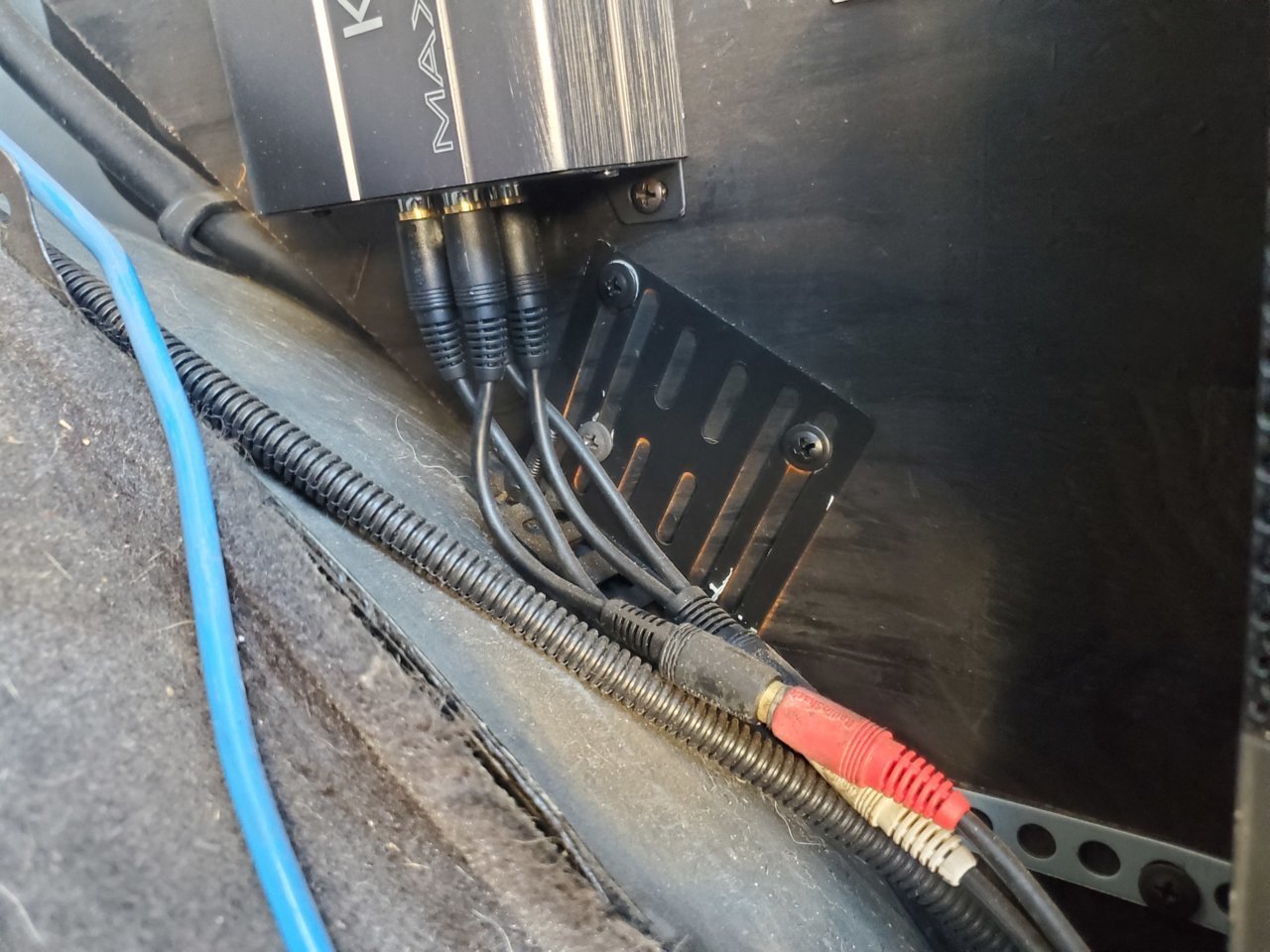

    After pulling the nest of wires I was able to figure things out pretty easily. At first, my assumption was a half-assed line converter or something similar after first seeing the RCA's up front.
    What is really going on is this -
    New speaker wire was run to each of the front 4 speakers and run back towards the 4-channel amp. As for signal, 1 RCA cable was run from the headunit towards the rear to the 4-channel amp, and connected to Y-cables to split the signal to both the front and rear channels. With the exception of the Y-cables, the principal here is correct but the whole job itself was done really fucked up. I also found that some of the wires 'terminals' were loose.
    I pulled off the Y-cables and decided to simply run one set of RCA's into Line A. I did this because I was able to see that at the very least, the speaker wires were properly labeled for FRONT and REAR as well as LEFT and RIGHT. That and I also disabled the high-pass filter that was left on; figured I could simply adjust from the headunit itself.
    Jump back into the rig, I fired up the headunit and was introduced to wonderful sound from my front speakers!
    Sure they're small but I'm genuinely surprised at how loud and clear the fronts sound. This is of course all due to the external amplifier, but man it's nice to have. After adjusting crossover points on the fly, I'm finding out that the Alpine subwoofer back there is struggling to keep up with the fronts. I'm sure being an 8" sub in a large vehicle isn't helping.
    Now that I've got pictures of everything, I'll have a better idea of what all will need to get done for once I pull the rear seats and shelf/frame.
