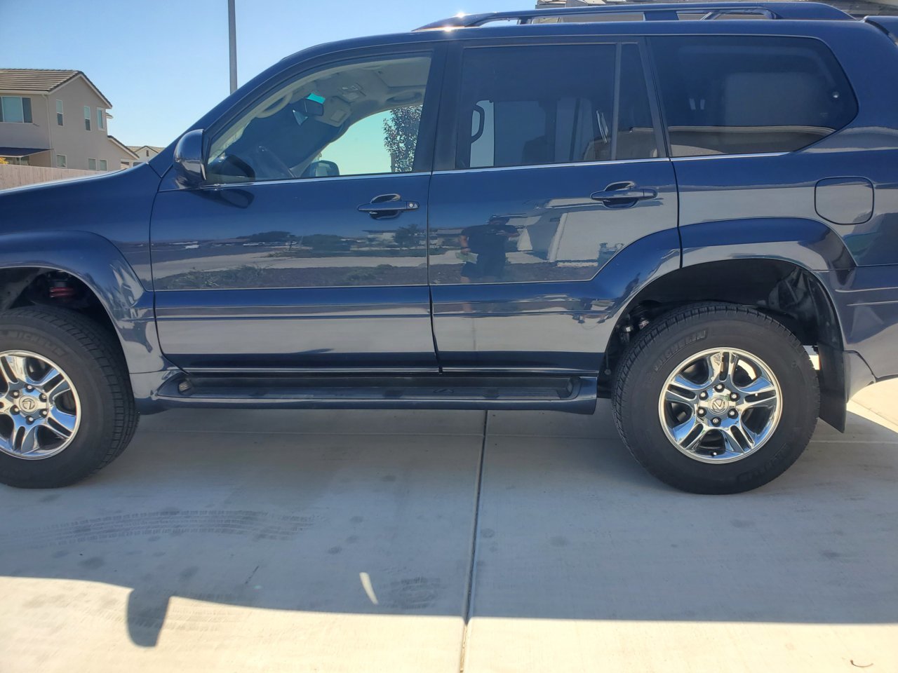

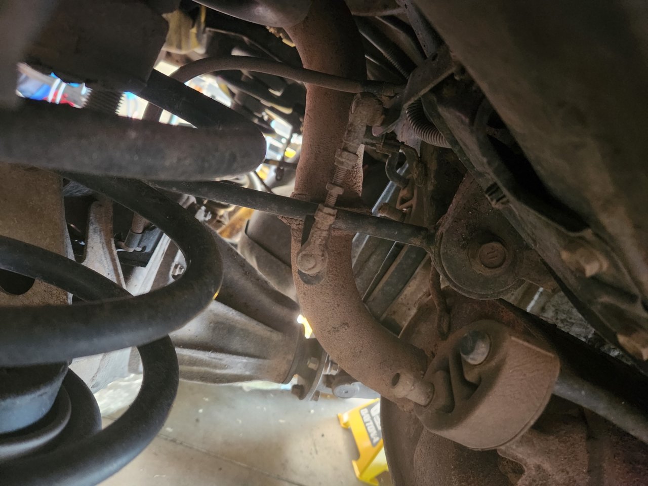

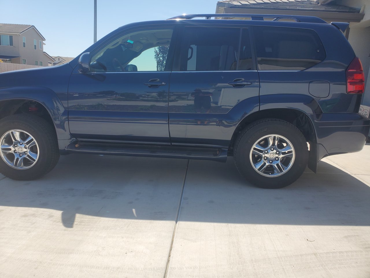

    Was busy but I took this video and these pics just for you.
    https://youtu.be/qr44v9XdSRw
    He wasn't hiding anything at all, if anything he's been super thorough about the vehicle and it was well taken care of by his BIL too.

    IIRC, it will default to "normal" everytime you start/stop the vehicle. He probably pulled the relay so that it stayed at the "high" level to counteract the spacers. Looks to have a little squat on the normal setting.

    My driveway is sloped a little but yeah you can see in that first picture, the front sits higher.
    I'll need a day to pull it into the garage and pull the coilovers; will need the new top hat parts/bushings just to ensure it's all new stuff then I'll be able to bring the rear height to Normal so it levels out.

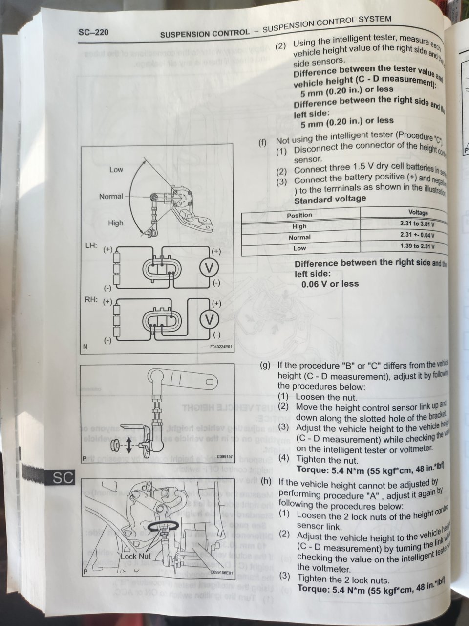

    Side note, you can also adjust the height with the adjusters on the rear control arms if you want to fine tune the height a bit more.

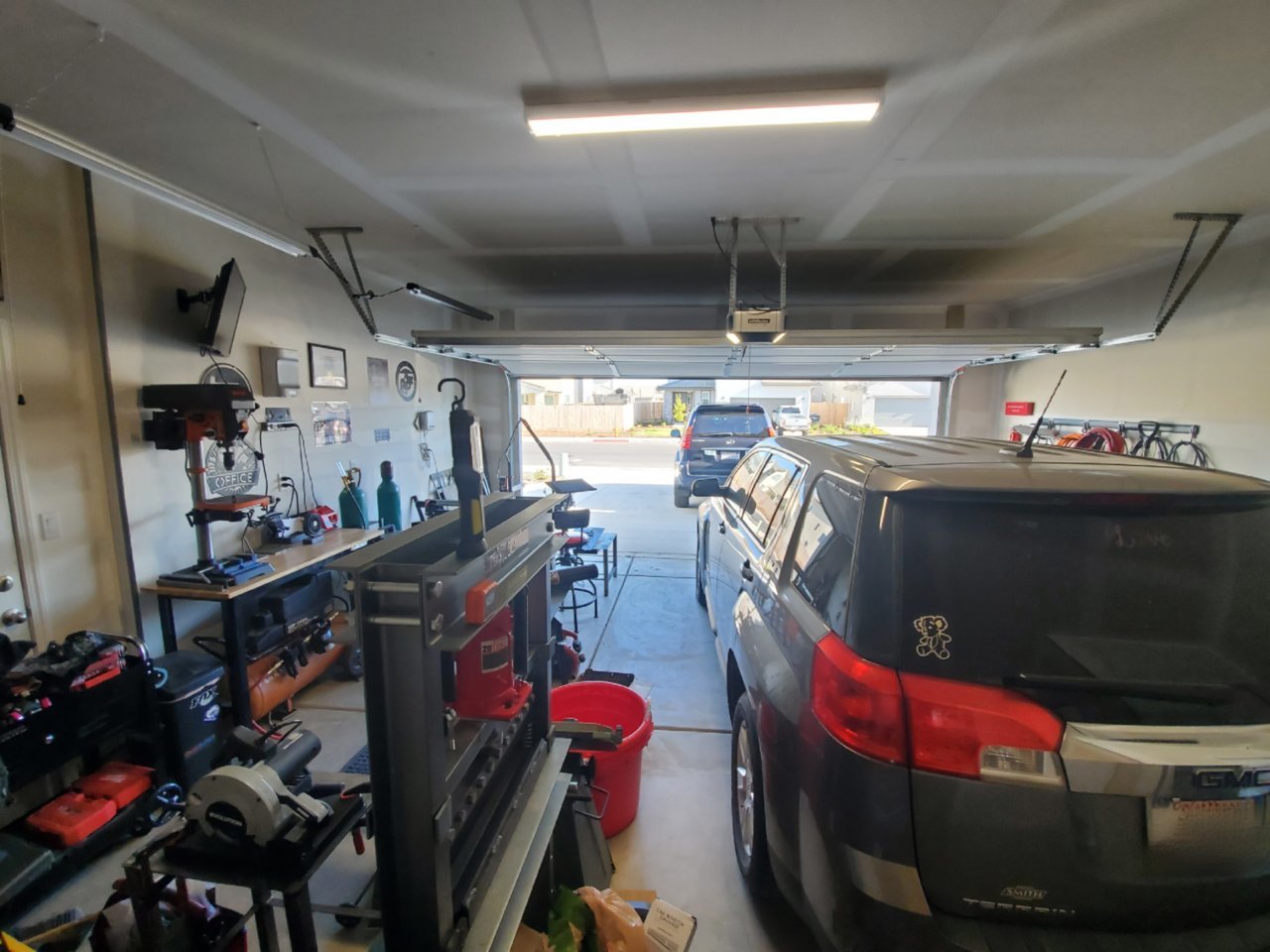

    Lol my garage is small, wife's car is inside right now.
    Although the 80 fit just the same. Just have a bunch of tables and tools taking up room on one side.

    But that thing looks super clean. You find more rust on new vehicles sitting on a lot.

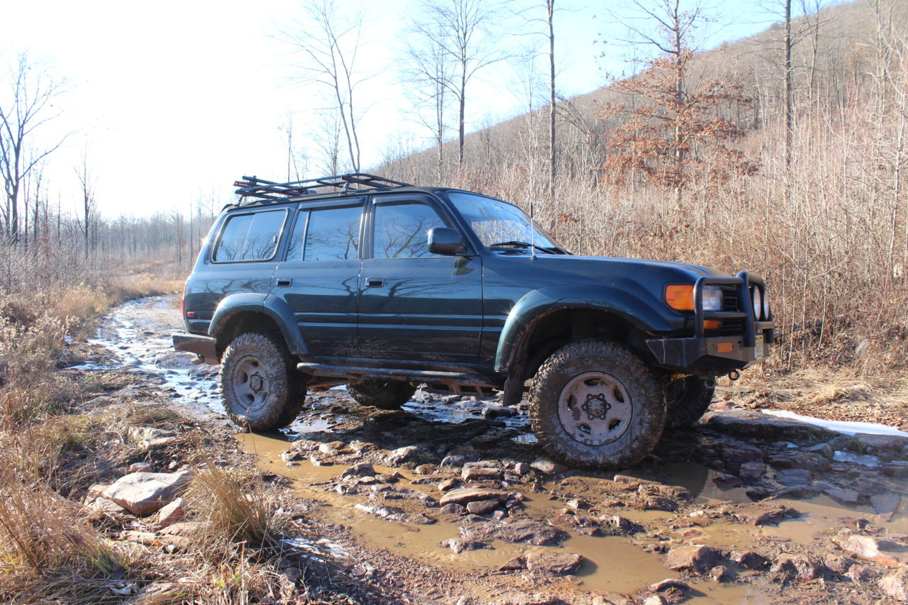

    This is when I had 33’s on it.

    Oooh yeah yours wouldn't fit in my garage :rofl:
    My 35s (and 33s as shown in the previous page) had a much smaller gap between the wheel wells.
    Ran Dobinson progressive coils which actually made for a comfortable ride.
