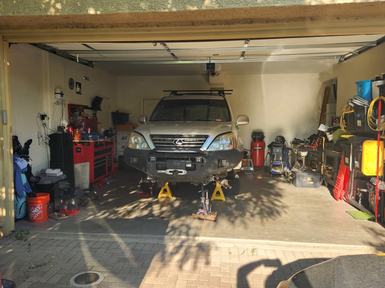

    Yeah, I'm on 265/70/17's (barely 32's) and am only an inch or two from the garage header. Kind of a pain since I need to remove the RTT anytime I need to pull it into the garage.

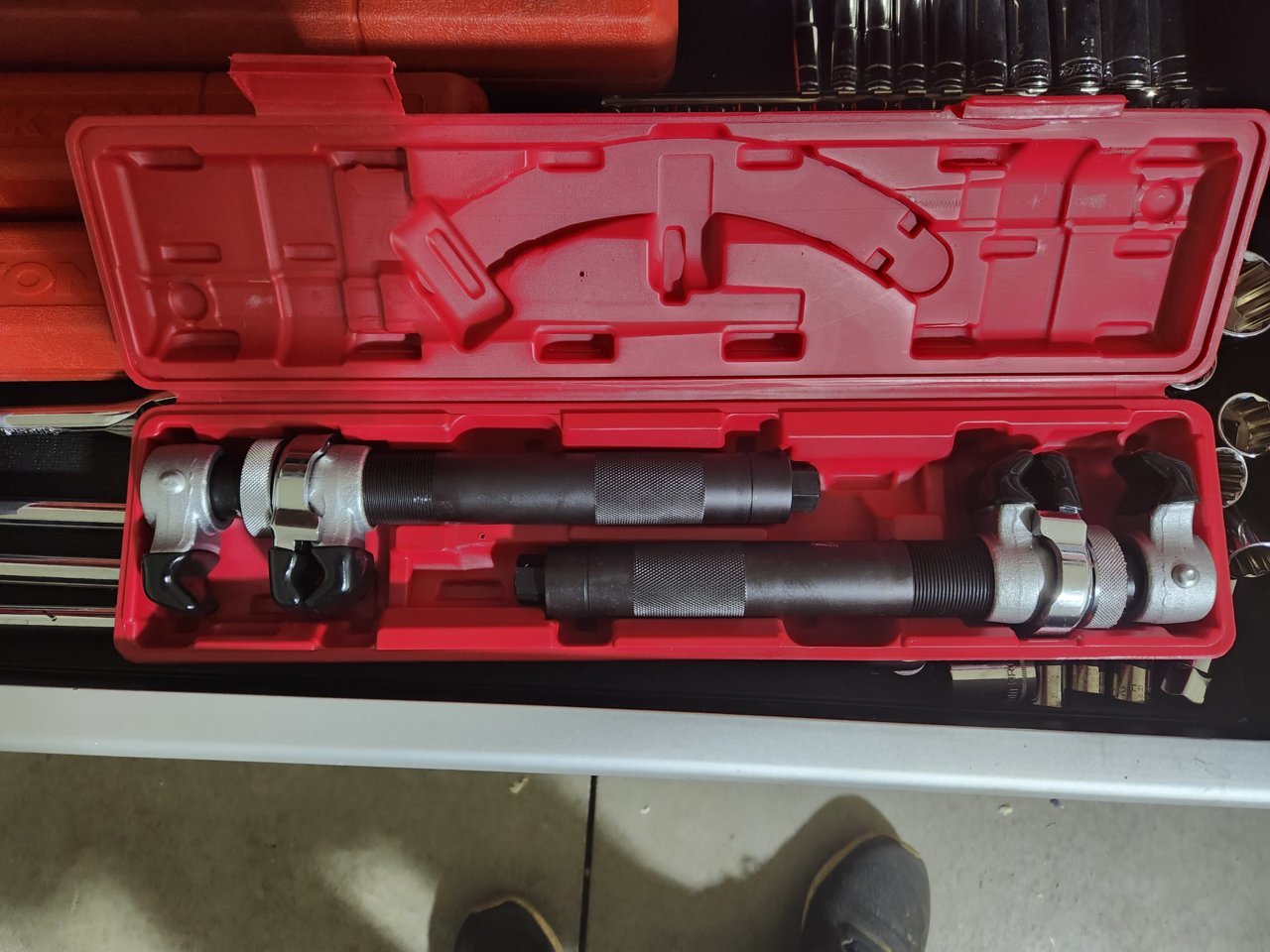

    I have SPC compressors that @Shmellmopwho recommended in the tool thread. You are welcome to borrow them if you want...

    GX looks good!
    I'd have to buy jacks and jackstands first though; all the ones I used to have and use for the 4Runner and Tacoma got stolen when I moved. :bananadead:
    I drive the wife's car up on blocks when I service it, and the LC was tall enough where I just went underneath with the creeper. :anonymous:

    @Gen1FTMFW Sup with the penis-shaped indentation in the box?

    Yeah, it's one of the shitty parts about having KDSS. Have to have all 4 corners off the ground in order to remove the front sway bar and the front sway bar attaches to the LCA.
    Haha, one of the first things I noticed too. There was some mention of it in the tool thread. Some kits come with a bracket that ties the two compressors together. It is oddly fallic shaped...
    https://www.tacomaworld.com/threads/garage-shop-tools.589784/page-293#post-28803726

    Oh dang, that's a pain in the ass it sounds like. But it's not like you're swapping coils or shocks all the time anyway so minor inconvenience.
    I had multiple jackstands cause I had replaced my leaf pack, and those for several other members, at my old place. Really convenient to have.

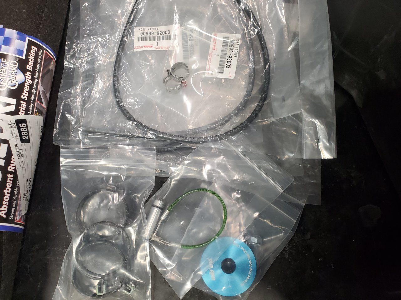

    Oh I kept a bunch of extra vacuum lines, an offset seal driver, as well as a Wit's End "emergency plug" for that tapered plug on the steering pump.

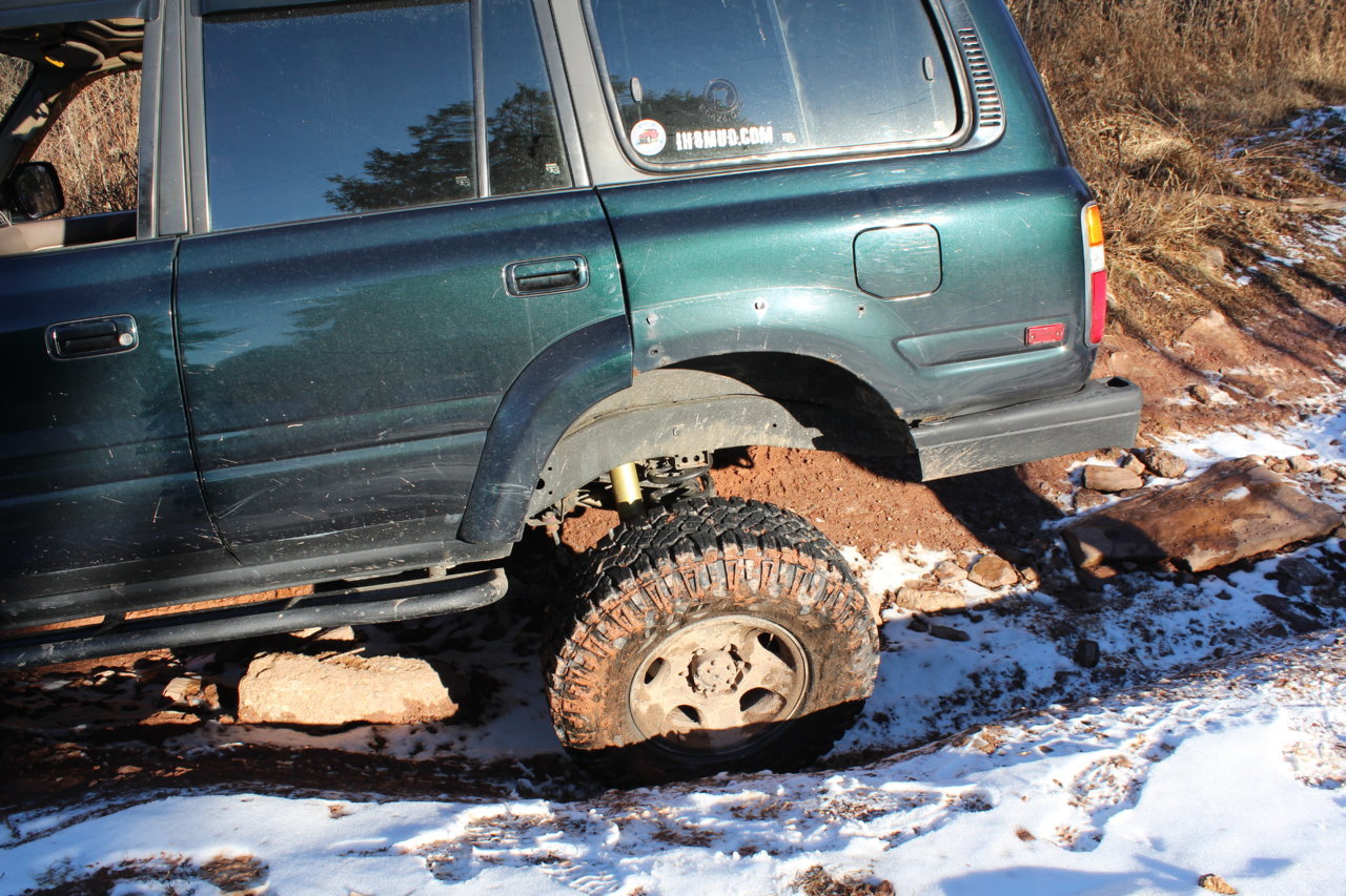

    It's 26 inch total travel. I forget the stock travel though. But enough I really do need coil straps to prevent the rear coil from popping out. with the rear swaybar removed when I crawl I can almost spin the coil spring in the perch it extends so far. The upper link prevents it from popping out lol

    This is the long travels on 33’s with the sway bar still connected

    Oof
    Yeah the previous owner spun the front coil around already (no front swaybar), and I found myself doing the same even though I'm on Dobinsons. Used to have OME when I first got the rig.
    Front shocks only had 9.8" or so of travel (like 13" to 23" shocks) but the rears had a tad more for 10" of travel. Even then the front drooped enough to allow the coil to float. :bananadead:
    The extended bumpstops in the rear limited my up travel which in turned kept a rear wheel from drooping so much.
    Had the same shit happen with the 4Runner rear too!

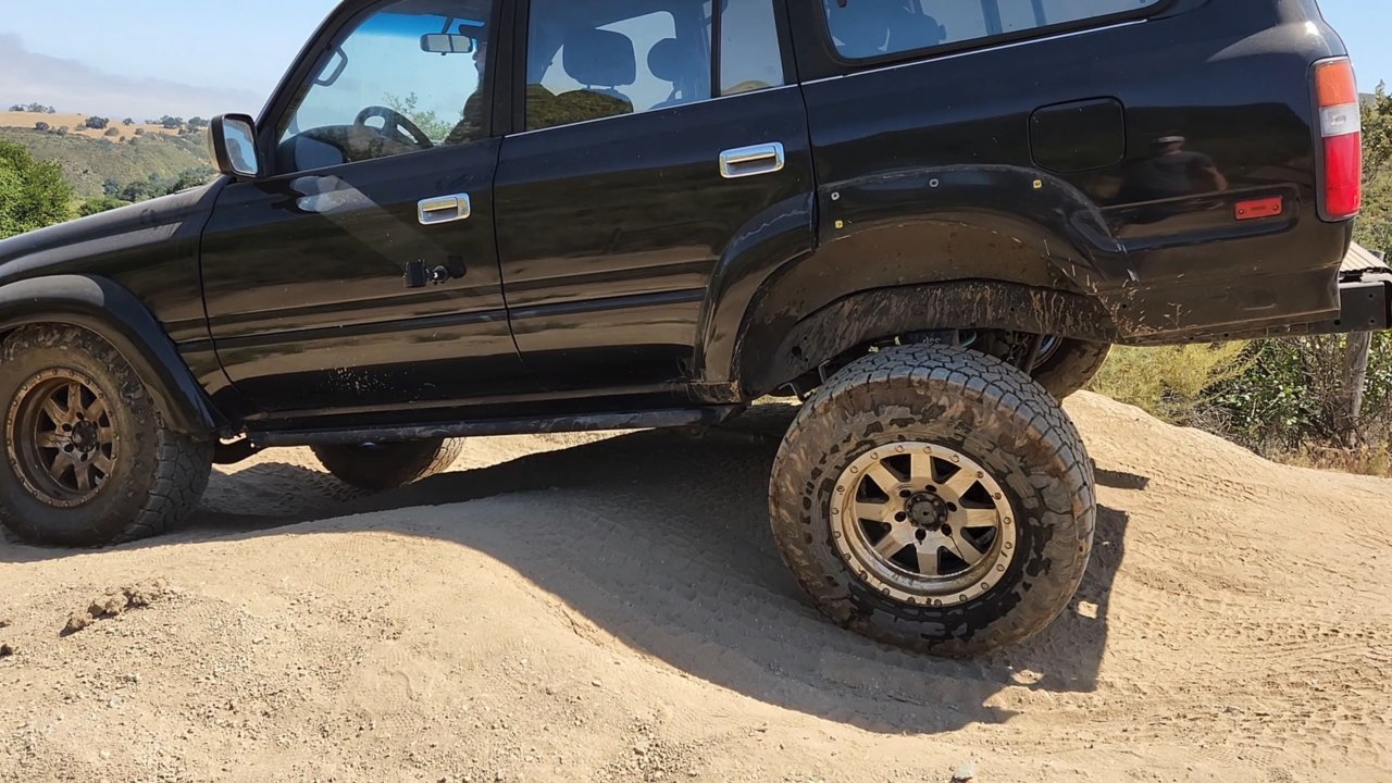

    Mid-travel on 33s with the sway bar on as well.
    Except uptravel limited on the passenger side due to extended slee bumpstops (you can see it peeking) which prevented driver from drooping more.

    Yeh I kept the bump stop OEM height I think. I need to stuff as much of the tire as I can into the wheel well sometimes.

    The bumpstop extensions were from the previous owner!
    I kept forgetting to take them off and too lazy to find the right size bolts :rofl:
