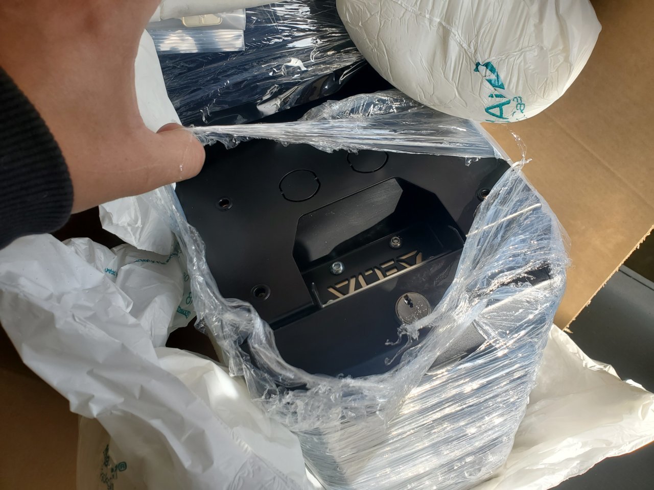

    Due to limited time, I may push this install until Friday or Saturday. With that said, I wasn’t going to leave myself (or anyone here) high and dry without some pictures!
    Once you open the box up and pick up the pieces, you SEE and FEEL the quality right away.
    Starting with the small faceplate, where many different styles are available to fit ones needs. As you can see, I went with the basic one as I have no need for multiple switches, an S-pod, or similar devices. No extra charge when picking between faceplates.
    To prevent any marring of the finish, each and every panel was individually wrapped as so.
    Even the hardware looks fantastic.

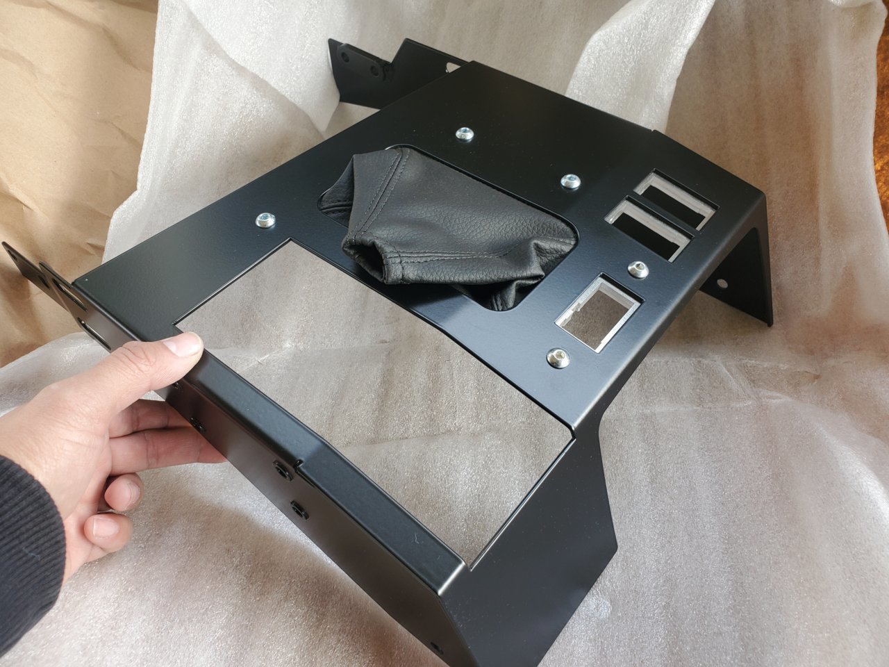

    Digging deeper I found it, the main piece that brings everything together...
    the shift console!
    It screams quality. The metal is surprisingly thick as hell too, adding a lot of weight to the console. No worrying about vibrations here!
    Someone did ask about the new shift boot for the transfer case. I'd have to look at my invoice but I'm 99.9% sure I paid the extra to get it. I didn't want to reuse my old one as it's dirty, dry, and about to rip.
    Nice thing is, they topped it off with a fully printed instruction manual, AND A STICKER :angrygirl:
    Bronx couldn't hold his excitement as he wanted to be a part of the unboxing :rofl:
    Not to forget, the locking center console!
    This thing is wrapped up so well, it pains me to take it out considering the install won't happen today, so here's a sneak peek.

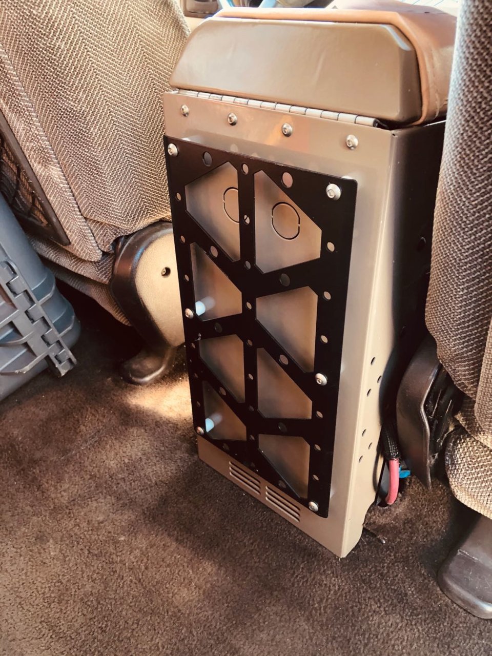

    If you scroll up, you'll see a rear plate attachment for the Delta VS center console. I plan to use that as the mounting platform for the Uniden.
    This center console has seen better days :bananadead:

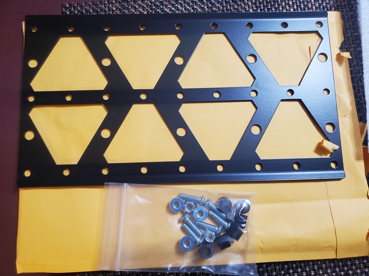

    Man, Delta VS is fast at shipping shit out!
    Expected delivery of Saturday turned to getting those parts today, just in time for tomorrow's install!

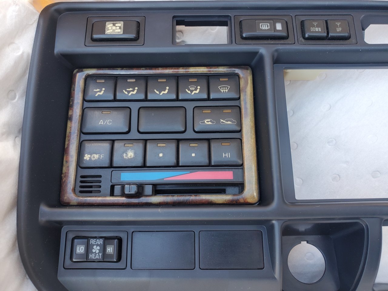

    Here's the double din, climate control bezel replacement.
    And the bracket for the center console; what's cool is this can be attached inside, on the outside, or the rear. Will be perfect for the CB radio in the back.
    And in case you didn't notice, yes that's another Toyota plug to cover any and all blanks.

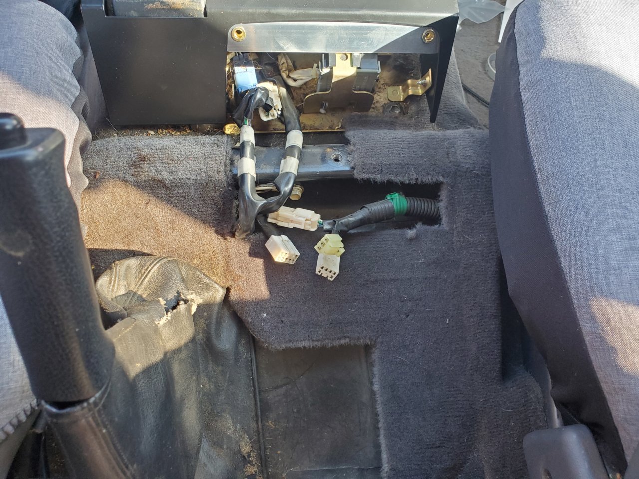

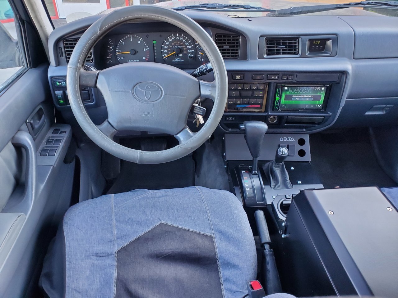

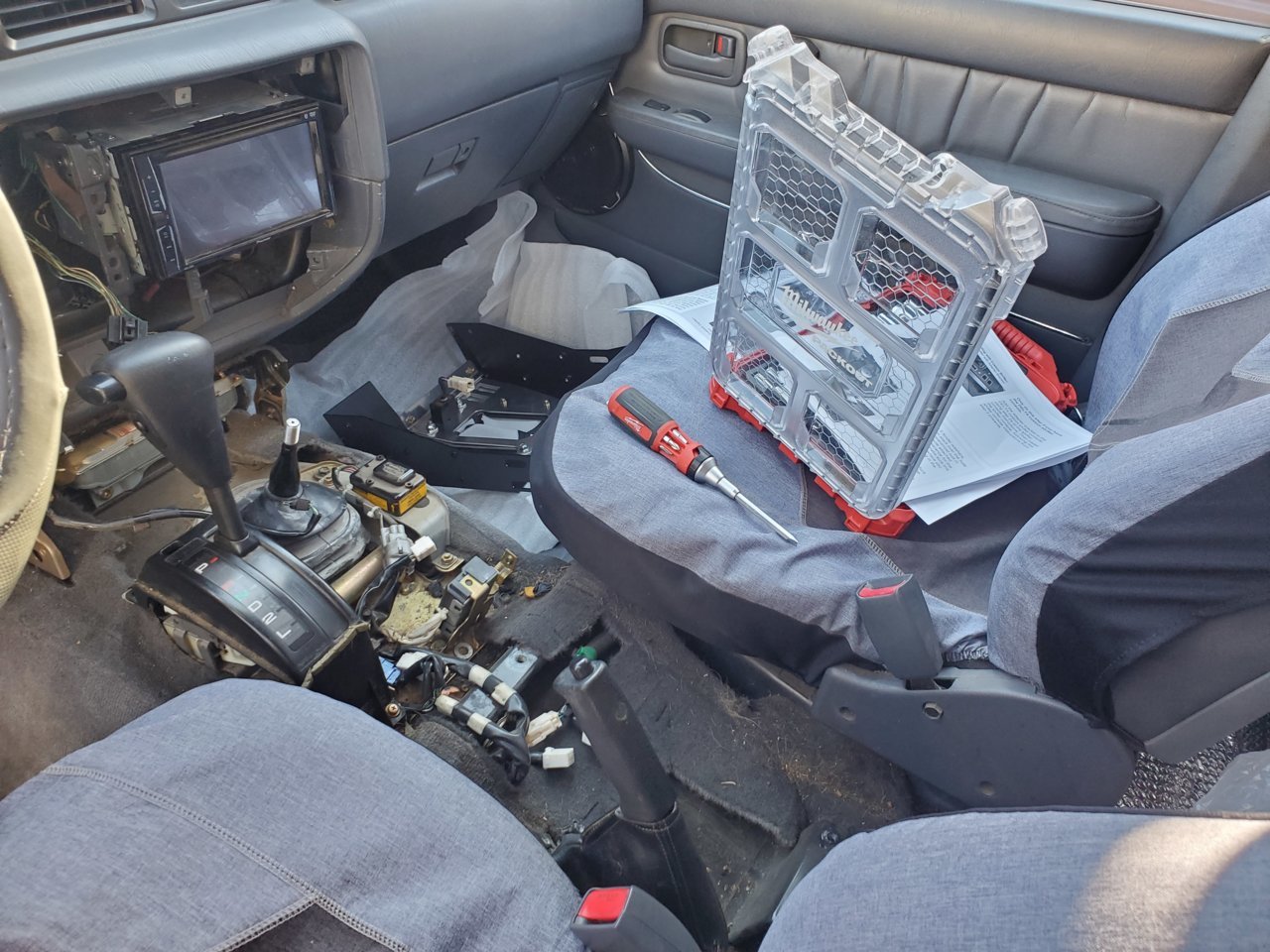

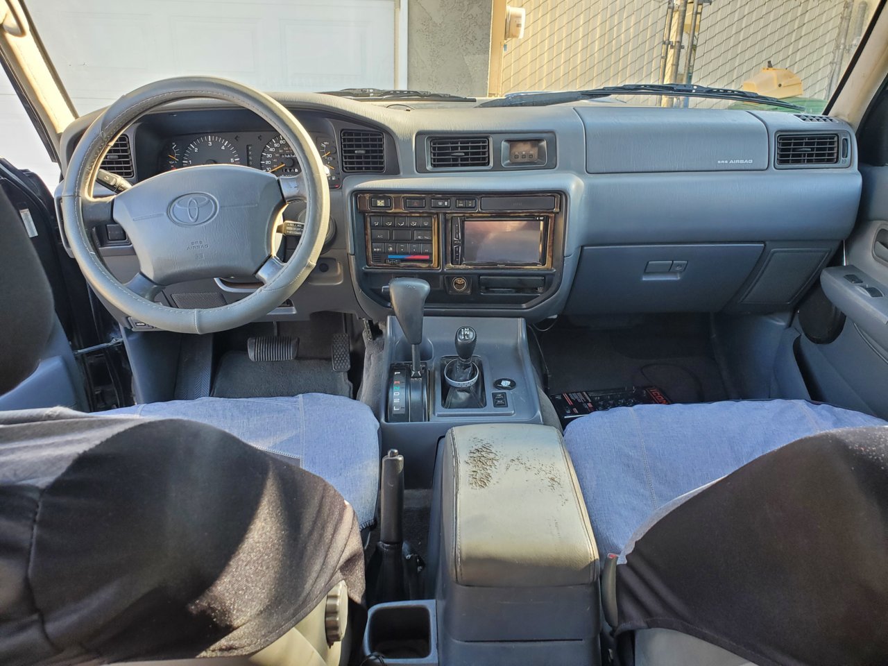

    Alright, the moment some of you have been waiting for. It's been a bit of a day you know?
    We all know threads are useless without pics, so here we go!

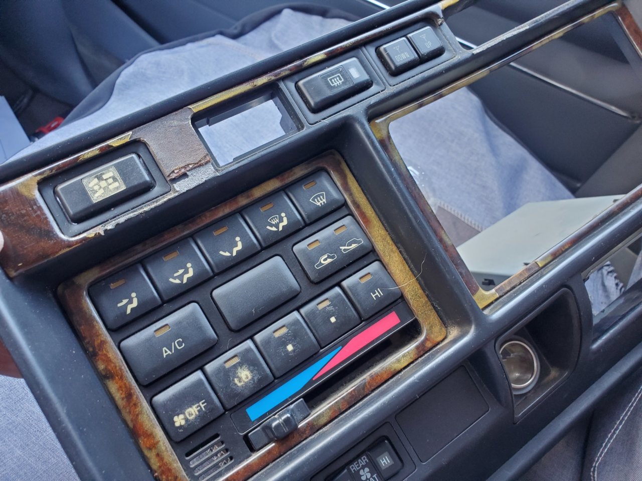

    The interior really needed a change, not so much because the vehicle is old but because it's really beat to shit. The pictures make the console look nicer than it really is, but not only is it filthy, it has tons of scratches all over the plastic. If you missed the before pics, just scroll up a few posts.

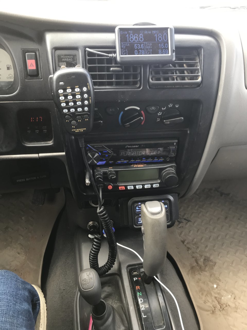

    Here's a quick one once I pulled off the climate control bezel, shifter console, as well as the center console. God knows how long all that dirt and hair has been there.
    The factory goodies.
    Here it is up close, just before pulling off the switches.
    With some elbow grease, I'm sure I can get the bezel looking really nice once I pull off the wood trim. The unfortunate thing here is, I was under the impression that the wood trim specifically around the climate controls was part of the larger piece.
    The new one, receiving all the goods. I'll have to stare at the wood trim for a bit longer until I decide to do something about it.
    Before install, it only seemed fitting to give it a quick vacuuming. You'll catch a tiny peak at the new shifter console partially installed.
    Also, it's cool to see that there were multiple options available for these LC's to include but not limited to a phone, multi-disc changer, and even a fridge!

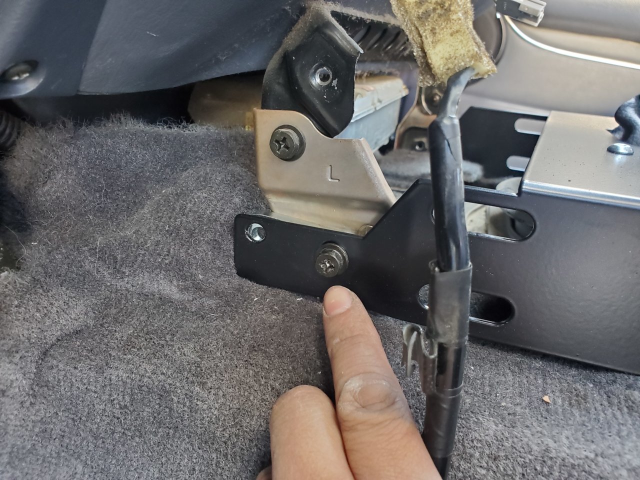

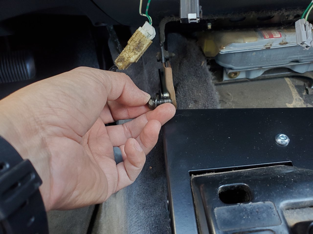

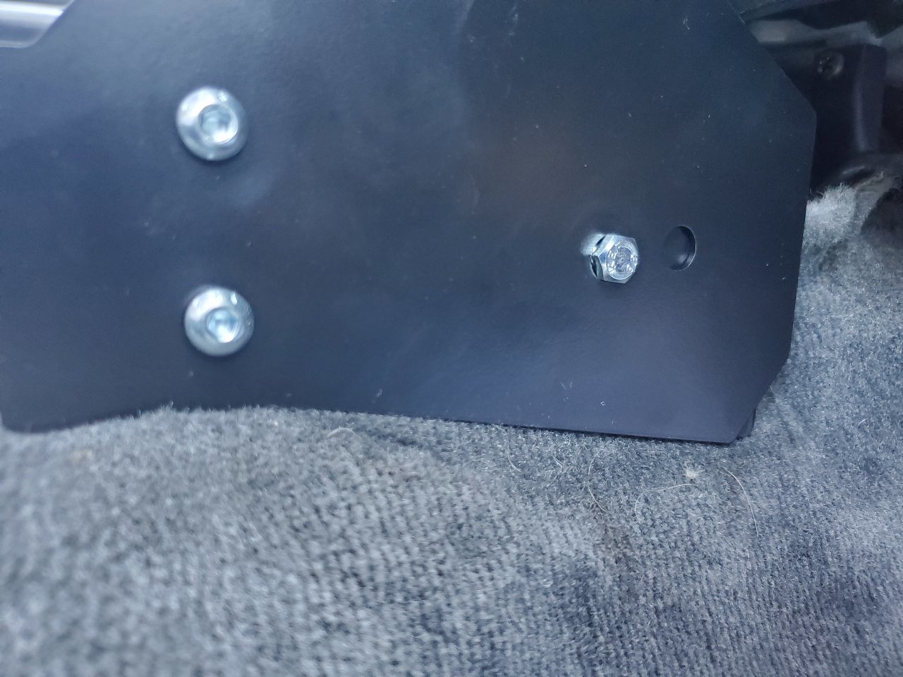

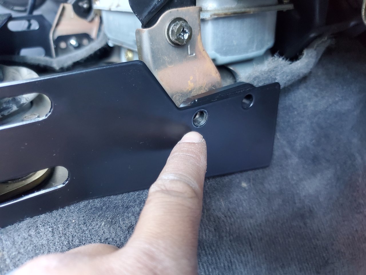

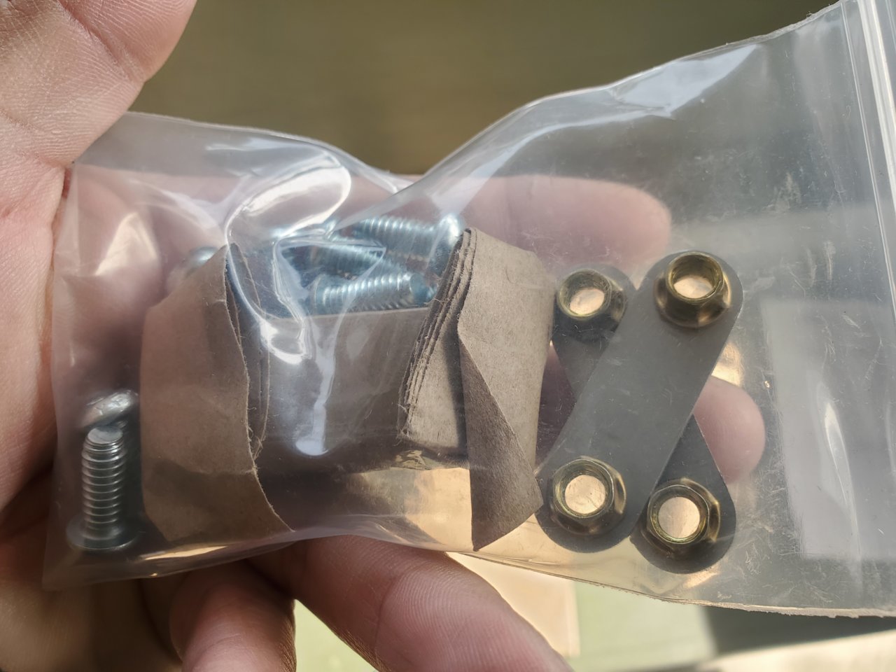

    Now I say partially because I ran into a bit of a hiccup; Delta VS provides a lot of hardware but in one instance, they require you to re-use your factory bolts.
    Those are the M6 bolts located to the front of the shifter console. Unfortunately, due to the spacer and panel, the bolt is just too short to get threaded on. I mean, I barely got the left side to catch but made absolutely no progress on the right.
    Here you can see what I mean.
    A trip to the local hardware store took care of that fortunately.

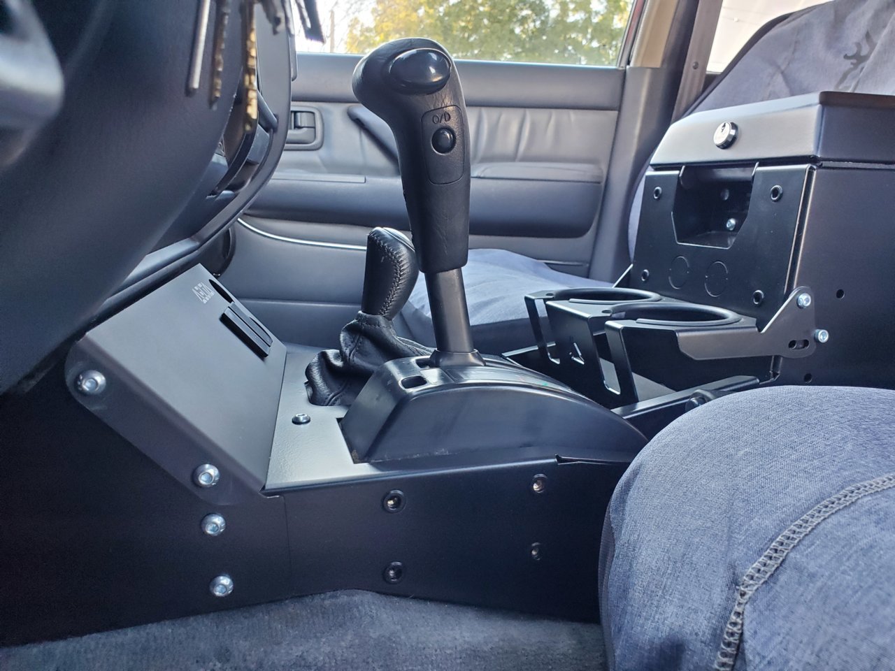

    Once those were in, it was onto installing the console and *drum roll* CUP HOLDERS!
    I had completely forgotten I ordered them, and so when I found a box inside the center console, I was genuinely confused until I opened it :laughing:
    And here she is installed!
    Hope you all enjoyed!
    Now for my other shit to arrive.
    As for the rear mounting plate, I figured I'd hold off and just uninstall the CB radio. Once I opt for new comms, I'll go ahead and install it to the rear of the console.
