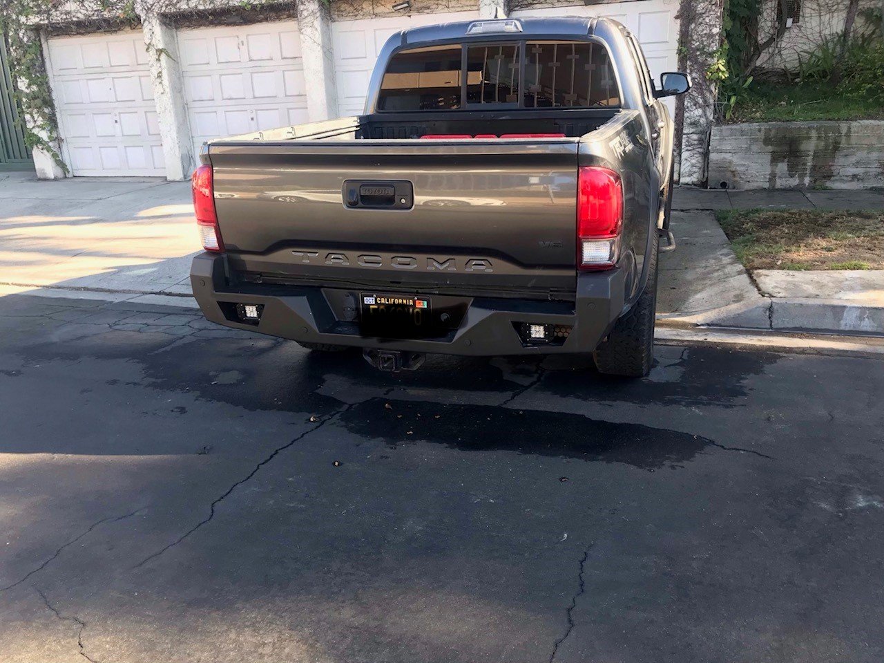

    I desperately needed some rock sliders after getting a dent on my lower section of my driver door I popped it out but did not want this to happen again. When it came to my design I wanted to make something with a kick out and a small step but not a huge step. I used 1.5" 11 gauge square and round tubing for this build.
    After welding up all of these I had decided to try and make them bolt on. This quickly faded after some difficulty drilling hole and alignment issues so I welded them directly to them frame. You can see in the next picture I primed them with a brush on primer and then covered them in Herculiner. I 10/10 would recommend herculiner, it has faded a little bit from an original shiny gloss to a matte yet held up like a champ! even after hitting some rocks on trails it is still holding on.

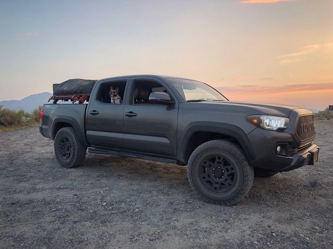

    I picked up my 2016 Taco DBLB TRD OR a few months ago. Before this, my vehicles ranged from an STI to an Infiniti G37x, with a couple street bikes along the way. Once the 3rd gen Tacoma's came out they immediately caught my eye. Throughout this thread, I will try and post pictures/plans of all the parts I fabricate for my taco. Sorry for the lack of pictures up until this post, in the future, I will post more with details.
    Picked up looking like this, after a few trips to the desert and dunes (pictured above) I knew tires were going to be on the top of my purchase list.

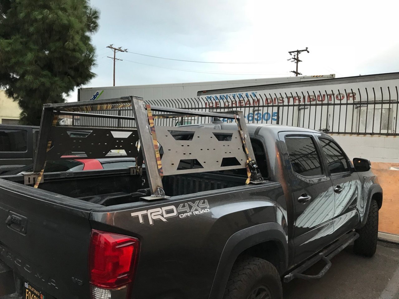

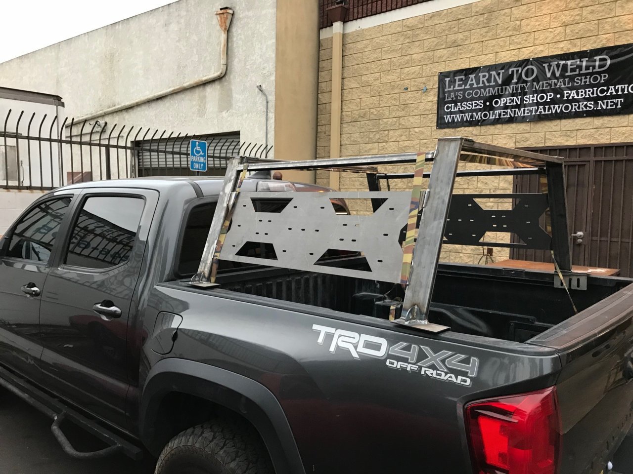

    Now onto making the roof rack. After designing it on AutoCAD it was time to get to work. I used 16gag 2" square tubing to make the cross beams. I wanted there to be a little room to access the bed while camping from the side also I plan on attaching a shovel, hi-lift jack, and an ax directly to the rack. The top tubing is 16gag 1" made into a 48"x48" shape. The cross tubing is 6", 12",12",12", and 6" apart in respective order. Welded this all up nice and strong. I attached it to the bed via the stock bed rails. I CNC cut some brackets that lined up directly with the rails and are slotted to adjust for height. Using 8 @ 10mm bolts and some T-NUTS this thing is secure.

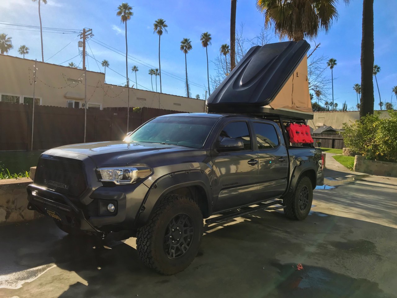

    Now it was time to fabricate a new rack as I had found a solimar hard shell rooftop tent. I wanted it low profile as close as possible to the cab. In the end I had to cut the shark fin down but it turned out great! The spacing on the sides was done to be able to fit rotopax and accessories. Currently has a 4 gallon gas on the driver side and a shovel/axe on passenger site with monkey grips.

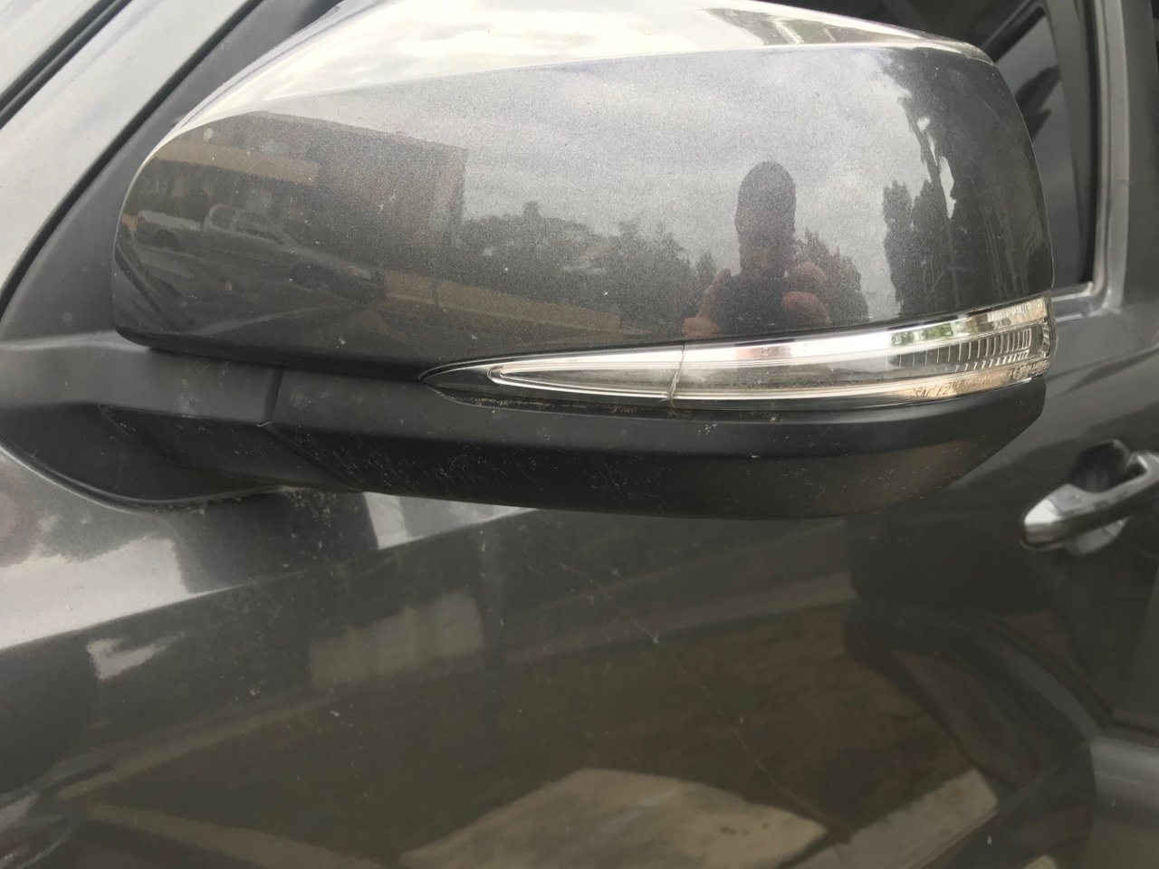

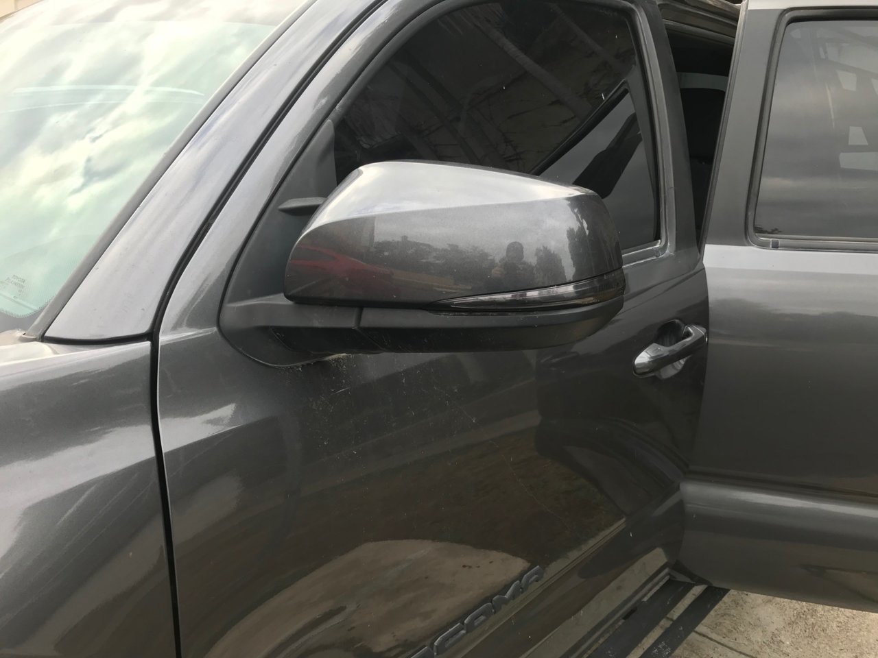

    Easy quick mod, ordered some 3M tint and did the turn signals. Got some OEM ones off TW as mine were cracked from the exotic streets of Los Angeles.

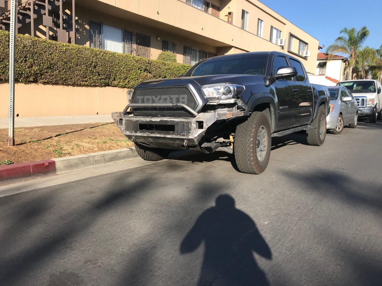

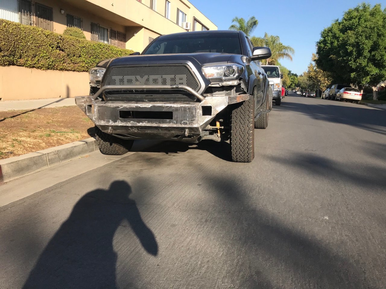

    Great bumper debacle of annoyance and frustration. I decided to test my fabrication skills by building a front bumper. Stop, do not attempt to do this as it will lead to many hours of frustration. Even after prototyping on CAD, with cardboard, this project was the first I was not happy with. Here is the pictures of the full bumper I built and scrapped. Ended up cutting my rock sliders which was a further mistake but I had dug myself a hole and throwing money plus time on top of this project.
    My overall opinion was it is two bulky and did not like the view from the side. Looked empty and not clean lines.
    OVERALL FAIL

    #18
    jowybyo
    jowybyo Well-Known Member
    Nov 19, 2013
    #116863
    6,092
    Joe
    Baltimore, MD
    '14 MGM DCSB Postrunner 4wd Conversion, Debadged
    Dude, I literally feel this exact way every time I design a bumper. Even after a half dozen prototypes, I’ll still be frustrated, hate it, and want to scrap it.
  19. Jan 30, 2019 at 4:40 PM
    #19
    NonTraditional
    NonTraditional [OP] Well-Known Member
    Jan 7, 2017
    #206857
    270
    DMV
    2016 Tacoma TRD OR DCSB
    It is infuriating! The hardest part for me was designing from all angles. Yours look super solid. I keep wanting add some skids as I will be reaching out to you.
    I went ahead with the C4 LoPro. Happy with their quality and looks great!
