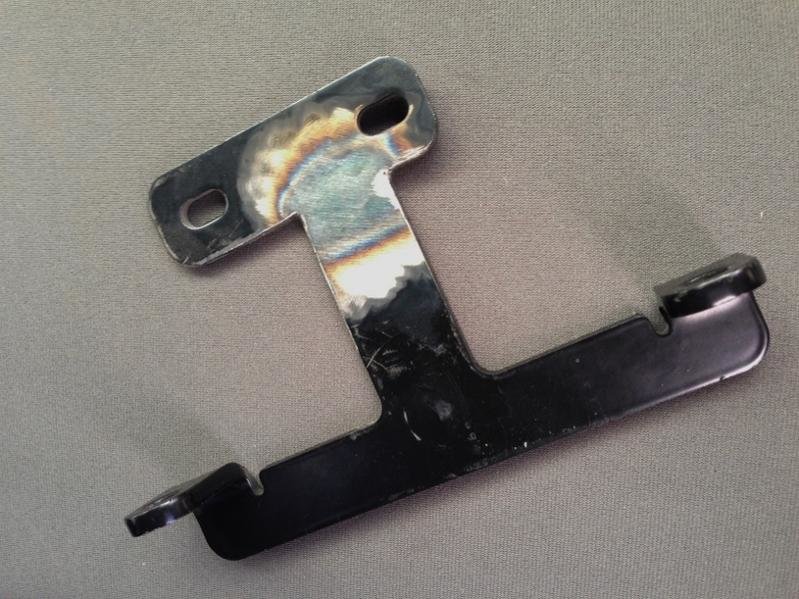

    I had to modify the contactor control box bracket so I can just attach it to the winch instead of making a bracket. I cut it off and moved it over about 3/4" and welded it back on.
    Paint is drying right now ;)

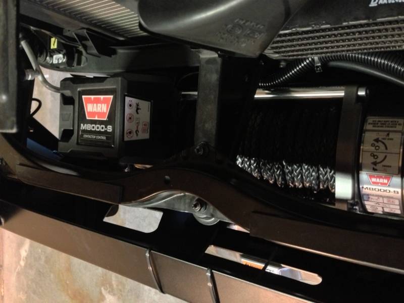

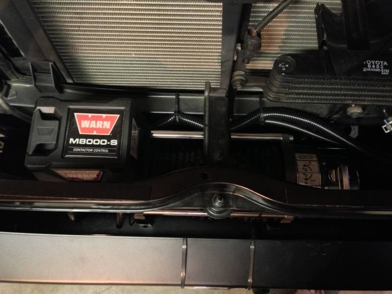

    The modified bracket worked perfectly!
    The contactor control box fits great. Got it all wired up and spooled up the new rope :D

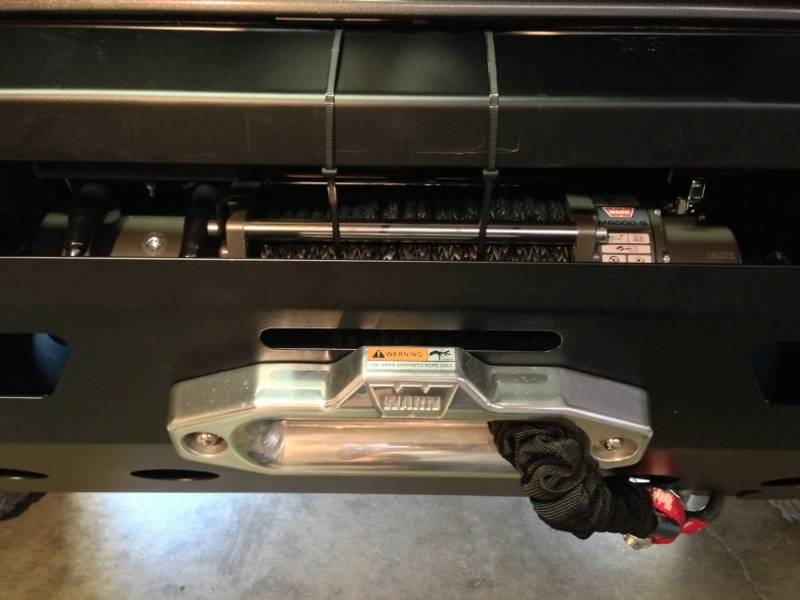

    Yup, just waiting on sliders now. Alex helped load the rope. Wife was in the truck riding the brake a little, rope was stretched out to a tree at the end of our driveway pulling the truck slightly uphill. She even helped run the rigging. I went over the manual with her and all the safety points prior to loading the rope.

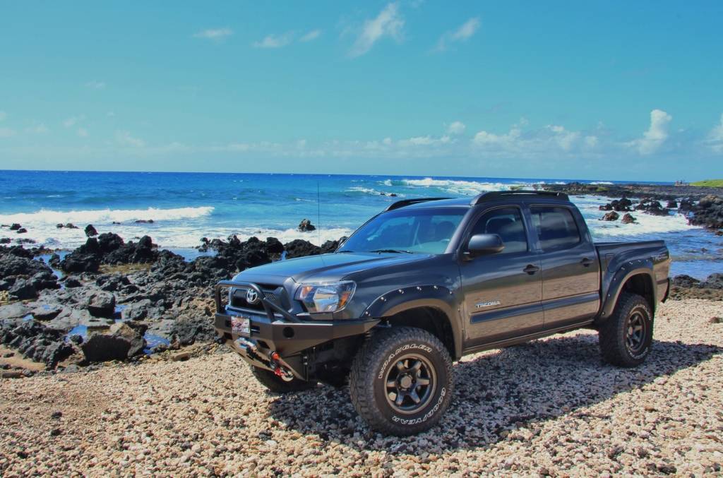

    Did a quick little photo shoot today before playing in the sand.
    Some jackass stole one of my shackles! :mad:
