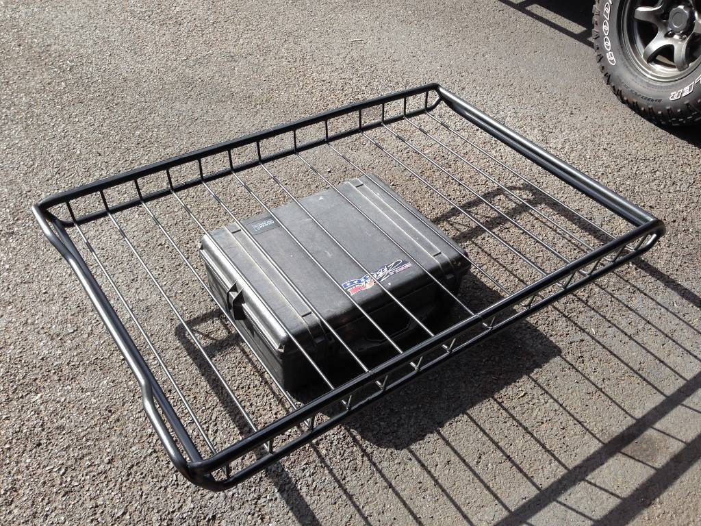

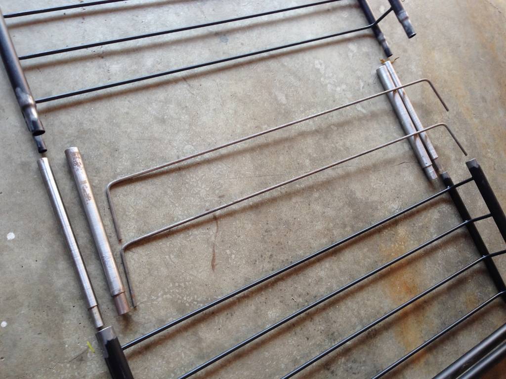

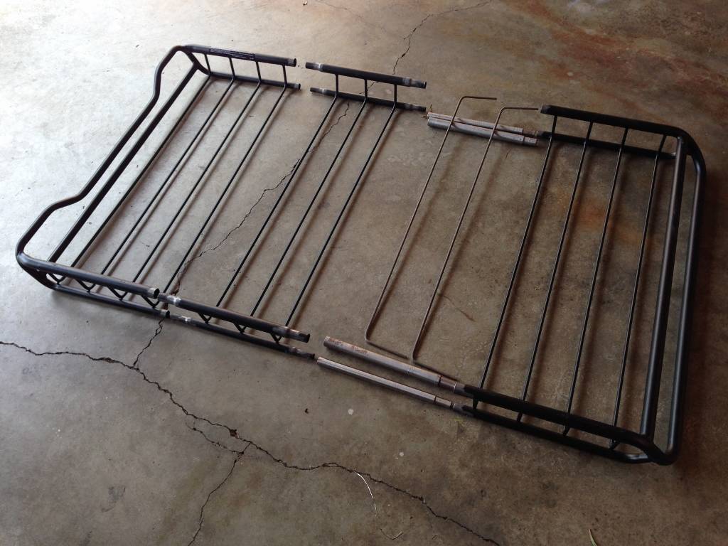

    So I bought a really, really cheap universal roof basket off Amazon. I knew it was too small, and would have to be modified to fit the non adjustable factory roof rack. But I was okay with that since it was so cheap. Supposed to be held together by some tiny screws :rolleyes:
    I machined some tubing and bent some 1/4" round bar to fit. Had to be around 10" longer to fit on the factory roof rack. The factory rack bars are just over 43" apart on center.
    All welded up :D The red stuff is glazing putty to hide my welds :eek:
    I seal welded all the joints, and plug welded the screw holes. I put the two ends on blocks, and jumped up and down on the center of the rails. Its very solid, and I don't plan on putting a whole lot of stuff up there anyway.
    Primed and painted :cool:
    I'll post some pics tomorrow after I let the paint fully dry tonight ;)
    I went the roof basket route instead of a modular roof rack like the front runner or PrInSu because I don't really want it up there permanently. I only need the extra space when we go camping. With myself, the wife and daughter and 3 dogs, the DCSB is pretty low on space for everything needed to keep all of them comfortable...

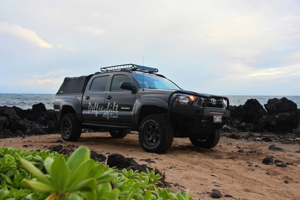

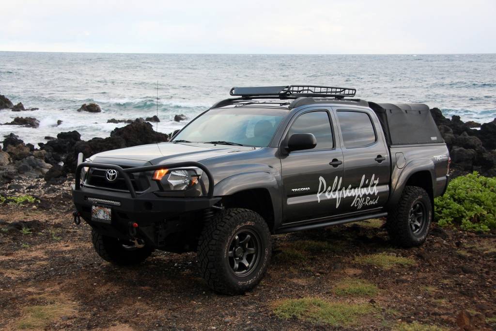

    Thanks! Pics with the basket on.
