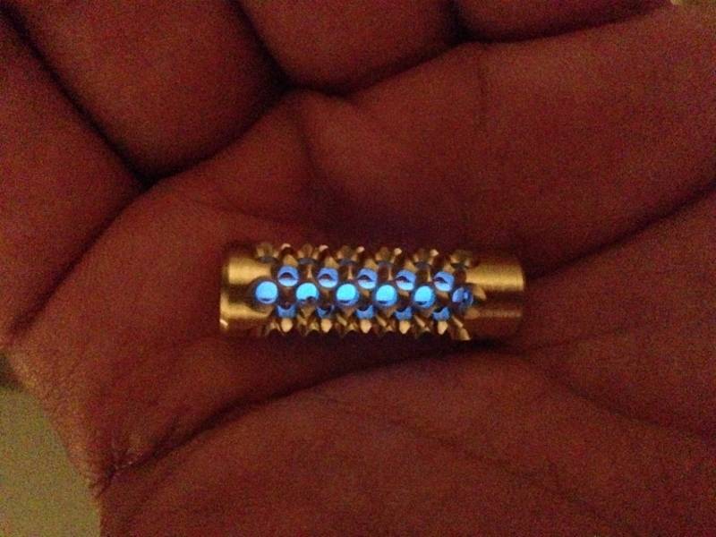

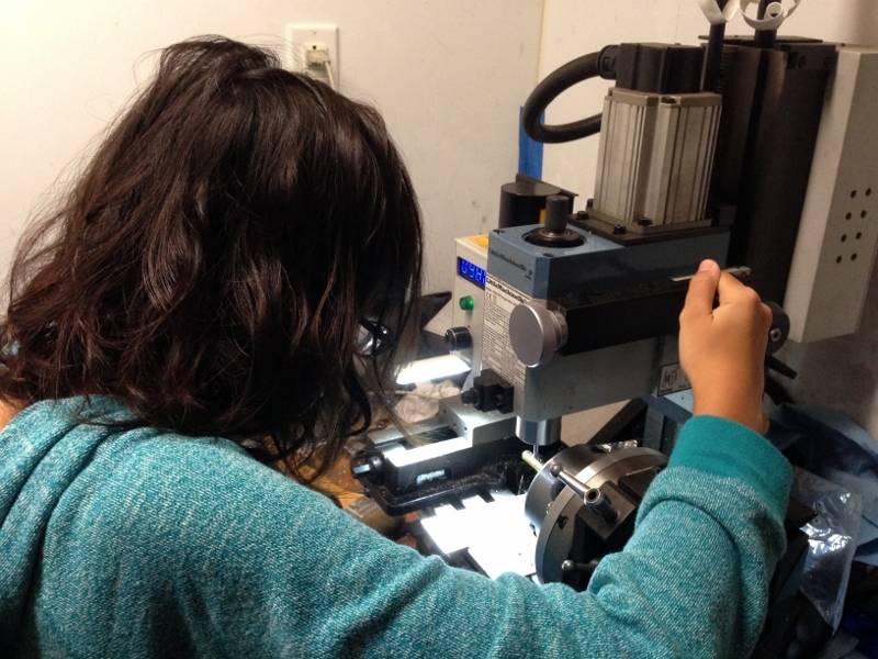

    So not much happening with the truck, but I did take a big step to making more isotope holders :D

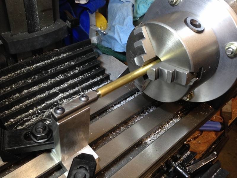

    The first few fobs I made were just roughly rotated by hand and eyeball to get the 4 or 6 sides. I was able to mount my rotary table horizontally. Now I can easily and precisely index the fobs for drilling. So I showed my daughter how to rotate it and space the holes. I chucked up some brass, set the stopper and let her go to town.
    She made this crazy 12 sided pinecone thing...
    Might have to recreate this in titanium :eek:
    It was bending pretty good as she was drilling, and I knew it would, so I made a simple tailstock after, and its perfectly centered to the index head :cool:
    Very necessary for drilling titanium.
    Now I need to secure some trits :eek:

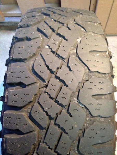

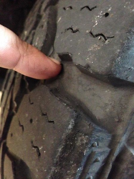

    Not my week. My battery went bad on Tuesday, and had to replace with an optima red top. And I just discovered this today.
    outside tread:
    inside thread:
    leaning tire :eek:
    It looks like my coils sagged and I had some bad camber. Tires were getting noisy and squealing around slow turns and over speed bumps. Cranked my coils a few turns and rotated tires front to back. Rides smooth and quiet now. Will check ride height tomorrow and readjust if necessary, then schedule an alignment.
    Don't be lazy. Rotate your tires. Watch your ride height. Get alignment atleast once a year...
