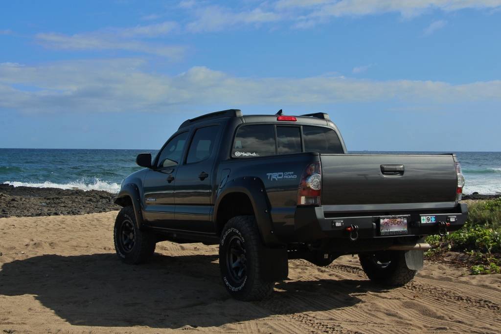

    Yeah, its not really worth it. Plus all those shiny bolts are just for looks! They don't even bolt into the fender :rolleyes:

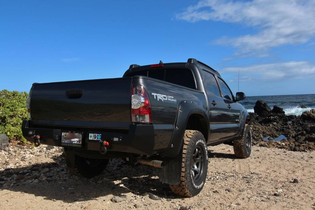

    Some pics of the rear with the homemade flaps. Thanks again for all the compliments everybody! :cool:
    The front sag is noticeable. DSM recommended that I get the 700# coils since I also have the IFS skid on now, with the mid skid and Beefed sliders on the way.

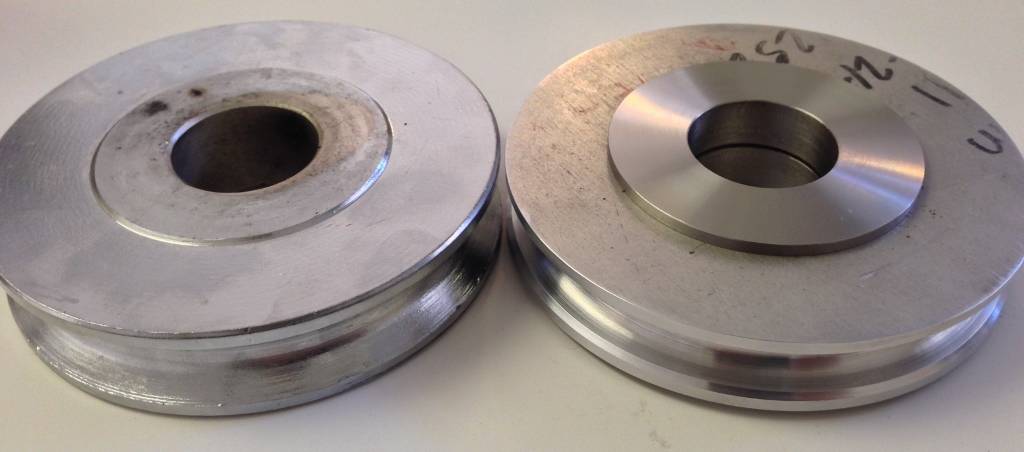

    I finished up the aluminum pulley I made for my snatch block. Polished aluminum with press fit stainless bushings. Much smoother and lighter than that chrome plated cast steel pulley that came with the block.
