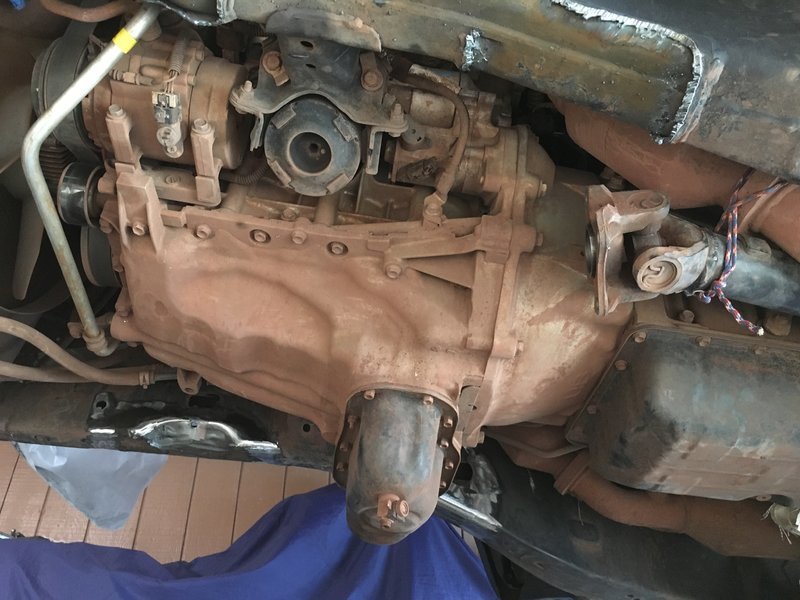

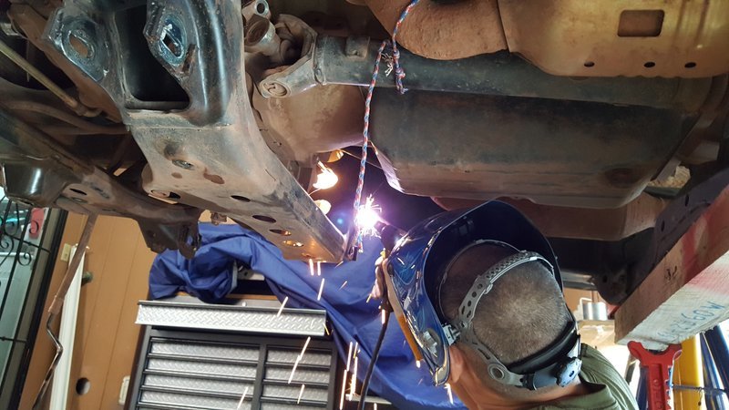

    Nearly done with cleaning up the factory welds on the passenger side. Hope to finish up the drivers side this weekend. Getting between the engine and frame is tough. Anybody got an engine hoist I can borrow? :rofl:

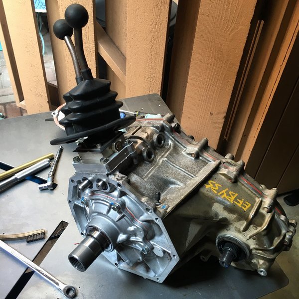

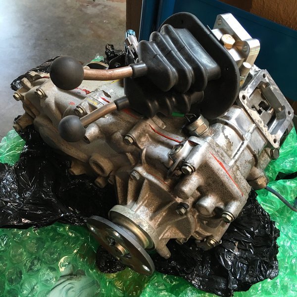

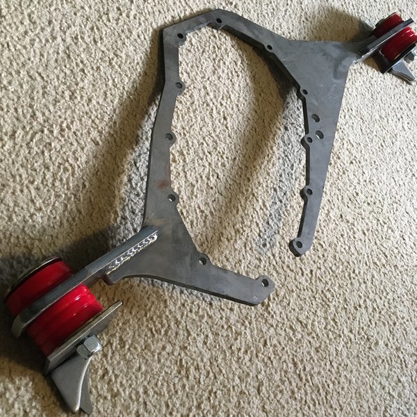

    Thanks to Jesse once again, I got in my front range off road transfer case crossmember, and twin sticks. And also a used FJ cruiser manual transfer case so I can get rid of the stock electronic t case.

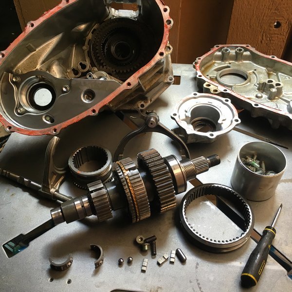

    Got the FJ t case apart and started to mod it to accept the twin sticks and cleaning up the case and making sure it's all working well.
    And it's a little intimidating, but Wyatt from rock solid toys has made some great informative posts with great pics that were a huge help.
    Got it all back together and sealed up, the twin sticks work well, and will be cool to have 2LO. Will be useful for reversing. Now to cut a hole in my floor :oops:
