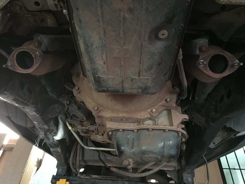

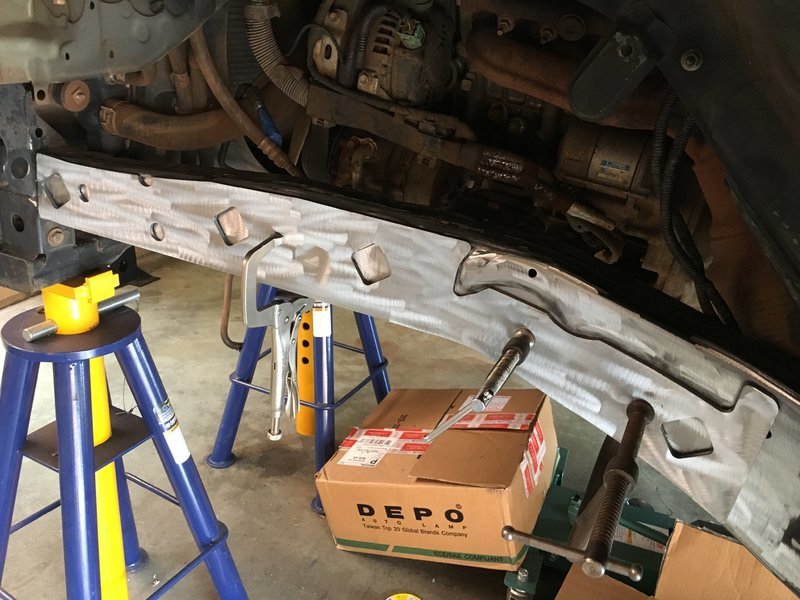

    Current view. Pulled the cats out of the way to make it easier to drop the t case. And they will probably be in the way cause I gotta notch the inside corners of the frame to clear the links.
    I wonder how it would sound if I started it up right now :D

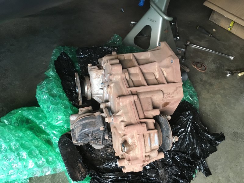

    Nah, just taking apart my truck :laughing:
    Dropped the stock T case... Onto a mountain of bubble wrap :rofl:
    I didn't really drop it. I was under it bench pressing it while my wife pulled the last few bolts. Then I lowered it onto my chest and off to the bubble wrap waiting on the side.

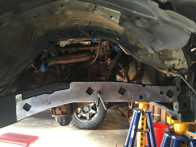

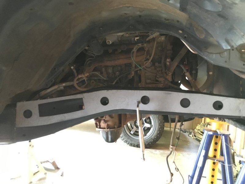

    Huge shoutout to @EddyRRT of SOS off road concepts for quickly making and shipping this new frame plates for me!
    Thanks again bro! :cheers:
    Eddy just finished his SAS and so he already had the file to cut out a set of these for me. They look way better than the first gen frame plates that all pro shipped to me :(

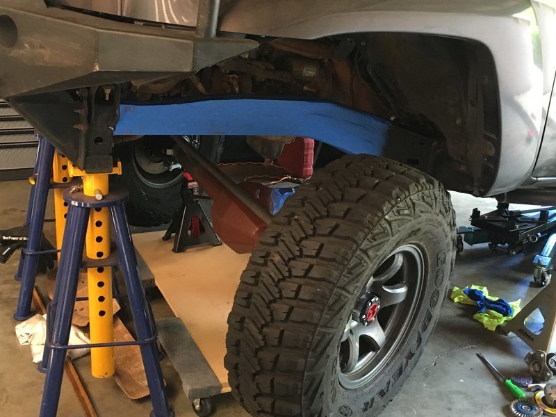

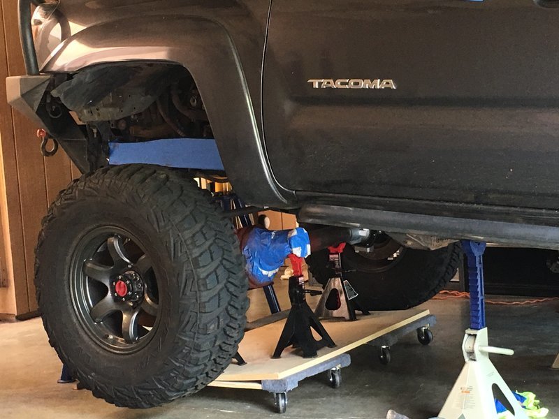

    Getting there... Not really tho.
    Just wheeled the axle outside to give it a coat of primer, and I thought I'd slap the wheels on to see how it looks and fits.
    Sadly I'm still wrestling with my front range off road X member. So no link brackets or shock towers yet...

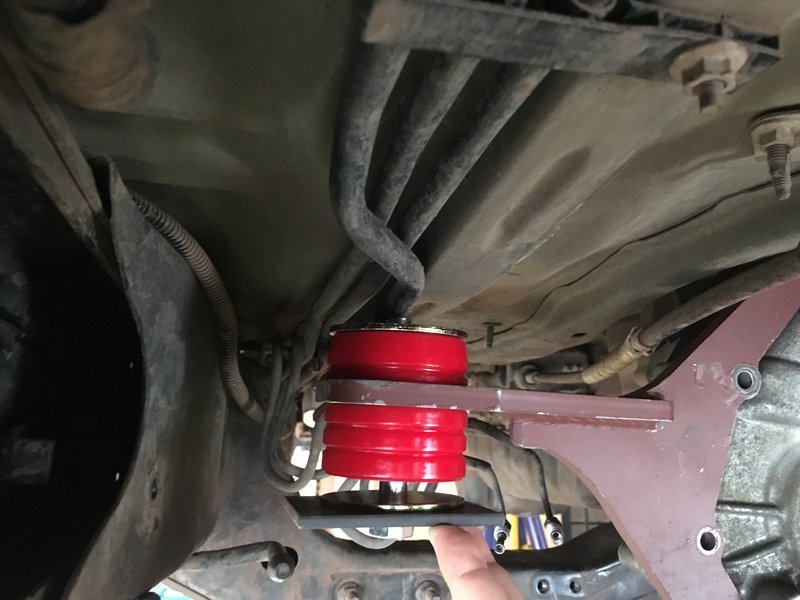

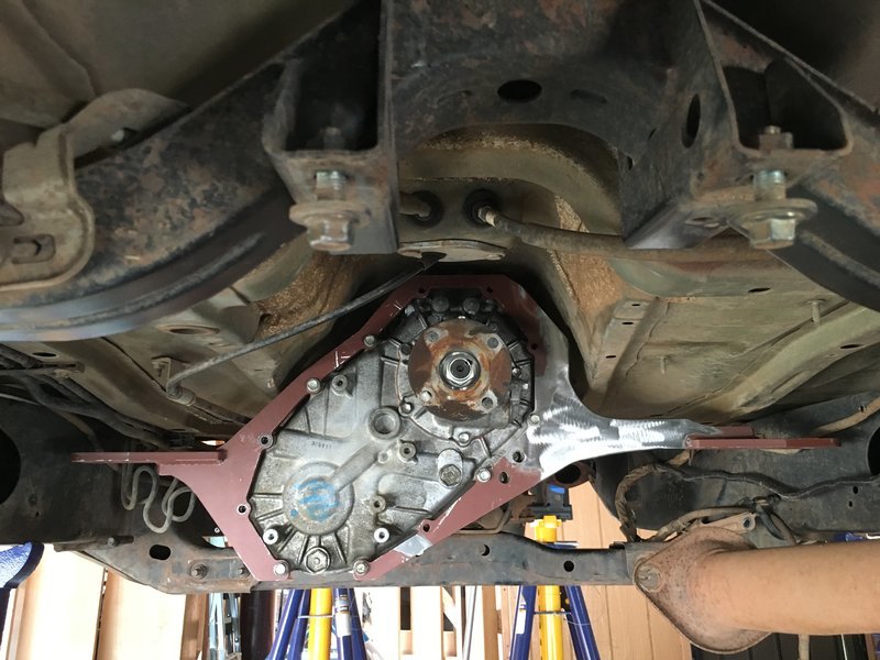

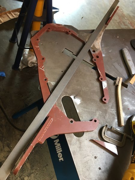

    Here is the problem I'm having with the front range off road t case X member..
    Was hitting the corner of the tunnel, so I had to notch it a little.
    But then the bushing pad was hitting the body...
    So I took some measurements, and decided to cut off the arm and drop it 1.250"
    Double bevel on both sides for full penetration.
    I'm not a certified welder, but I can put down a decent bead.
    And then ground it all off

    Now the arms are in line with each other
    Fits good...
    But the drivers side mount is a bit far away from the frame, and bolt head is now contacting the fuel lines, so I may also cut this side and extend it a little.
    Yay!!! More fab work! :rolleyes:
    I will probably add some side plates to strengthen both arms. But what I really want to do is a basket style crossmember with integrated skid plate using the factory transmission mount.
