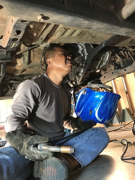

  10. Jan 4, 2017 at 12:02 AM
    #950
    bullaculla
    bullaculla [OP] IKA fabrications
    Oct 14, 2012
    #89002
    8,155
    Da big big island!
    2013 MGM DCSB Tacoma 4X4 TRD Off Road
    All pro 3 link SAS kit, Diamond axle, kings on 37" MTR/K
    Here is the crossmember all welded up and painted, and I'm very happy with the fit.
    I had my good friend Richard, one of the best pipe fitters/welders at BAE Systems Hawaii shipyards come down and weld on my frame plates to support the crossmember
    I hate overhead...
    Now I need to fab up some brackets and gussets to hold this trans/t-case up, then I can finally cut off that last factory X member.
    Nate87, sloth671, polekasta and 5 others like this.

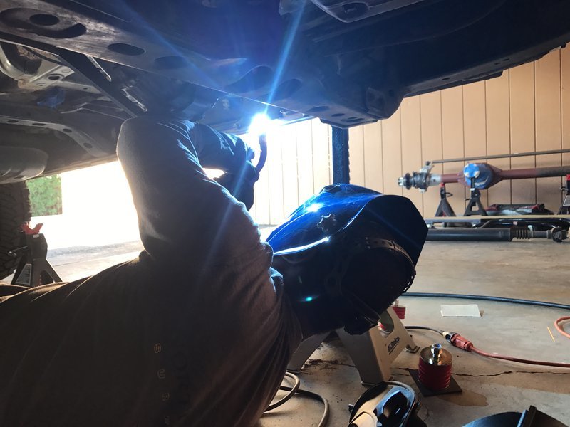

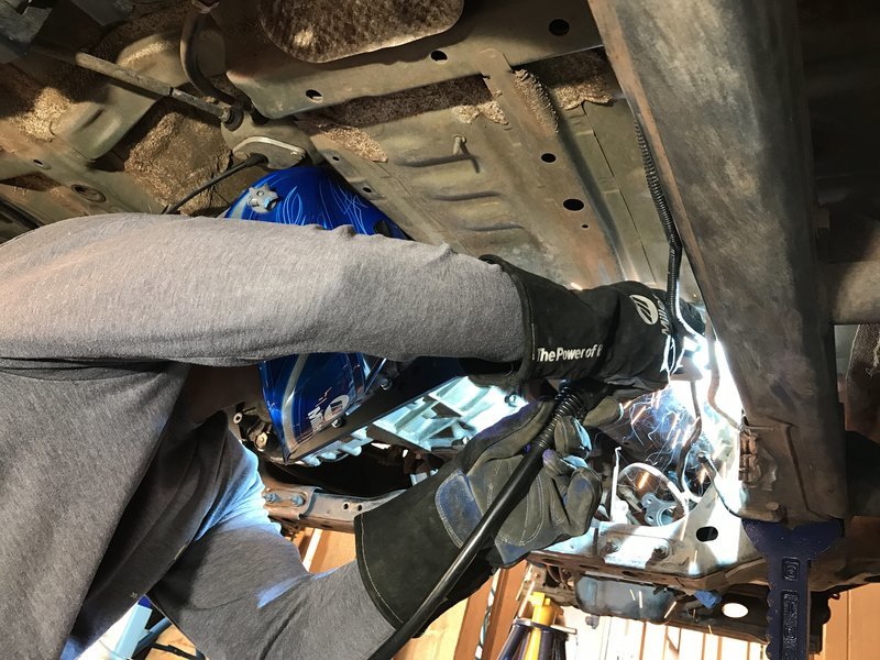

  13. Jan 4, 2017 at 12:13 AM
    #953
    bullaculla
    Oct 14, 2012
    #89002
    8,155
    Da big big island!
    Welding the top of the plate to the top of the frame. Not much room to work between the body and frame.
    Only a Pearl Harbor pipefitter would consider this roomy :rofl:
