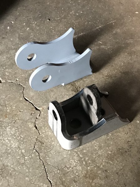

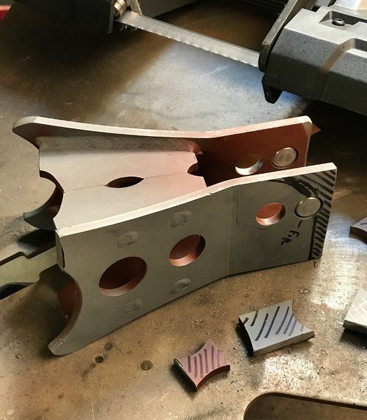

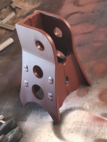

    I had Jesse order me some beefy Ruff Stuff side mount shock brackets for the axle. Having the shock mount sideways will be easier on the eye when flexing. Also has a beefy skidplate with drain holes.

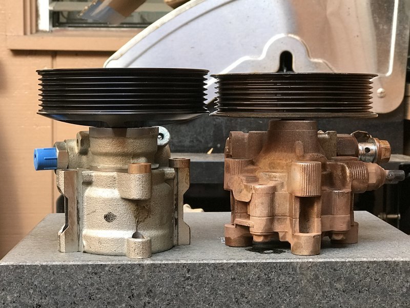

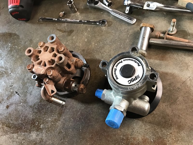

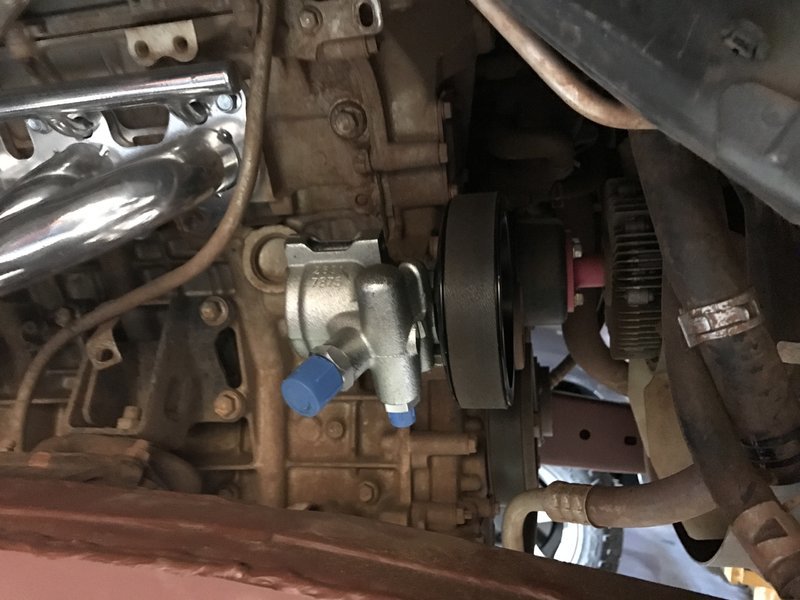

    It turns out the PSC pump I got has the correct bolt pattern to mount right to the engine block, but the width is slightly narrower than the factory pump. I had to make some spacers to get it to mount correctly, and to keep the pulley inline with everything else.
    Can see the spacers I made resting on top of the body. I machined them a few thousandths oversized, then hand lapped them to size on the granite block.
    After I took these pics, I rotated the pump 90 degrees so the return port points up.
