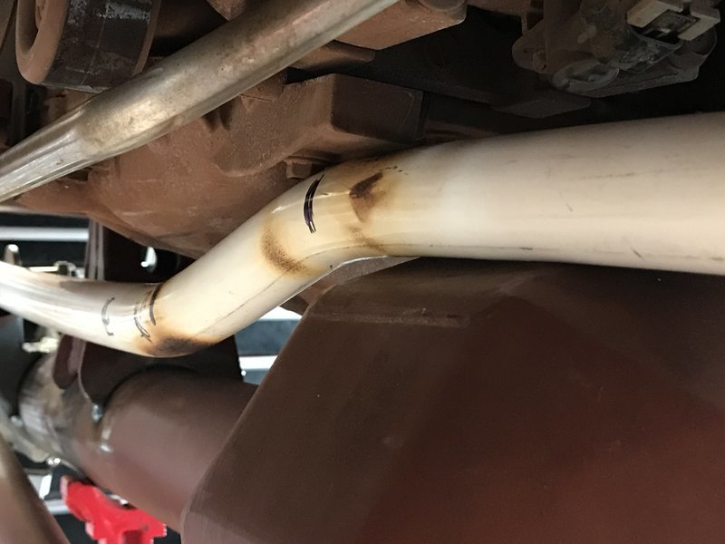

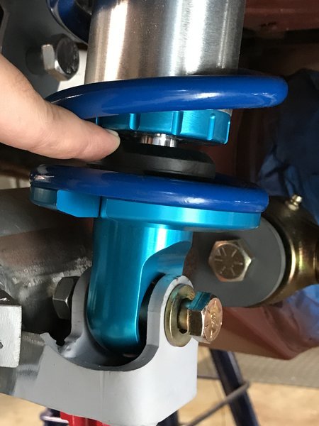

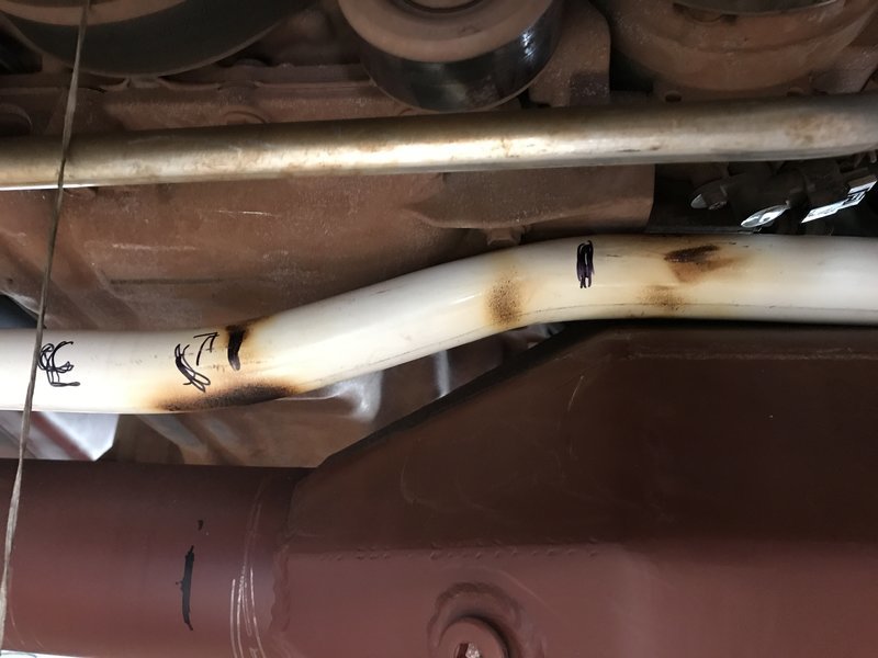

    No real progress with the SAS. Panhard bar and some brackets giving us a hard time. Gonna have to move things around a bit and make or buy some smaller brackets, as some of these are unnecessarily wide. Also to keep the ride height low, we need to put a couple bends in the panhard. So we are using a PVC pipe to mock up the bends then use it as a template.

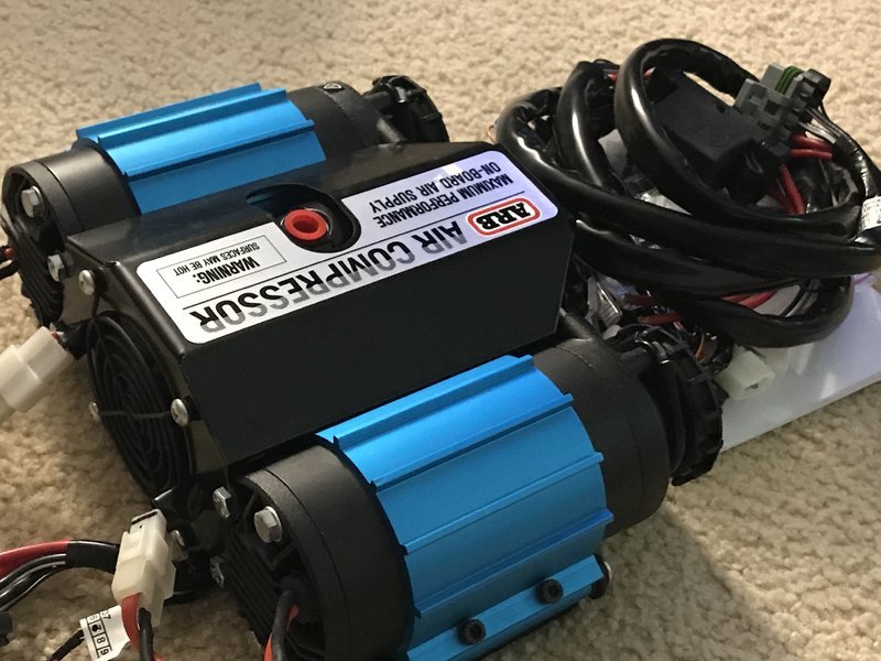

    But I got this in the mail the other day and wanted to say thanks to @bijick for a pleasant transaction. Thanks again bro. It looks great. Now I will be able to actuate the front locker if I ever get the truck back on the ground :oops:

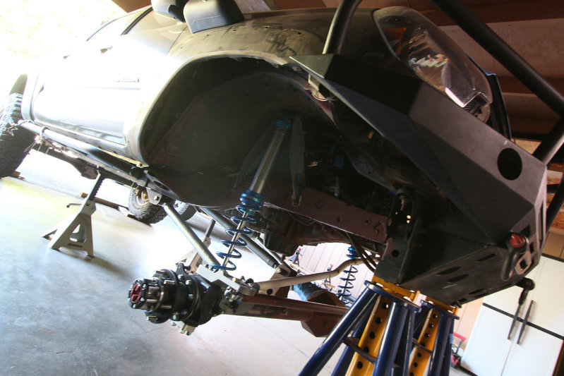

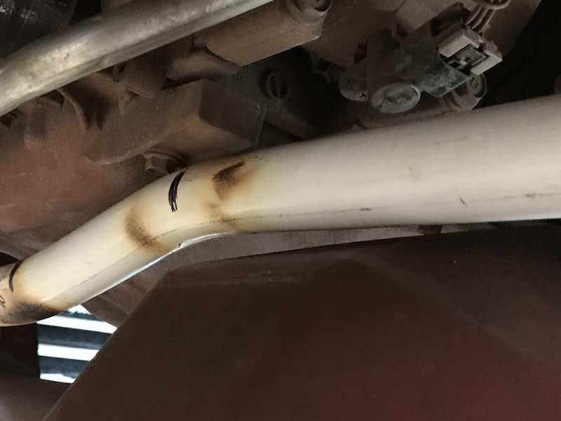

    Yep...
    Here is the situation.
    This is full stuff.
    I think I can cut off that little extension on the oil pan. It's just floating there and not touching anything. If I do that, then put a little more bend in the panhard, it should clear at full stuff.
    It's either that, or limit my bump travel and have a higher ride height, or move my engine up a little bit :rofl:

    I would just shave that small piece, does that bolt come in contact?

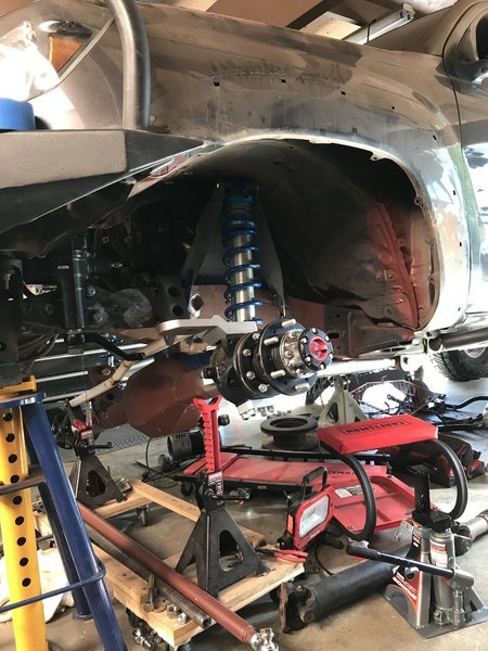

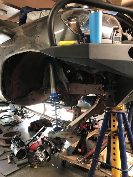

    :rofl: so I messed up. I had the axle stuffed as high as it could go, but the shock wasn't even in place on the drivers side :oops: it was actually past full stuff. The pvc panhard is fine now.
    This is already too far,
    But at this amount of stuff, I still have space on the panhard.
    Fully flexed. Ignore all the crap under my junkpile...
    Now just gotta fine tune the panhard bends and duplicate it in 1.5" DOM tubing :cool:

    I still might cut it for extra room. If I put a little more angle on the bend, it will clear the bolt even tho it won't go that high anymore :D

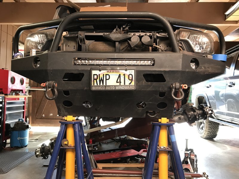

    All those expensive goodies, and your license plate is still held on by zip ties! You do have your priorities straight, though!

    Yep! Done! PVC panhard should hold up fine :laughing:

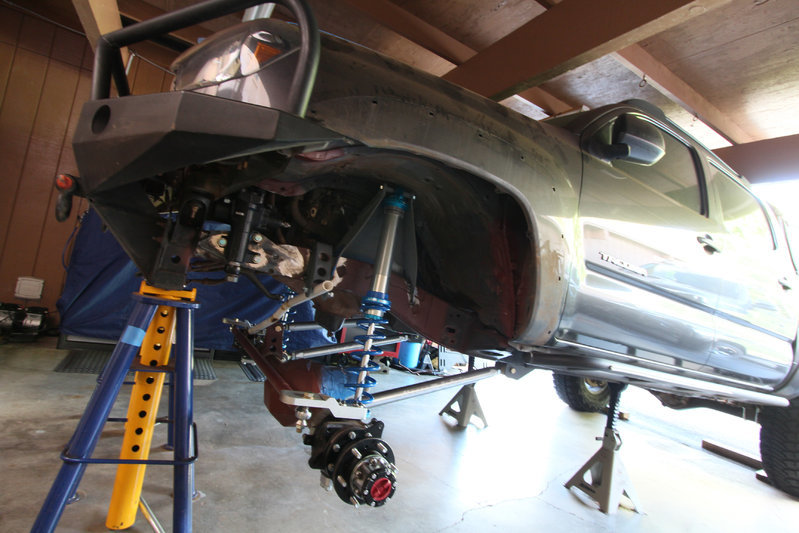

    I cleaned up under the truck and snapped some more flexing pics :D
    And I made a gif
    That panhard tho! :drool:

    I see you got rid of the zip tied license plate.:anonymous: And, you used to tease me about my zip tied plate. :rofl:

    Shit, that was always zipped tied on there! :rofl:
    And I think safety or recon says that it needs a minium of 2 zip ties to hold it on. And I use zip ties cause its easy to cut off if I need to use the winch :D
