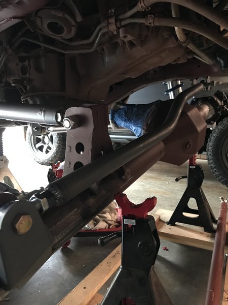

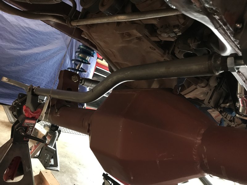

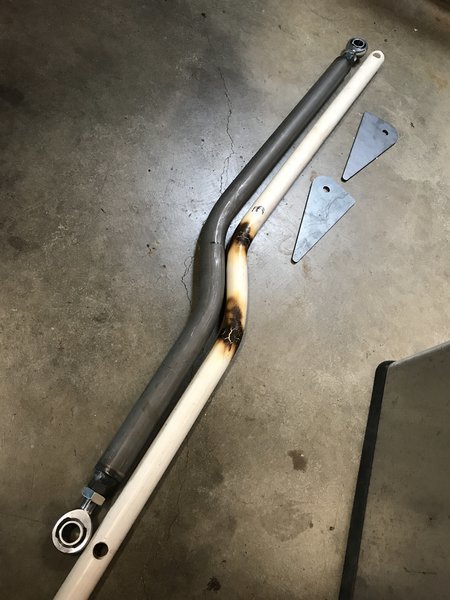

    So I took the bent up PVC panhard bar to @1uzrnr to bend up some 1.5" diameter 0.25" wall thickness DOM tubing to match it.
    Jesse inspecting the angle of my rod! :devil:
    I didn't get any pics, but after bending and welding on the bungs, it matched up great.
    The plates next to it is a Barnes ultra 100 bracket we are gonna use to make a more narrow panhard bracket that goes on the frame side.

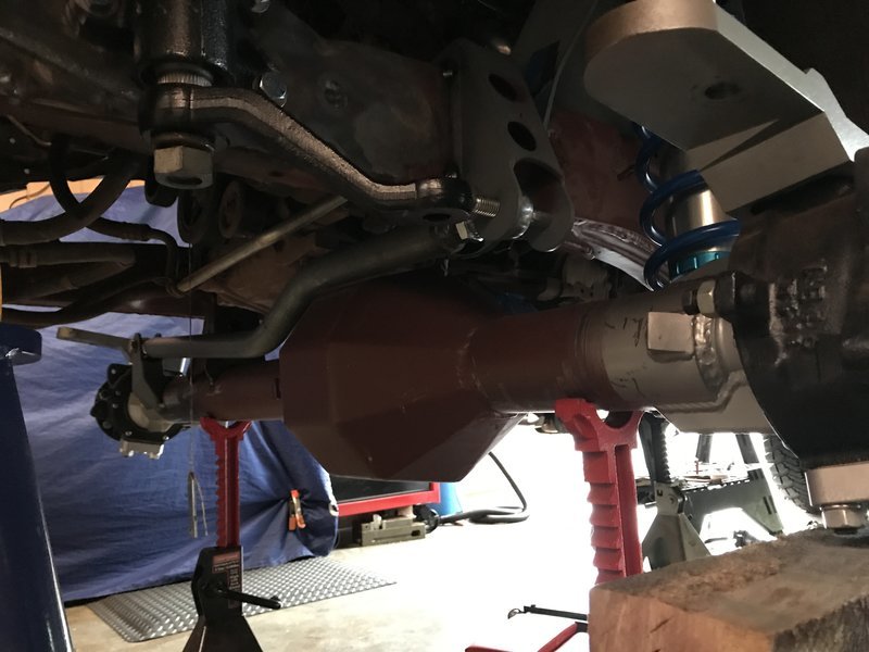

    Gotta make some minor adjustments on the brackets, but everything looks like it's fitting great. Did a quick flex on the axle, and it clears the oil pan and pumpkin everywhere.
    Full stuff above, full passenger droop below.

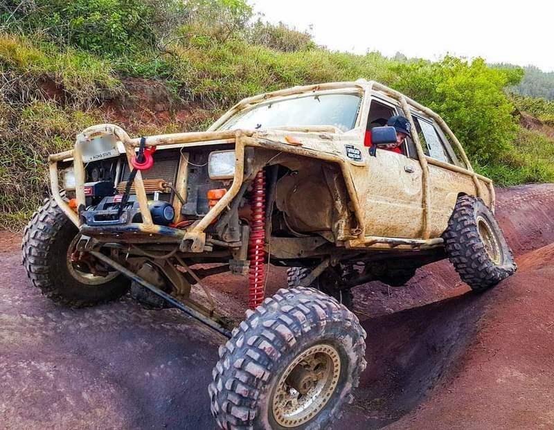

    My 4runner was a pain in the ass to put a 3-link on. The 1UZ oil pan, exhaust, and motor mounts were all in the way. Took a while to make everything fit and it paid off with 24" to the frame on 37's and 5" of uptravel. I beat the piss out of that thing!
