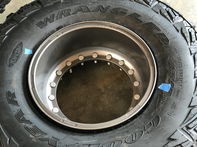

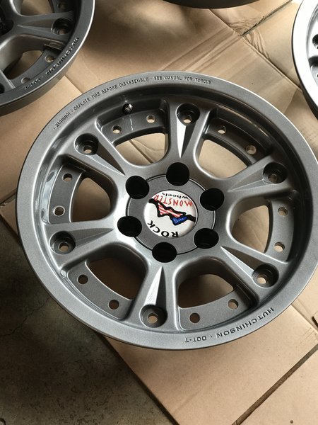

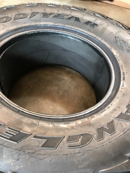

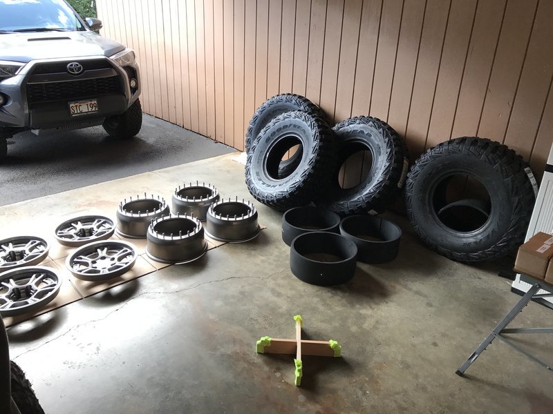

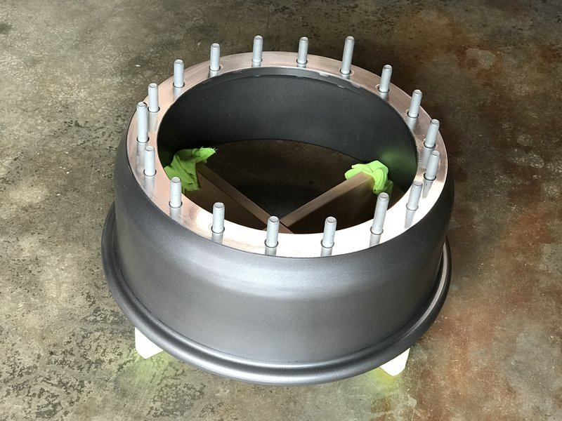

    There are some great videos on putting these together, so I'm not gonna go into too much detail on the hutchinsons.

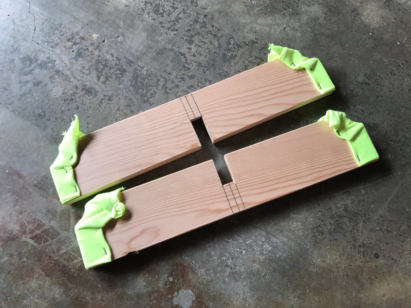

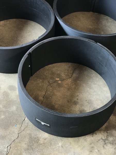

    I made this stand so when I step on the wheel, my weight is pushing the wheel against the ground and not just compressing the tire. With the tires spaced off the ground, my weight will just be putting direct pressure on the two sides of the wheel forcing it into the tire and getting the bead closer to being seated.
    First thing to do is get the doughnut into the tire.
    Then shove the inner part of the wheel in, trying to get it in there as far as possible. Blue tape is to line up the groove in the doughnut with the studs so I get the valve stem in the right place.
    Lubing up the O-ring with Vaseline. @1uzrnr said to start with one finger first, then try two :laughing:

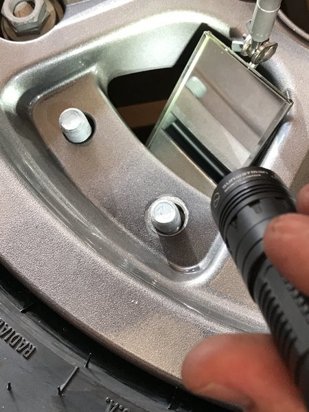

    Back of the wheel is on my stand. Gotta stomp on the face to get the 3 starter studs to protrude enough to get some of those weird locknuts on. If you gonna run dynabeads, get them in before putting on the outer wheel. Hutchinson does not reccomend it tho...
    Once you close up the gap a little, check to make sure the O-ring is still seated in place.

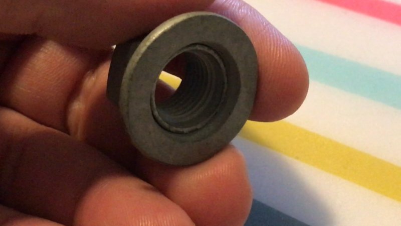

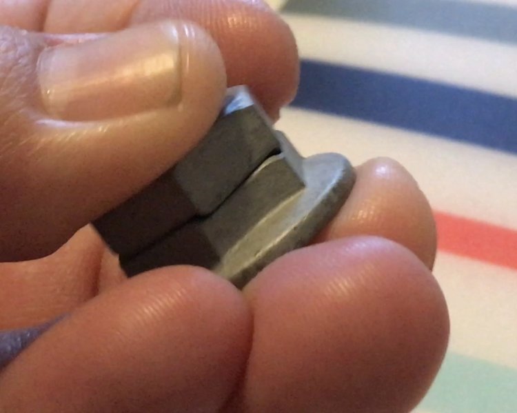

    Here is the locknut. Weird 2 piece thing. I've been a machinist for awhile and have never seen this before.
    Threads go all the way down tho.

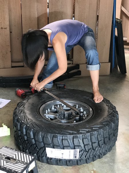

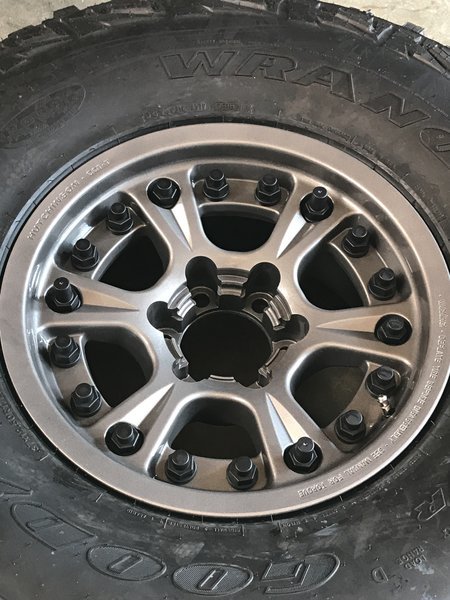

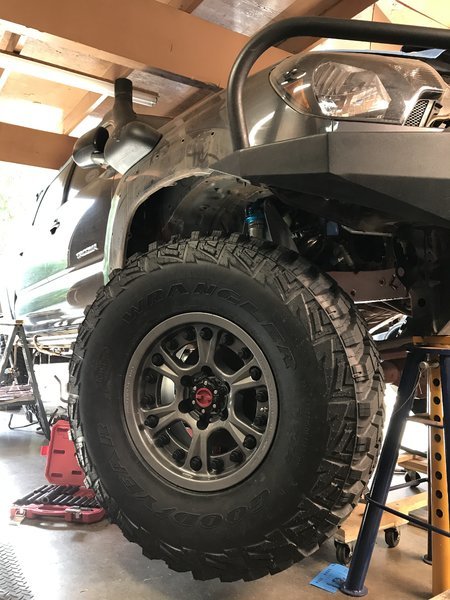

    Put them all on and torque to 100ft lbs in a star pattern. Wife tried, but couldn't get the torque wrench to click 100lbs :D

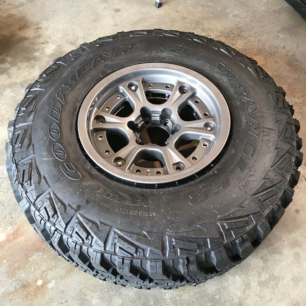

    Then put these plastic caps over the nuts and studs to make your real beadlocks look like fake beadlocks :rofl:

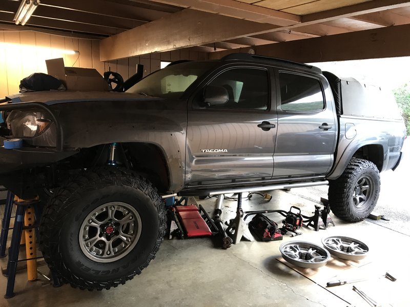

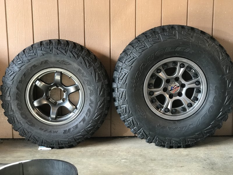

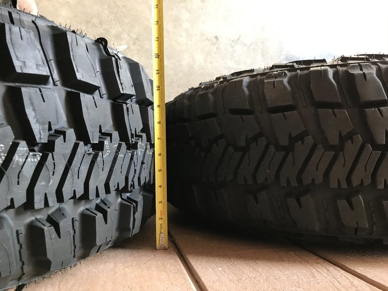

    In case you were wondering, 37s are bigger than 285s ;)
    Not much wider tho thankfully!
    Daughter was making rain noise with the dynabeads :)
    Looks right at home on there :D
    Would it be okay to run 37s up front on 4.88 gears and 285s in the back with stock gears? :laughing:

    Rubber doughnut, 13lbs 8oz.

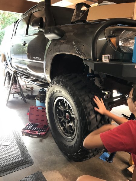

    I got them on the hubs just fine :p

    That's cause you take so long to get a wheel on! :laughing: it only took me a few seconds to get that monster on.
