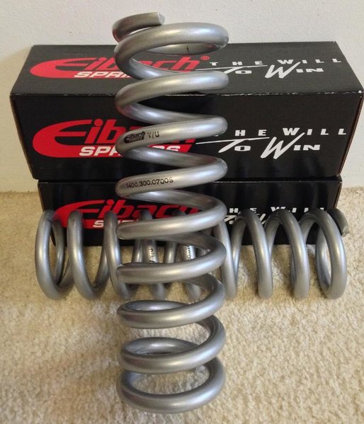

    How much was the springs? I mighy have to upgrade mine too to 700lbs. Full load scraping in the front.

    PM sent.

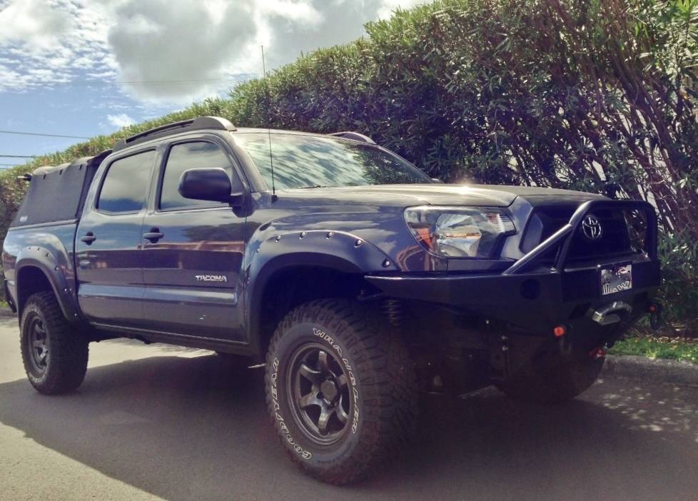

    Had to leave work early today...
    cause I knew this would be here!
    Sorry for the crappy pics... The Iphone doesn't like being aimed at the sun. I'll take some nice poseur shots this weekend with a real camera :D
    Doggies already making themselves at home! I also got the screen window for the pups.

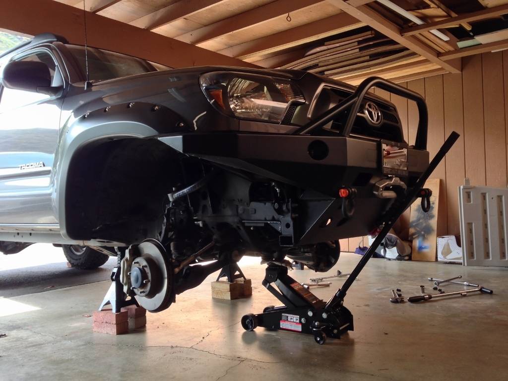

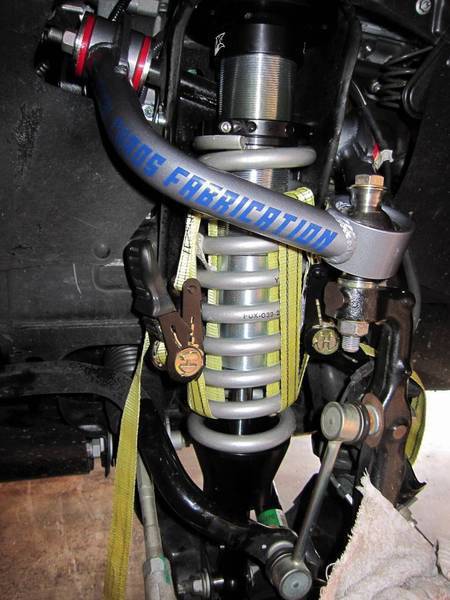

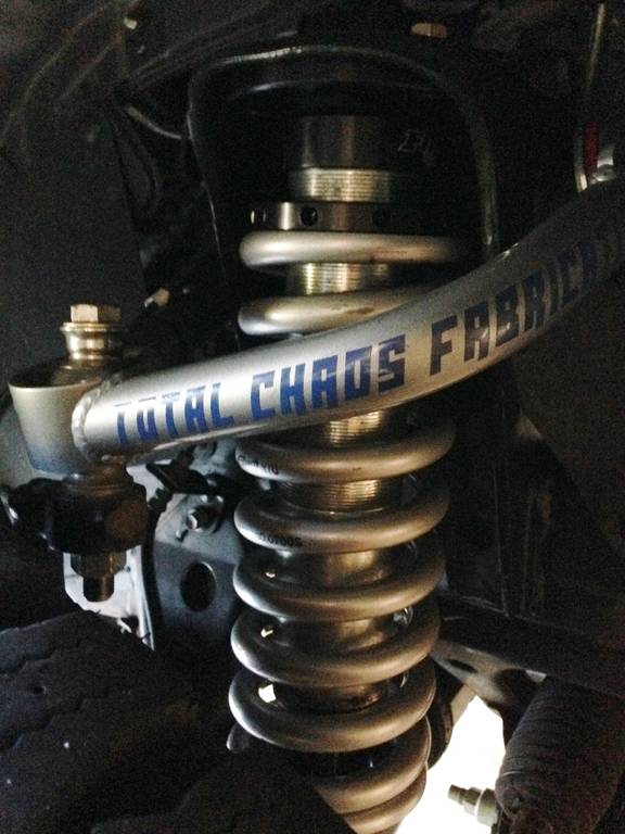

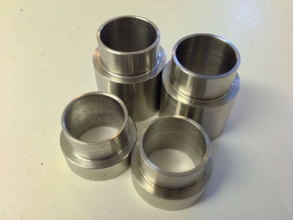

    So I have been patiently waiting for this weekend to come so I could install my 700# coils. Before I removed the coilovers from the truck, I wrapped the coils with some ratcheting straps to keep the spring compressed. I loosened the preload adjustment ring and backed it off enough to remove the lower spring retainer. Now I have this coiled up spring loaded with energy. I laid it down on its side and wrapped it with a moving pad and released the ratcheting clamps. No problem with that. But there was no way I was gonna be able to compress the 700# coil enough to install them on the shock bodies. The clamshell type compressor I bought and the running thread type that Luka loaned me would not work with the 2.5" fox shock bodies. Not enough space between the shock and spring for the hooks.
    So I decide to call around my nearby service stations to have them use their real spring compressor to mount my coils. I called atleast 6 service stations. Saturday. All the mechanics are off. I finally called Ron's Performance in town, and they said they had some one that could do it. I drop them off, they said they'll call when its done. I told the guy to back off the preload rings all the way. When I picked them up, the one that I had already removed and loose was backed all the way off, but the other one still had the same amount of preload for the 600# coil. I thought I could back it off myself so I paid them the $85 they charged me, and took my coilovers home. I mount them on the truck and loosen the clamp screw and start backing off on the preload. I guess I loosened the clamp screw too much because the amount of force from the spring cocked the split ring and made one side jump a tooth. Afraid to damage the threads, I quickly call Ron's again, and they said I can bring it back. I get there and the mechanic I just talked to had left early too go eat dinner! :mad: Nothing but sales guys there. I told the manager what happened and he was upset with his guy and tried to call him back on the phone, but he wasn't answering. So he let me come in the back and we both worked it, got the ring straightened out and backed it off. He didn't want any money or beer, so I told him I will buy my next set of tires from them.
    By this time its 5pm. I get home and as soon as I take the coilover out of the car, I realize that I left the lower shock mount spacers at the shop. I tried to call but they had left for the day. They would be closed sunday, and Monday because of the holiday... I have the spacers for the other side, so I could easily make a replacement set at work on Monday, but I would not be able to drive my truck. So I left my house at 6pm to go and make the spacers in my shop. I got permission from my supervisor who was surprisingly ok with it. Was home by 8pm with this.
    Can you tell which is the original? :D
    Everything is within .0005" and it felt really good for something to go right :) I really needed that. What a long and frustrating day!
    My truck was like this all day Saturday and most of Sunday morning.
    Preload with 600# coil with ride height at 22-1/4" (hub to fender)
    Preload with 700# coil with ride height at 23-1/2" :D it will settle and now I have lots of room to adjust.
    When I first got these coilovers, I thought that this split clamp type retaining ring was better than the old school double lock rings. I have changed my mind.
    The tried and true way is better. There is no way it would have jumped a tooth with the regular style.

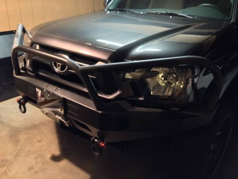

    So now my truck is all back together, I got some ride height back, and my pipefitter friend is on the way to my place to weld on my headlight hoops! :D

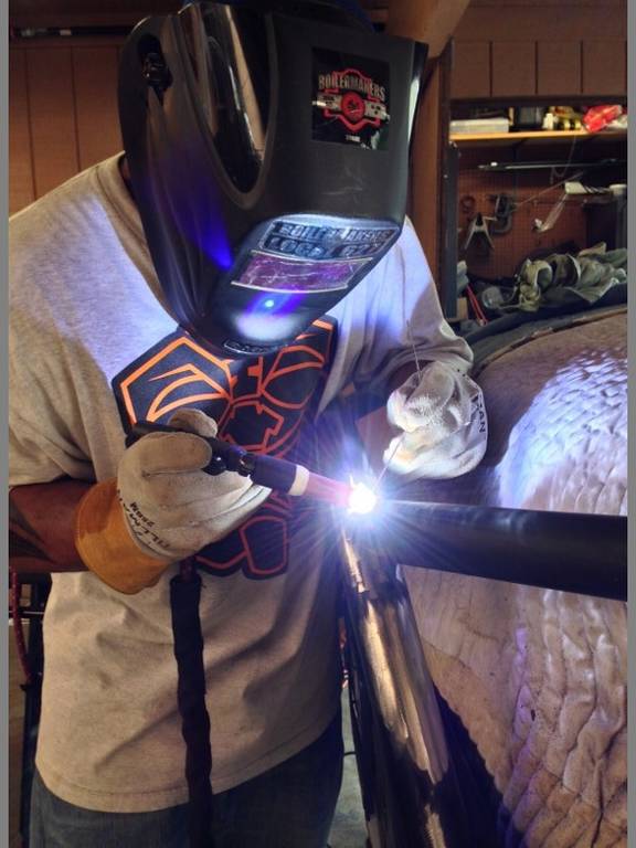

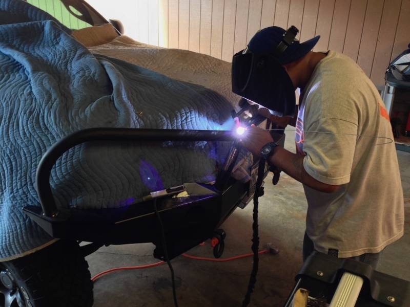

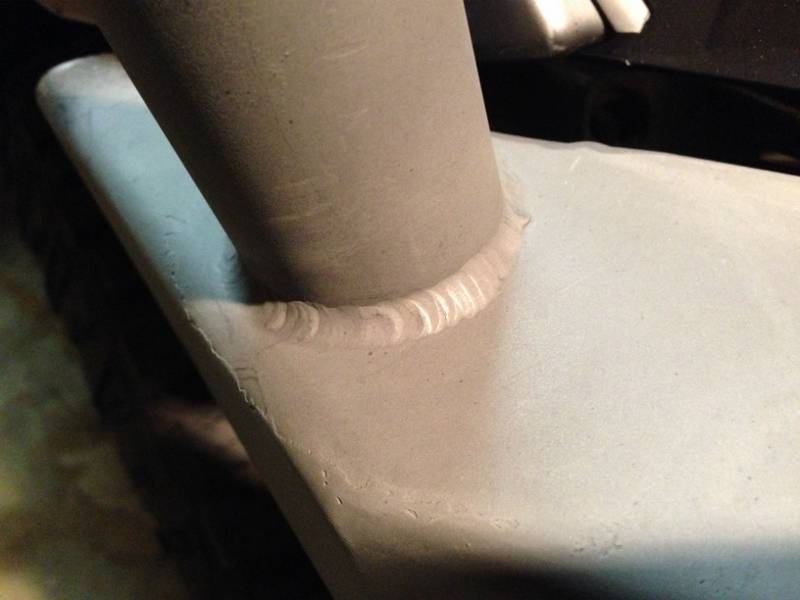

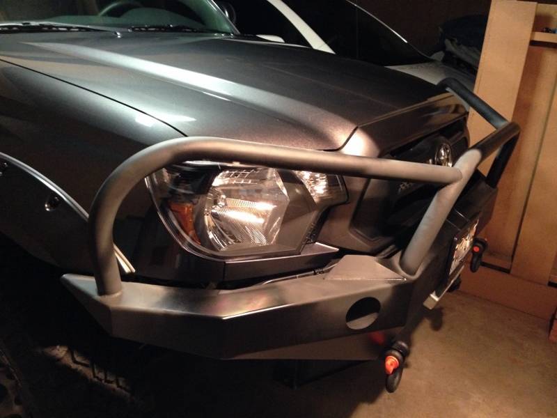

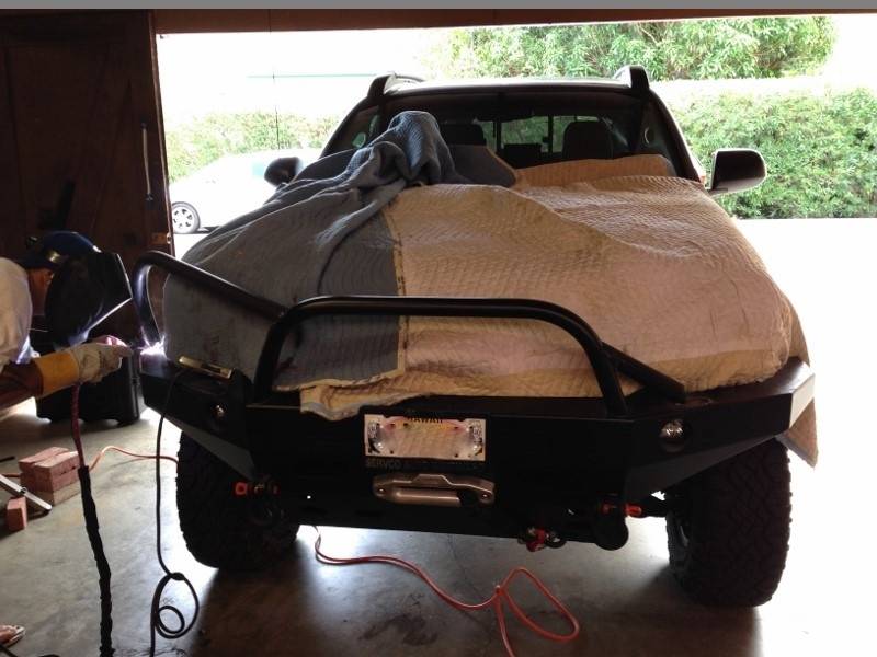

    I got my hoops on! After I got my front end together, one of my pipefitter friends from pearl harbor came to my place with his TIG machine and helped me fit up and weld the headlight hoops on. Thanks Hanohano!
    He was welding while I cut off the other brace. I thought about leaving the braces on and running the hoops, but I think it looks cleaner this way.
    It doesn't look very uniform because he was walking the cup.
    I just shot the raw steel with some primer for now. I'll take it all off again later and drop it off for powdercoating.
    I'll take a straight on pic and post it later. It is very even on both sides.
    So happy I finally got my hoops on! :D Very productive weekend!
