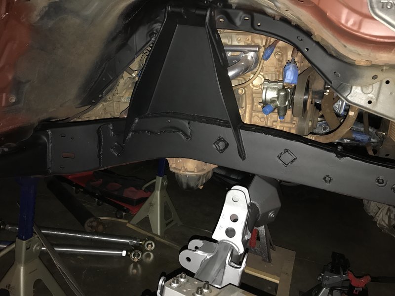

    I forgot to take pics of this, but we also added gussets to the long tubes on the shock tower.
    Welded all the way around the gussets. Way better than before.

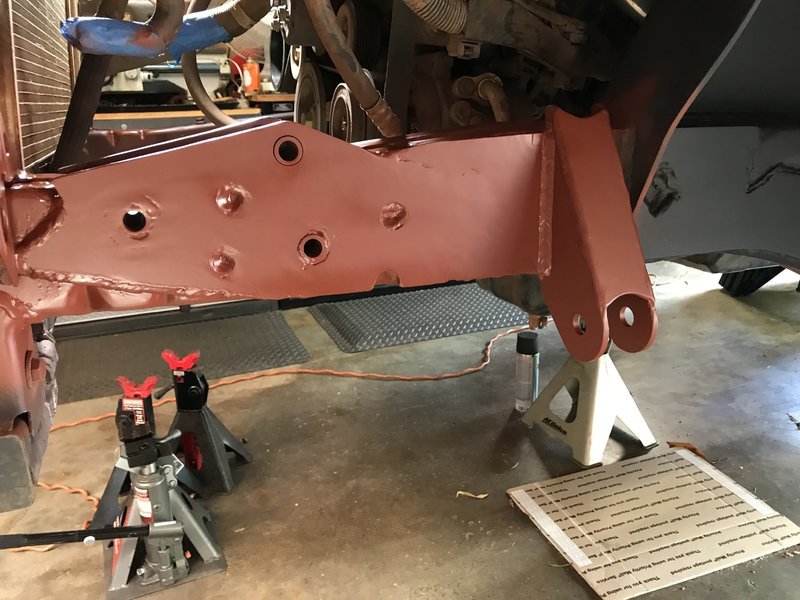

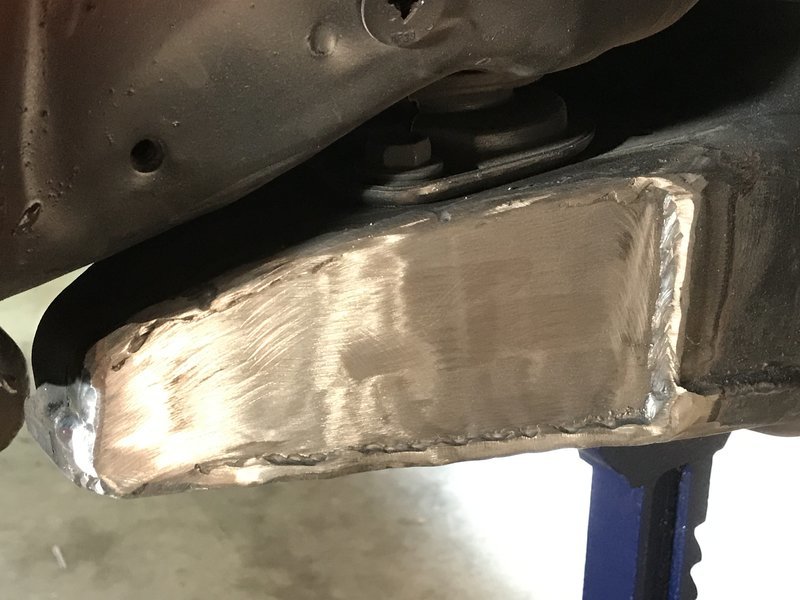

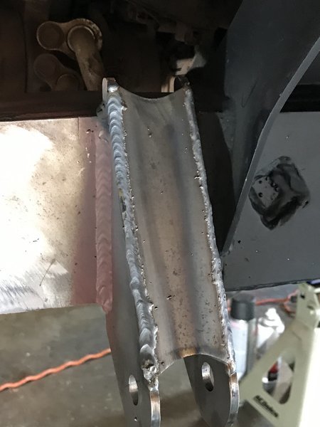

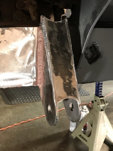

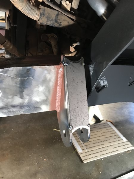

    Finally got around to plating that panhard bracket we made.
    I don't claim to be a good welder, but I've seen worse :D
    It started off good :laughing:

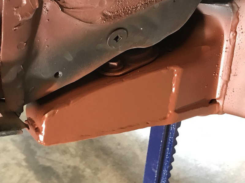

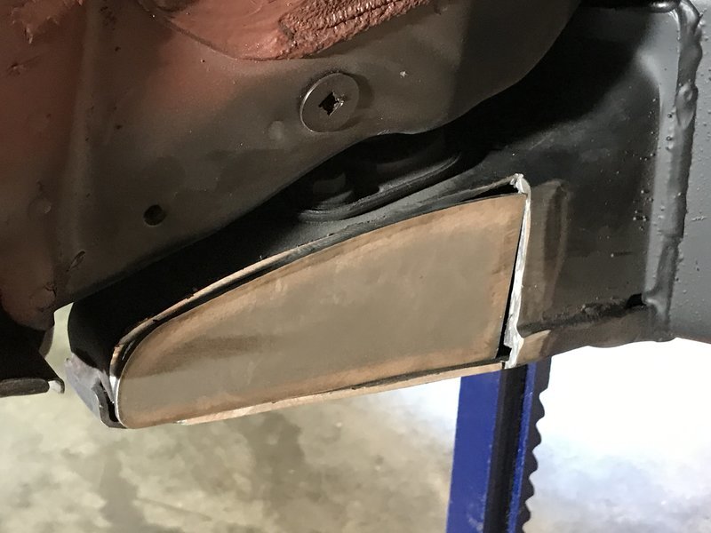

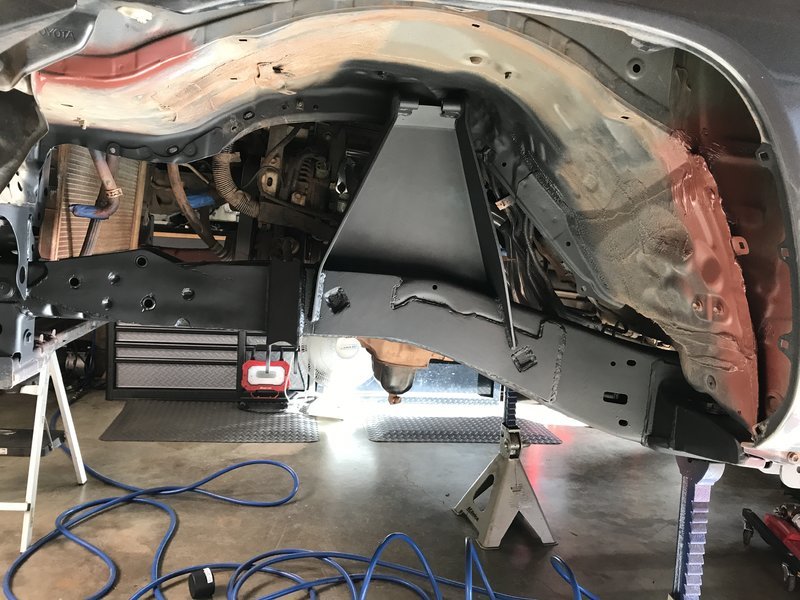

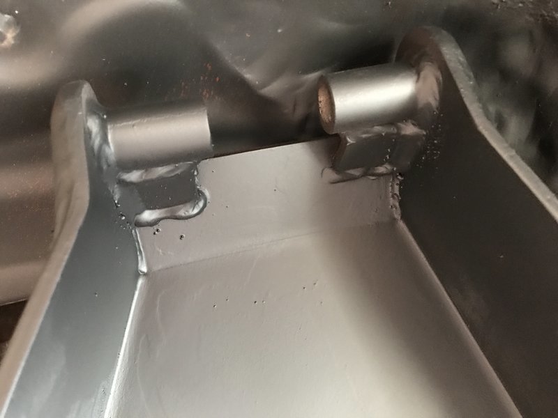

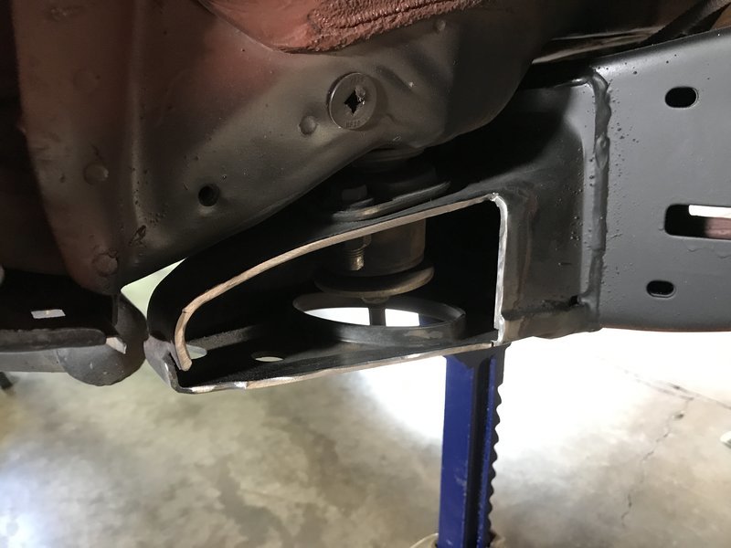

    I got away without doing the CMC for a long time. My 285s cleared it just fine, but with the 37s it'll be close. So I figured I'd just get it done while my truck is in pieces. BAMF plates.
    I got a lot of shit done today! :cool:

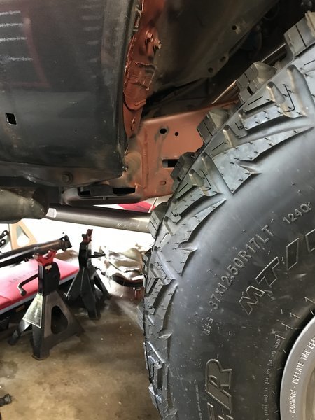

    How far forward is your axle? Cause just stock with the 315s I had to buzz that all the way down to the bushing mount.

    It's pretty far forward. With the 37s on there it cleared the stock cab mount, but more clearance is better. And this will give me more room for adjustment. I can safely adjust my lower links and change the wheel base over an inch. The Johnny joints have pretty long threads.
    Passenger side, steering at full lock.

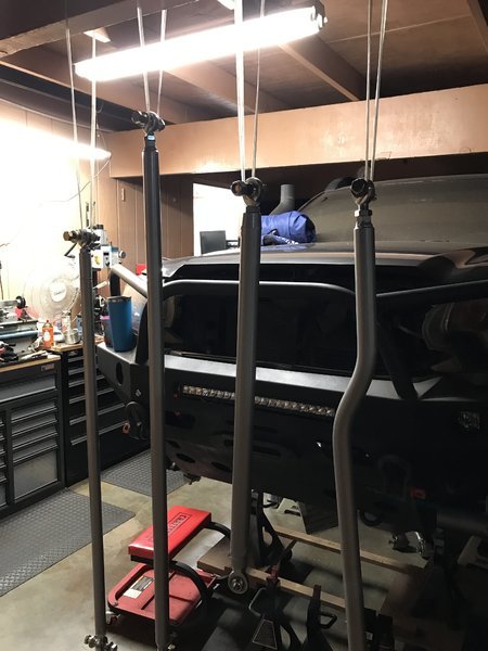

    This makes me smile :)
